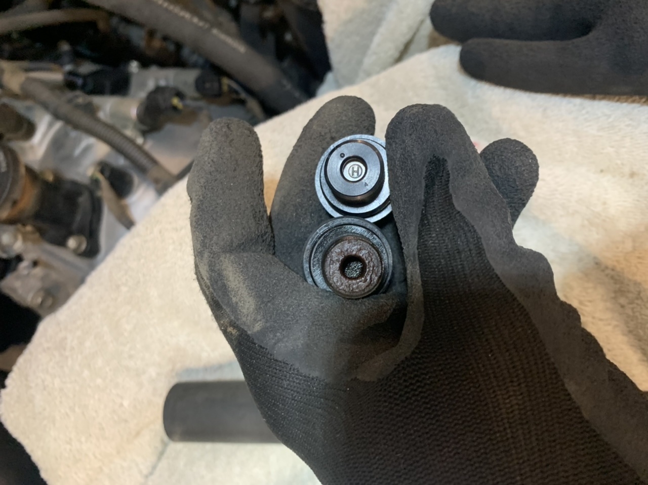

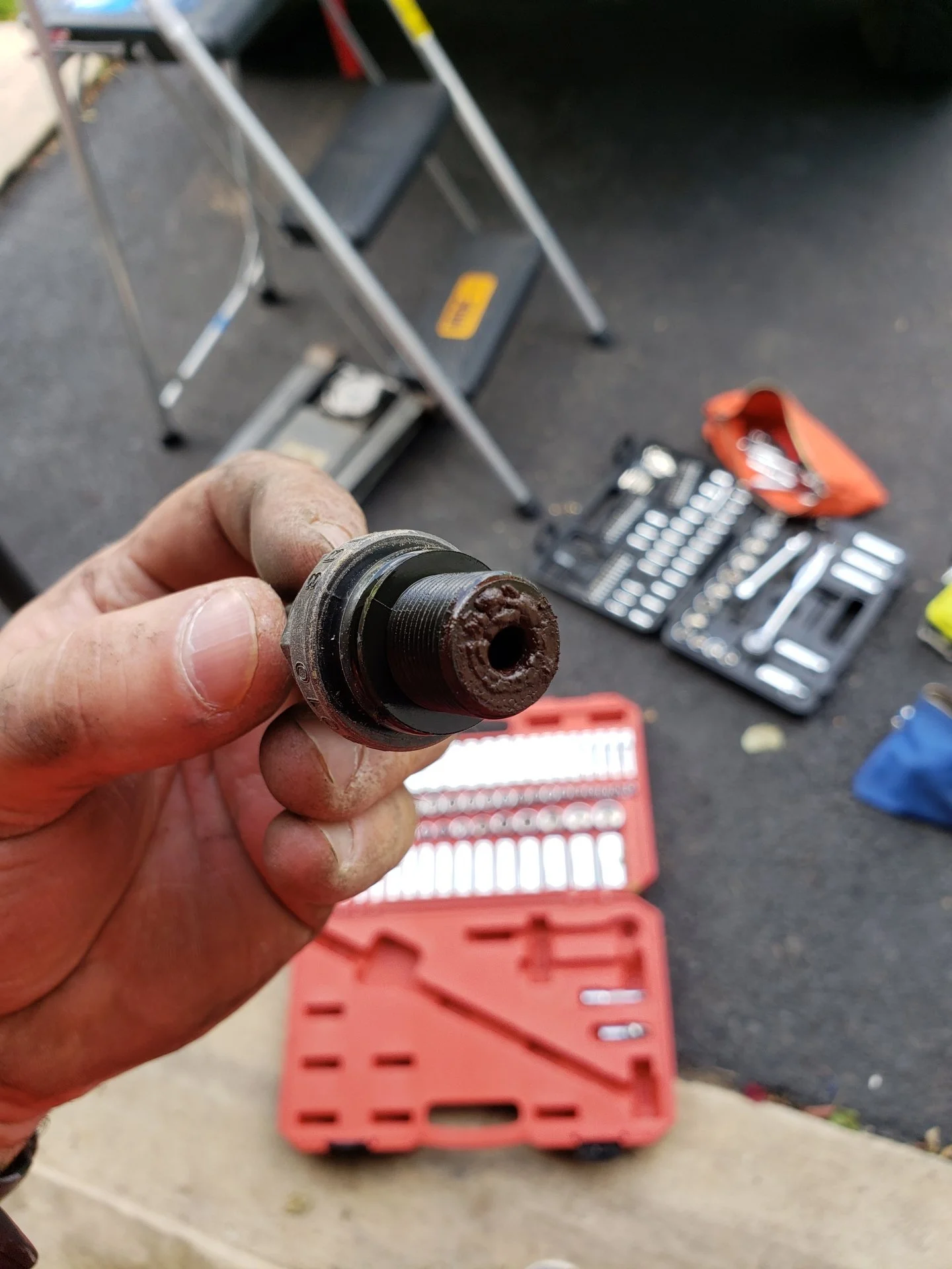

Mine was nasty and stuck. 08’ 110,000
I changed mind around 100k. It wasn't stuck, but the old one felt heavier and less smooth when I shook it. I suspect there was a bunch of gunk building up inside
The old one fell out of my hands and landed somewhere on the skid plate.

Stuck open

mine was still rattling at 140k miles but I did see oil leaking past the PCV, my intake had oil and even the spark plug wells had oil.
