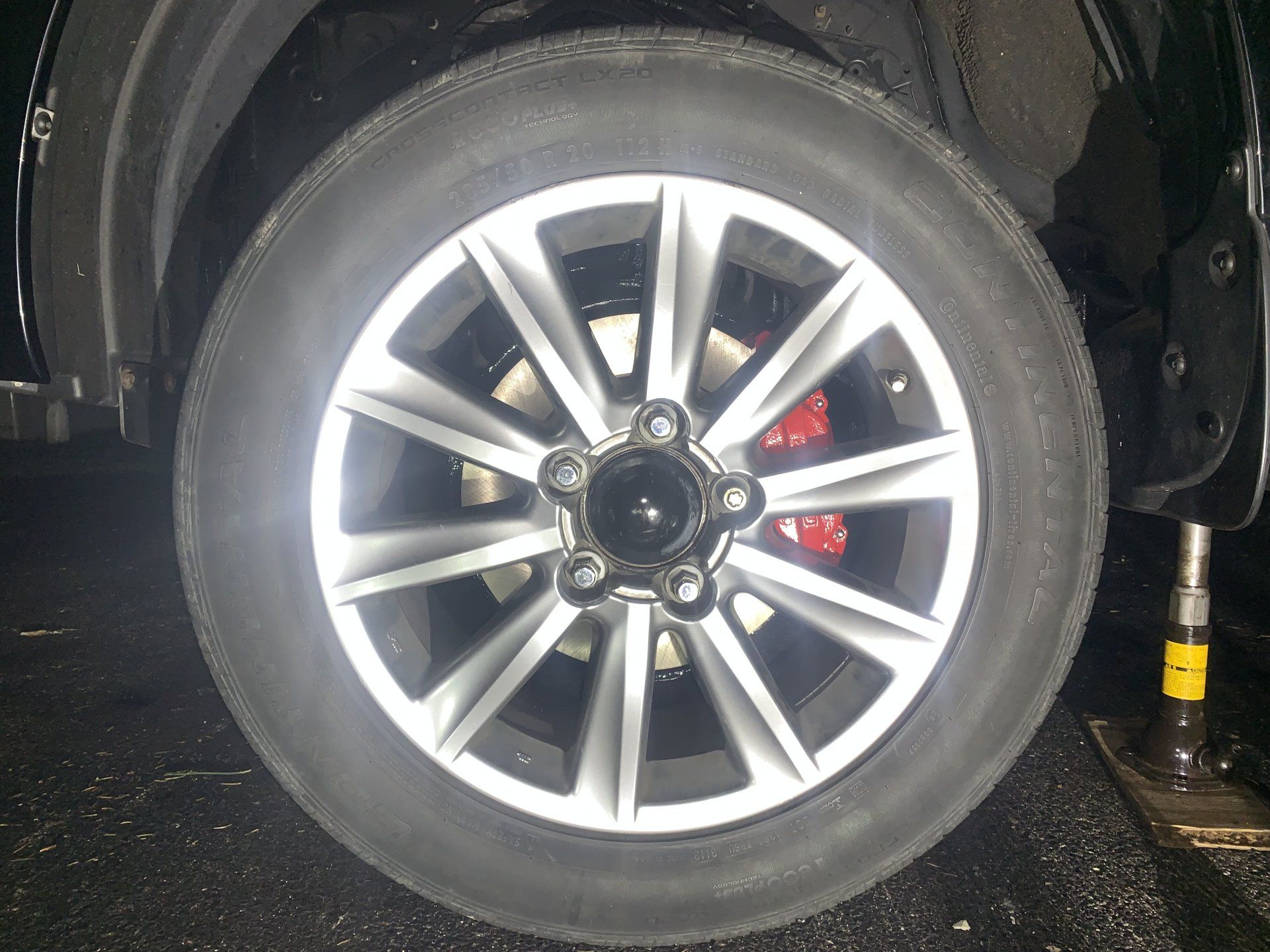

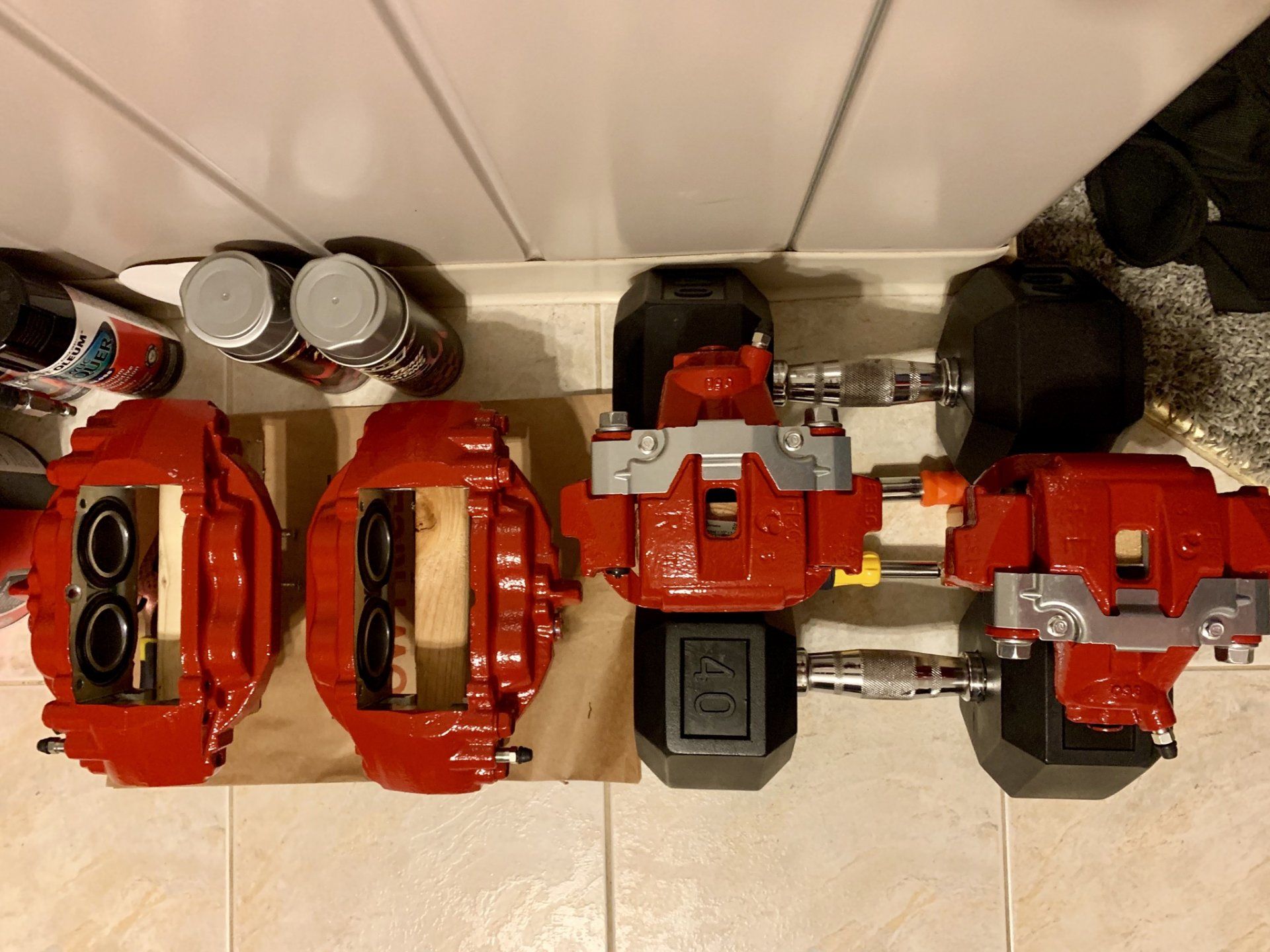

I did a lot of maintenance and pins on my old calipers were stuck frozen from rust so it is indeed possible that my old brakes were dragging, one of the original spark plugs was under tourqed but I truly think faulty PCV valve was to blame for the poor gas mileage.
I credit the improvement to the new PCV valve. Either that or the red calipers. Another variable I also got new set of Michelin Defenders at Costco (replaced Continental Ecco-Plus) just before the 100 mile drive, new tires ARE nitrogen filled as that is what Costco does these days.
