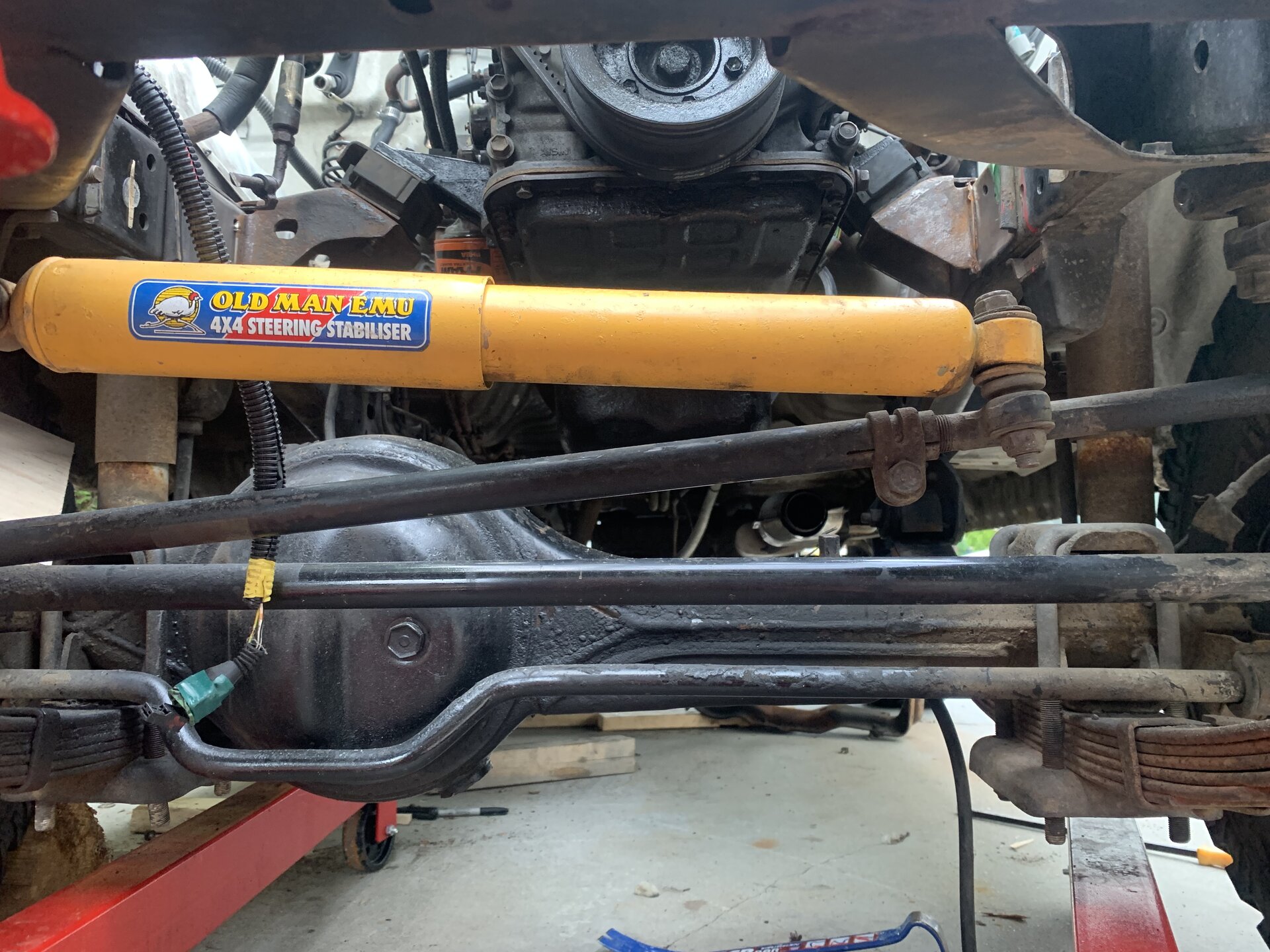

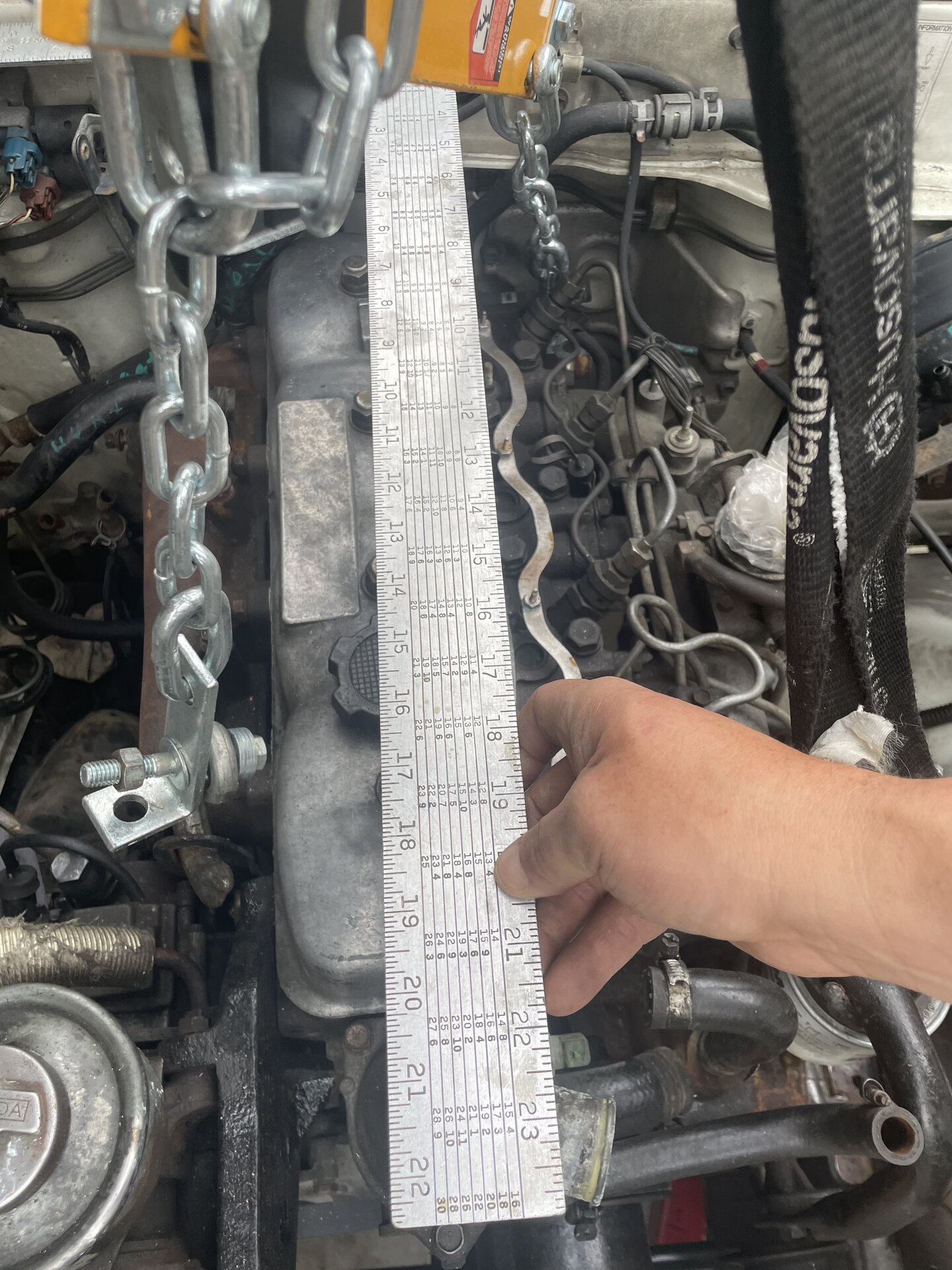

I swapped in a 3B into my 62 today. The motor mounts were cut and welded in by me. The engine landed right where it should be, however it is VERY crooked.
From what I have read on here, it’s normal.
However, I want to be 100% sure it’s okay… does anybody know if this is acceptable? How do I know of the engine is too crooked!
The engine also doesn’t seem to sit flat.
Any help is appreciated.

See if you can mount up the fan shroud temporarily. Should give you an indication of whether it’s sitting correctly or not.
Measuring for the motor mounts is good for double checking things, but not great for actually locating the mounts accurately. Better to make jigs to locate things on the old frame, and use the same jigs to place them again.

Well if you're using the clocked bellhousing, then a crooked engine sounds right.
I don't think this logic is correct. The engine is mounted irrespective of the bellhousing and transmission used. Leveled BHs and flat transmission mounts are used with H42 transmissions. The clocked BHs are mated to H55F transmissions utilizing a transmission mount that accounts for the BH clocking.
If it helps I just posted some pics of angles of how the 2h sits in a hj75, 2h into fj75 post in 70 section. The engine does tilt backwards about 4 -5 degrees and the front is slightly pointing to the left front on the 2h from factory in a hj75, very subtle. The rocker cover is very close to firewall and cab heater hoses, so just a little little painfull when adjusting valve lash putting rocker cover back on/off.
I have been told many engines are slightly askew in many vehicles.
You could be right. I was extending my experience with my 2H, that uses the clocked BH. The 2H sits crooked, so I would have assumed the 3B would as well - they're both getting bolted up to the same BH.
Either way - as I mentioned before I think putting the fan shroud in place would give a good indication if the location is good.
Fan shroud appears to fit nicely.
I’m putting the trans on today to see if everything lines up.
