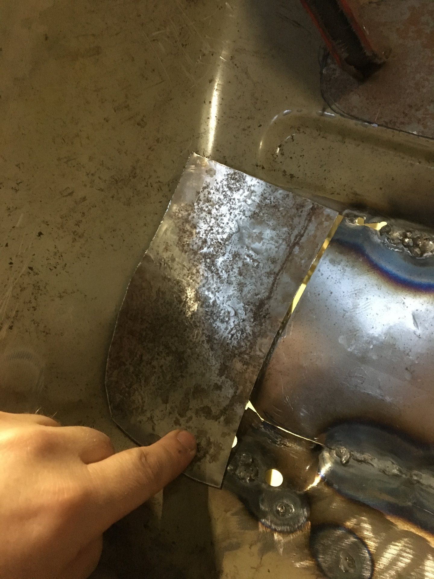

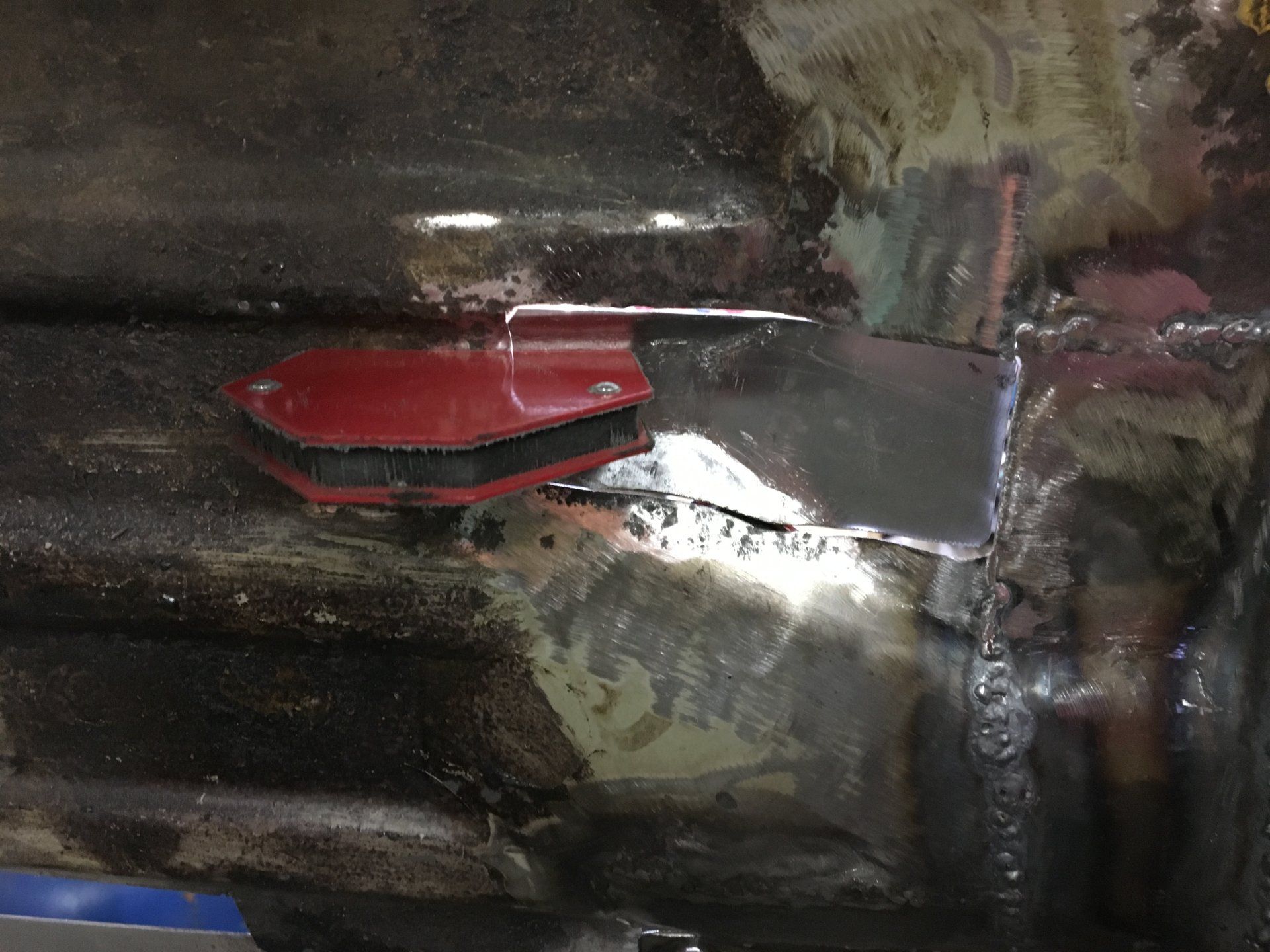

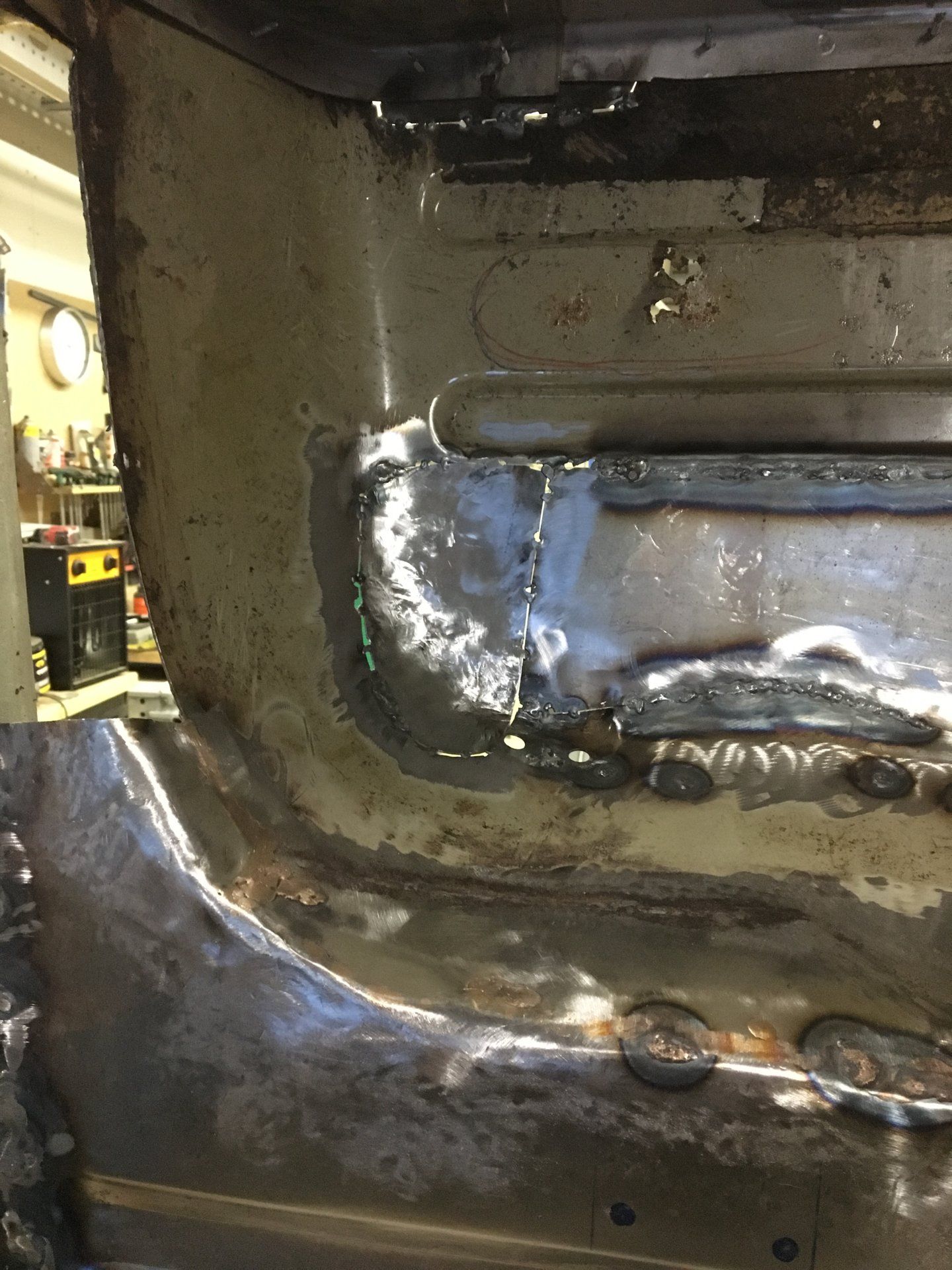

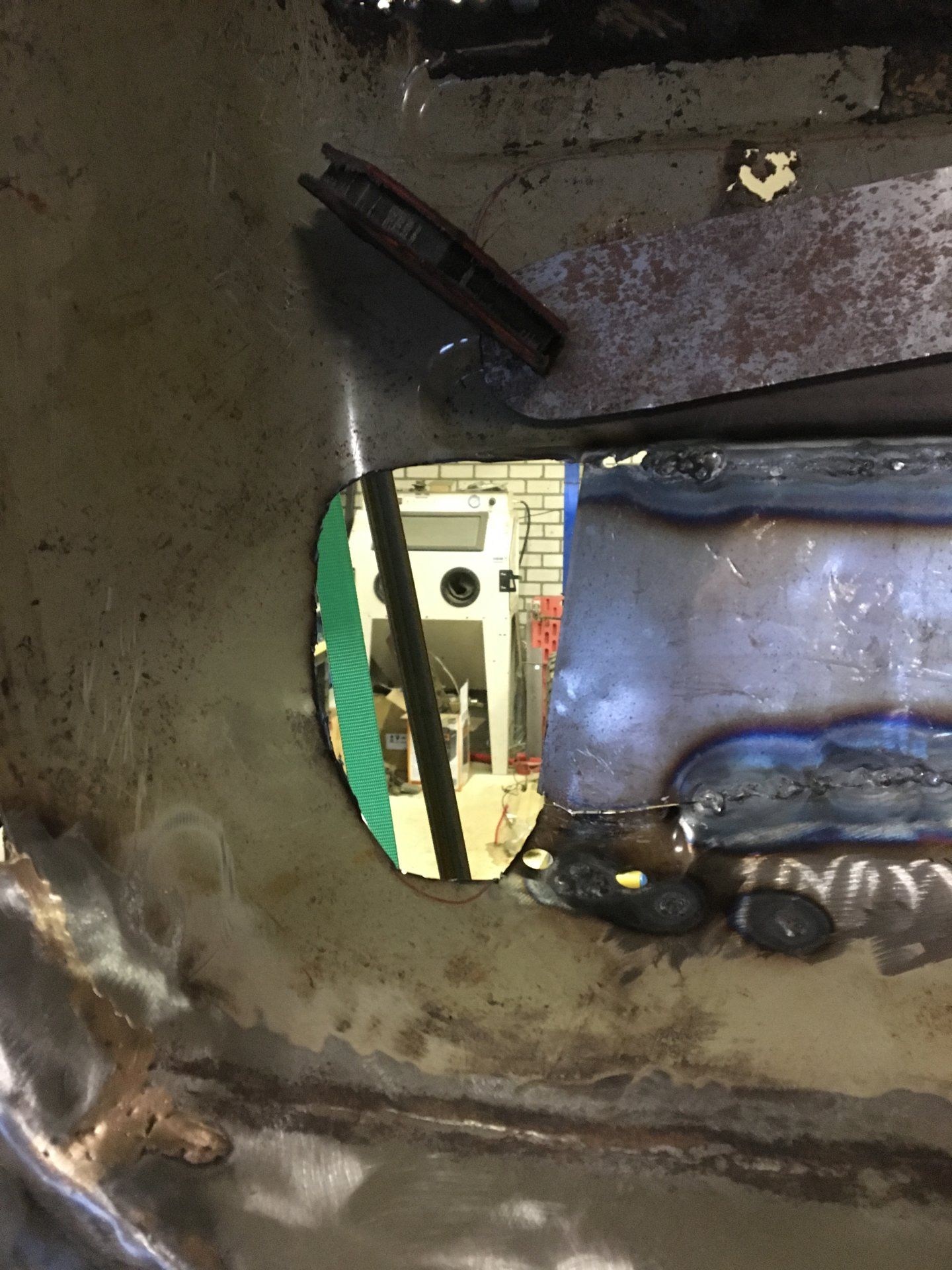

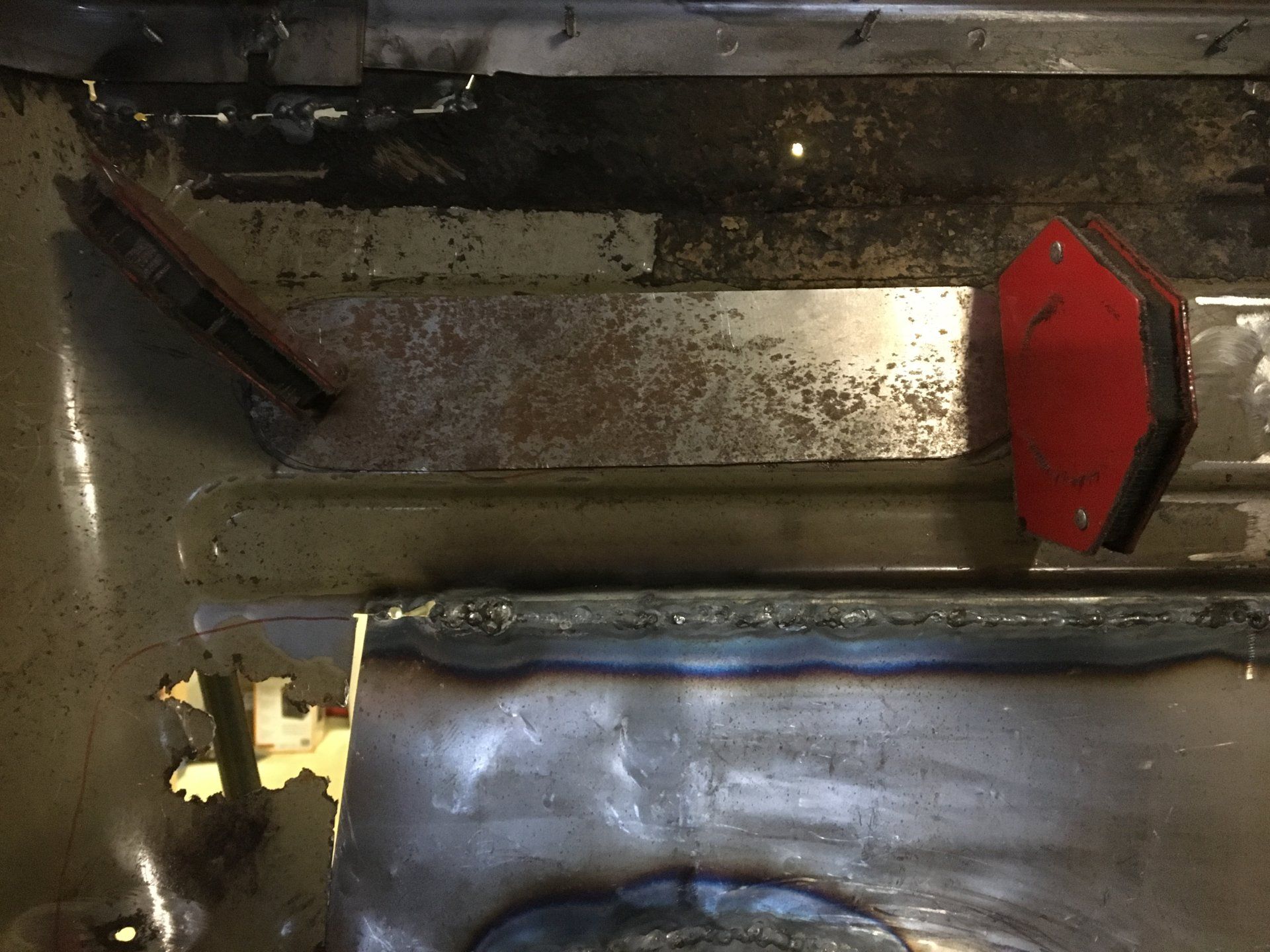

Recreating the heat shield bracket,
1925001
1925002
Had to run an errand for my wife and she let me go by myself. There happend to be an addult playstore close by and I packed up this item on the way.

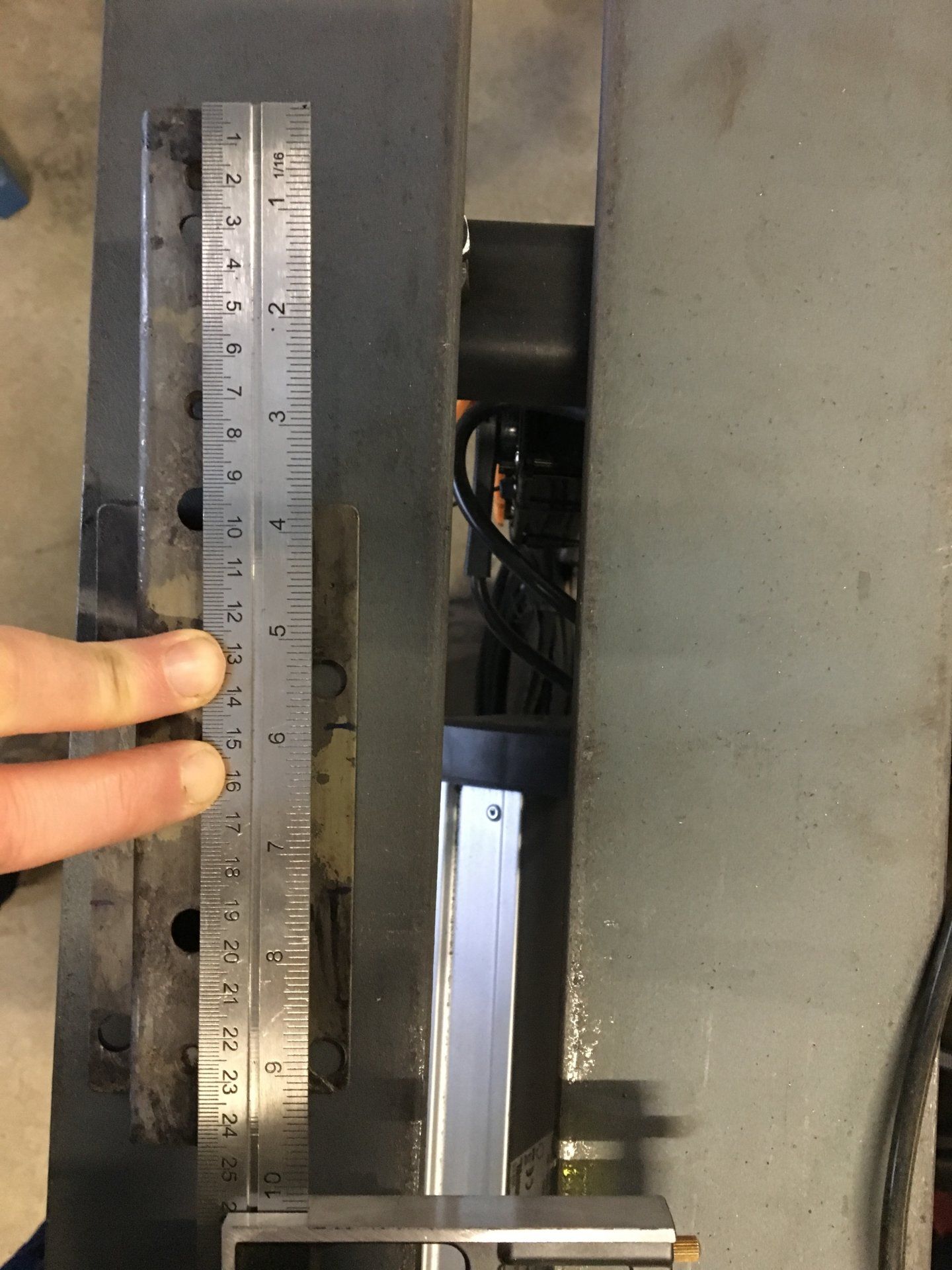

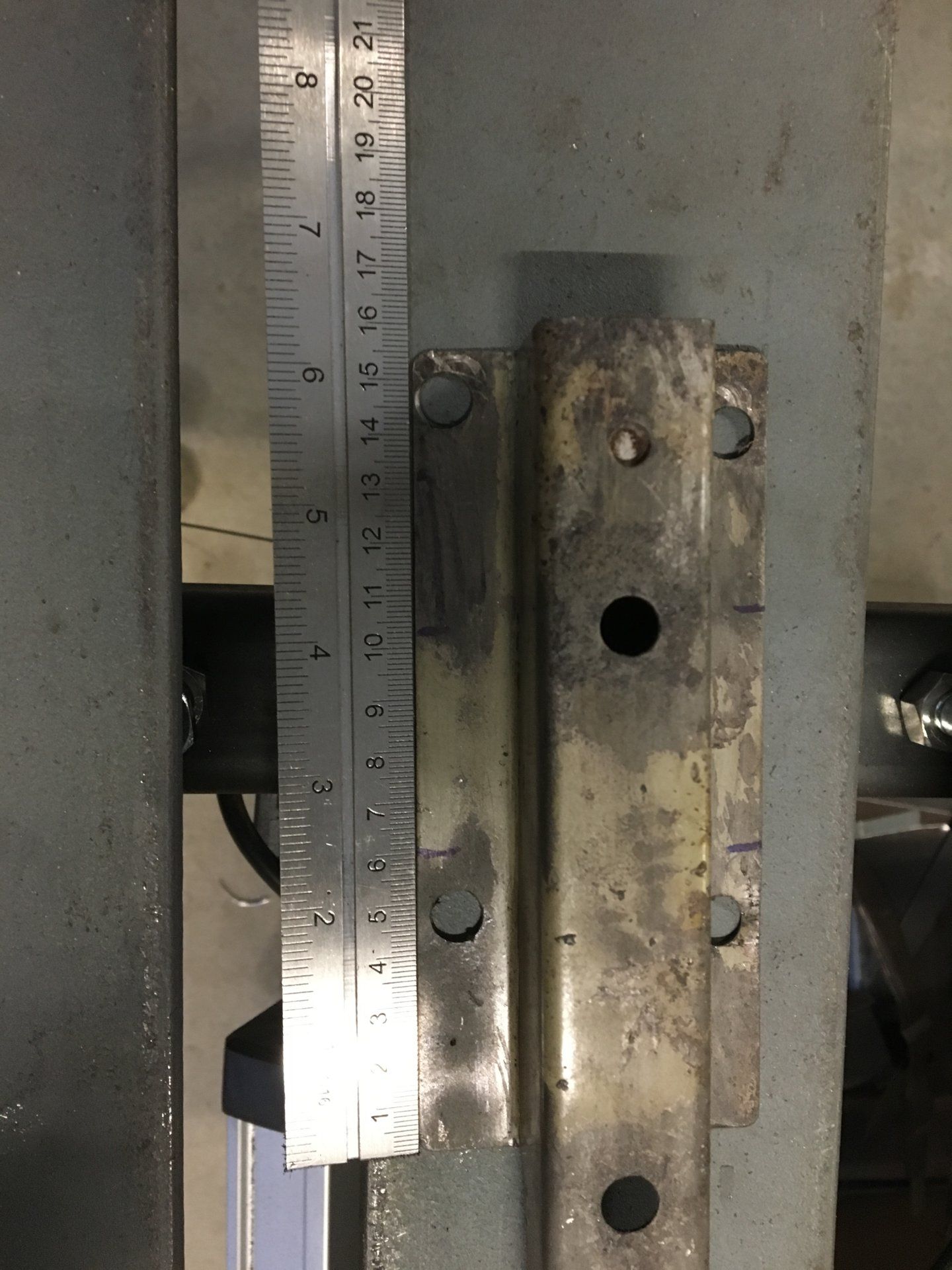

Excellent work. I need to make that heat shield bracket aswell as my 40 was missing it. Do you have the dinensions of the original?
I will try and measuere it this evening when I”m there.
This should cover all sizes (in cm)
Not able to make a drawing at the moment, let me know if this works for you. If not I can make drawing later.

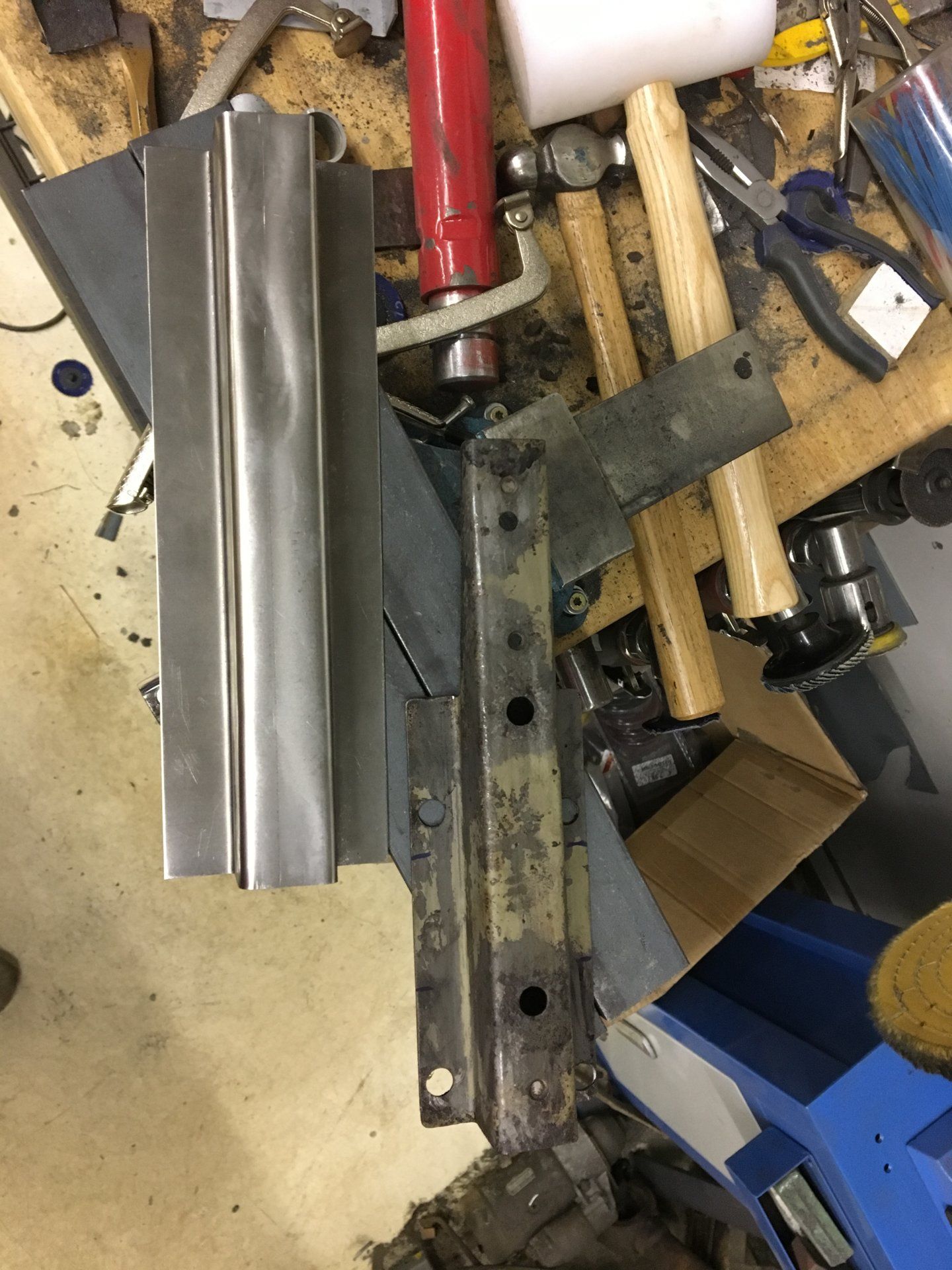

Spend some time cleaning and reorganising, still difficult as the tub is hanging in the middle if the shop.
Started with the jig today, cut some steel for the main frame. It will be bolted together so it can be stored when not in use.
Next up is some pieces to cut out.
