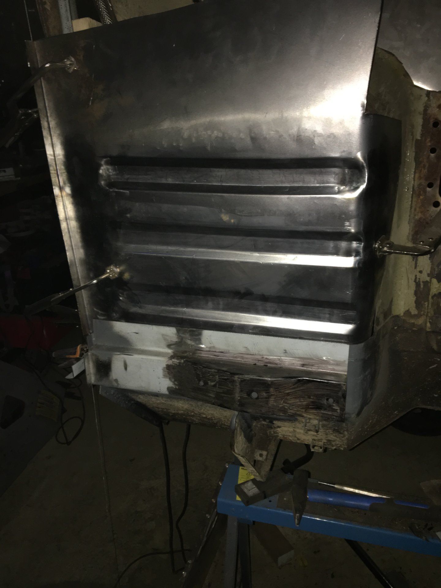

First rib is in, I need to shrink the ends of the rib te straigten out the floor before the next rib.
1901541
1901542
Three ribs in and the distortion is not too bad.
1902400
Floor in its position.
1902398
1902397

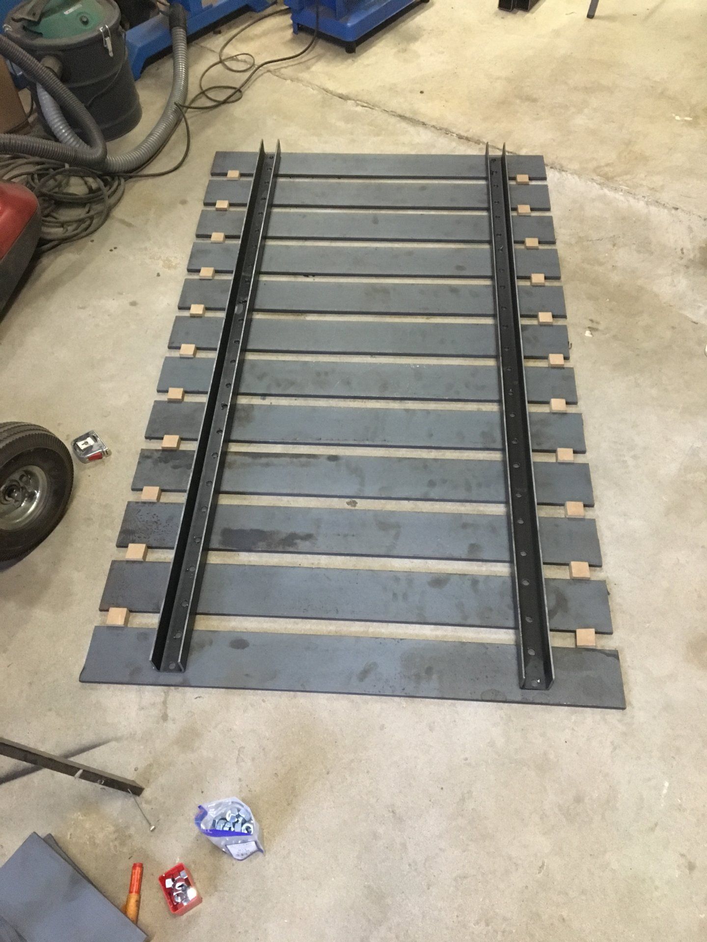

Ordered some steel today for a welding table and a jig.
The jig is going to have the mounting points for the body to make alignment possible.
Elevated points will allign in height.
The jig will also guide the Rebuilding of the frame after disassembly and blasting.
Any of you with experience in using a jig?

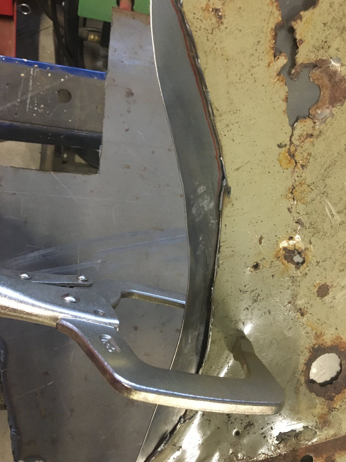

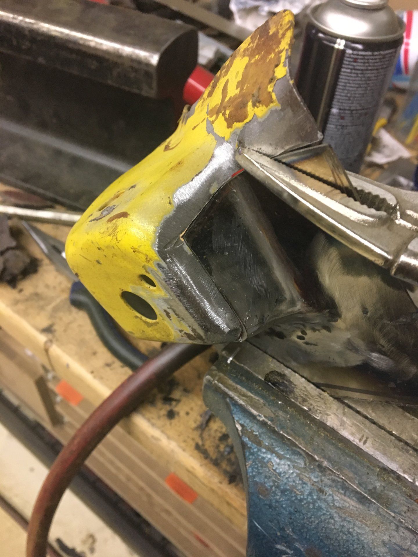

Patch panel under the original steel.
1905331
Made the curve in the patch using the E-wheel.
1905332
1905333
1905334
Two pieces welded together
1905347

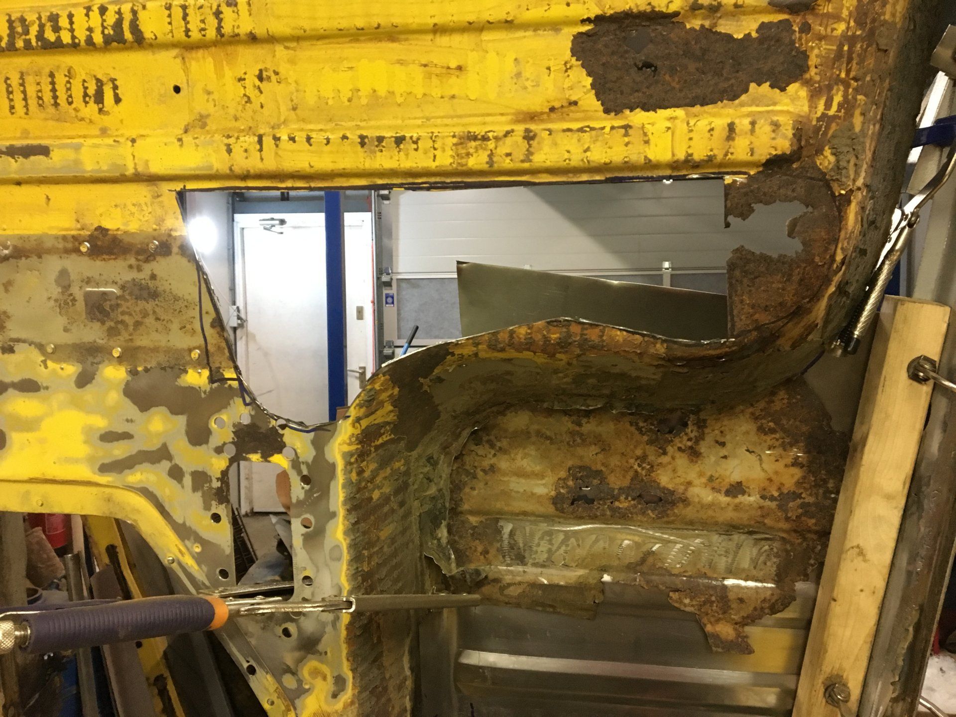

Cut the bad part out and patch made to fit.
1905348
Fixed and fit
1905350
1905351
Only woodworking (dovetails, etc.) and I doubt that would help you.
This is going to be different.
Basicaly building a flat wide frame with cross bars at the body connection points.
Then the connection points will be elevated to the correct hight taken from the manual.
That should give me the needed reference points and the clearence to rebuild the tub.
I’m impressed that you’re cutting and patching all that rust, most folks are leaning towards finding new tubs or going aluminum nowadays.
I like your style, I did the same thing.
Thanks.

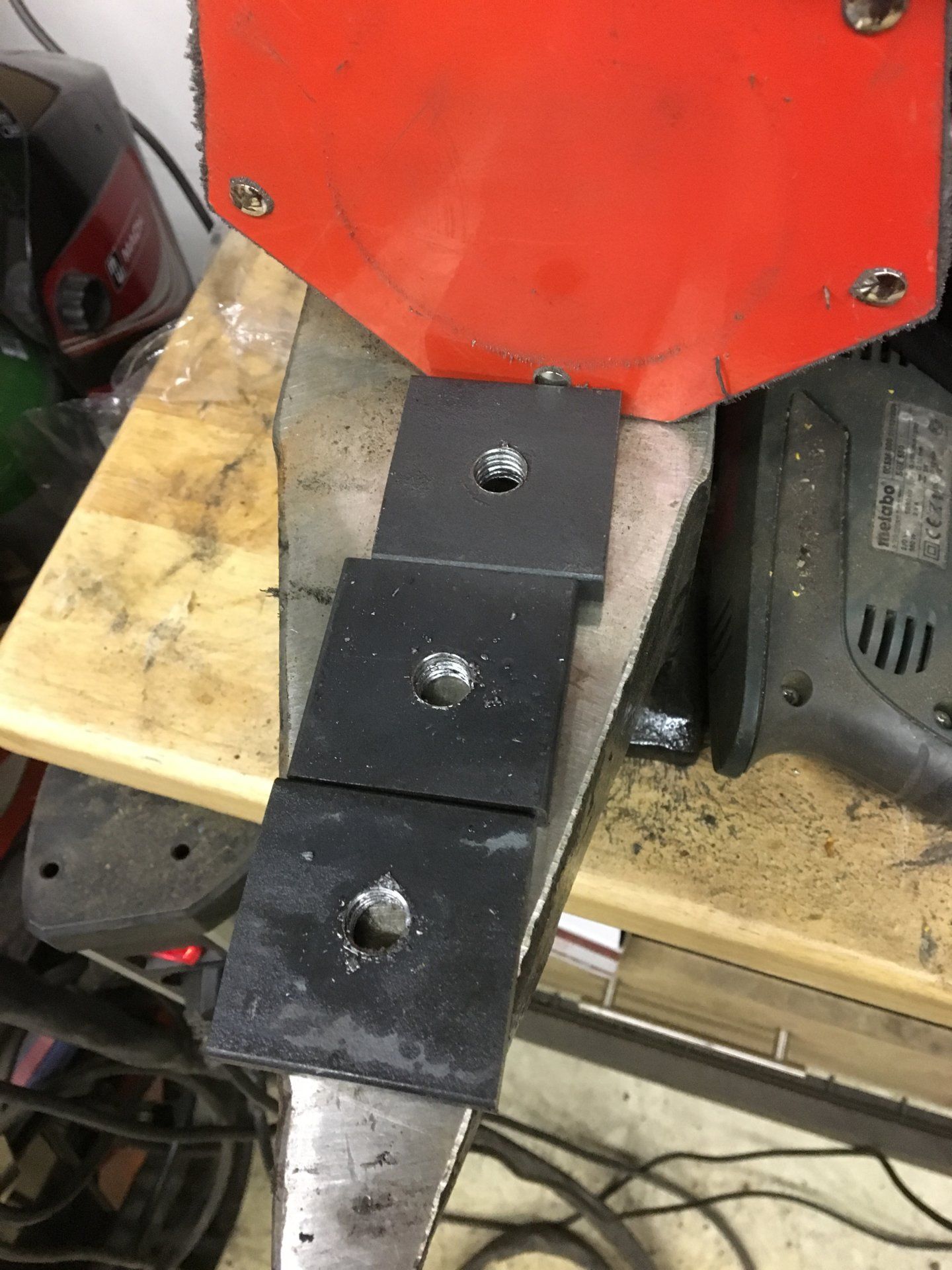

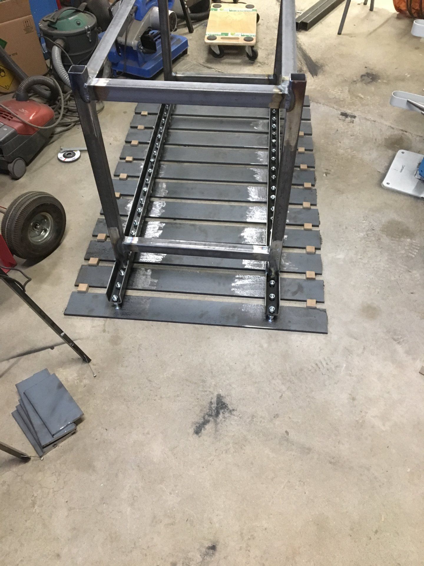

As a side project.
1907259
Drilling, cutting and grinding.
1907260
Adding a few bolts
1907261
And some welding.
1907262
Next is finish welding, add some casters and grind the surface smooth.
