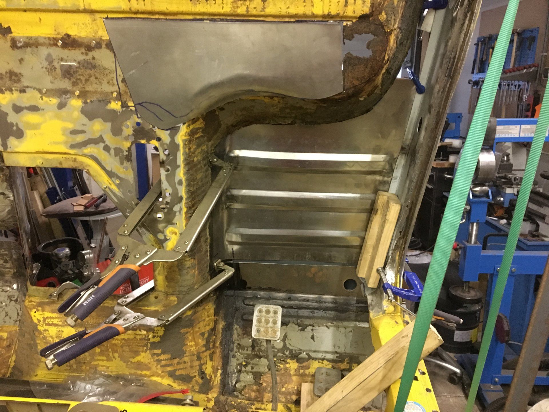

Started with the PS floor patches.

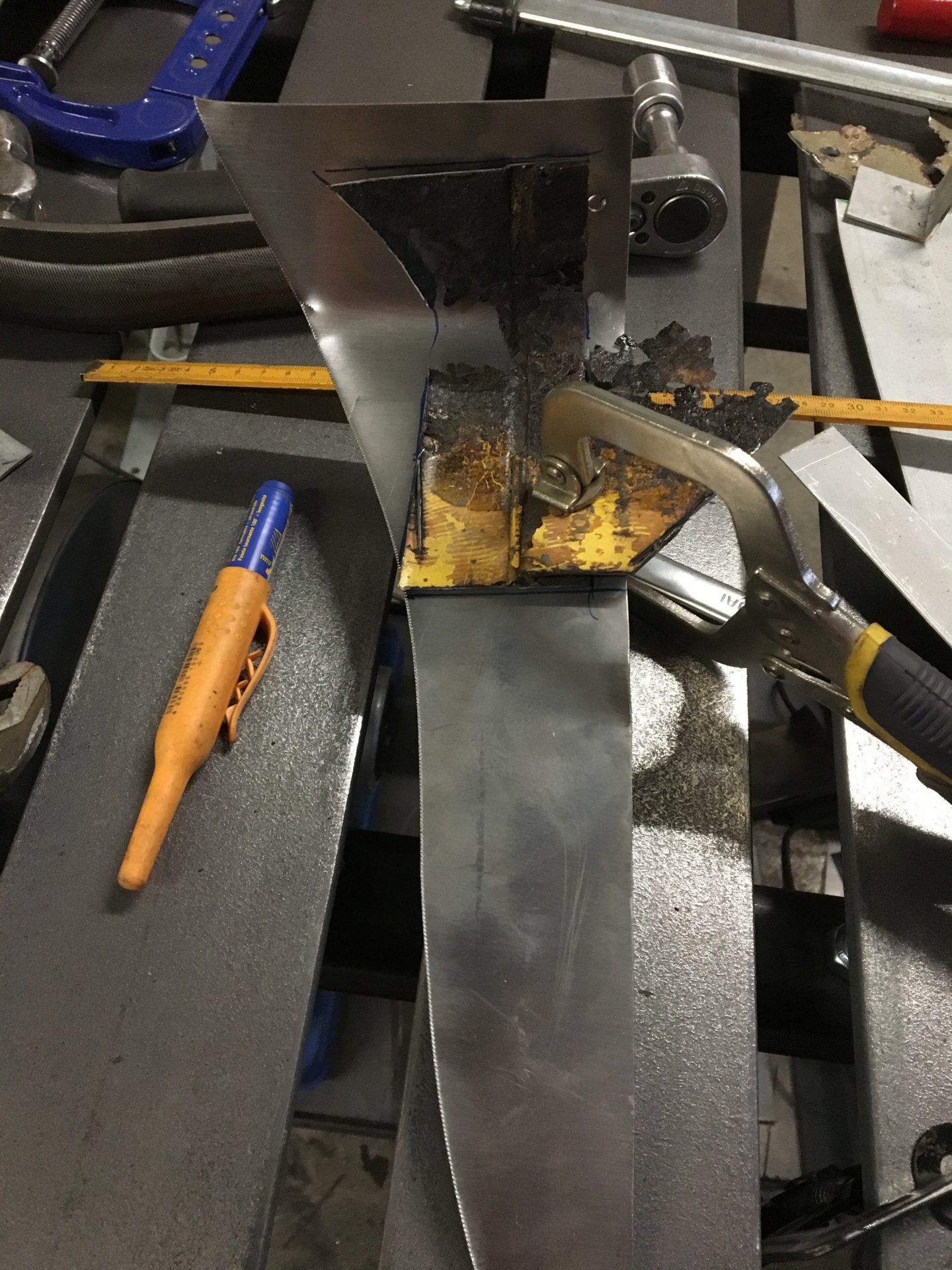

Bending the corner first.
1912692
Not alot of material left.

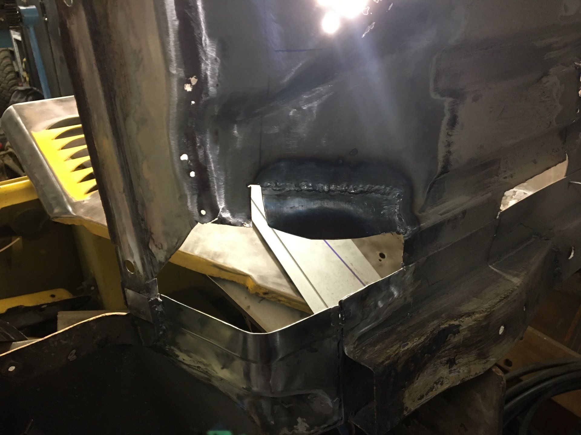

Getting the shape in there.
1912694

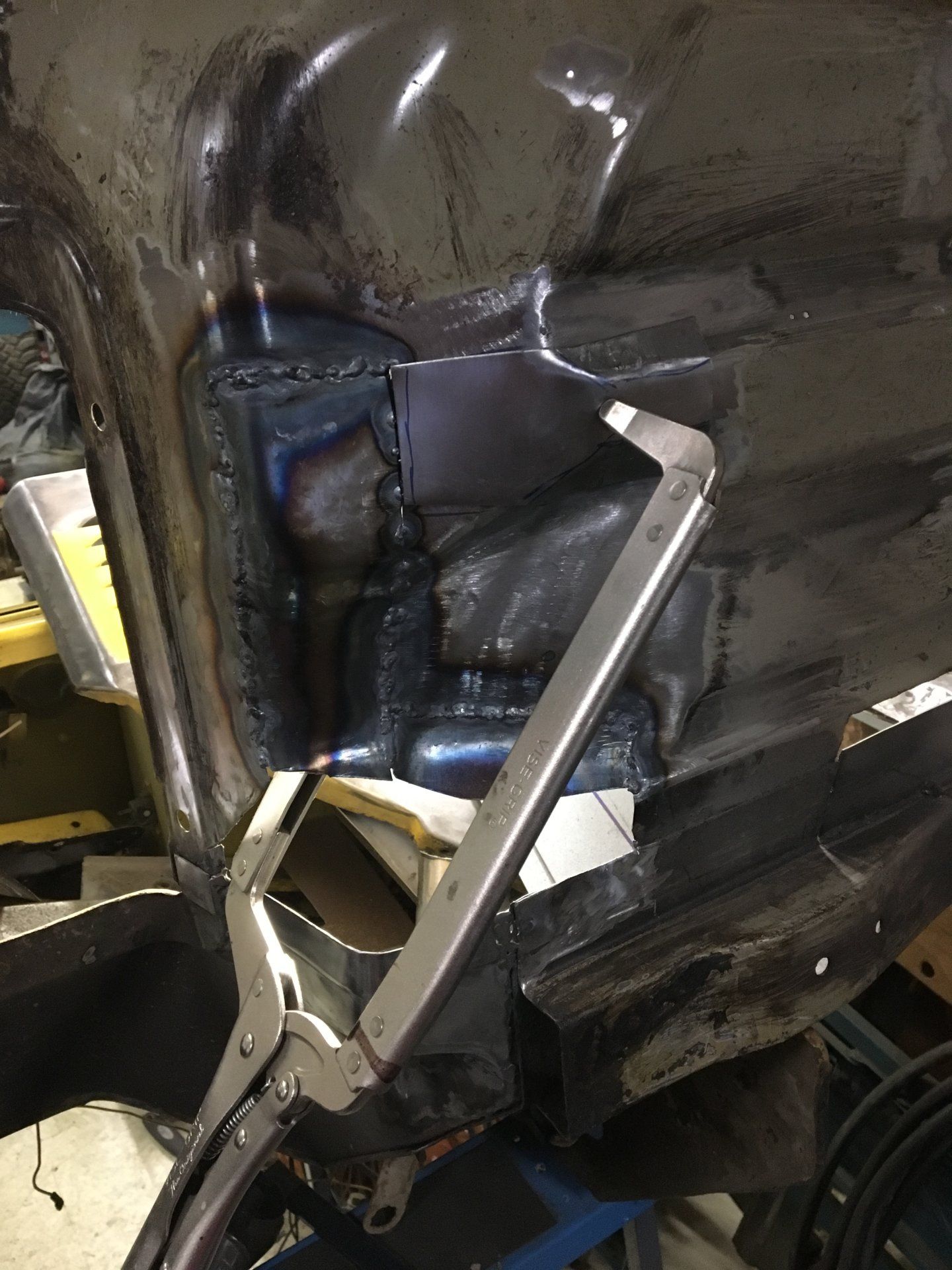

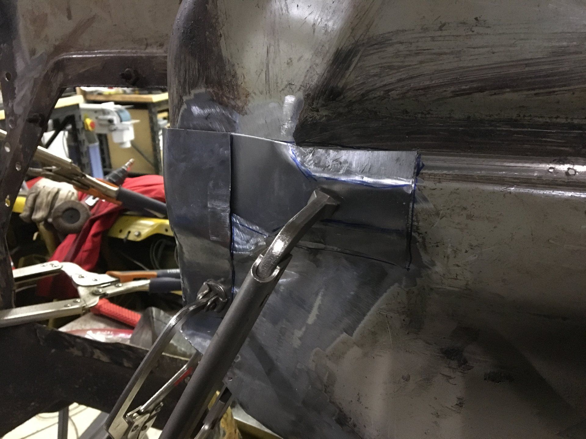

Welded the patch in and fit the next one.
1918538
1918539
And the last patch in position, ready for final fitting and welding.

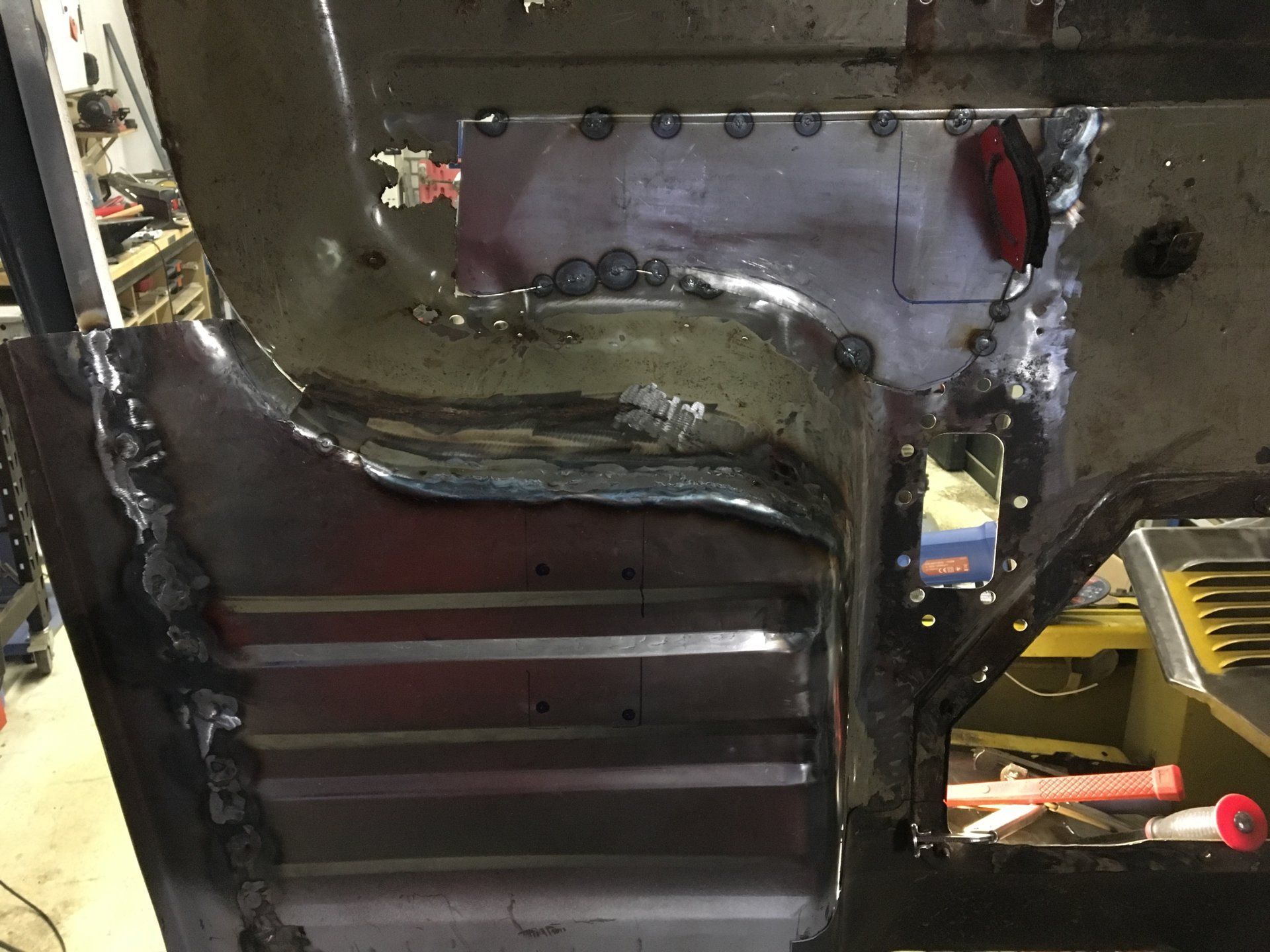

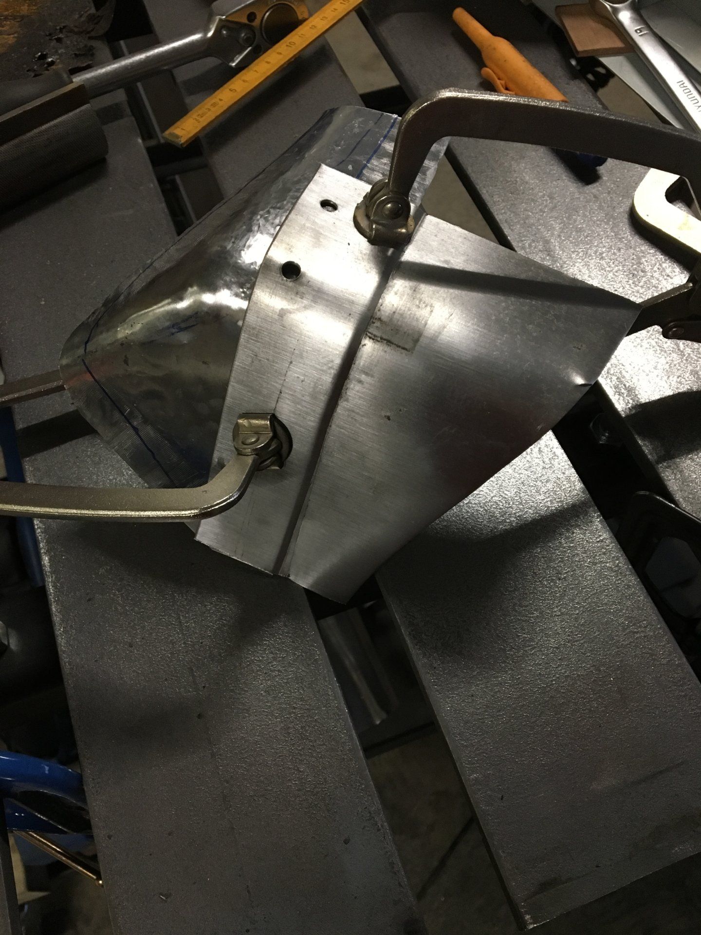

Hi Michael, I have a quick question for you. What's the best way to fold this rounded corner flat? Do I need to cut triangular notches in it? Thanks for your amazing thread.
1918567
Hi Michael, I have a quick question for you. What's the best way to fold this rounded corner flat? Do I need to cut triangular notches in it? Thanks for your amazing thread.View attachment 1918567
Its best to use one of these.
1918636
You can close the straight parts untill you are close to the curve.
If you Don’t have one use a piece of wood on the flat surface and clamp it on.
Slowly hammer the straight sections close. When you aproach the corner slowly hammer the corner close.
You need to shrink the material as you close it, this takes time and has to be done evenly.
Keep the back clamped to the wood to keep the outside flat.
Thanks Michael. I'll look for one of those. In the meanwhile Ill give the hammer and wood a go.
In addition you can grind down the corner 50% to have less material to shrink.
The lip is pretty small, I should be able to shrink it.
