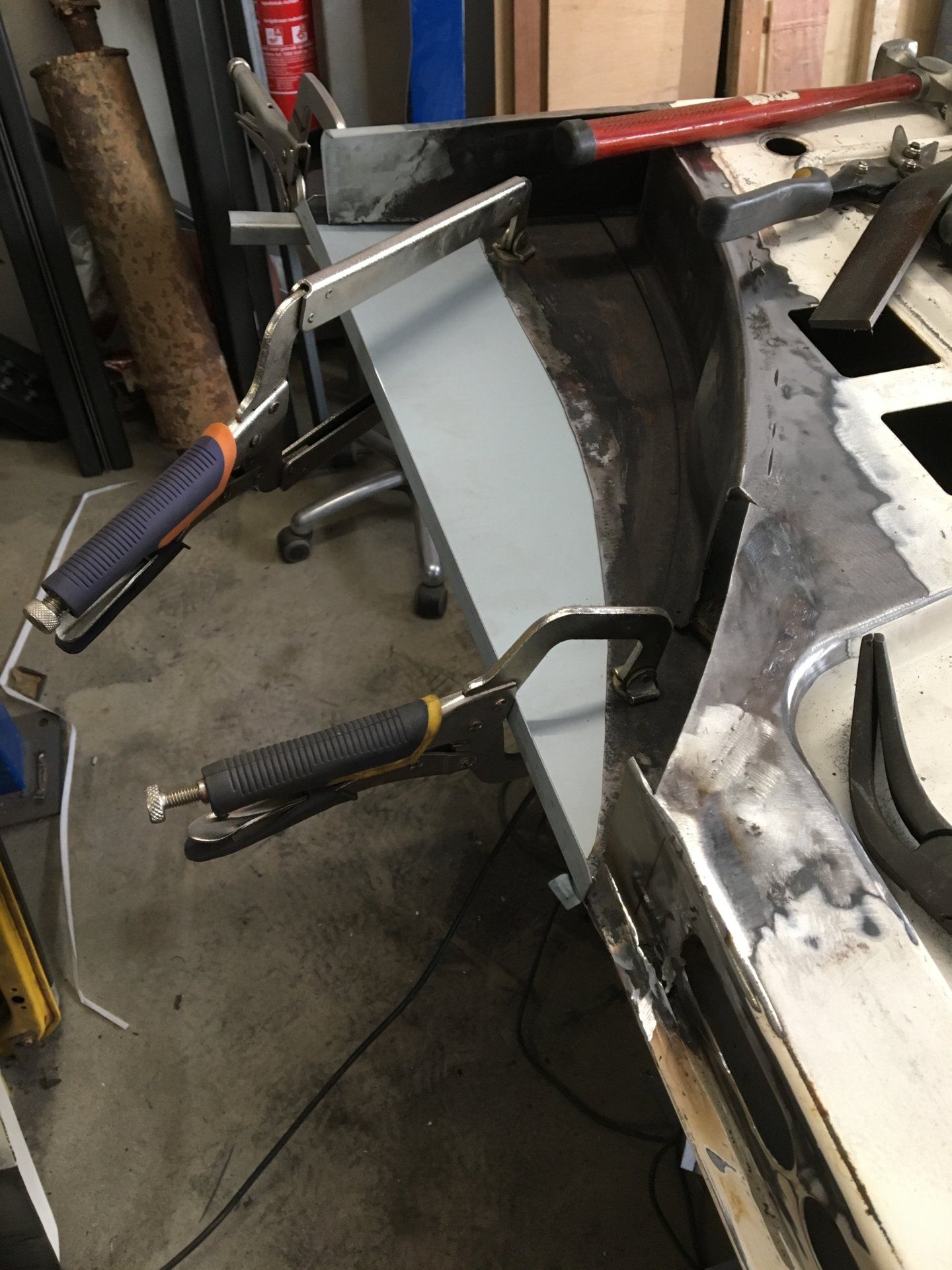

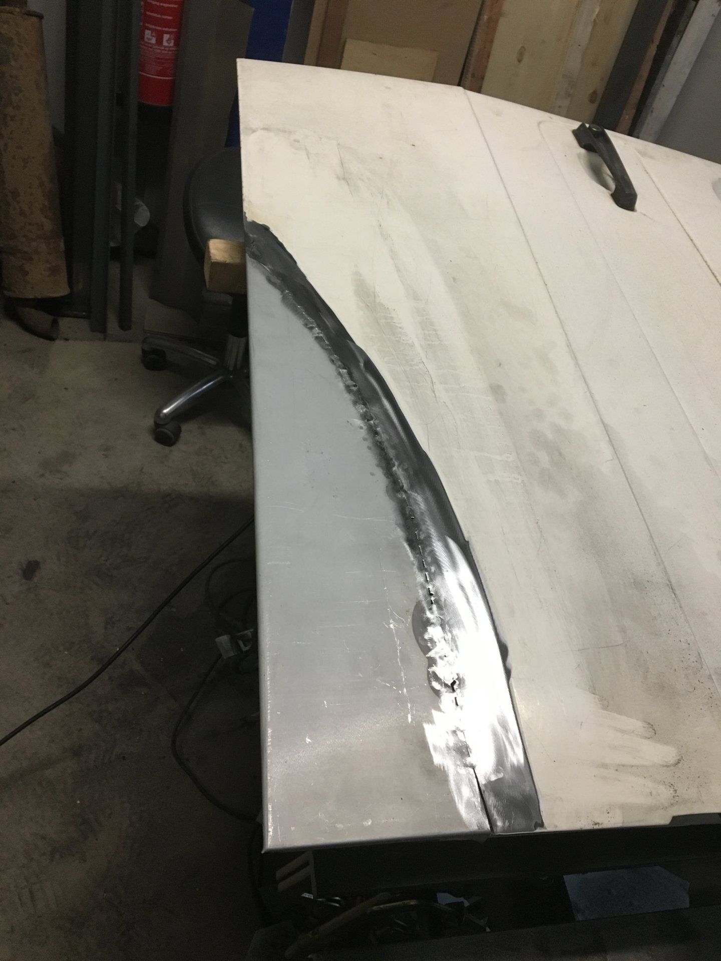

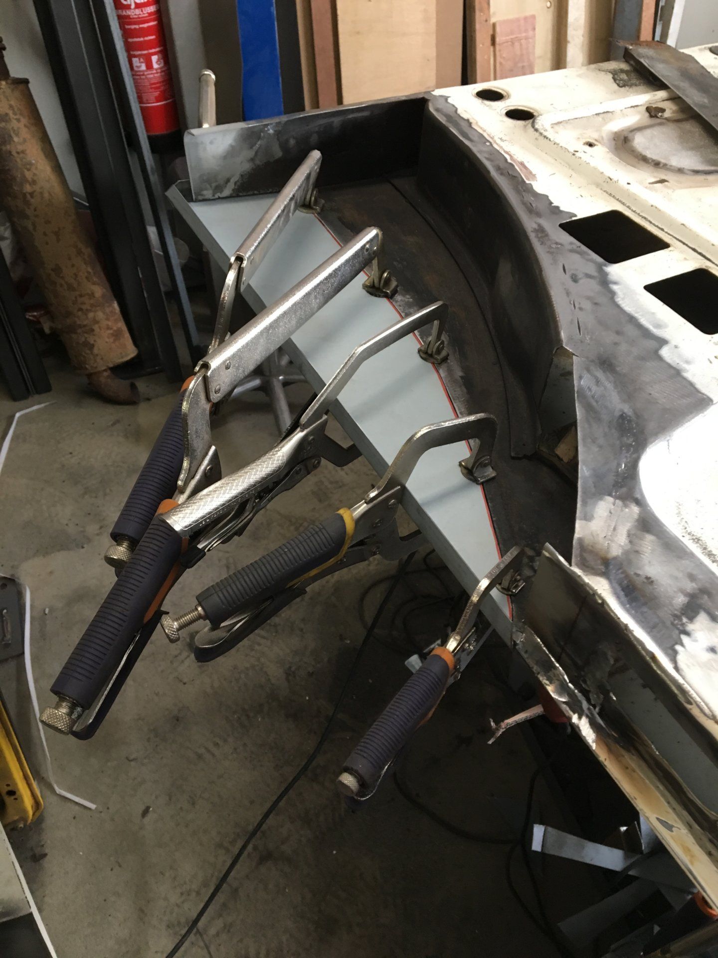

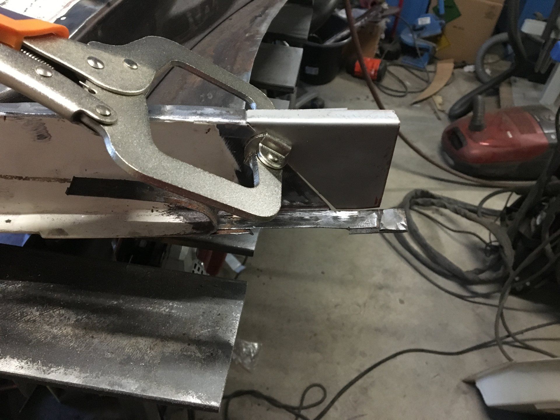

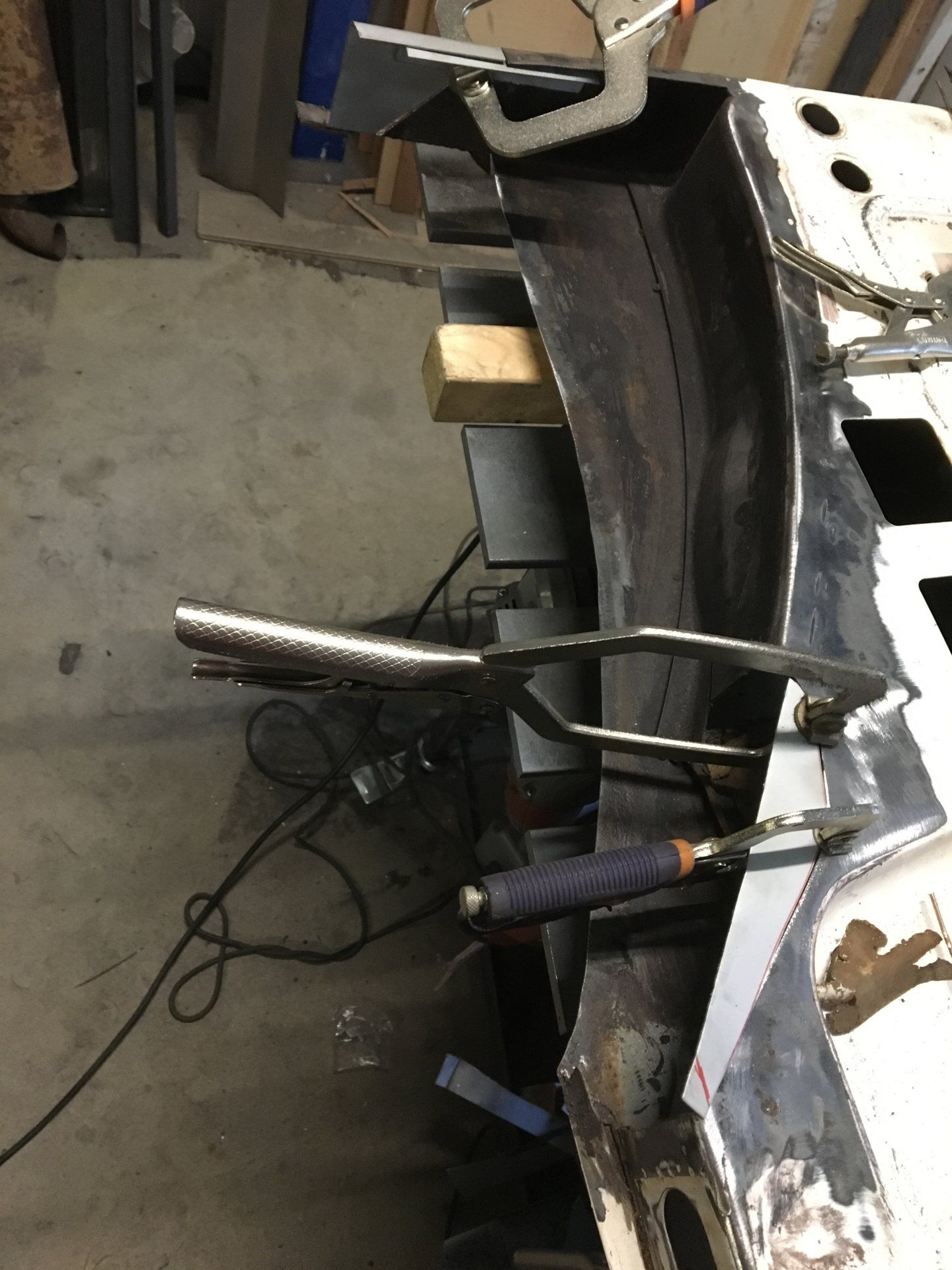

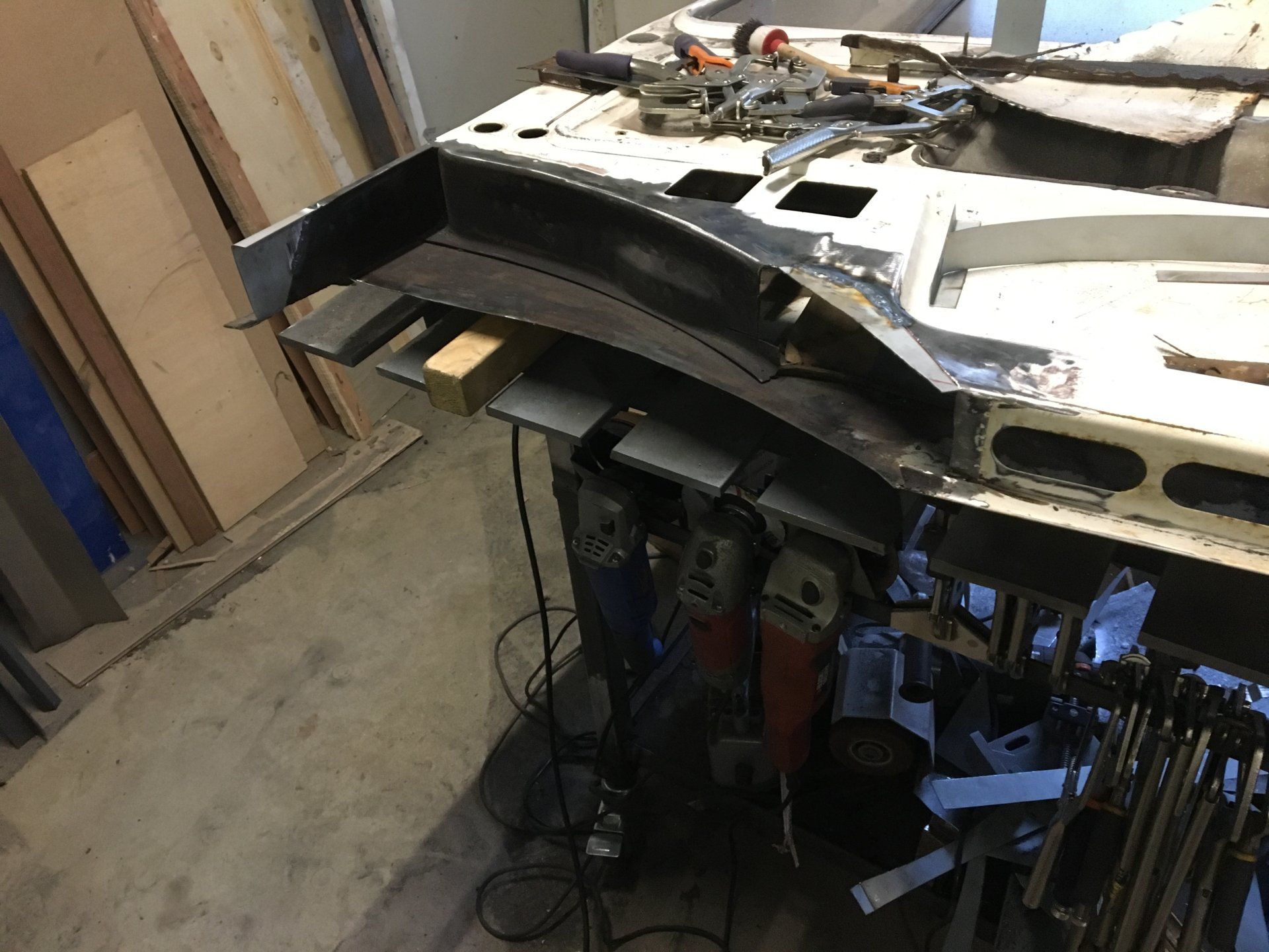

Now some pic of door number 2.

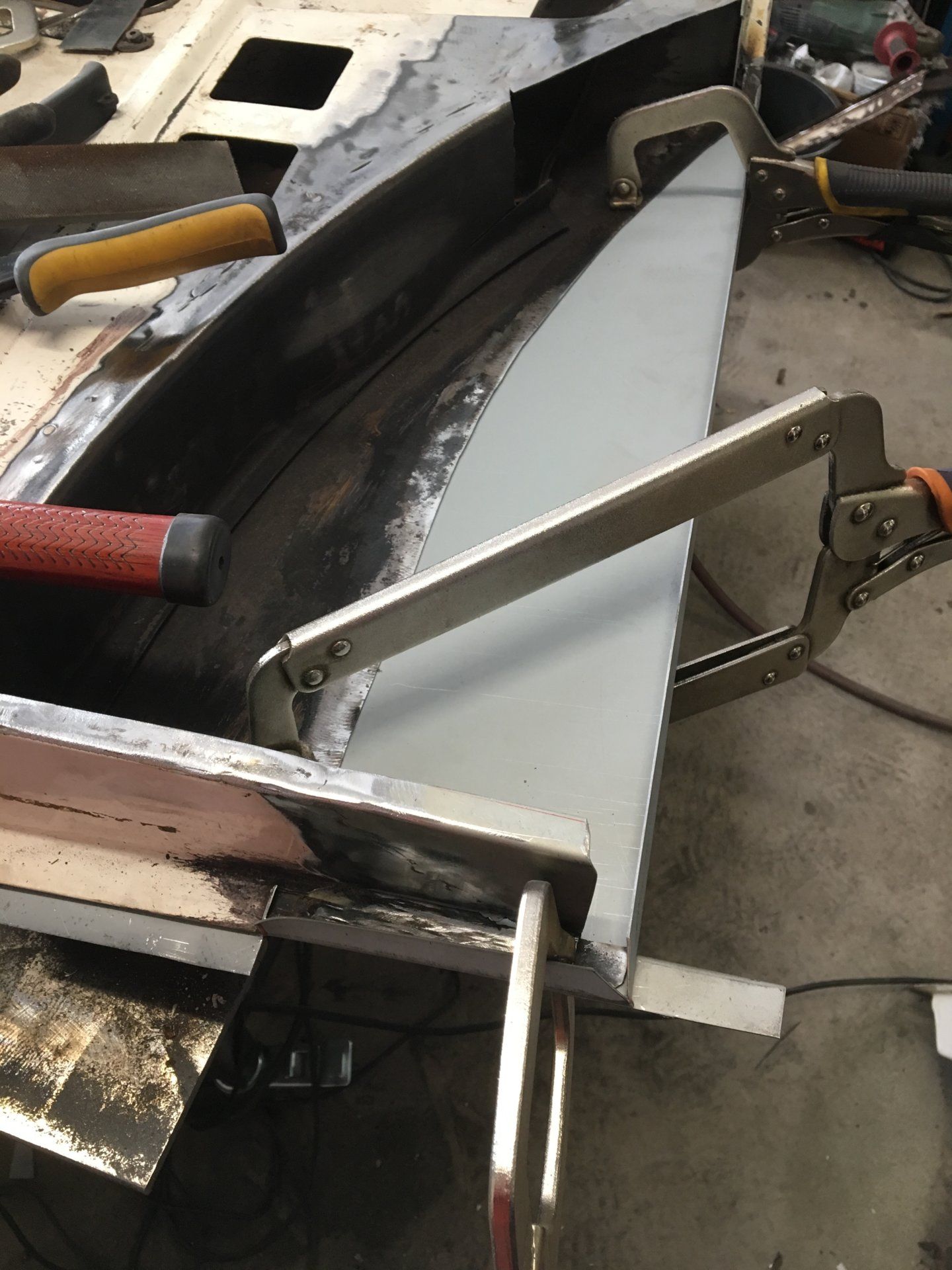

Cut out all the bad parts and prepped the smaller patches and welded them in place.

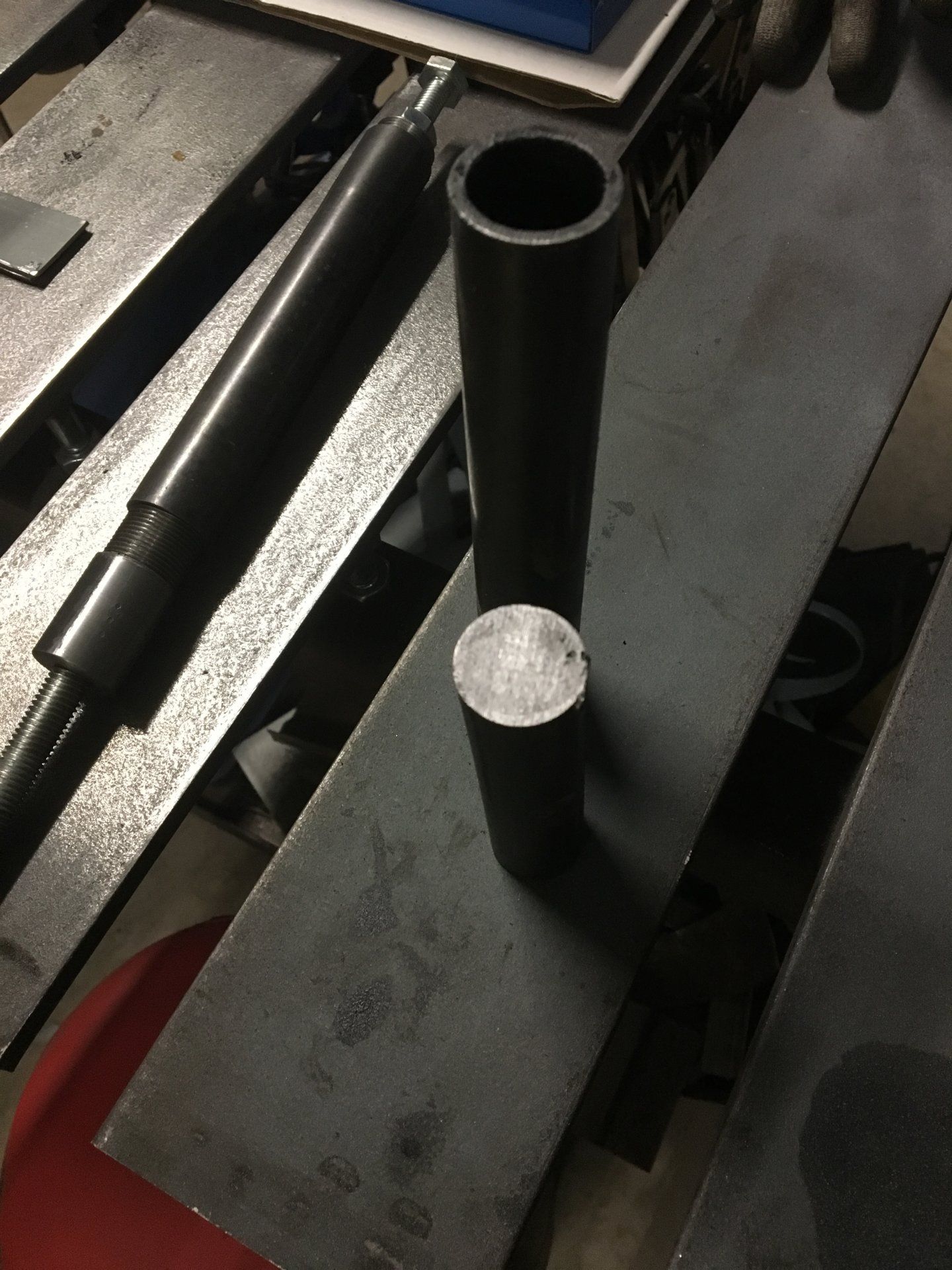

After reviewing my options on connecting the body to the jig I decided that m12 was a bit weak for height adjustment.

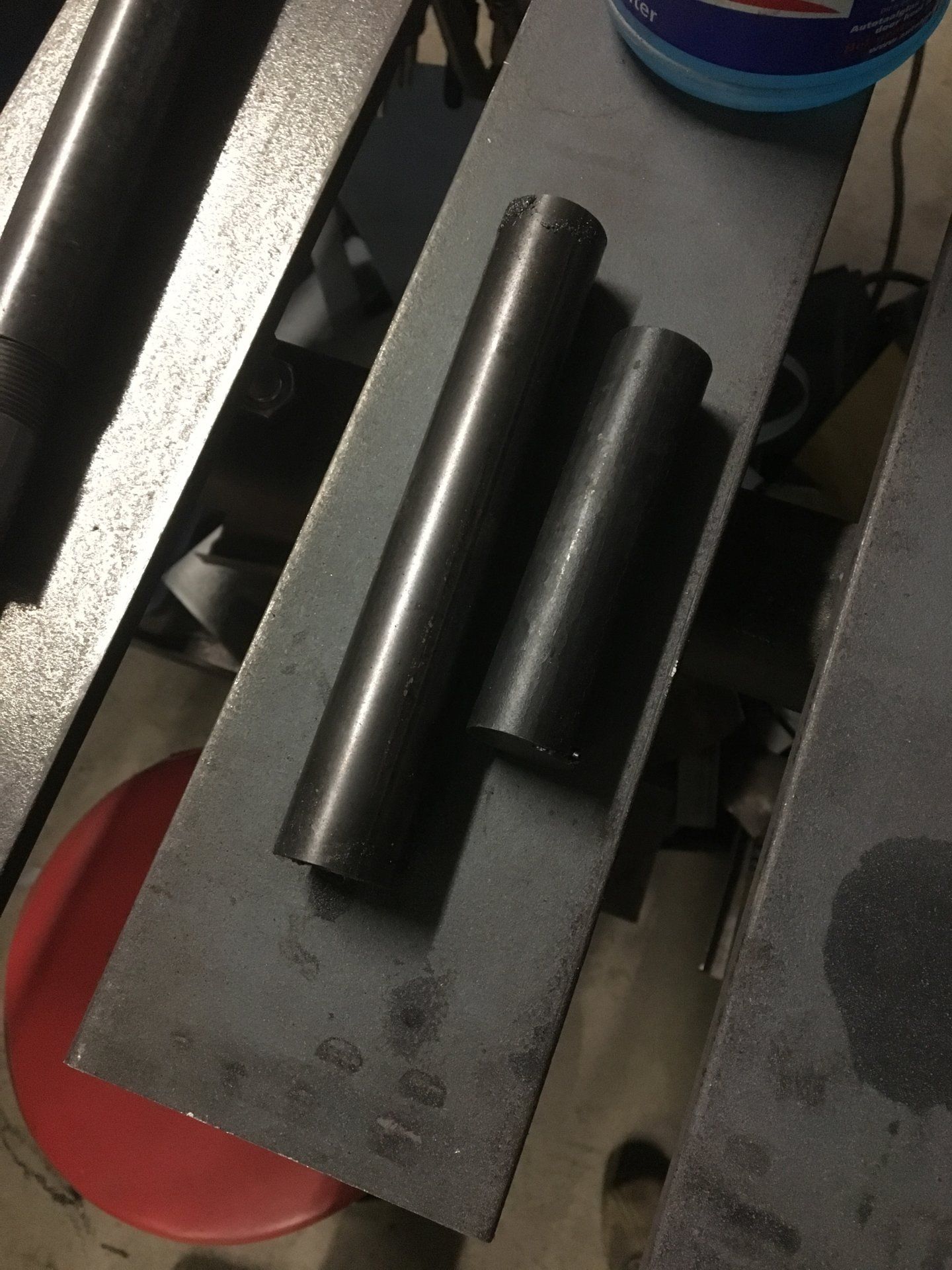

Found a tap & die set that included fine coarse m24.
Cut some 25mm shaft, turned it down to just below 24 and run some threads. Next I cut some tube wit 22mm inner hole opened it up to 22,5 and run the tap about 50mm throug it. Run the tap about 20mm through the other side too.
On one side, the non treaded side, I drilled an tapped a 12mm thread and on the other a 10mm thread.
Cut about 20mm from the threaded, 10mm side, cleaned it up and turned it in the 20mm side of the tube.
The other part is going in the opposite, bottom, side.
M12 will be mounted on the jig and M10 on the tub.

First one was a test piece next is finding the right lengths and such.

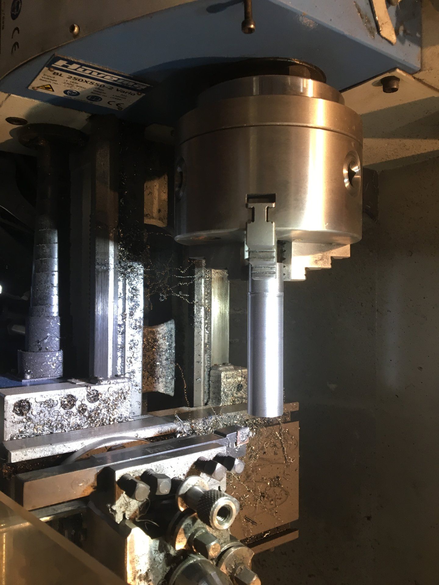

Turning down to correct diamiter.

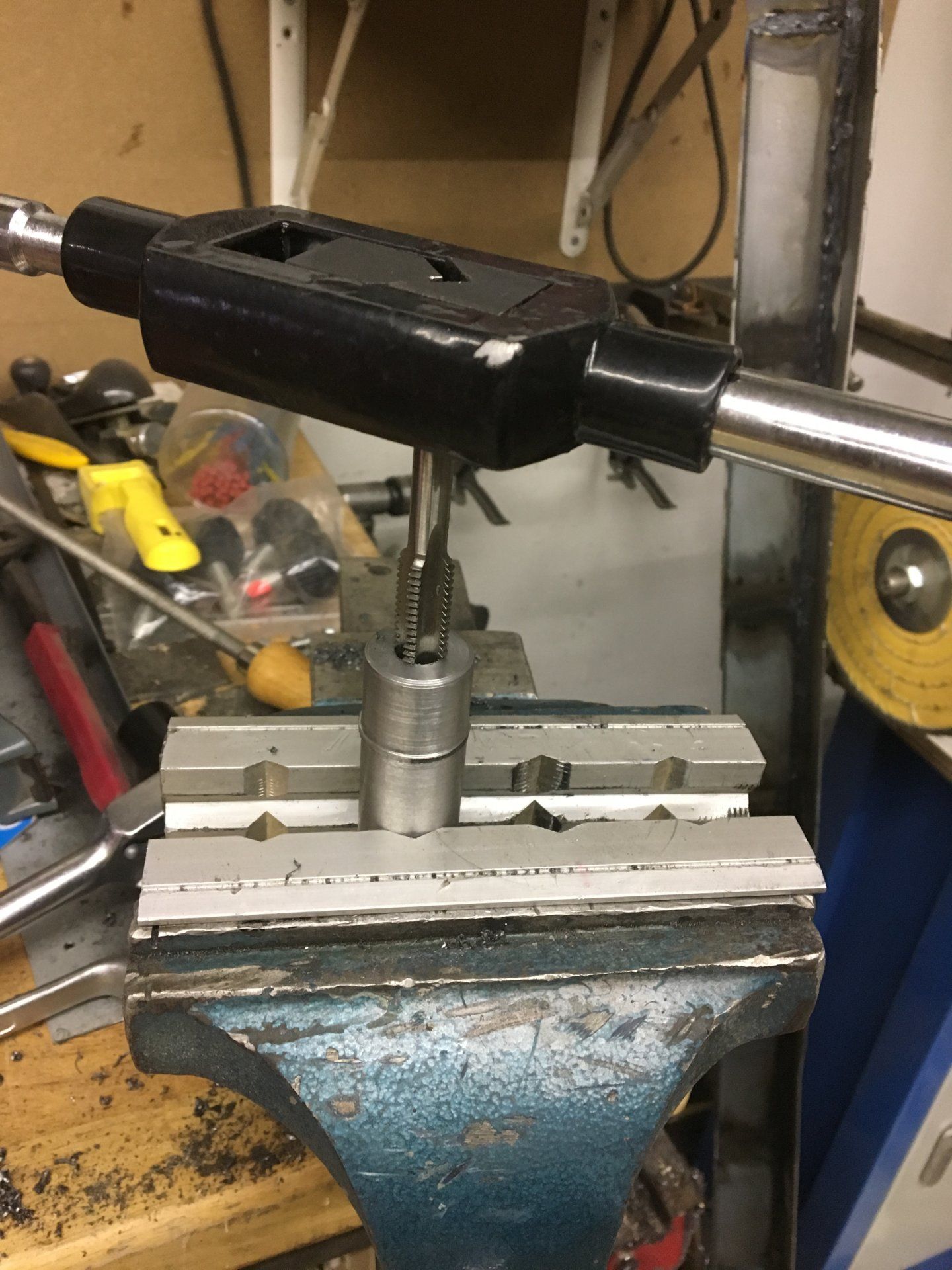

After threading and cutting the to part clocking it again in the lathe.
Tapping the bottom hole M12
And tapping the tube for the adjusting bottom section. It is tough to tap this.😅

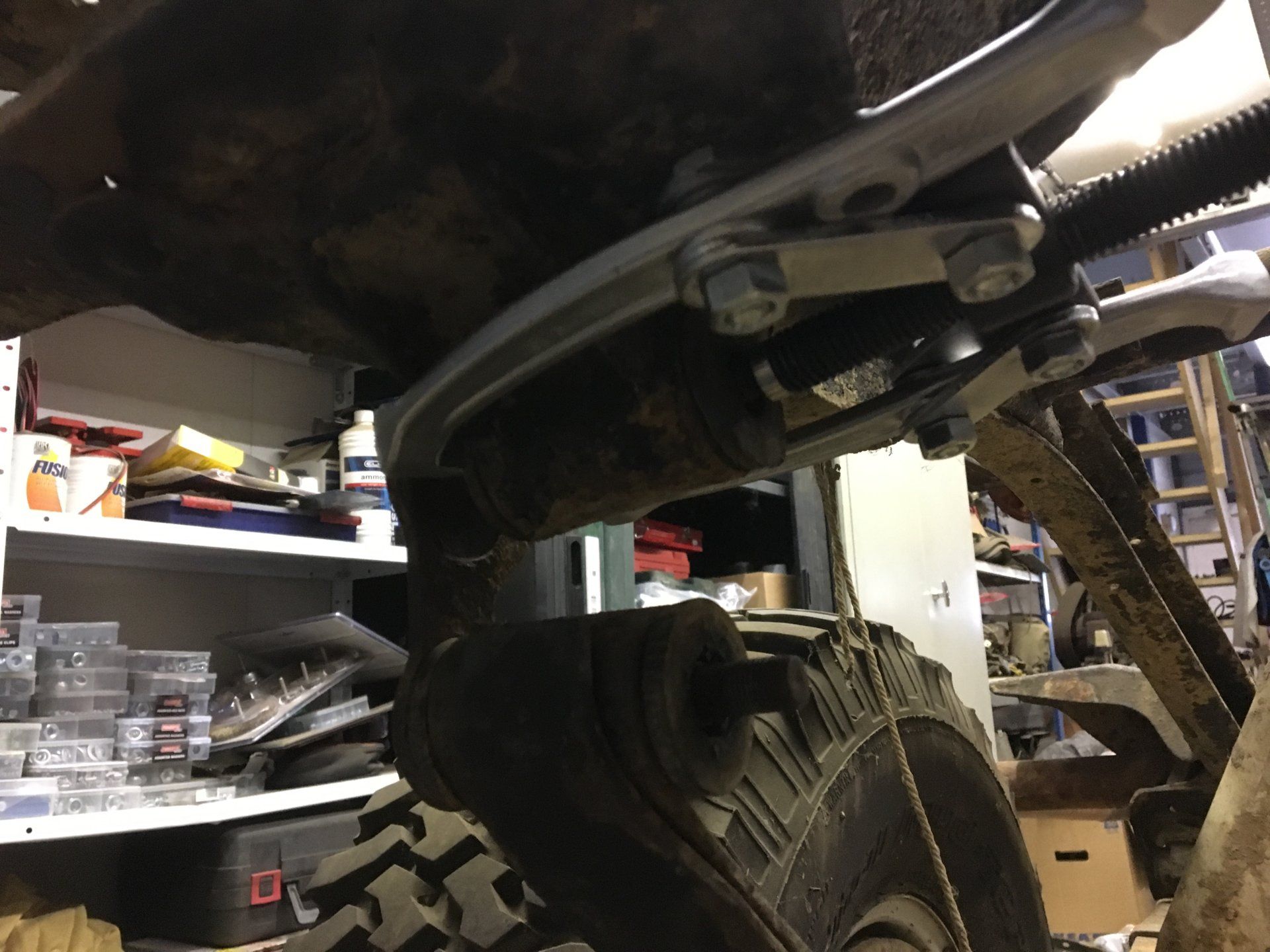

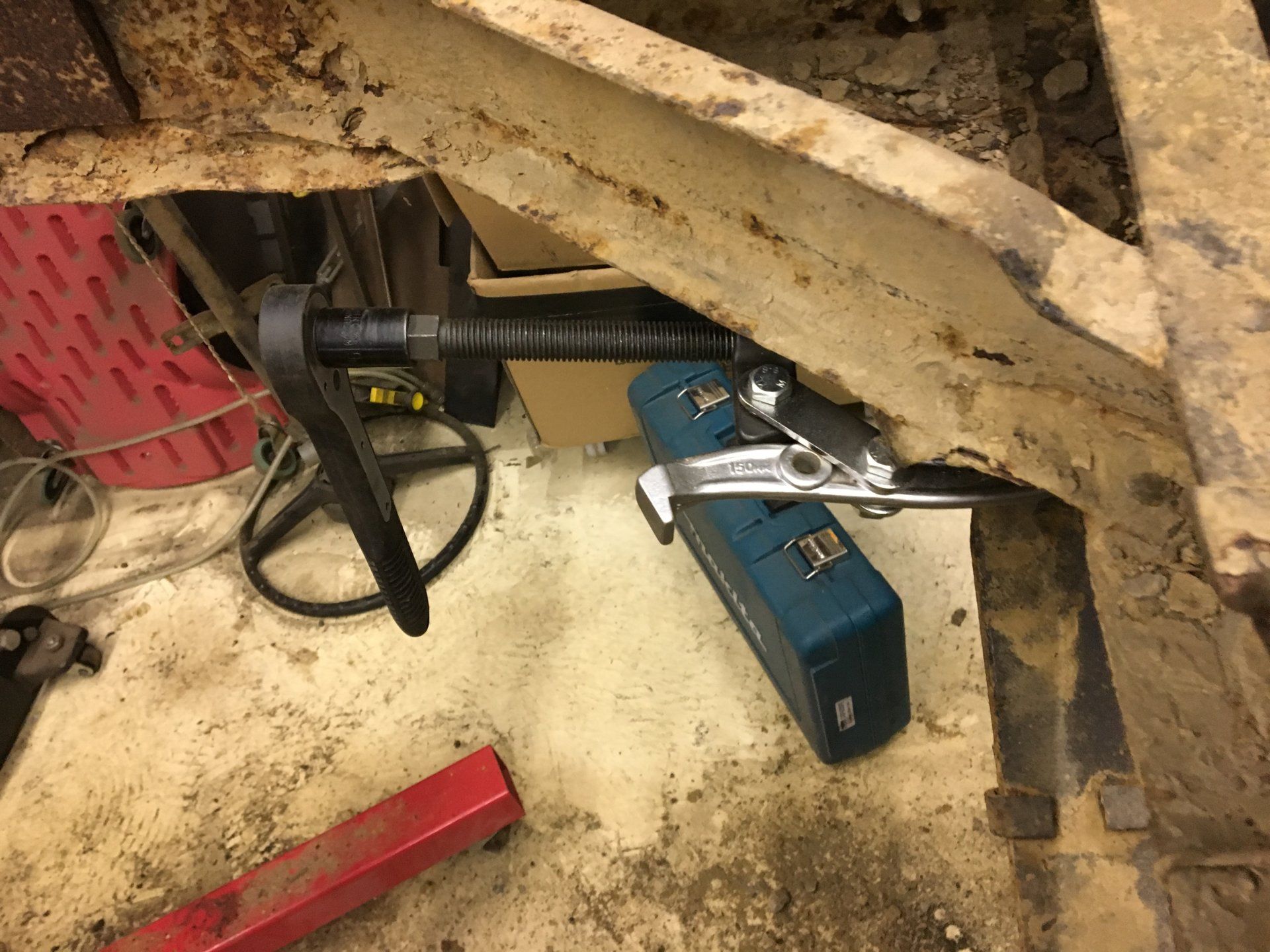

Front springs came off the frame easy but the rear were not moving at all.
I didn’t want the smell of rubber in the shop for several weeks so I decided to try something different.
Used a 2 legged puller to push the pins out of the bushings and it worked like a charm.
The only issue I had was that the puller did not fit on the spring side of the hanger, I had to loosen the U-bolts so the whole spring could move sideways.
There was no movement at all before I used the puller and it came out within 10 minutes without any drama.

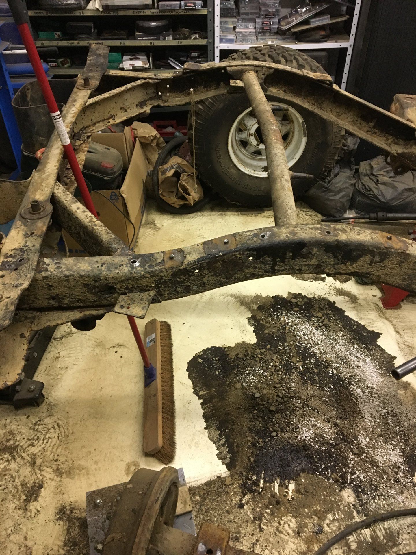

Next step is taking out the rivits.
Not the easiest job but we like a challenge.
It would be so nice to clean this part of the shop and get rid of the gunk inside the frame. Only work with clean parts.🎉
