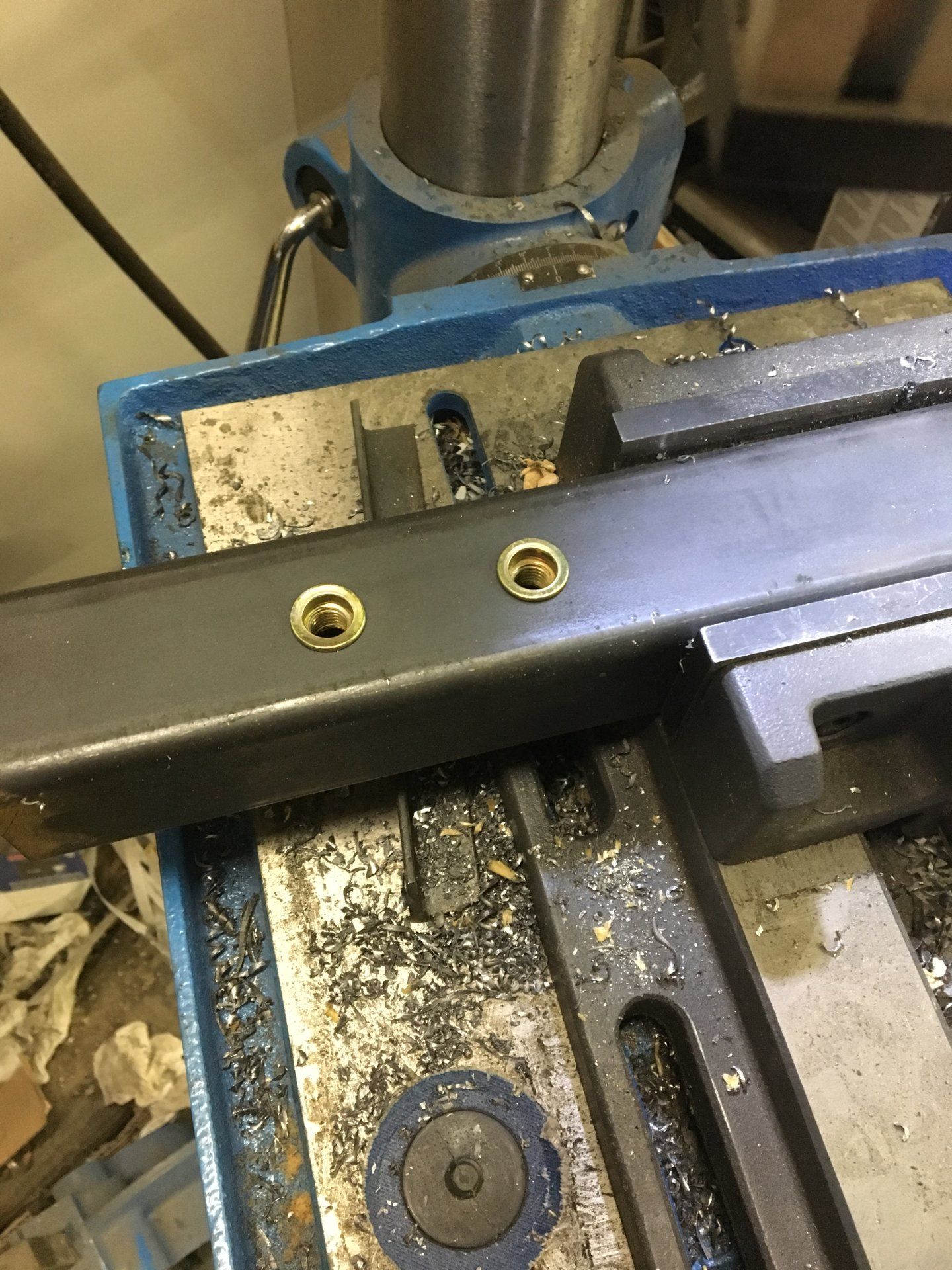

Nutserts in.

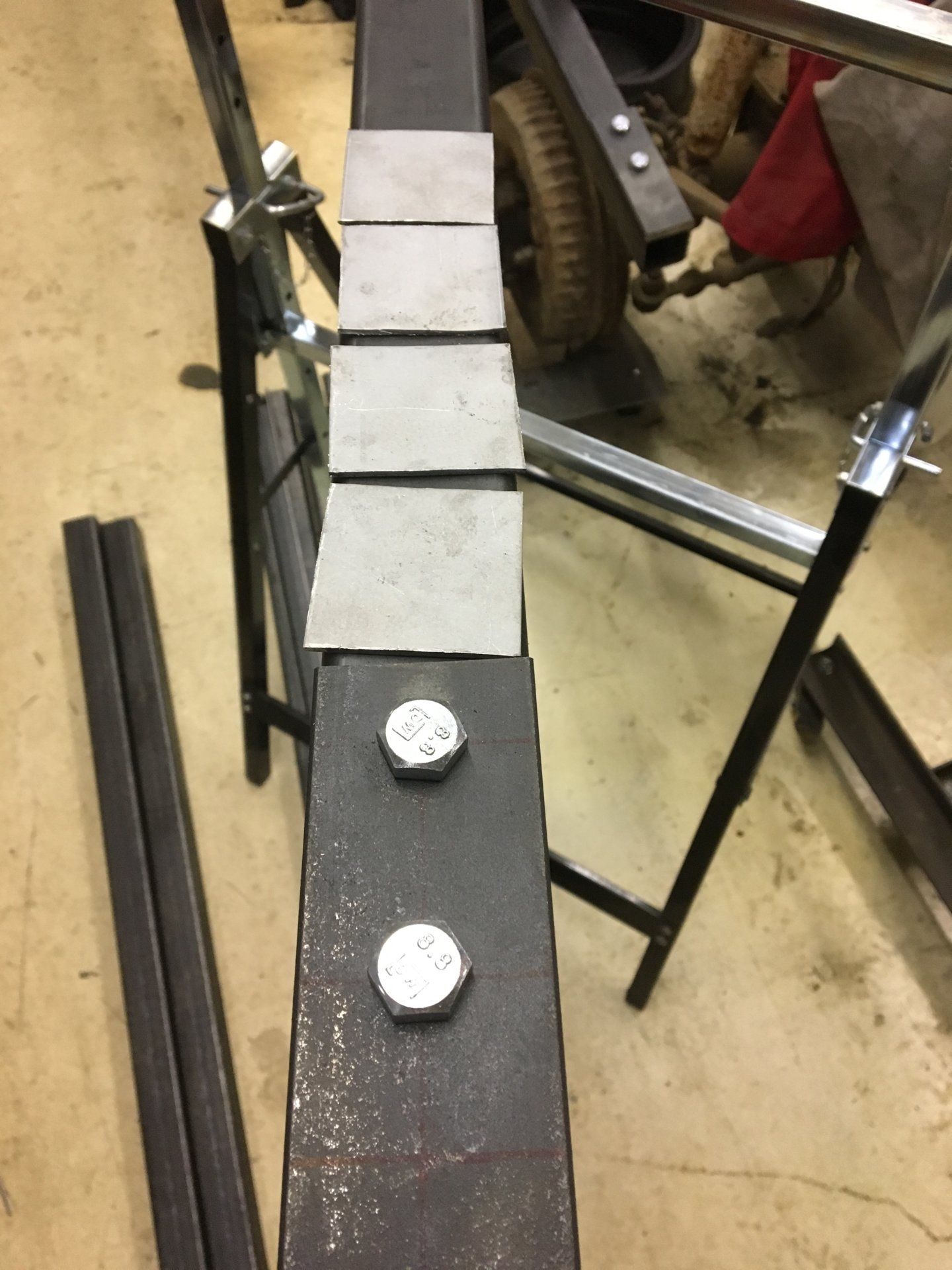

The cross bars, 5 one for each 2 connecting points from tub to frame, will be Attached in a flexible way to make it possible to use it on different vehicles.
The cross bars will get attachment points that can be adjusted in height for the different mounting points.
The tub is going to sit about 10cm plus original difference from 0 line on the chassis.
This way I can build the tub back up off the chassis and it wil fit just on there when done.
An other benefit of this is that the frame will not be in the way of the metal work.
I’m looking at the best way to make the flexible connection between cross bars and frame and mounting points and cross bars. I don’t want permanent connections if not needed but it needs to be solid as it is going to be used on a rotisserie.

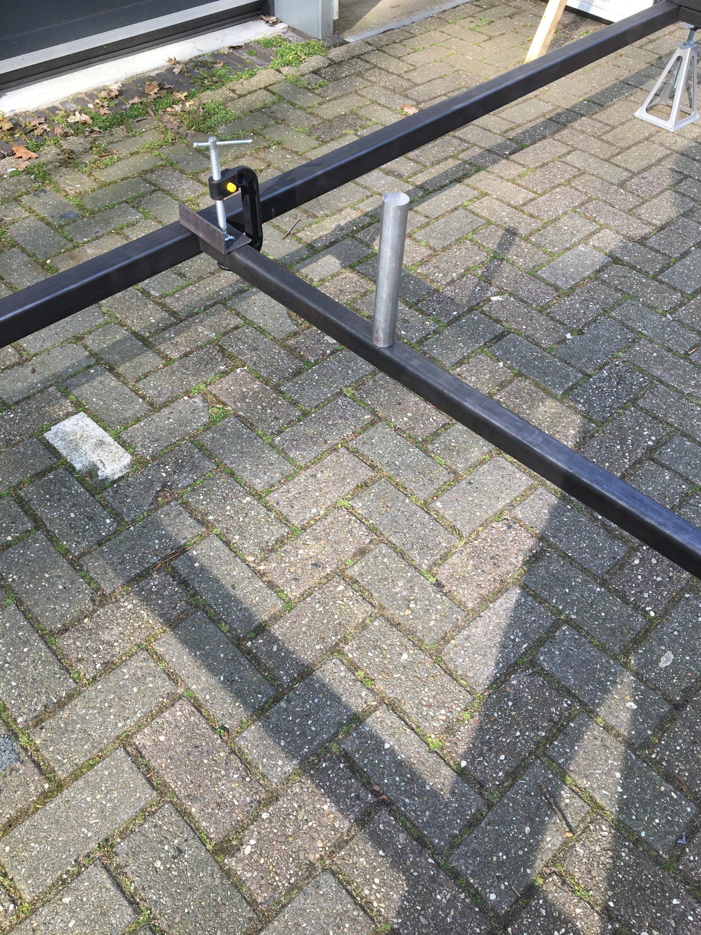

The jig is standing on the levelers, an aluminium frame with treaded rods to adjust the height and set everything level.
Outside frame is welded, diagonal measurements are 10mm off that will be easy to fix.
I might add a steel wire cross to the bottom to make sure it stays square during the work on the tub.

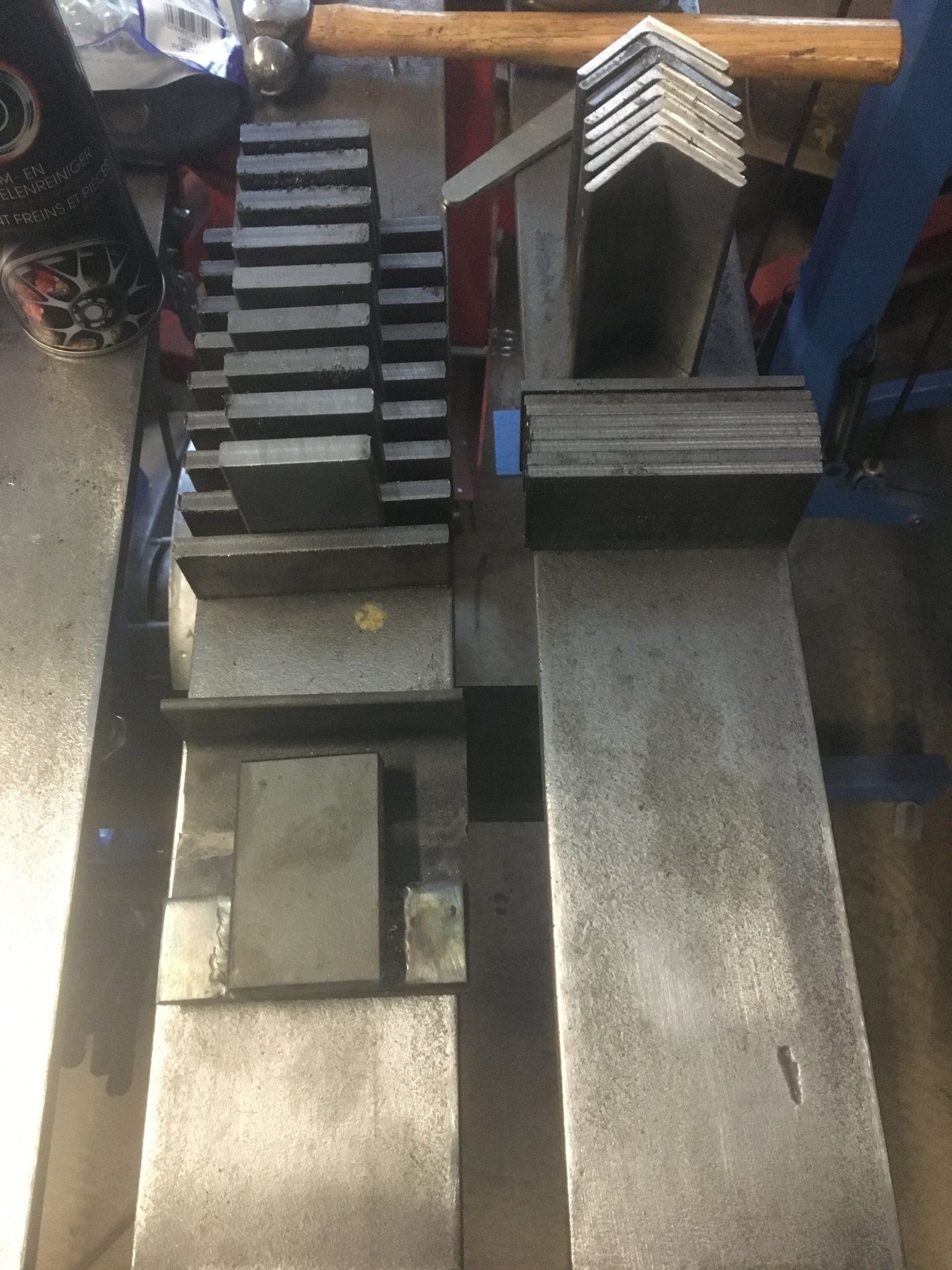

Marked all the cross bars and cut them to size.

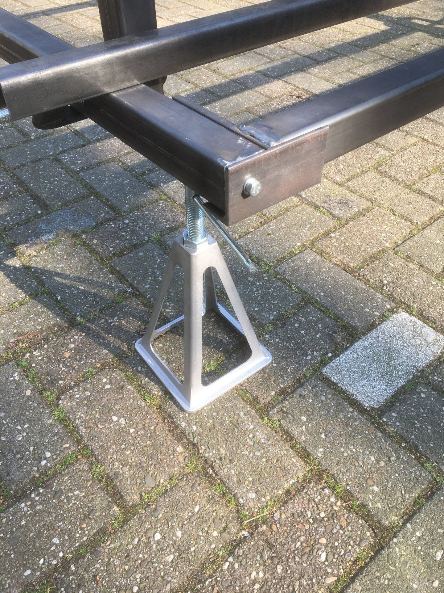

The ends of the side bars are capped and will get a M8 nutsert to attach an extra brace on the corners.
This brace will have a hole in the size of the top of the levelers so it cannot slide off the levelers.

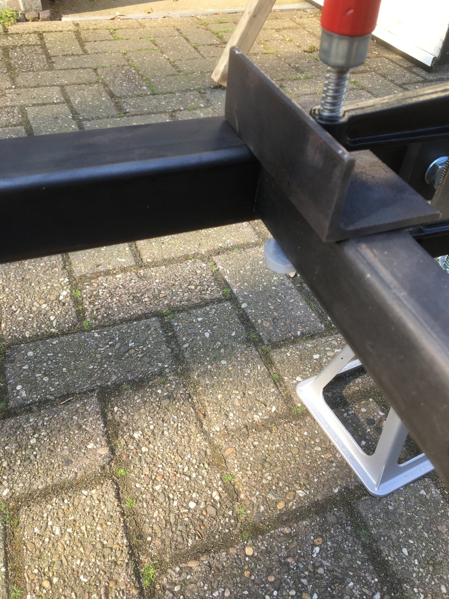

All cross bars cut to size, a snug fit. Now to think about how to attach them.

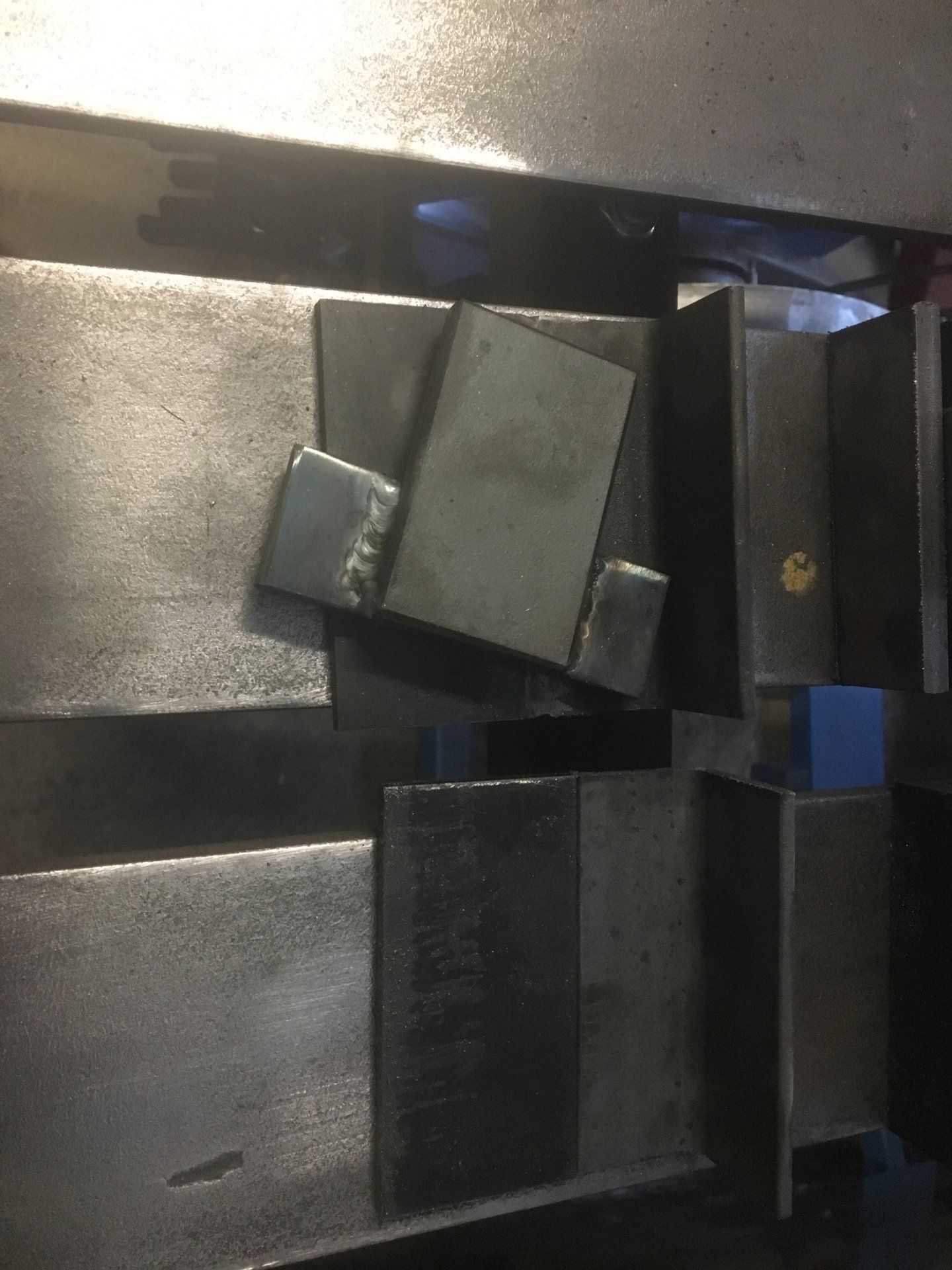

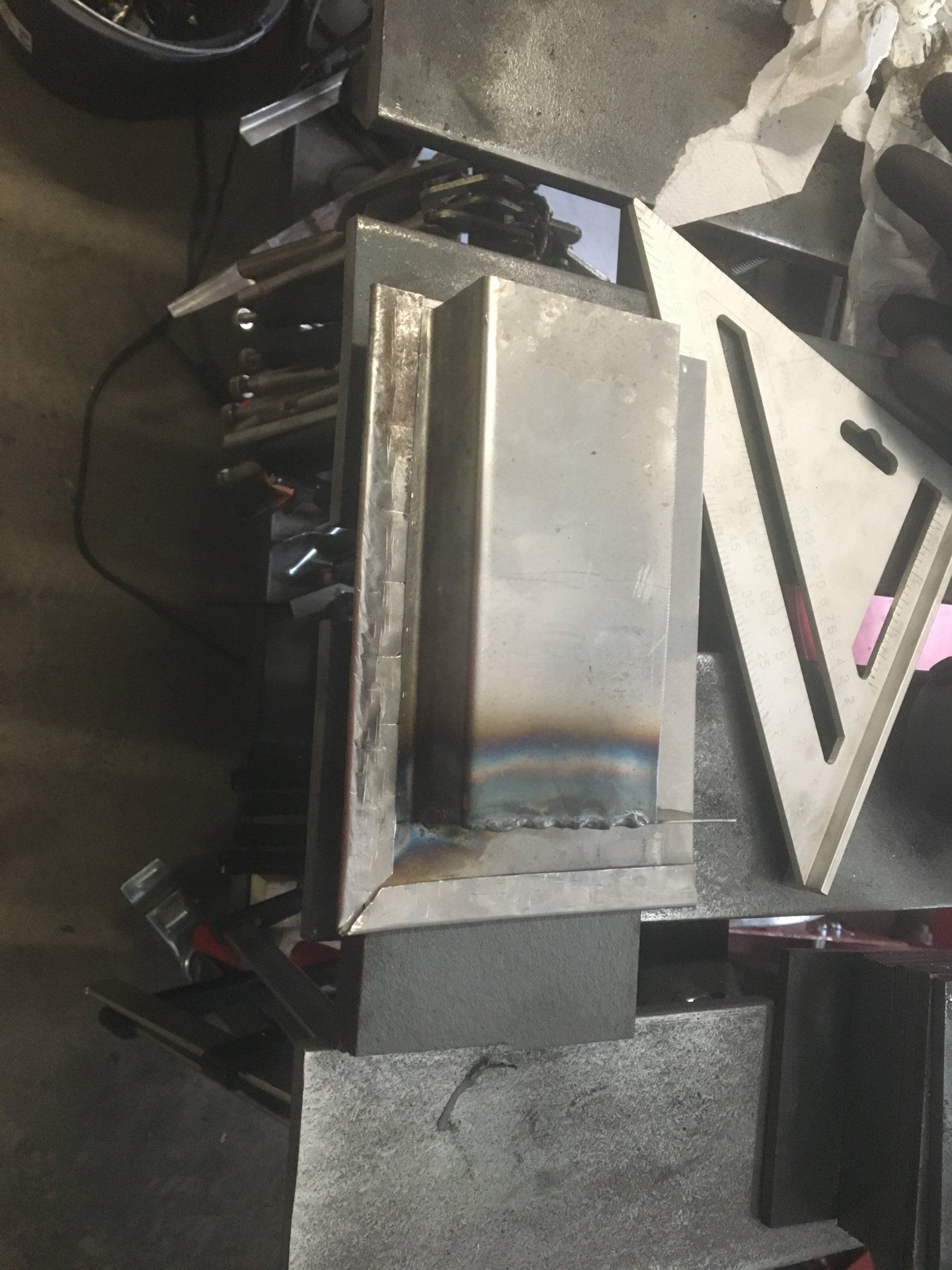

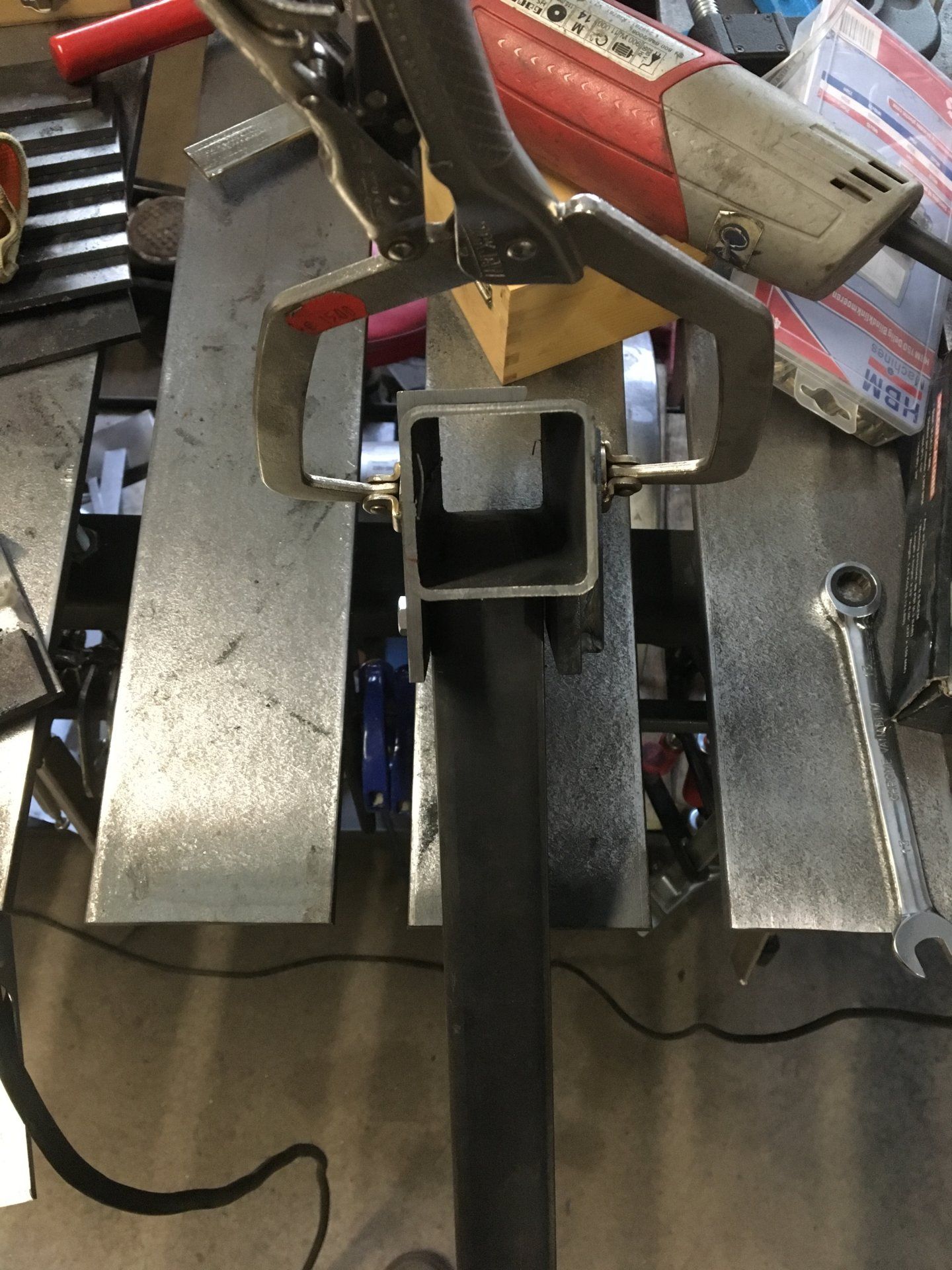

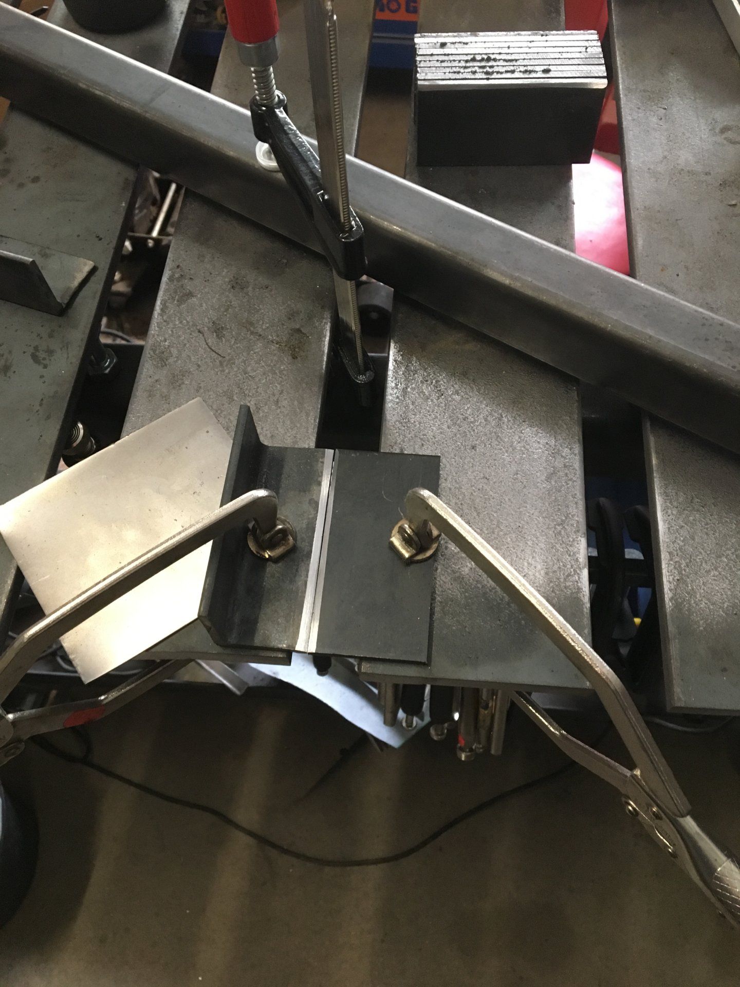

Piece of angle iron with an extension plate to cover the top of the crossbeam over the box section.
Than 2 pieces of flat stock welded together on the opposite side to hold it together on a rotisserie. There will be 2 m8 bolts holding upper and lower bracket together.
This way the bars will stay in place even with side loads.

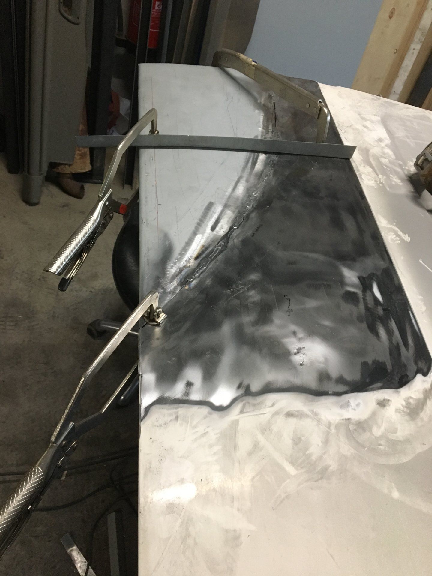

Made attest piece to find the best way to create the connection between the skin and the frame.
The side shows some damage on the skin from folding but I got the hang of it on the bottom.
I would like to make some half doors from scratch so this is a nice exercise for that.

Left door outside patch ready, outside skin is nice and flat.

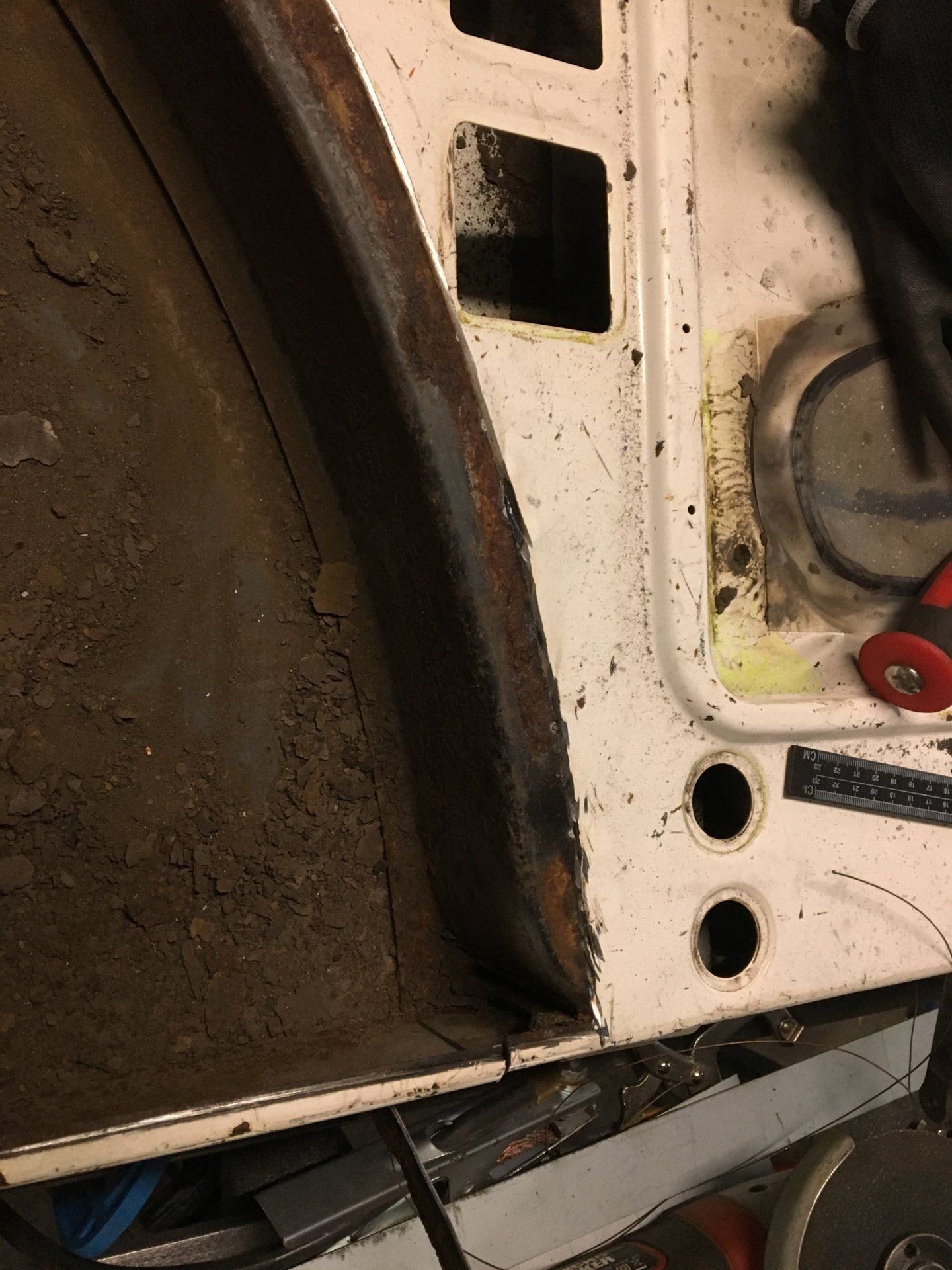

I’ve been slowly working on the inner fenders and doors of the Unimog.

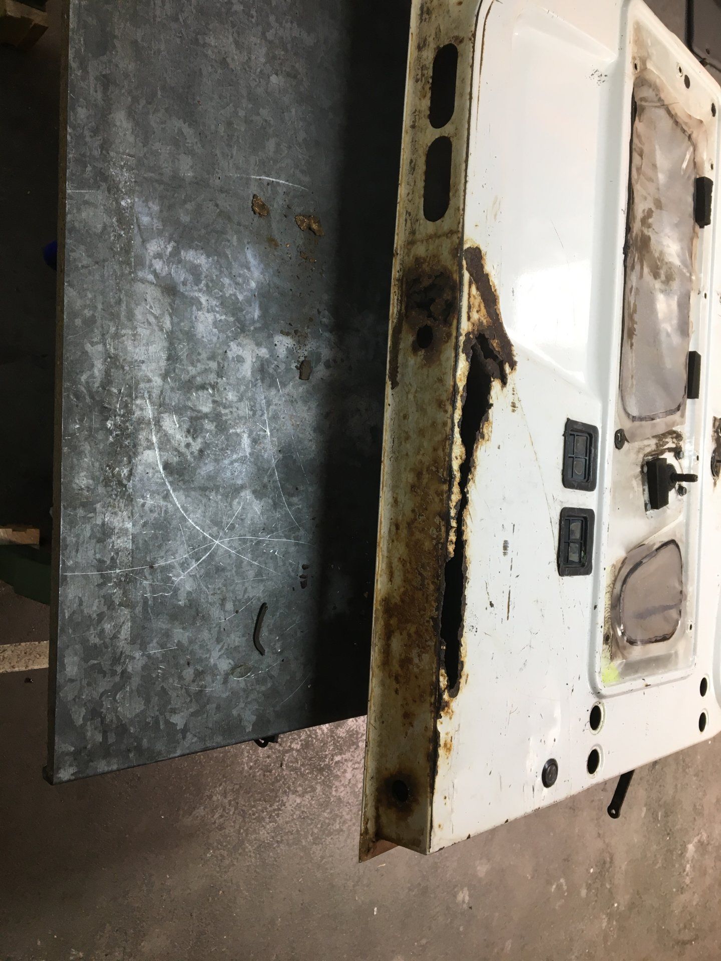

Some inner fender damage and repair pieces.
Hammer forming a repair section.
Replacing rust wirth steel, this is all 1,5mm steel.

Blocking to see the high and low spots.
A template to get the correct flow in the panel.
