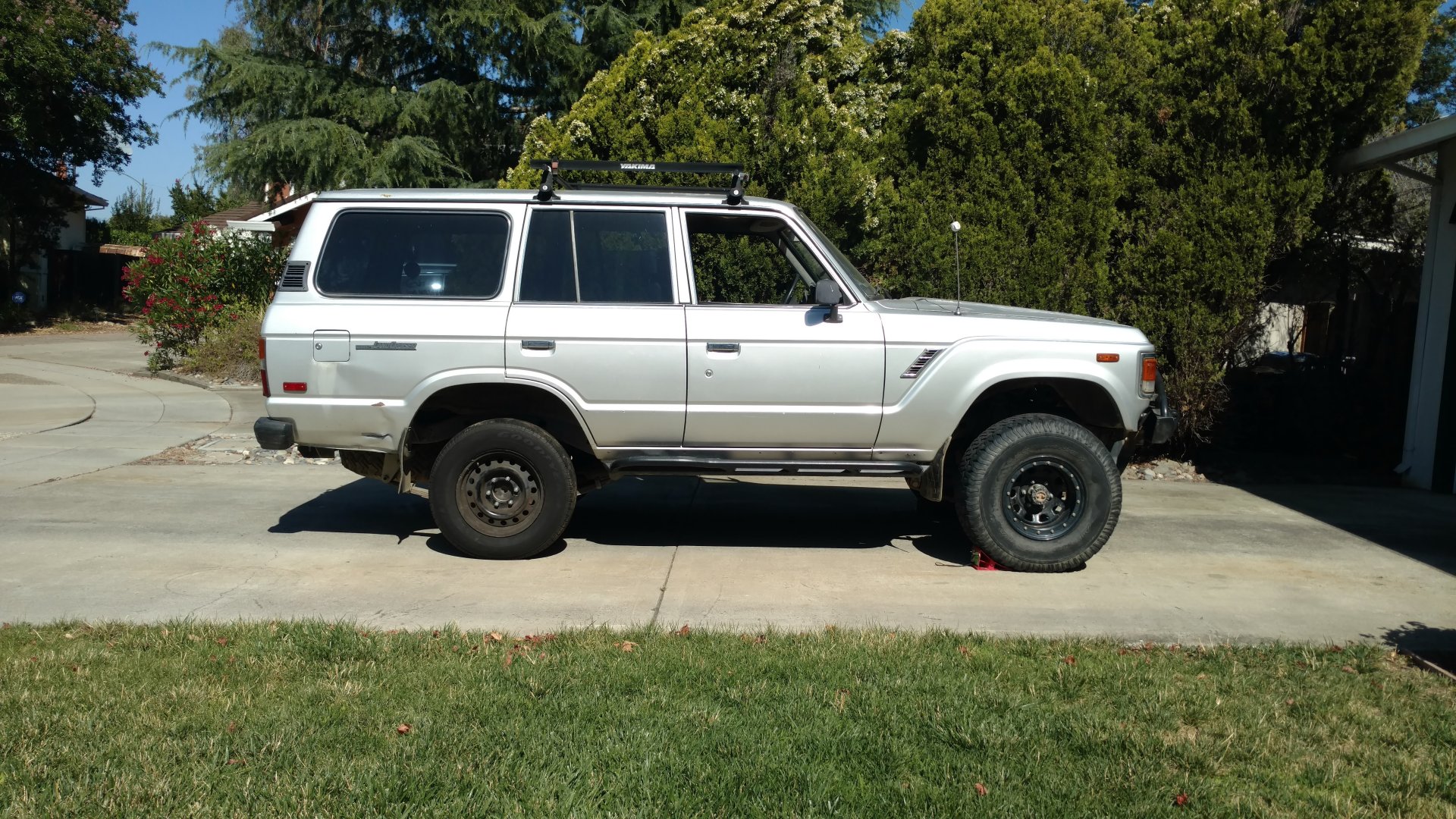

Everybody overlooks gearing when it comes to passing the roller test. With bigger than stock tires, the engine is under more load to maintain the 15mph, often meaning that your emmissions will skyrocket.
California makes you test at 15 and 25mph, but doesnt care what gearing or tires you have.
I see that you are in the bay area, you can have the old rollers if you want to come down to San Jose to pick them up. I moved out of California this summer so I dont need them anymore.
At first I looked at this pic and thought, WTF? but realized in 2WD you can have the different sized tires and just run to the test then remove.
Great f'kin idea! I'm gonna try that next year!

Maybe lean drop mix adjust and try some E85 gas and the smaller rear tires (see above) and retest. You're very close except for the low speed running rich.

I slapped a set of used 4runner spare wheels and whatever matching size, roughly 29" (stock 60 size), tires the used tire shop in town had on and passed the low speed test and high speed test with flying colors.

Yep. I ony did the mismatched sizes for the morning that I took it in for the smog test, and since they only test in 2wd I only bought 2 old rims and used tires. The smog tech probably thought it looked strange, but it definitely works.
If you already have a set of 31s I would definitely give that a shot before spending any significant money or time trying to chase minor adjustments in the tune-up.
