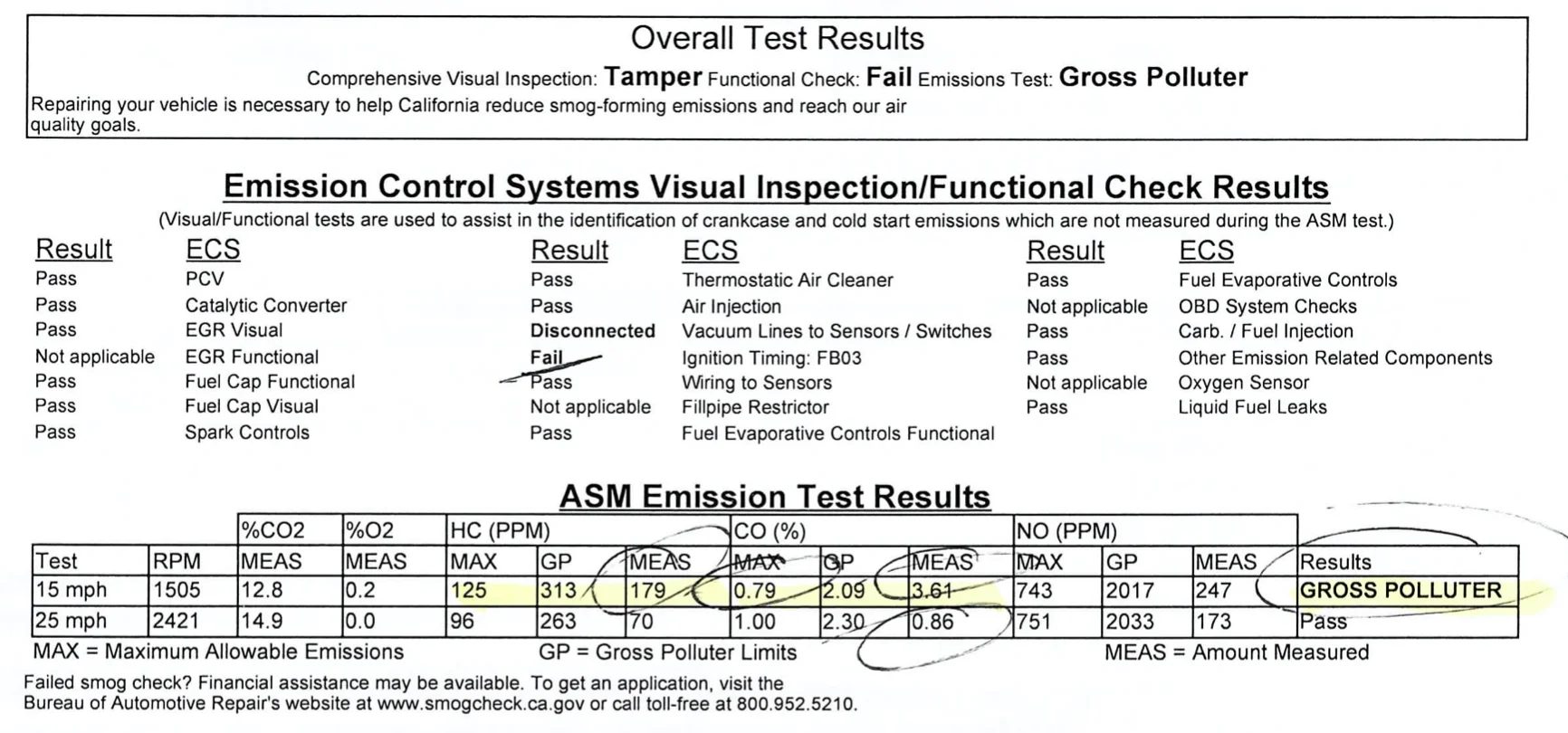

Took my FJ60 in to get a smog check...Failed. First test, failed on visual inspection. Smog tech said that vac lines to the carb were not correct and should be silicon. Didn't want to argue with him but told him that PO had carb serviced with LC specialist, Mudrak. Fine. I changed them. 2nd was timing was off and at 3* BTDC. No prob, I'd adjust. and 3rd I wasn't passing 15mph but passing 25mph test.
1st test results:
After failed test:

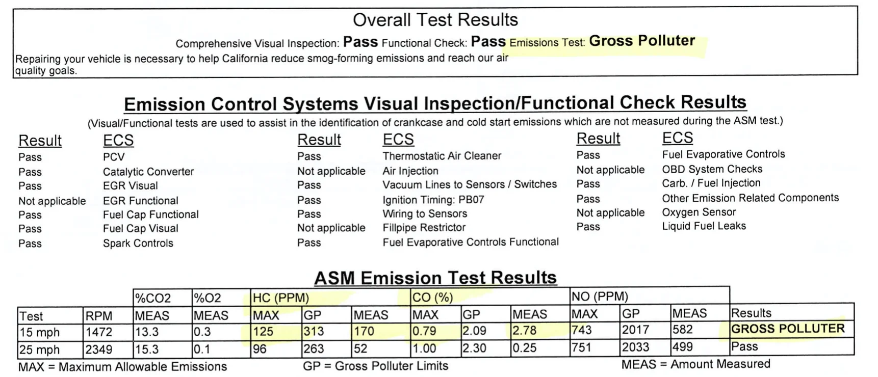

  1. changed vac hoses to carb
  2. adjusted timing to 7* BTDC
  3. prayed that 2 steps above resulted in passing 15mph test
2nd test...Failed:
After 2nd test, I passed visual inspection of vac hoses to carb and timing of 7* BTDC but failed on the 15mph test.
2nd smog tech was much more approachable and after talking with him and comparing the 2 failed tests, that the likely culprit is the carb and I'm running too rich.
I then went to another smog shop which was recommended by other LC enthusiasts and find 4 other FJ60s there and thought I was in the right place. The tech there took a look and noticed fuel seeping out of the carb pictured here:
He said that I'd need to have the carb rebuilt and was looking at $1k for a rebuild. His approach would also inspect all other smog components in the system (EGR, VSV, all vac hoses, etc).

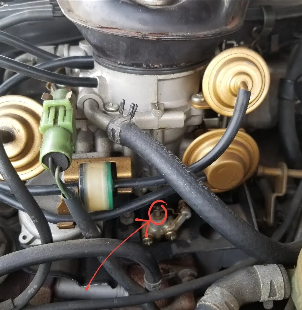

  2. Is there any way to address just the part circled in red where it's currently seeping fuel - without a rebuild or taking the carb off?

The diagnosis from the second guy who is supposed to know land cruisers is a little suspicious to me. Fuel leaking out of the slow cut valve doesn’t necessarily mean it is causing a rich mixture. The leak is to the outside of the carburetor. Also if he is knowledgeable he should know this valve is no longer available and not rebuildable so after you pay $1000 to him it will still be leaking.
During your first test one of your residual O2 readings is zero. This indicates your air injection system may not be working properly.

That leaking thing on the Carb is called a 'Slow Cut Valve' and it's long unobtanium from anywhere and all of them, pretty much, at this point leak. The standard fix is to remove, tap, and plug the valve with a very shallow bolt and JB weld and cut off the arm. Does not effect smog.

@2mbb - I haven't been around too many stock FJ60s to notice the fuel smell like mine. And it's seeping out very very little but noticeable. So all orig stock carbs would be doing this? Unless they've done was @Spike Strip has done in plugging the slow cut valve as he mentioned. I have the 2F emissions manual and it's less daunting to me (a shadetree mechanic) than the PinHead carb rebuild YouTube vids.

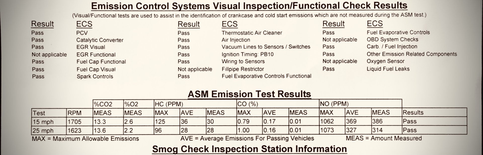

I’ll post my test results here so you have a reference what’s possible.
This engine had 280,000 miles on the block but a newly overhauled cylinder head. Also catalytic converter only had about 60k miles on it so it was fully functional.
Engine was as tuned up as it possibly could be (oil change too) and was driven 30 minutes before the test and never allowed to cool down before testing (waited idling).
Used normal gasoline with nothing added to the tank. Timing was at 7° BTDC. (Spec).
Ten years ago it used to get lower numbers.

the bar has been raised. the CO% your 60 produced are crazy low. i'll add an oil change to my list of todos also. thanks @OSS

The slow cut valve shouldn't be leaking and you really shouldn't be smelling raw gasoline if everything is working properly. My point was that the slow cut valve leaking to the outside of the engine isn't going to effect your tail pipe emission readings. If you smell gasoline in the engine compartment then you should check for other leaks and make sure your EVAP system is connected properly. If you smell gasoline out the tail pipe, then your engine is running rich and/or the catalytic converter isn't working properly.
Your low tail pipe oxygen readings (OOS' are in the >2%) indicates you don't have enough oxygen pre-catalytic convertor to let it work properly. This could be your air injection system or it could be that you are feeding too much stuff to the cat to convert. This is where doing the checks per the emissions manual will help.
