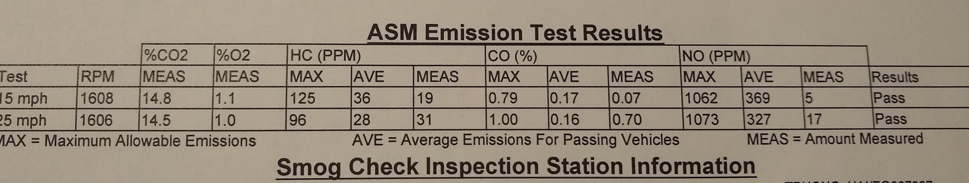

What did you do to have those readings besides premium fuel? That looks like a newer car out of your tailpipe.

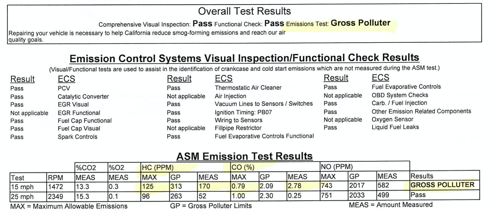

Took my FJ60 in to get a smog check...Failed. First test, failed on visual inspection. Smog tech said that vac lines to the carb were not correct and should be silicon. Didn't want to argue with him but told him that PO had carb serviced with LC specialist, Mudrak. Fine. I changed them. 2nd was timing was off and at 3* BTDC. No prob, I'd adjust. and 3rd I wasn't passing 15mph but passing 25mph test.
1st test results:
After failed test:
  1. changed vac hoses to carb
  2. adjusted timing to 7* BTDC
  3. prayed that 2 steps above resulted in passing 15mph test
2nd test...Failed:
After 2nd test, I passed visual inspection of vac hoses to carb and timing of 7* BTDC but failed on the 15mph test.

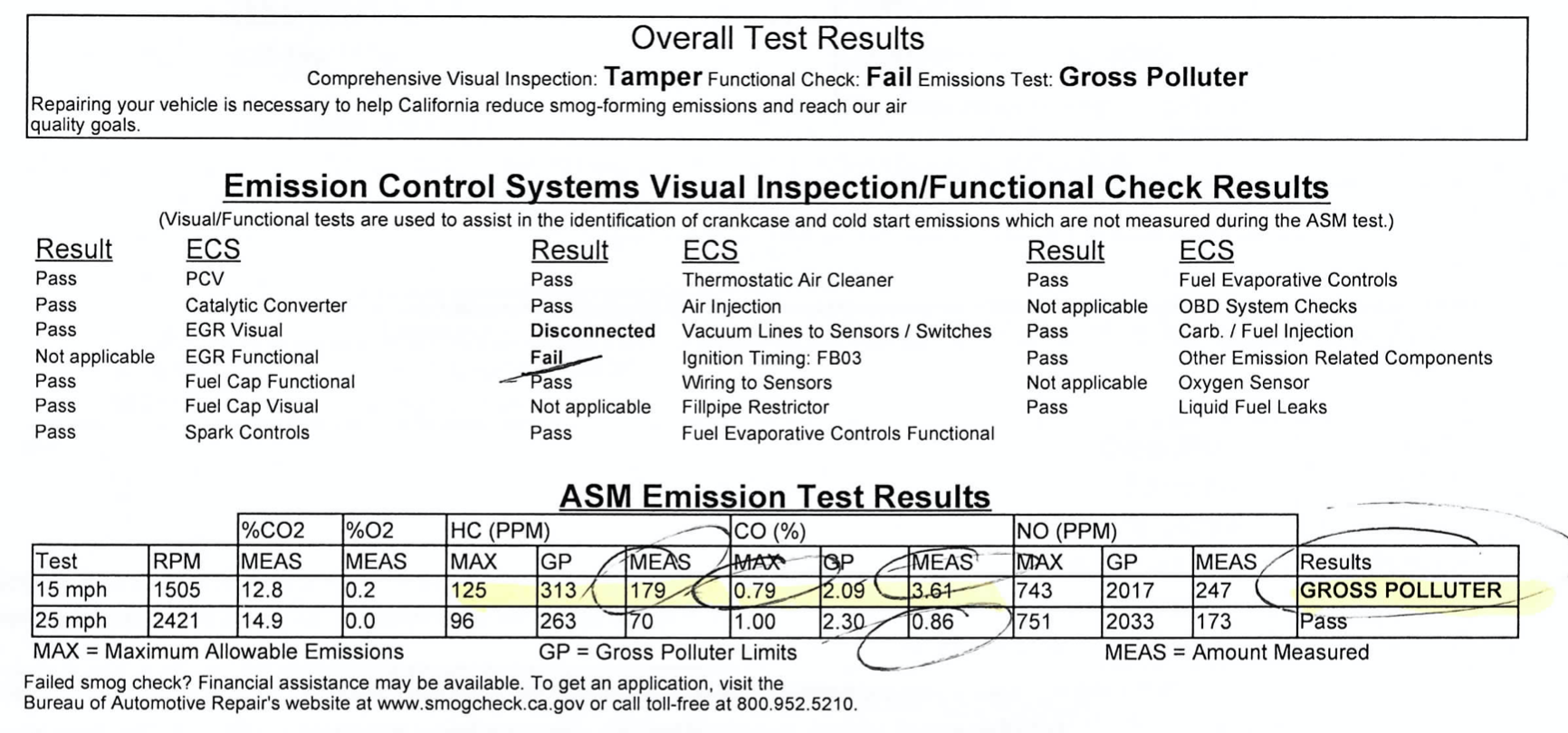

3rd test: FAILED
but now I'm passing the 15mph and failing the 25mph. It's reversed!
What I did after the 2nd fail and before the 3rd attempt:
- reviewed emissions - looked good
- noted my intake hose from my air pump was loose. all secure now
-valve adjustment, new valve cover gasket. valves seemed tight initially. i did a cold adj to spec and sounds more like a sewing machine more than ever
- changed the rear tires from 33" to 31"
-oil change
- i was at 3/4 tank full. tried to siphon fuel out to replace with premium/E-85 but was only able to get about a gallon out. Never siphoned gas before and was surprised i was able to do it but upset i was only able to get a gallon. when I filled up with premium i was able to get 7 gals.
above are my previous 2 failed test and here is my latest test:
Not sure why the flip from 15mph and 25mph is occurring but i'm now only off by CO% by 0.48. O2% is still quite low for some reason. @2mbb - you mentioned previously that it could be my air injection. when i went to check the air pump, the intake hose was loose. i re-secured it and felt a vacuum - I just didn't have any way to measure it. I am going to run thru the AI once more in case i missed something. @fjc-man - u mentioned i may need a new cat which is what the smog tech mentioned. and i do have what looks like the original cat. Anything else to try to tackle here? I didn't change spark plugs (which are only 3 yrs old). I do have a new set sitting in the garage.

Your % O2 above 15 mph is zero = Elevated CO from incomplete combustion because of low O2 = fail
If you have the 35 year old brick OE CAT it needs replaced if you want to keep the truck reg in Kalifailure. Be prepared for replacement sticker shock. But your Zero % O2 is not from the CAT.

Look at your air injection system. You have ZERO residual O2. Fix your air injection system and your problem will be solved.
nothing at all. i i added some sea foam to the gas and drove it until hot, left it idling and passed. a huge improvement to my first test i posted in this thread - even the smog shop was surprised. two years ago i had the carb rebuilt and i had 0% CO on that test. first time in years i didn't need to make repairs to pass smog.

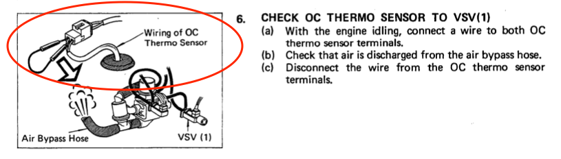

@2mbb - Yes, I'm going thru the AI system in the Emissions Control System manual...painstakingly. Getting familiar with all the internal parts that make up the system. One part I'm not locating is the OC Thermo Sensor. Can you point me in the right direction where this is? I was expecting this to be somewhere in the engine bay based on the picture in the manual (below) but I'm thinking it's the sensor coming out of the cat underneath the 60.
Yes the thermosensor was originally inserted into the catalytic converter. It’s a rod about 6” long.

The Thermo probe is located under the center console. The pump if not grenaded is almost never the problem with the system it is almost always the ABV.
