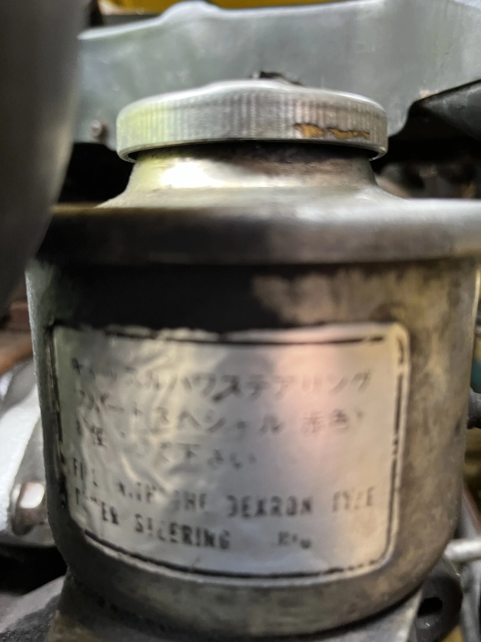

The truck came with this power steering pump. It still works but the bearings seem to be going out because it now turns pretty hard and gritty feeling. I know it’s made by Toyota but nothing more than that. Would it be cheaper to just buy a new pump or rebuild what I have?

I'm wondering if your 2F has been swapped out as it looks like you have a stock setup but a 77 block would not be drilled and tapped for the stock bracket

I rebuilt the ps pump on my BJ 60, which looks to be the same pump, using a rebuild kit from RockAuto. 4 years later, it is still going strong. I think it was a Gates kit, and the rebuild was surprisingly easy I thought. But I could imagine that if the pump has significant wear on the various internal parts, replacing just seals and bearings will be a band aid fix. Bottom line, you have to start with a decent pump for a rebuild to make sense. I think this is why buying a rebuilt pump is hit and miss.
