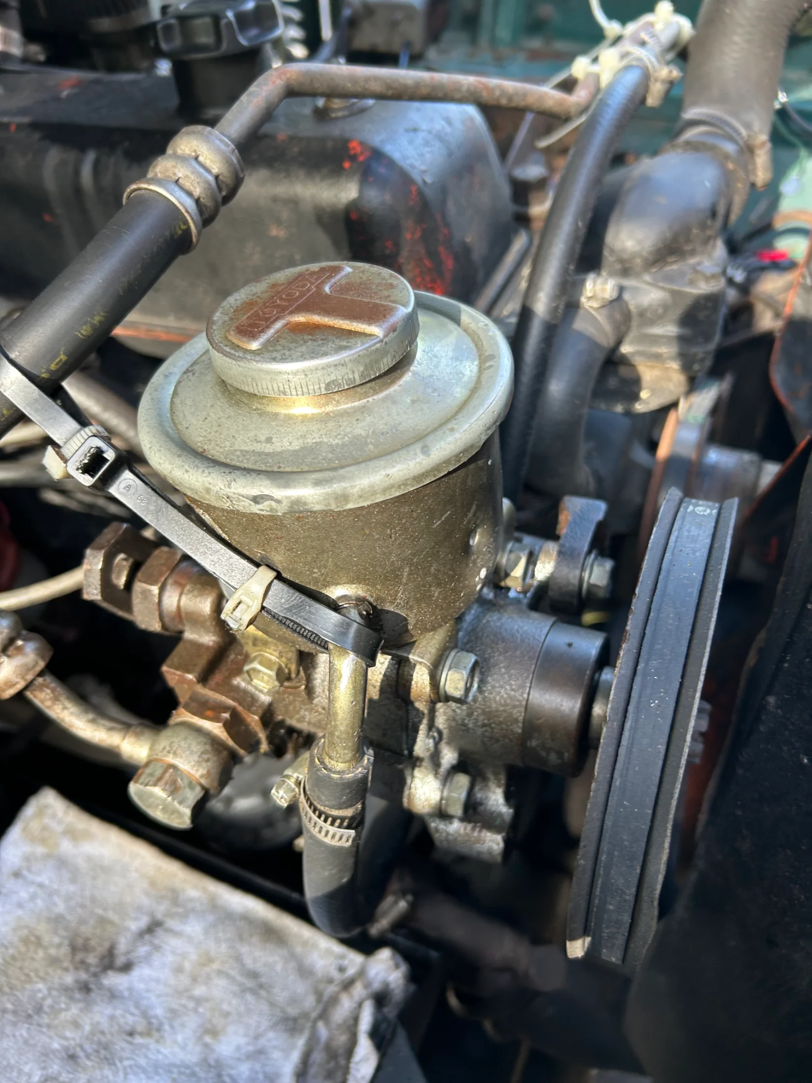

‘72 FJ40. Leaking power steering pump looking to reseal it if there’s a kit available
I’ve searched and still unsure. I hate to order multiple kits due to not knowing what year this came from. Or reseal and have it leak again.

either non-US 2F or, or 3F/3FE. The difference in the mounting width. Do you have more background information on the vehicle?
It’s a N.A. spec 72’. I do know 72s didn’t have power steering so I’m guessing it’s from another year or not from a 40 at all. Based on the D in Toyoda, it might be from another market…no clue. Thats why I’m asking.
I got it a couple months ago and trying to pick away at some issues and gather parts for the winter. Enjoying it now before the snow flies here in the NE.
If it is a US spec truck it is almost certainly not a non-US 2F pump. On second look, with the narrow belt I would bet it is off some sort of Toyota car/truck. 3FE pump is availbe new for a decent price and would bolt up to your 1F with the associated bracket, and use the LC belt width and clean up a lot of that, but you would want to swap to a 2F water pump or the very rare double groove 1F pulley

The reservoir appears the same as a domestic 2F but pretty sure US market 2F's had the power steering mounted on the other side of the block and the alternator mounted where you're pump is......
Domestic 2F reservoir would have the drain line on the opposite side of the reservoir.

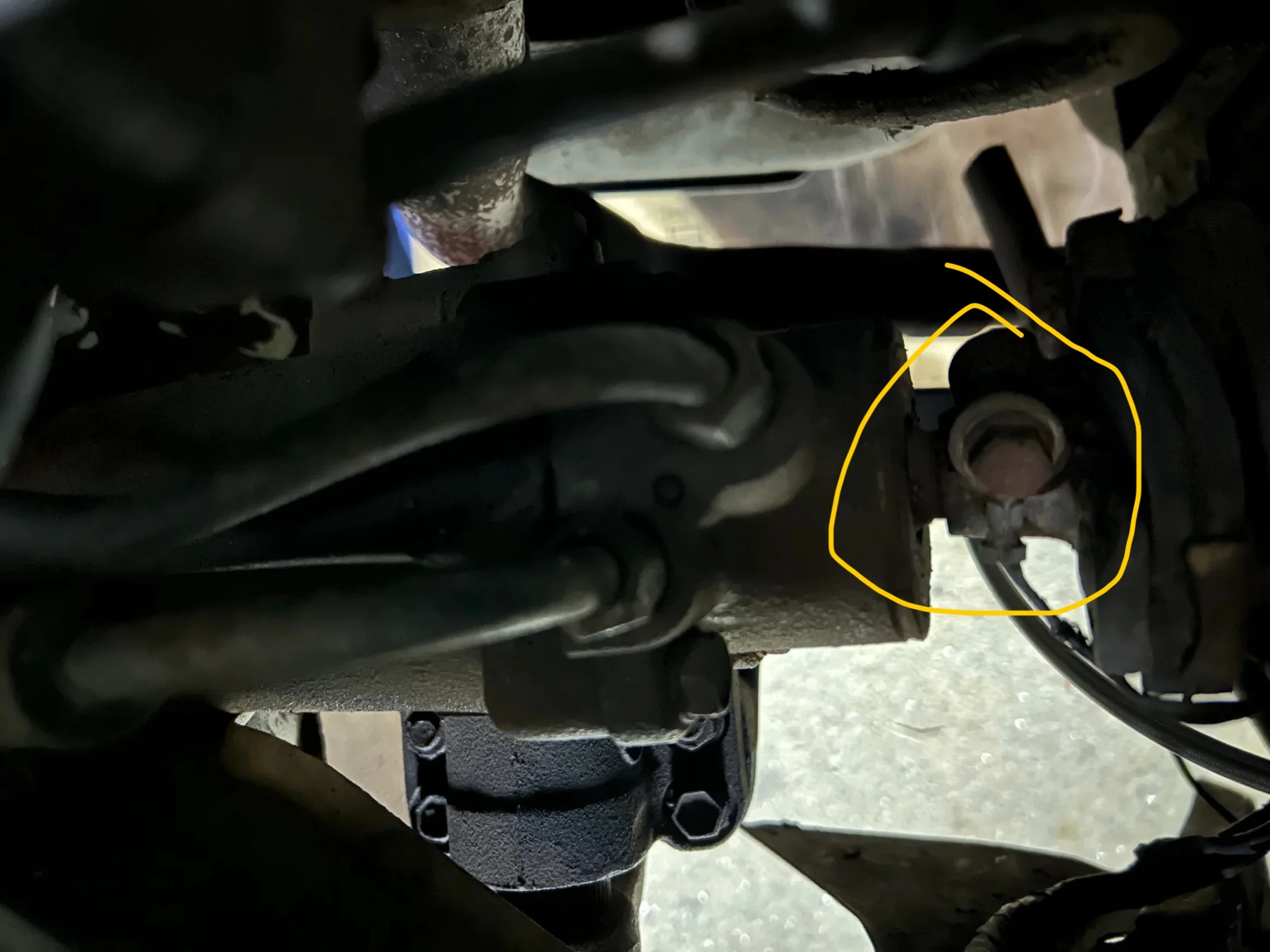

Here a pic of my PS box
is your box a mini truck box? can you take a pic from the side? If so, feed is M16, return is M17, I stock that PSC fitting as well as the hose/ends, and new 17mm low pressure fittings if you need.

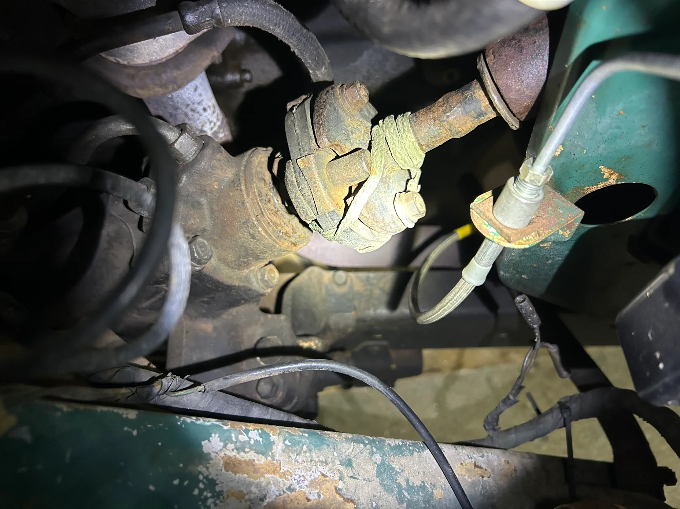

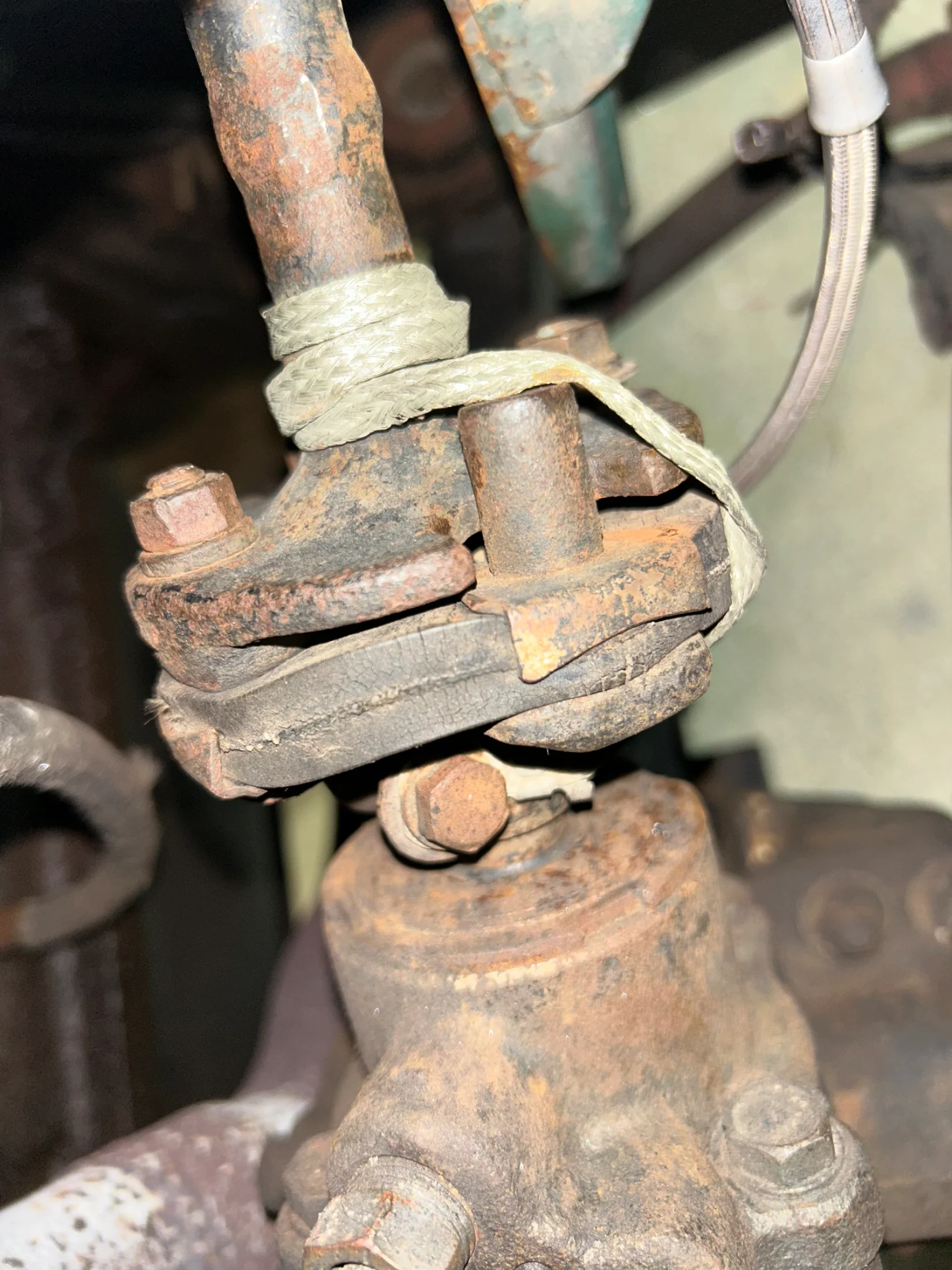

why is there a wire ring terminal on your rag joint?
It's like those little wires they hang from shopping carts to prevent static electricity buildup. ;)

Here’s a pic of my box
this is the fitting you need for the pressure side of the box and pump. Looks like someone cut and welded the pedastal to mount a 78-85 mini truck box

So I have a mini truck box. New to 40s…. so I’m learning.

That look more like a moisture trap promoting shaft rust threw failure. You got locomotive horns that need that heavy a ground wire - that blows.

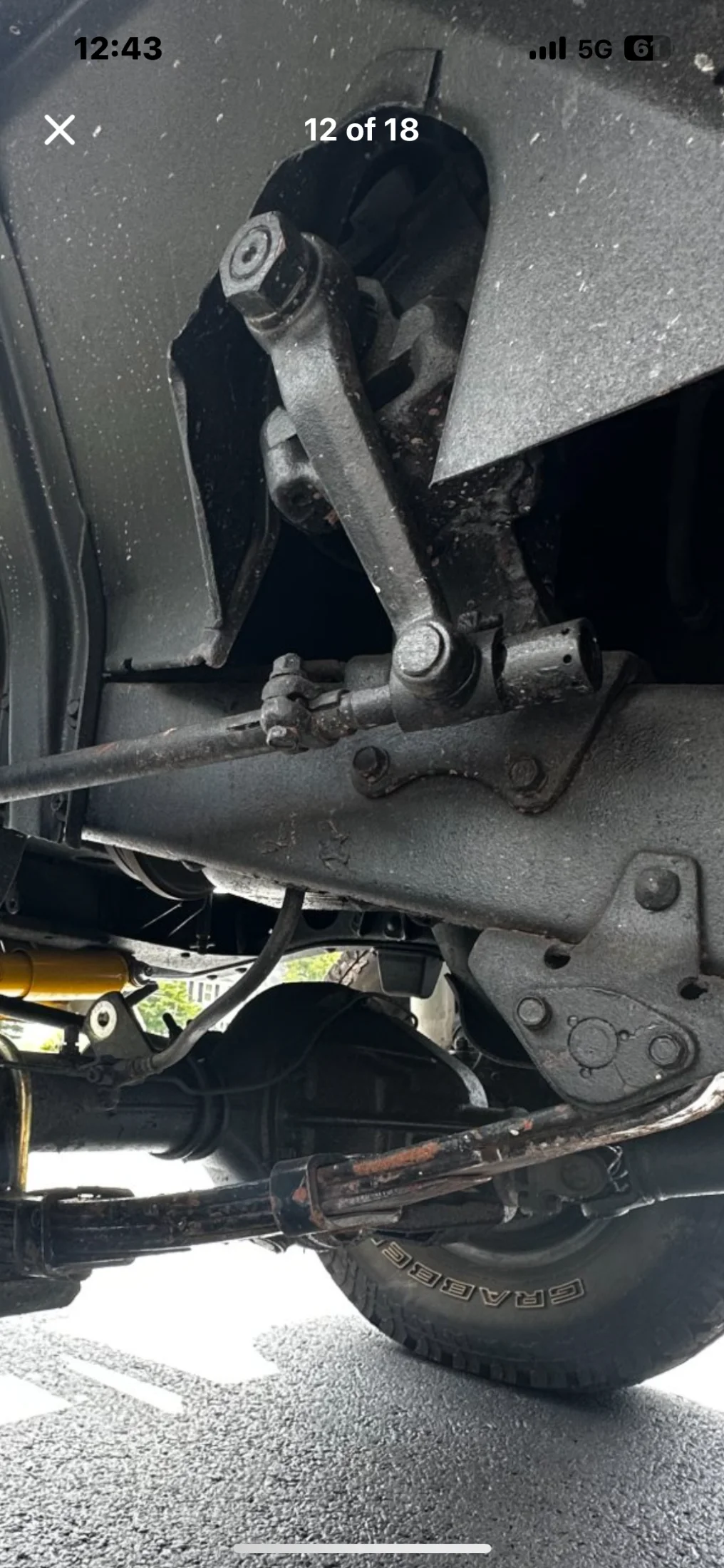

Might want to replace that rag joint. How sloppy is you steering wheel? Doesn't look like there is a bushing or pillow block on the engine firewall side.
You can also ditch that steering stabilizer bracket that is ubolted to the axle.
