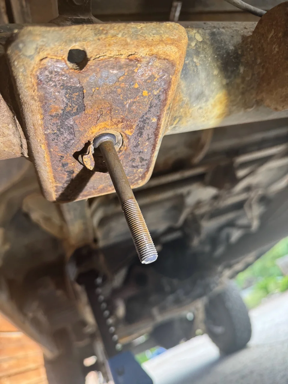

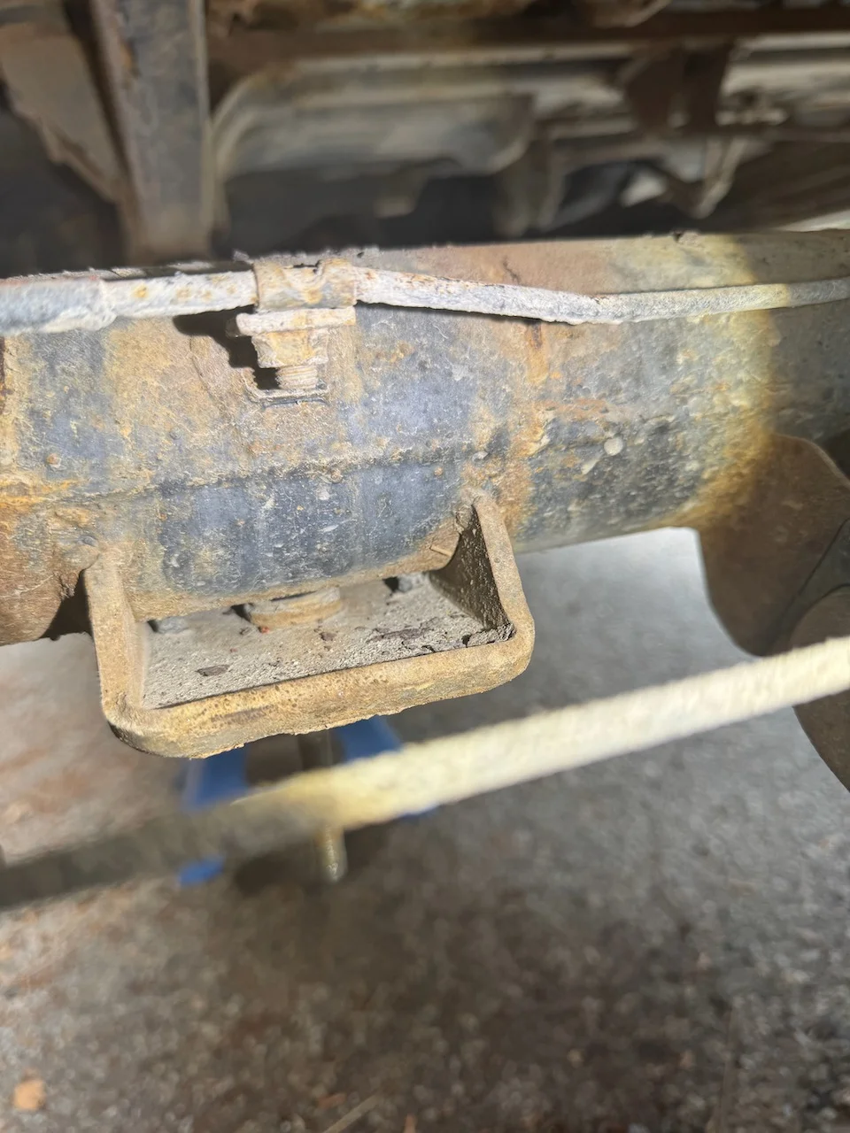

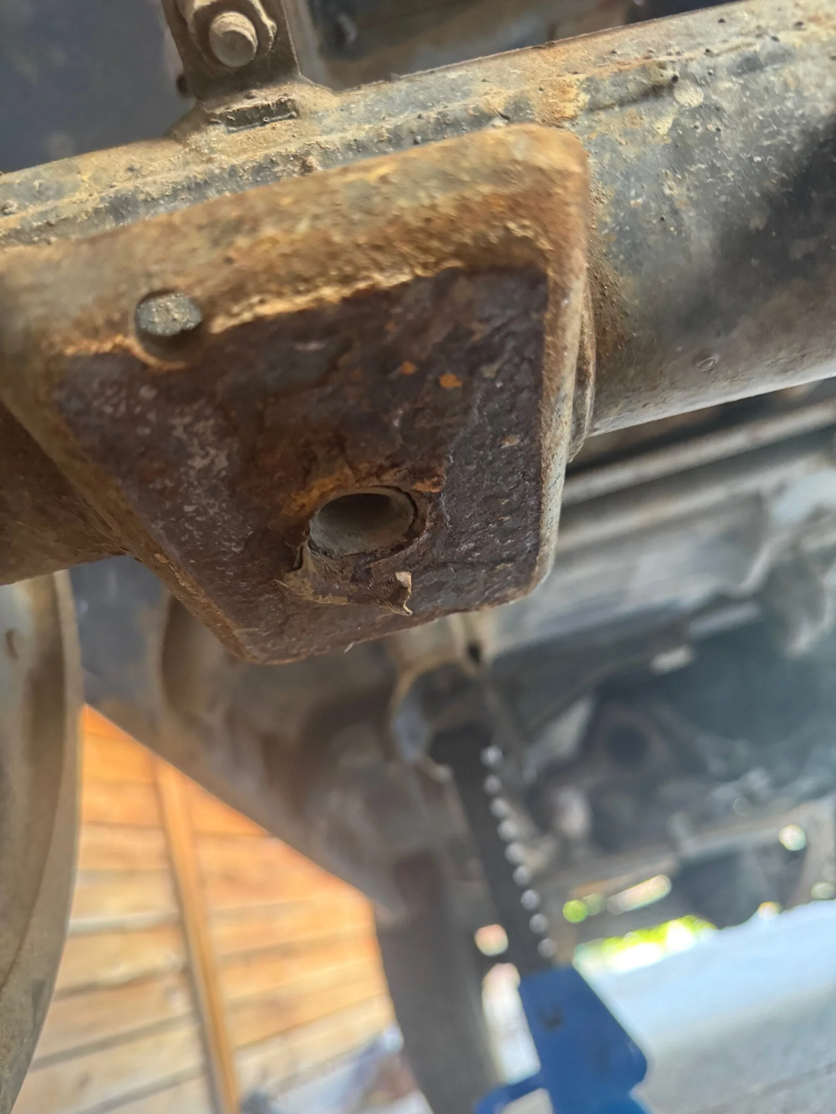

Hey guys, broke a leaf and now replacing with OME on my 1987 HJ61. After removing the old spring, I'm a little confused as to what to reuse or replace from the old spring brackets and rubber cushions. In the photos below you can see the bottom of the axle bracket with what looks like part of a broken tab of some sort hanging off of it, as well as the old top bracket and two rubber cushions. Do I just grind that old tab off the bottom of the axle bracket? Do I need the rubber and the other bracket at all?
Am I looking at an existing center bolt spacer that is in the spring plate already? The center pin fits snug as is, with the only issue seemingly being the dangling bit of steel on the spring plate that needs to be removed.
Remove the other old spring and you'll see how the parts go together.
Some guys get rid of the rubber pads when installing thicker springs. I kept mine. The rubber pads have a formed bushing in them that fits the bigger hole in the mounting plate. Looks like yours have been torn off.
You'll need to get a bushing for the smaller spring pack alignment dowel to fit snuggly into the bigger mounting plate hole.
Just for reference, the 70 series Landcruisers don't use rubber pads to cushion the spring packs.
I got new rubbers on Partsouq when installing mine ,they were like 60$ for the whole set of 4 .
Wanted to keep them , anything to cut the noise ahah
Parts supplier said just use the old ones, as they will at least still do something. As @OSS said it looks like the rubber bushing that is in the axle plate now has been torn from the main rubber pad. My options seems to be, use everything as it was, or delete the rubber and ubolt bracket and grab some new bushings.
I think the 60 Ubolt torque is lower than the 62, but the problem I found w re-installing the rubber dampers on the 62 is I couldn’t get 105ft lbs very easily, and ended up bending the lower spring plate when I did. No bueno. 4+ Ubolt flip kit solved that.
