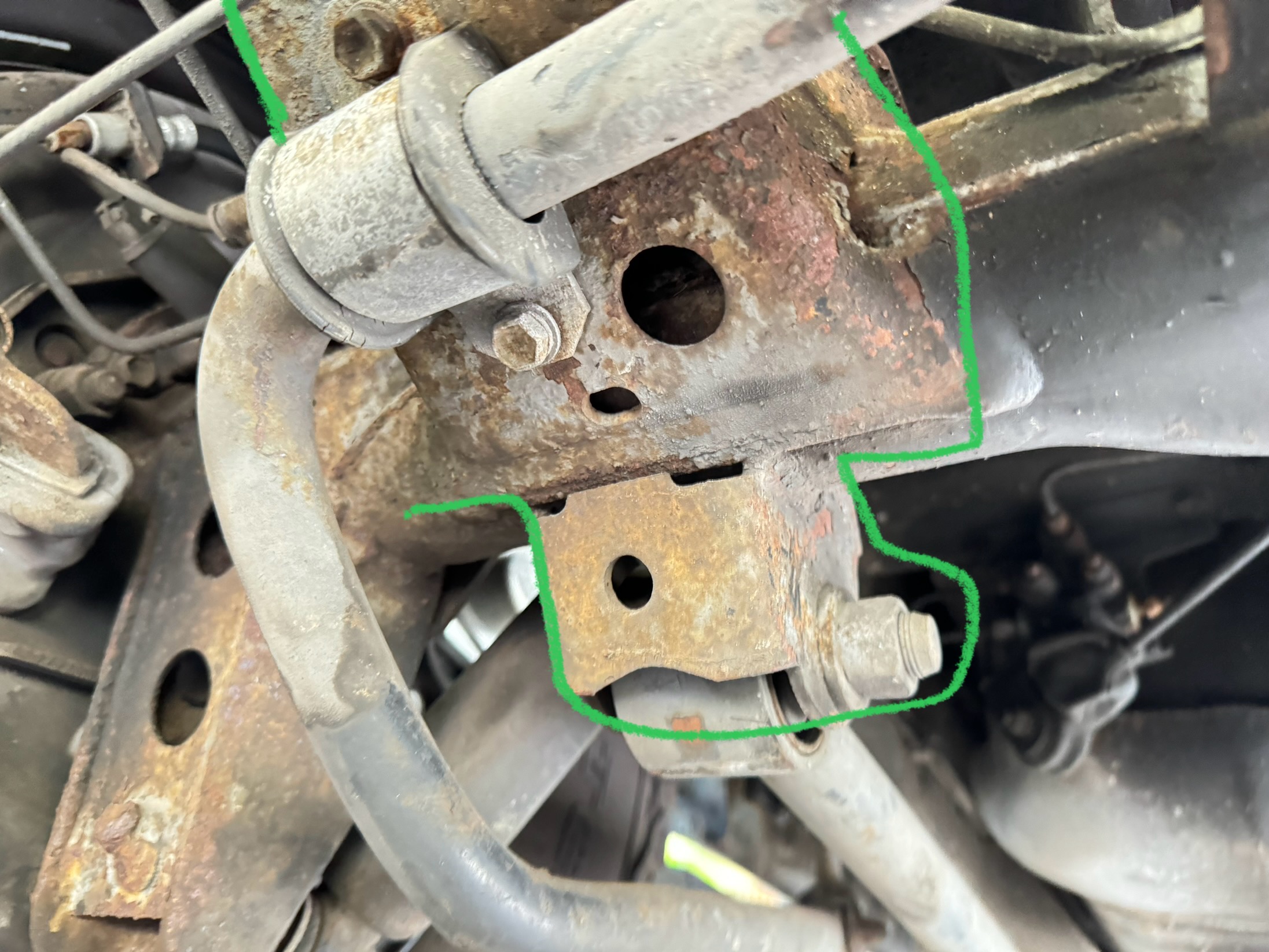

Hello, are the shaded green areas part of the rear axle housing or a bracket that can be replaced?
It appears to be welded to the axle housing and I’m trying to figure out what to do about the rust.
Wow, that is bad. I can take that axle off your hands and give it a good home. 😆
I would look at the upper mounts and check if they are thinning. Mine showed more rust there than anywhere else.
Use a rust convertor and then paint. I use Rust-Oleum Rust Dissolver Gel. Apply, Sit for 30+, Rinse, Repeat. I use Rust-Oleum Professional Cold Galvanizing Compound as a primer.
Thanks for confirming and the suggestions. I'll take a look at those mounts, brush or wheel, and see what it looks like.

LOL. You've obviously never seen rust before. That looks like a 3 year old truck around here. The bolt heads are all still clean. Rust is when they turn to dust when you touch them.
That said, after you've cleaned and painted all the affected areas, Fluid Film is your friend. I spray my LX450 from tip to tail every October. It helps to prevent rust (or at least slow it down where it has started) and makes removing bolts easier.

I am fan of Rust Bullet for treating/coating over (what is apparently) surface rust like that. You would coat it after removing the loose corrosion on the surface with a wire wheel, etc. Definitely follow the directions (and wear gloves); you do not want to waste it, as it is not cheap. You would then paint over the Rust Bullet with a top coat of normal paint. Nothing else I have used has worked better.
You could also do a media blast, then prime and paint. Depends on your air compressor situation, how much you want to disassemble and what media you choose. Walnut, sand, black beauty, steel shot
If close to the Ocean you'll get corrosion from the salt in the air but as others have said, that's not bad. FWIW I recently cleaned, wire wheeled, brushed and sanded by hand, then primed and painted my rear axle housing (also in FL) which wasn't that much better than the photo above before I started. It was a ton of work (mostly removing old undercoating, turpentine works well) doing it while laying on my back in the driveway (wheels off, frame resting on four 12-ton jack stands). I taped off the emergency brake cable and a couple other small things but mostly went over the bracket bolts as this wasn't meant to be a 100 point restoration, more for long term protection.
One bracket that needed special attention (more corrosion than anything else) was the right rear ABS sensor wire bracket on the backside of the axle housing. For some reason that bracket had significant corrosion; only guess is the factory that produced the ABS wire assembly did not paint/plate/protect that bracket as well as the others?? I had that bracket Cerakoted (E Series black) along with a batch of other parts.
FWIW I used SprayMax 2K Epoxy primer (2-3 cans IIRC) and 2k Epoxy Top Coat, 2-3 cans (Hot Rod Satin Black). Came out nice.

My weapon of choice for tackling rust like this on the axles is a needle scaler. Obviously you need space and a decent compressor but the finish is as good as you will get. Beats wire wheeling especially in the corners.
