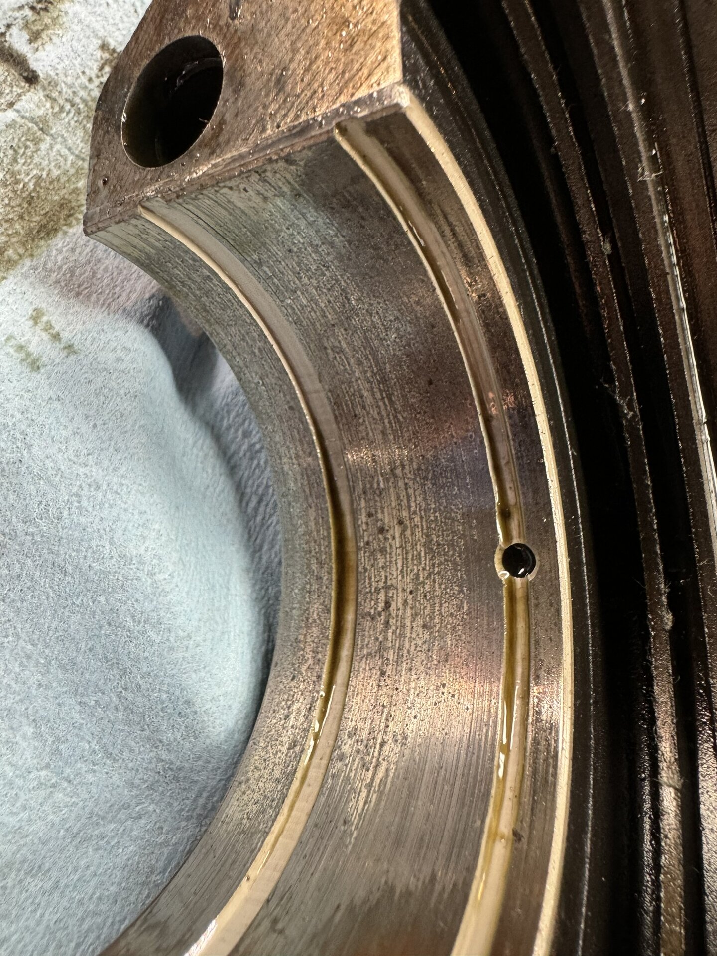

I'm being lazy, but didn't you say in your main 4-speed thread that the bolts to your rear main bearing cap were not fully torqued? I don't want to say lose but not difficult to break free. Now that you torqued them to spec I wonder if there is something up with that bearing?
Edit: I went back an looked at your thread and also looked through my pics from my clutch job a few years ago, unfortunately I didn't take a pic of my bearing cap. That said I'm not sure I like the looks of the cap, here's your pic zoomed in. I'm not an expert but you may want to focus on this before you try to go too far forward. What did that cap feel like to the touch, looks like its starting to fail.
Thanks! Yeah, I was afraid of that. I guess I'll drop the pan again and remove the cap (again) And see if the flywheel spins better.
This bearing is toast. Might want to look at all the bearings.
Sorry to dig that up, but you will be better off dealing with this now rather than smoking one or more bearings and wiping out your crank and who knows what else. My bad for not looking at those pictures more closely the first time.
I really appreciate everyone's help. Reporting back: Dropped the oil pan and removed the bearing cap. Flywheel rotates. Reinstalled bearing cap for the time being and the flywheel turns easier with the aid of a prybar on the teeth. So, I went ahead and finished the clutch/pressure plate install. I left the oil pan off for now. I'm afraid to ask but here goes: How big of a job is it to replace all of the bearings?

So with the cap off it rotates easier? What's the journal look like? On the back side of the bearing shell there should be some form of measurements or std. Plastigage might be a good idea along with more investigation of other caps. Did you lubricate the bearing b4 installing the cap?

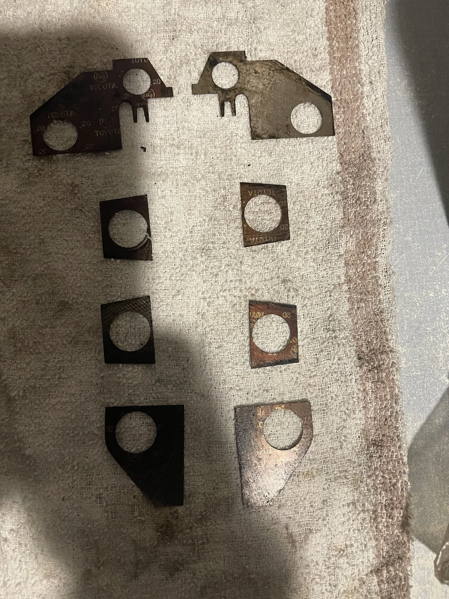

Thank you everyone. The motor is approaching its 54 year anniversary. So, it is no spring chicken and would undoubtedly benefit from a rebuild by someone more talented than myself. For now, I'm going to try and get as much out of her as I can. Since there were no shims in the bearing cap and since removing/loosening seemed to free things up, I ordered the above-referenced shim set. (Thanks @73FJ40 and @Mark Jennings). The plan is to proceed on with the 4-speed conversion project and button her up and drive it as much as I can before she croaks. :)
