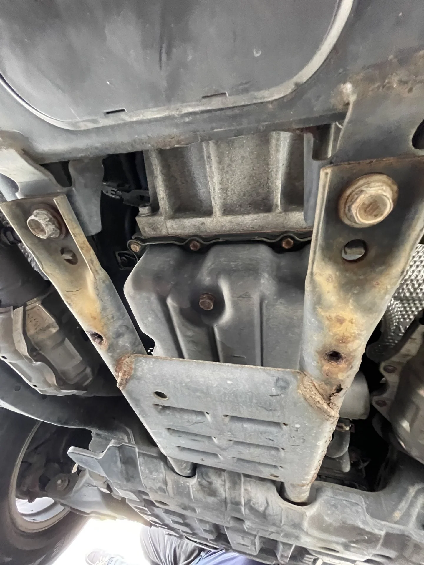

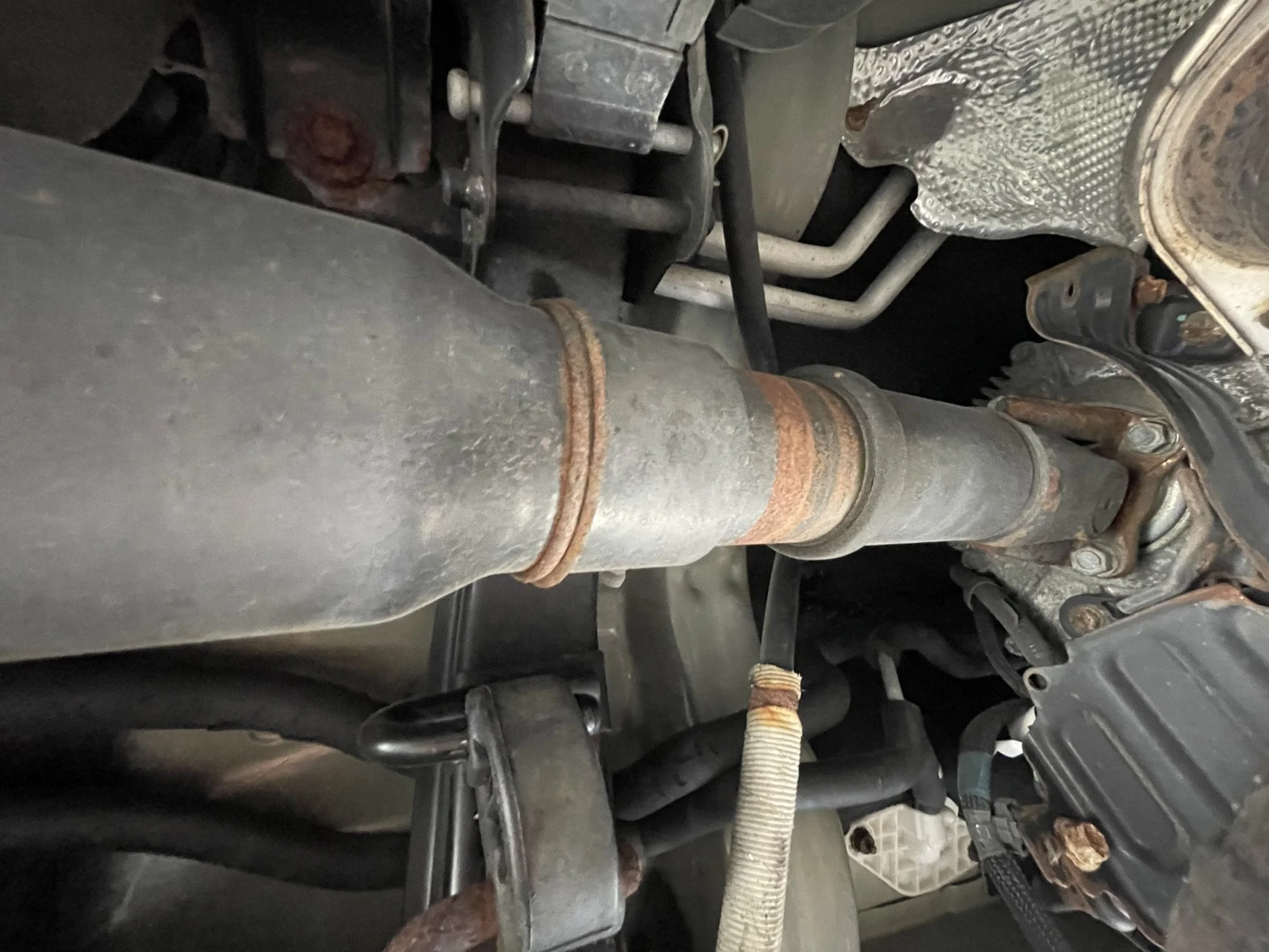

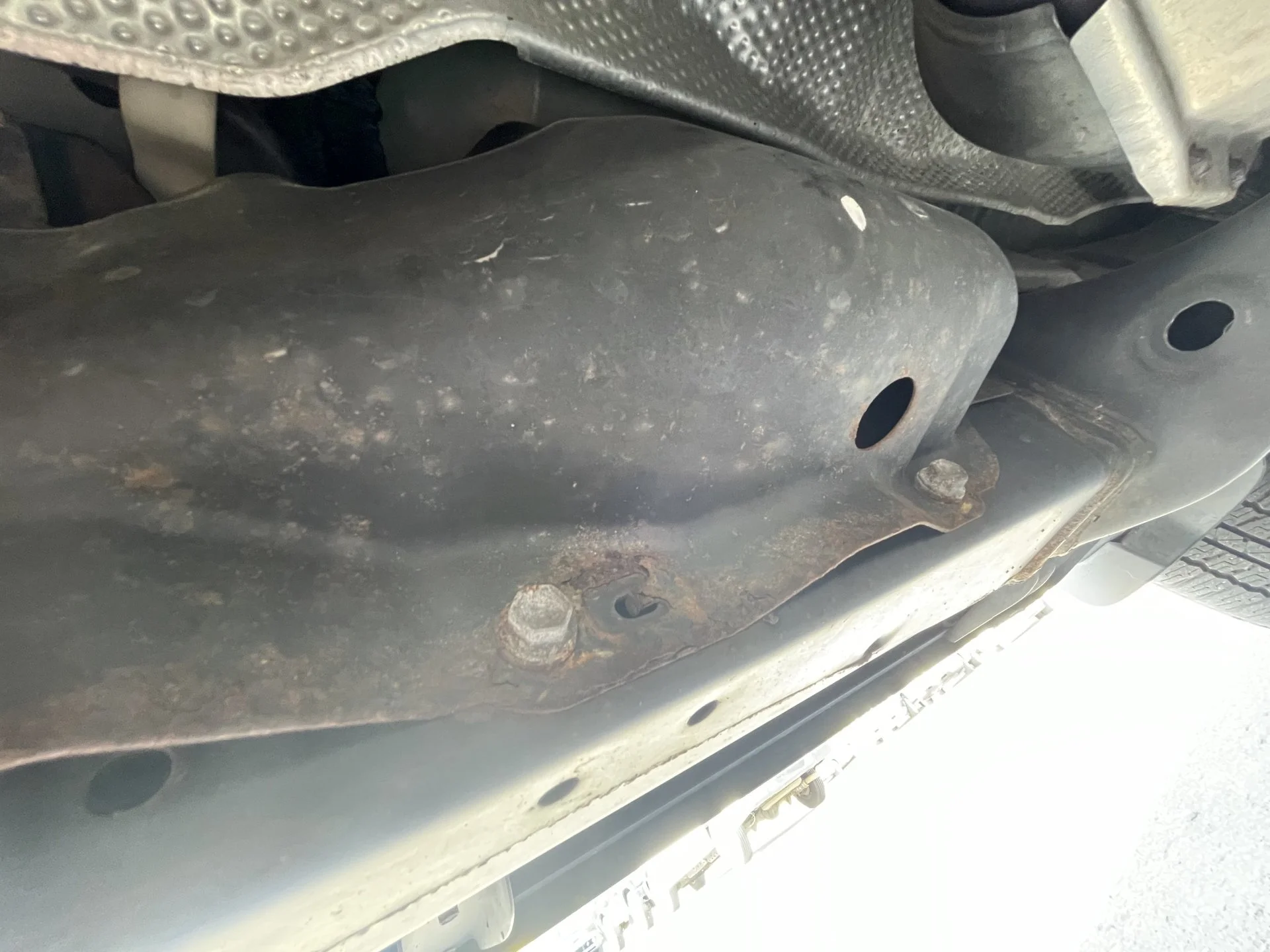

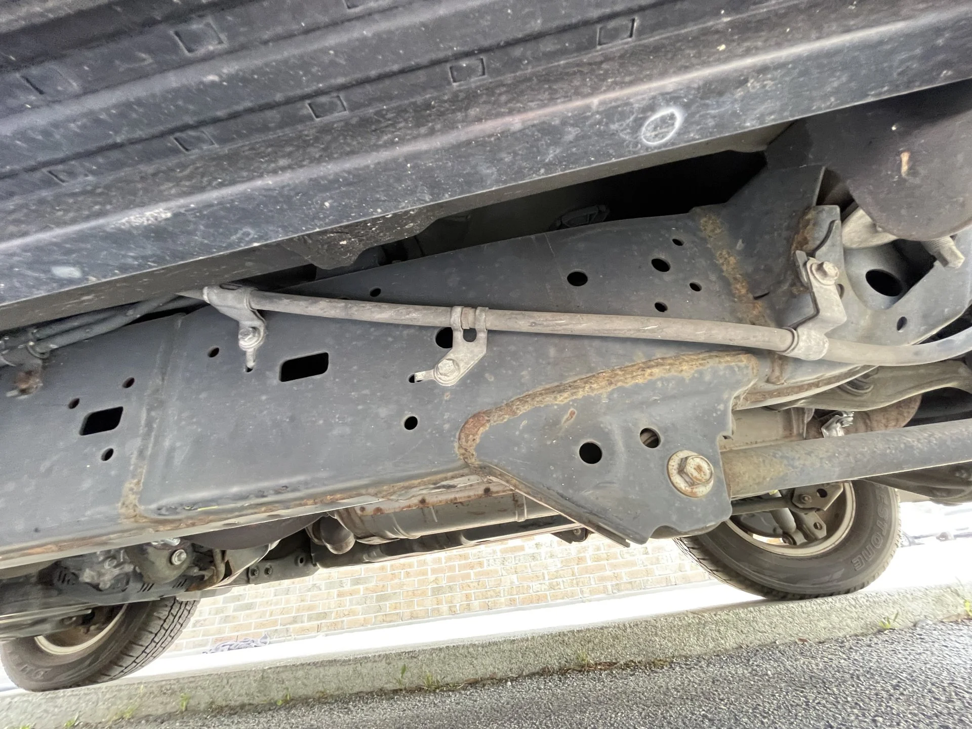

Ready to buy my first LC, thoughts on this underside? I GOT IT!!
What rust? :meh: Maybe my northern genetics prevent me from seeing it. Can’t see okra as a vegetable either and chicken and waffles are not meant to be eaten in the same meal.
If you put enough syrup on it I'll eat lettuce and waffles

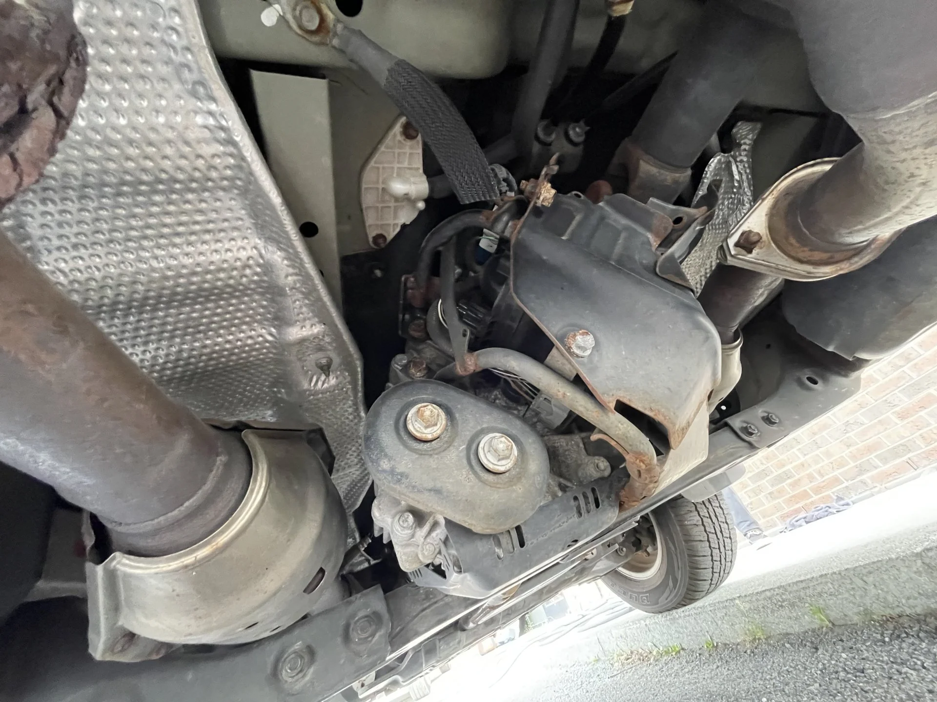

Those bolts are easy to snap on vehicles in rust country. They seize, and especially for people that take a vehicle to a dealer, the techs commonly snap bolts like that during service. I can't tell you how many have had skids, access panels, etc left off of the vehicle. I've personally had many factory skid bolts on Tundras, Tacos and a 4Runner snapped by dealer oil change techs, that I only discovered when I went to do the next service myself. That is one reason (amongst many) that I do my own service work.
All great points @CharlieS . Thank you very much for the help!
The missing bolts on the undercover are easily replaced and often not reinstalled by a lazy tech doing lube work. No biggie but do replace them. Edit: note what @CharlieS wrote about broken bolts.

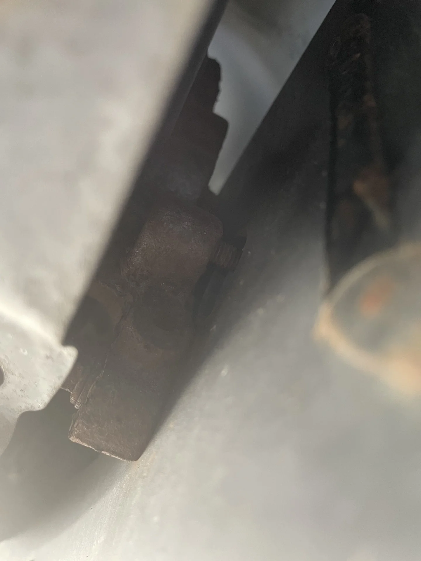

Unless the KDSS valve is utterly consumed by rust (will look like a rusty boat anchor), with some patience and the right products/common tools, you can easily loosen the bolts yourself. A photo would be helpful for those of us that have experience with this process. No need to remove the valve protective cover. All you really need to inspect are the two bolts through the access holes in the cover.
And I wouldn’t be concerned with that amount of rust. Very common to anyone who doesn’t live in the central (non-coastal) south, southwest, or California. A few hours descaling the rust, with a wire brush, and some fluid film, Woolwax, surface shield, etc. and you’ll arrest the corrosion for the life of the vehicle.
Awesome! Thank you so much for the detailed and very helpful reply. I plan on seeing the truck tomorrow in person and will try to get some photos of the KDSS valves to post on this thread.

I saw the truck today and checked it out the best I could as a novice - exterior, interior, crawled underneath, checked under the hood, etc.

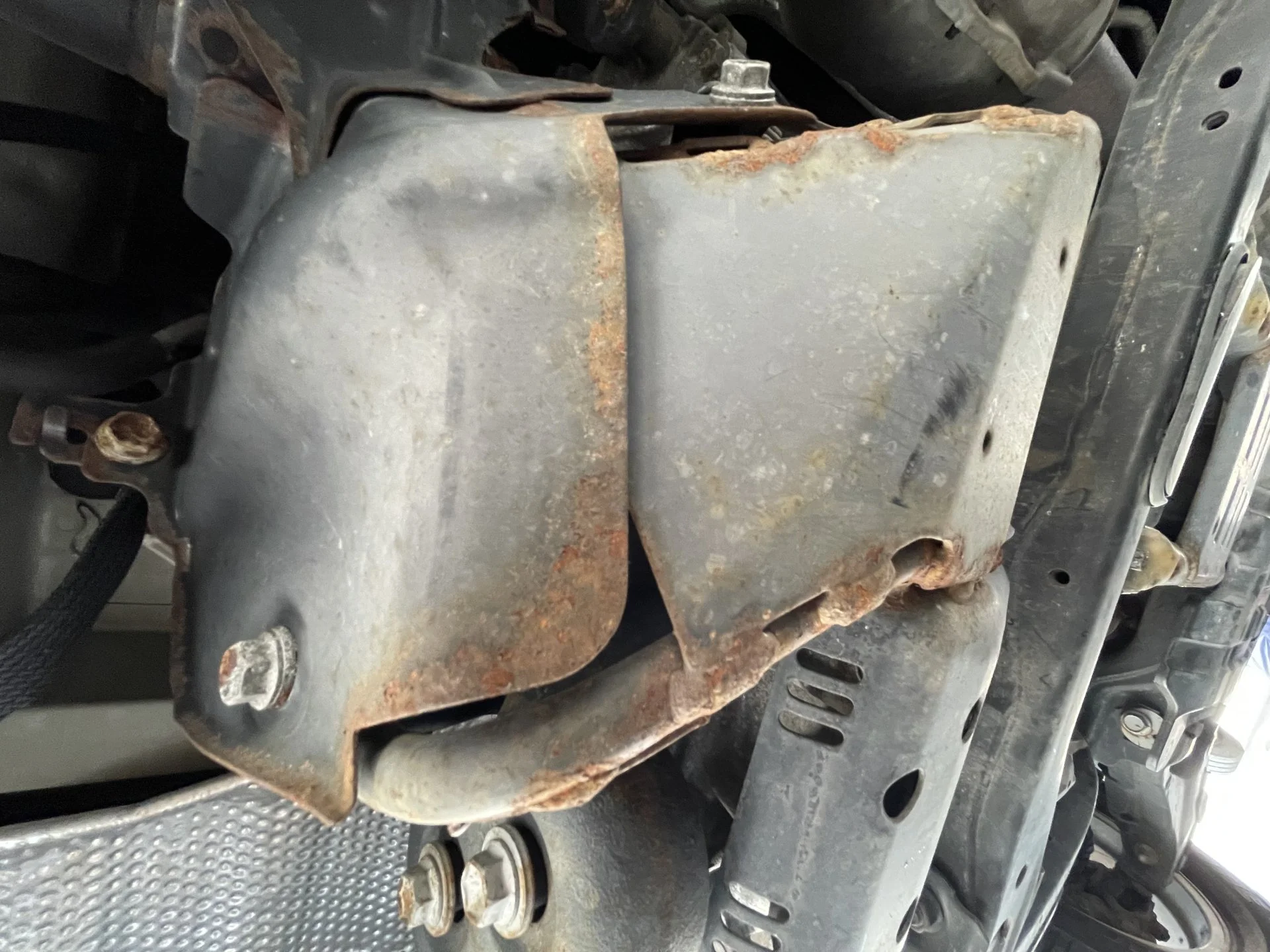

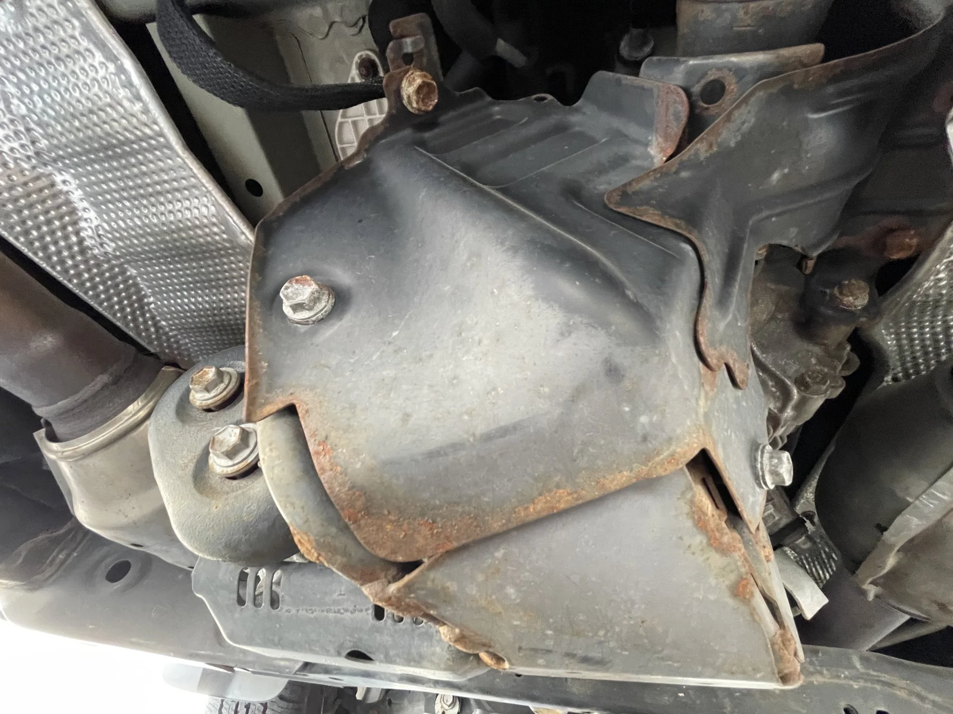

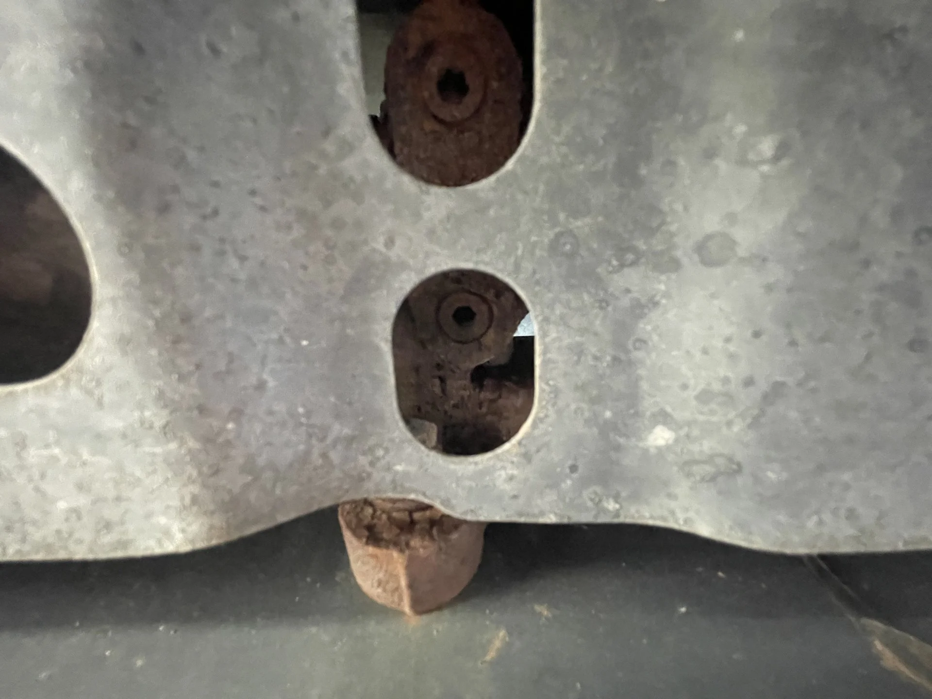

  • KDSS Valves - I tried to find them and take the best pics I could, see below and let me know what you think please

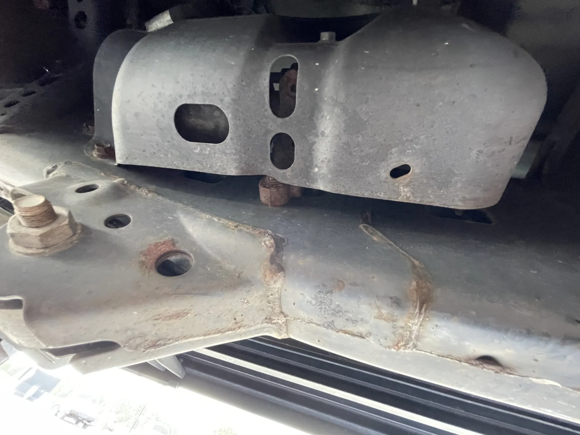

  • Rust - some areas looked ok and others I'm not sure. Same as above re: pics and your thoughts

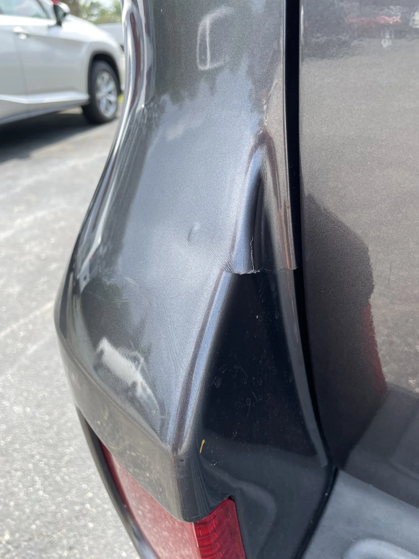

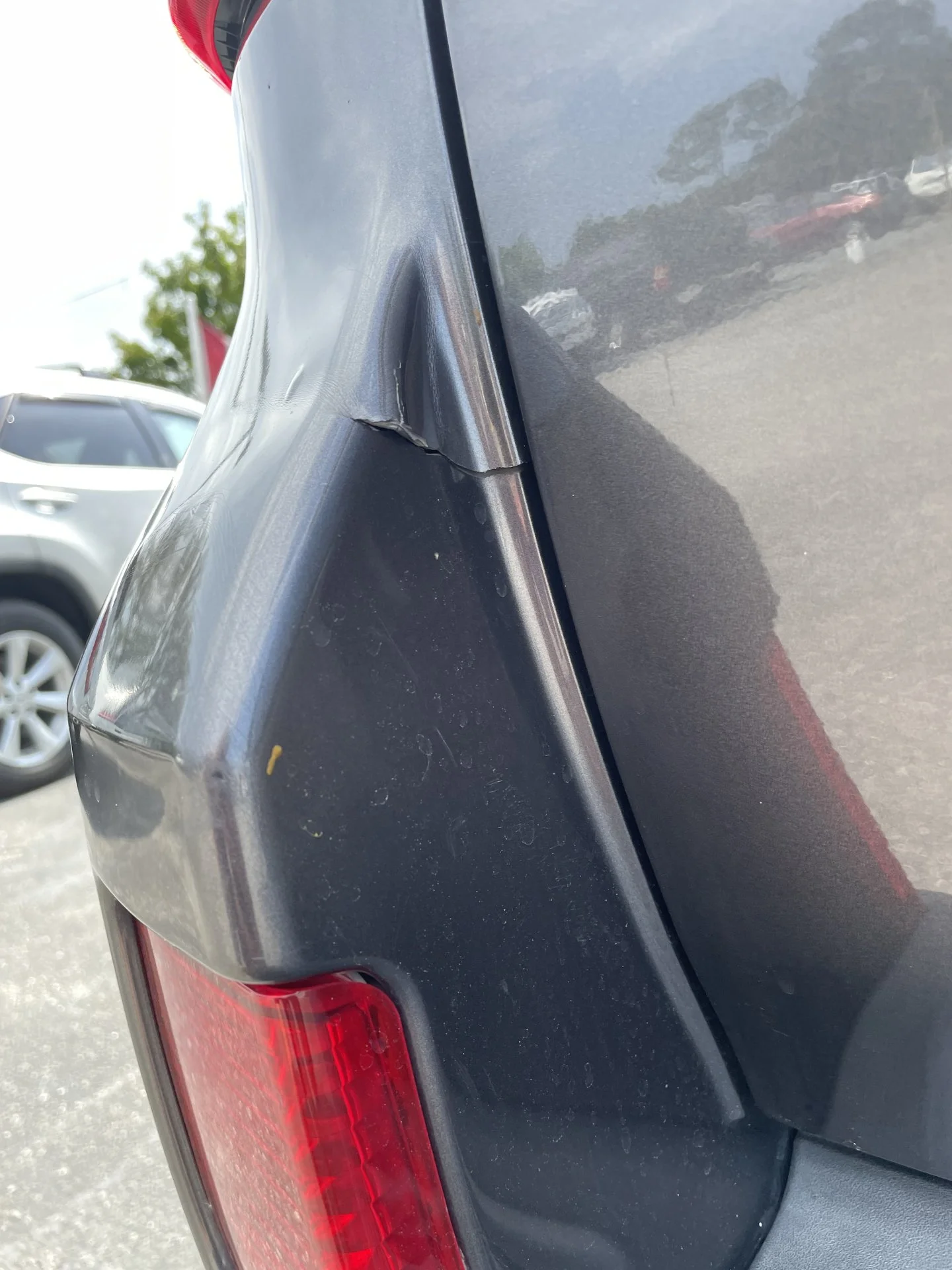

    • L rear bumper cracked (2 pics) and R side scratched, should it be replaced?
    • 2 engine tray bolts missing - to be replaced by dealer

The KDSS shutter valves look the usual awful. They may be salvageable, but no guarantee on that. The rest of the rust is an odd mix, bad in a couple spots but generally light enough for the year and miles.

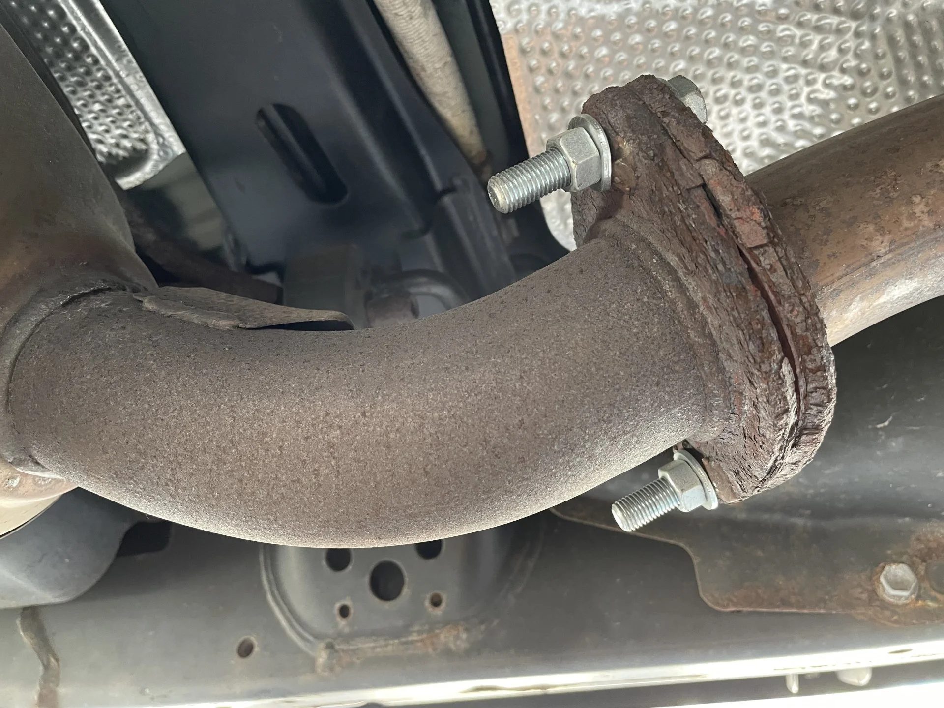

The recent work on the exhaust system (new bolts) may have been to replace a blown out gasket that went bad due to rust. That may or may not hold up.
Any explanation on the damage to the rear? Bit of an odd place for a break and deformity like that.
In my experience, dealers are not better at a PPI than a good indy shop, and in places where land cruisers are rare, they can be worse. Dealer techs ignorant of Land Cruisers can miss stuff (these are not the Corollas they do every day) and they can find things wrong that are really ok in hopes of making service sales. So, take any PPI for what it's worth, a quick look at the simple stuff that can help with a buying decision.
I agree with Sandroad on most points. Not the worst KDSS, but that thing may not want to crack loose. Rust on the transfer skids not that bad, that's all easily replaceable stuff if it turns into a problem. The exhaust repair worries me a little.. from stock there are studs and nuts. They needed to get it apart for some reason, most likely that corroded flange leaking. So they couldn't get the nuts off the studs and likely torched it all apart, then replaced with bolts. Recently, by the condition of those new bolts. I'm betting that flange doesn't hold up, but then an exhaust repair isn't difficult or expensive.
The bumper damage looks like they just backed into something. Happens a lot, not the end of the world, but it will cost money to fix and therefore should impact valuation.

  • KDSS valves - again since I am a novice to the LC world, what is the seriousness and/or what are the consequences to having rusty KDSS bolts? Is it only an issue if I wanted to do any suspension mods in the future like a lift or an aftermarket suspension? If so, probably not a big deal because I will likely keep it stock. But if it could be an issue for just regular maintenance then how concerned should I be?
  • I had the same thought about what I felt like mild-to-moderate rust in some spots and then zero rust in others. I'm still not sure what to make of that if anything at all...
  • I asked about the crack in the rear bumper and he did not have a great explanation. He thought maybe someone backed into it but that was about it. I feel like I would want that replaced though as that could become a bigger problem with water getting in there. Any thoughts on what a bumper like that would cost? And if it would need to be painted to match as well?

There isn’t a path of entry for water behind the bumper skin. You could take it off entirely and be fine as far as weather goes.
Spray some penetrating oil on those kdss, give them 15 min, and try to loosen them. If it seems a no go then you know it’ll be a battle. Many have gotten free after a week of wire brush and penetrant. A few have not had success and it became an issue.

Good call on the pentrating oil and wire brush. Sorry for my novice level of knowledge, but what is the exact issue if the bolts are seized? Is it only an issue if I want to do suspension work like a lift or replace with an aftermarket suspension? Or is it something that can cause an issue associated with regular maintenance over time? Thanks for your time and help.
Nothing related to regular maintenance. The system will function fine with the valves rusted shut. I opened mine 3 turns when I added air bags to the rear springs for towing. Someone like @bloc will need to weigh in on whether they need to be opened for shock replacement.
If you get the truck and go after those valves, I’d give penetrating oil a lot longer than 15 minutes. Even days before trying to turn them. My favorite is PB Blaster, but it smells bad.
I've seen reports of successful suspension R&R without opening them but they reported it was a total pain in the ass. Our front sway bar is very thick, and even with KDSS "disconnected" managing the end links is a difficult job. Having to do them both at the same time because you can't get the bar to flex would be a nightmare.
But that's assuming work that would keep you at the same ride height.
Any changes in ride height, such as a lift, or even the OEM toyota 10mm front strut spacers.. will induce a serious lean if the valves aren't opened, from what I've read.
