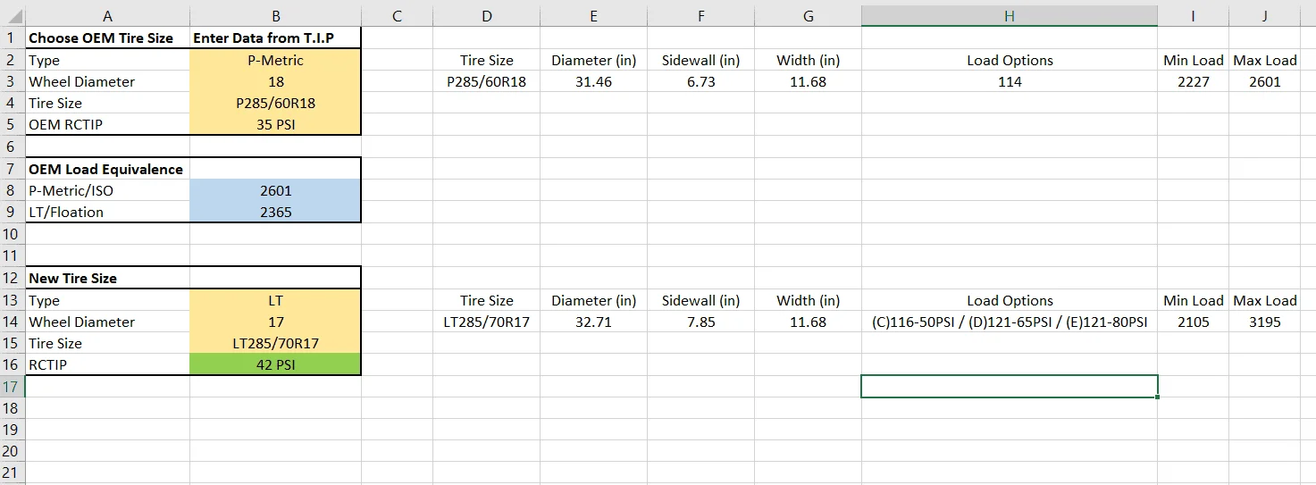

I was doing a deep dive into the tire pressure tables because I got bored at work.
Anyone know how T&RA and ETRTO derive the data for the inflation/load tables? Is it real world testing at different speed/load and checking tire temperatures? It's also strange to me that these tables aren't tire model specific in any way. It's all calculated just from size and load ratings. And really the load ratings don't affect the tables, other than the max load. A load C and load E LT tire will have same RCTIP assuming the load is within range of both tires.
The guide that gets posted here regularly, doesn't really speak to where the data comes from. Also it says to calculate load between data points in the table you can do a linear approximation. But strangely, the data is not linear across all it's data points per tire size. I was going to make a quick cheat sheet to calculate RCTIP based on min and max load and min and max PSI, but I noticed pretty quickly the calculated data didn't fit the tables.
Either way, for everyone's RCTIP pleasures, I'm attaching the spreadsheet I made to calculate RCTIP. Looks like you can't add a .xlsx file to mud. Here's a link to it on Google Docs. I don't think Google Sheets will run it very well as I'm sure I'm using some Excel only features to make everything work.
It has a lot of tire data also that you can use to compare sidewall and sizes. There is no "real" tire data in here, only calculated from the tire size and matched to the inflation tables.
Based solely on the data I have gone through, I'd say RCTIP is probably just a good starting place, but certainly experimentation with different pressures around RCTIP are more than safe enough and in some cases may be more ideal than the standard RCTIP calculation. It seems the recommendations are far too broad (as far as the application) to be a concrete answer to safe/ideal inflation. It all seems very specific with the PSI to load equations and what not, but when 5 different manufacturers can make the same size tire, in AT/RT/MT configurations, and the same tables apply to all 15 of those tires, the specificity loses some of it's shine.

You can try out the spreadsheet if you like. Let’s you enter any TIP info and any non OEM tire and it will calculate the RCTIP. Not that it’s doing anything amazing.. the automation is the only real “fancy” thing about it.

A 33x11.50R18LT needs 46 PSI to match up with the P285/60R18 33PSI of the LC200. But is rated from 25-80PSI.
The quick notes seem to be (mass generalizations, I know, please don't flame me):
P Metric (NON XL) tires reach their rated load faster than any of the others, in AT sizes they seem to have about same load Max as a C-Rated LT, but at 35PSI, rather than 50.
LT has higher bandwidth than P Metric for different load ratings, but min RCTIP is 35PSI
Floatation seems to have the best of both worlds. Widest bandwidth of load ratings and can function from 25-80PSI. Does take relatively high pressures to get to load equivalence with LT and P-Metric.

The min RCTIP of 35 PSI for LT tires is just a practical threshold for documenting tires nominally meant for load bearing applications which is a focus of the reference. It's also a limitation of the reference. It's not some figment that is somehow defining a critical floor to the operational envelop of LT tires. Practically speaking, of course the tires work below that, and many off-roaders do it all the time. People using them in lightweight trailers, lightweight passenger cars, or low speed off-road work regularly run them well below 35 PSI and into single digits. Just that we don't have handholding guidance that exists in a nice table. Could the data be created and document? Sure. Utility of it given all the different variables would be questionable, compared to Floatation tires that are more meant for that application.

This is definitely how I've always taken it and after looking at it more closely my opinion on that hasn't really changed. I tried to reference that in my first post without starting a flame war. It would just be interesting if anyone could post some sort of article or study that shows where any of this came from.
Either way, I wasted a few hours making a fancy spreadsheet, mostly just to see if I could. And now all the data is in one easy to digest place, for me anyways.
