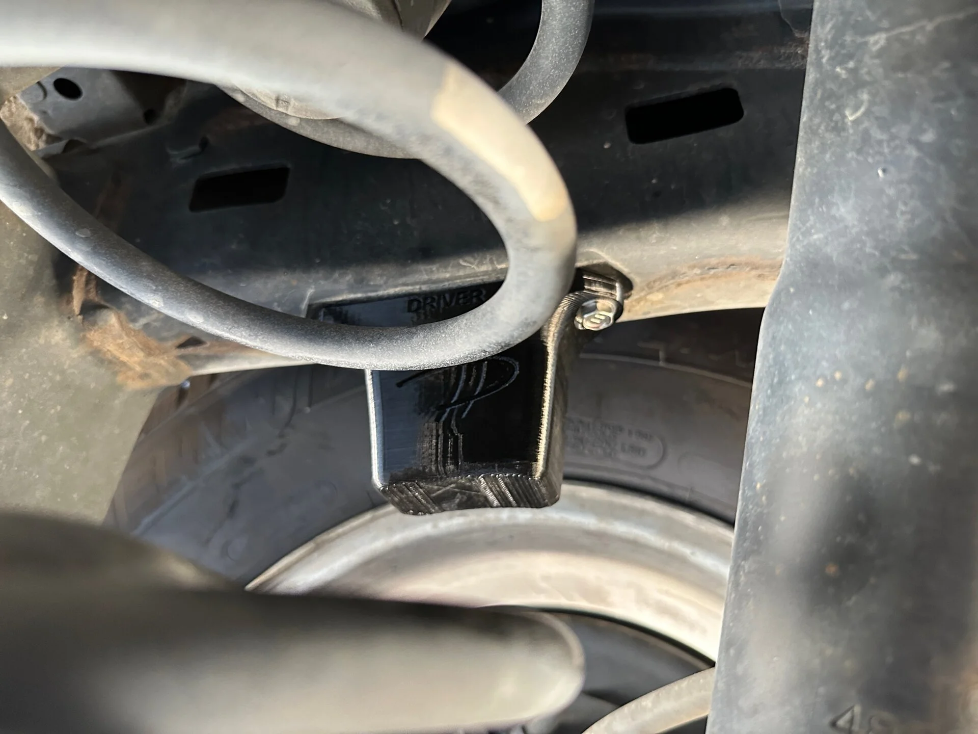

Below is my honest review of PerryParts bumpstop. I have usage from the highway to parking lot, to speedbumps to of course some trails :)
(Items were paid for in full, no Instagram shill here :))
Before we begin this review is not bashing the other brands just my honest experience having used both DuroBumps on previous trucks/LX570 and PerryParts on my AHC LX570.
Everything in this review is regarding the LX570 with AHC, (Note: I have a slight AHC lift on my LX, about 1 inch in the rear and .75 in the front.)
When I first saw PerryParts bumps on my IG feed I was hesitant... 3D Printed bumpstops that advertise themselves to be able to compress differently at high and low speeds? Sounds too good to be true. A few months past and I see the Owner (Patrick) post comparison videos and develop great graphs that show how it is possible to have both high and low speed compression damping.
In the end this is the video that made me pull the trigger on these bump stops -
What led me to purchase PerryParts bumpstops?
The Front
Before I purchased PerryParts bumpstops I ran the 200 Series Durobumps on my LX570. At the time I had my AHC at stock height and then raised it up 1inch in the rear and .75 in the front. Upon installing them I noticed that when the truck enters fast-low the front suspension engages way to early going over bumps at freeway speeds, both with stock AHC height and raised .75 inches.
When using easy exit mode the front of the truck took a little while longer to settle and enter L and I could feel the truck resting on the bumps, again both with stock AHC height and raised .75 inches.
The Rear
Regardless of stock AHC height or raised 1inch in the rear I felt the rear Durobumps engage way too early both on road and off-road. So much so it is what led me to search for an better alternative.
My opinion is DuroBumps are not an option for folks who have stock or slightly lifted AHC. They will engage too early and were not created with AHC in mind.
THE PerryParts bump stop review
Once I installed the PerryParts bumpstops it solved all the issues I experienced above.
- When entering fast-low I now use more front suspension without engaging too early
- Easy exit mode works flawlessly without taking time to settle and does NOT rest on the bumps
- The rear now engages smoothly and no longer has that harsh bottom out feeling
In addition to the above the engagement of my front and rear is so much smooth. When going over bumps on the highway I have a very smooth engagement that I never knew was possible with aftermarket bump stops.
The rear engages firmly and is smooth without any harsh bottom out feeling.
Off-road when the suspension compresses at low speeds it again feels firm and smooth, the rear engagement feels like a soft "touch" vs a "hard bang" if that makes sense.
TL;DR
- PerryParts offer great bump stops with a great price point
- Engagement of the bump stops feel smoother and firmer without the harshness of others
- If you have an LX570 with AHC, I feel PerryParts offer a better product than its competitors
- Being 3D printed allows PerryParts to offer many different applications while being cost effect and still retain its durability. I have YET to see a post of a PerryParts Bump Stop failure.
I highly recommend giving PerryPart bumpstops a try, the smooth and yet firm engagement upon suspension compression is way better than anything else I used on the market and they offer many applications.

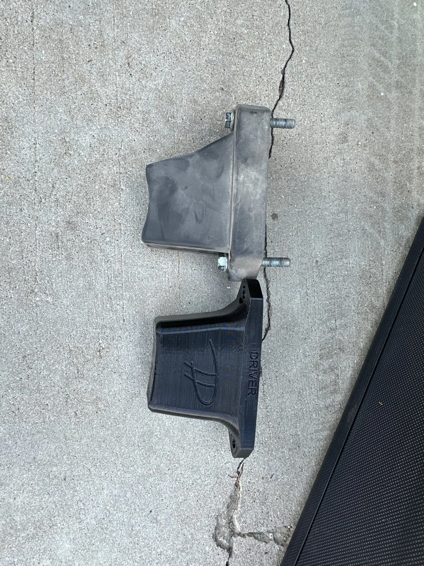

Glad everyone is enjoying Perry’s Parts. Owner seems really cool as he also helped bring the bump stops over to the Montero platform with my feedback!
I sold my 200 and got into a 100 series. I’m looking to buy the bumpstops but the prices seem to have gone up quite a bit! Not sure what the new design does, but I’m a big fan of the OG version!

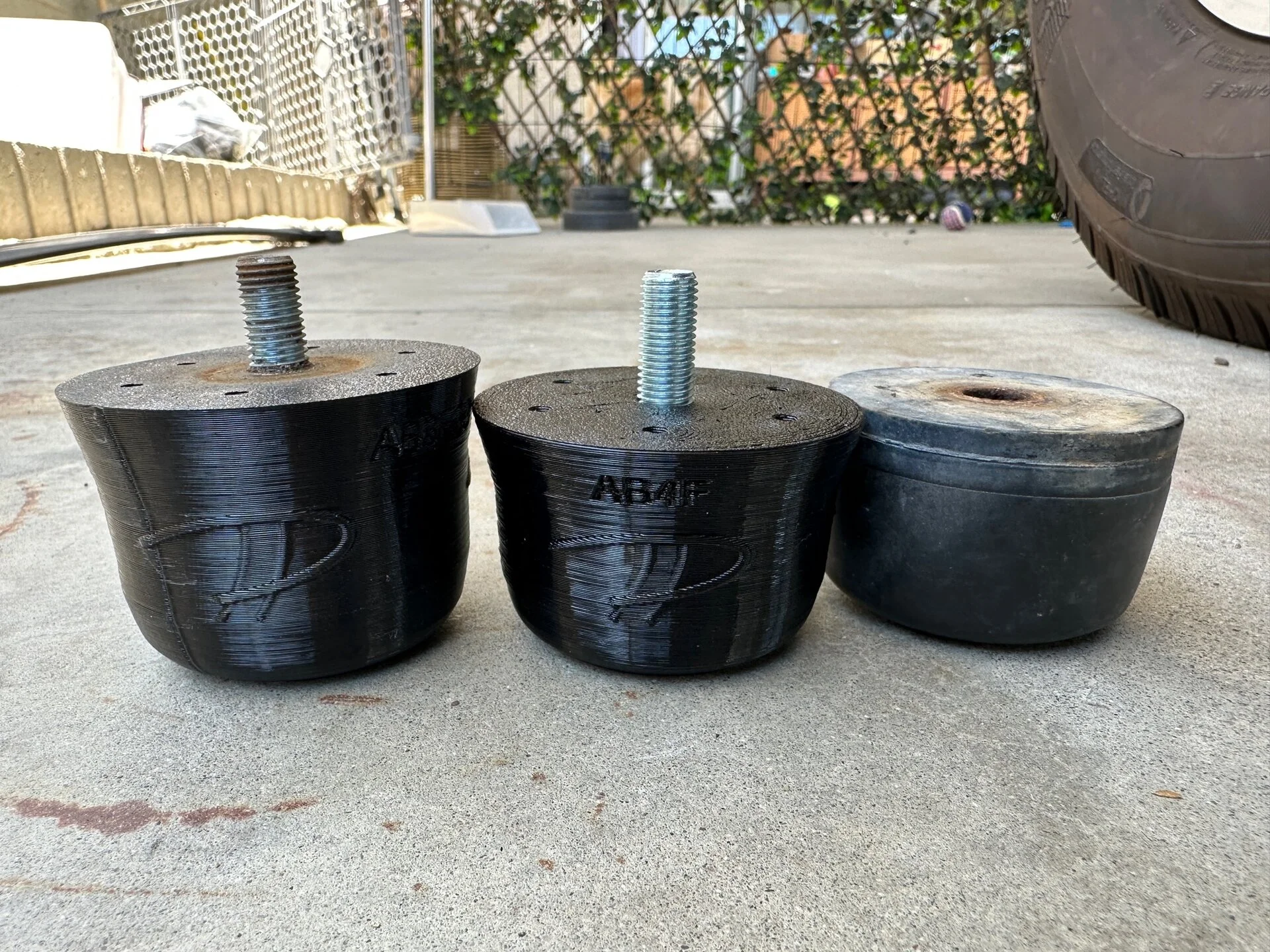

We did come out with a new design, but our previous design is still for sale! (We didn't want to be the brand that just hikes prices after they get popular.)
The big differentiator is that the new design is fully modular, meaning you can add and remove spacers and inserts to change both the stiffness and the overall height of the bump stop. We've tested them to 5 times the longevity of MK2 (500,000 cycles), and they carry an 8-year warranty. They also hold an enormous amount of air volume, meaning the patent-pending air damping is markedly improved compared to previous generations.
Again, MK2 is still for sale, and we still fully support it. We just really wanted to be able to show and offer the best product possible at the same time. MK3 is expensive to produce, about 8 times the cost to manufacture. And is the culmination of the last two years of development on our end.
