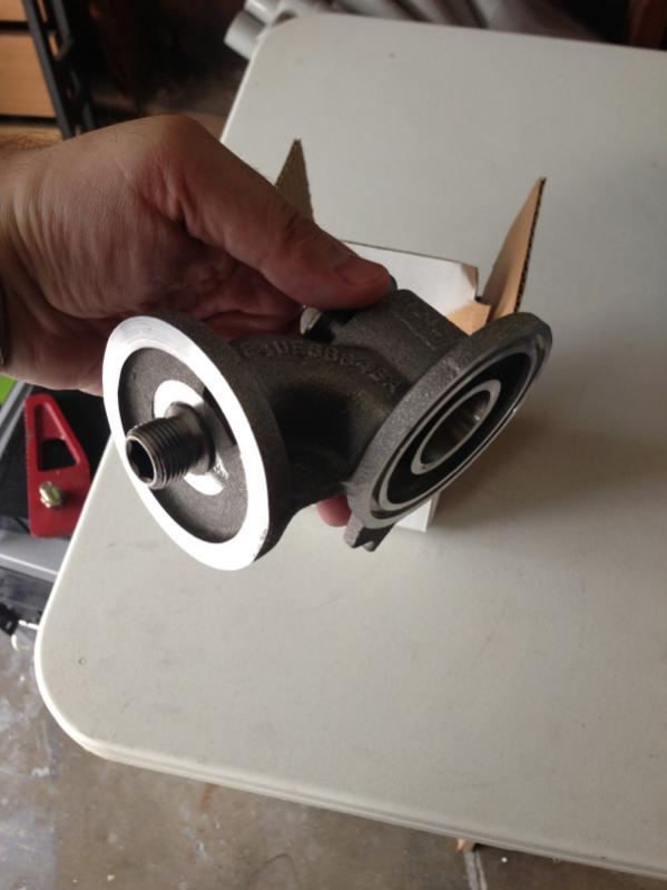

Also it's been found that using the Ford 90* adapter for the oil filter eliminates the rattle as well by turning the oil filter upside down and thus holding oil in the filter regardless of length of time the truck sits.

There are at least two threads on it. This is the oil filter adapter:

What NLXTACY said: with the 90 degree adapter installed I have zero rattle on start-up.
Wow, that adapter is spendy. Anyone have a link to a decently priced one? Or is that just what they cost?
You might find them on sale, think I paid about $80 shipped. I looked high and low comparing many different adapter models and styles and this Ford-Racing adapter was the only off the shelf bolt on solution I found. The best part is that installing this adapter is as easy as changing a filter.
