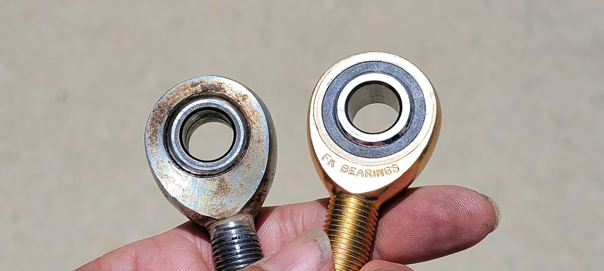

I ordered 12" piece of 1.5 x 2 x 1/8 wall aluminum tubing for drop brackets and 1/2-20 LH self lubricating replacement ball joints from McMaster Carr. It took me a while to find high quality replacements for my sway bar end links that didn't cost an arm and a leg. I also ordered front sway bar bushings for both the frame side and axle side.
Ball joints for the end links were replaced first and it made a huge difference. No rattles no squeaks and it only took about 5 minutes per side.
