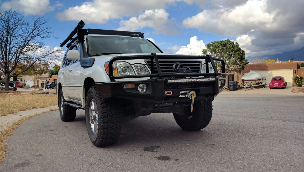

Here comes my biggest complaint about my Gamaviti rack. The little bracket holes I had added to the expo bars where I bolted the lights was kind of ridiculous. Its impossible to get any tool on the backside because of how close the hole is to the bars. I ended up having to hold the backside bolt with a pair of pliars then twist the lights/bolt until it got tight. In doing that, I pulled off a bunch of powdercoating, which brings me to my second complaint. My rack is rusting all over because of how bad the powdercoating is. Its beginning to rust in the crevices where the mounting platform meets the bars. It scrapes off with a fingernail too. I would probably think twice about having them powdercoat it if I still lived in the NE.

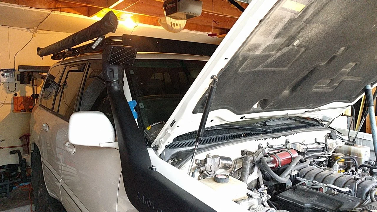

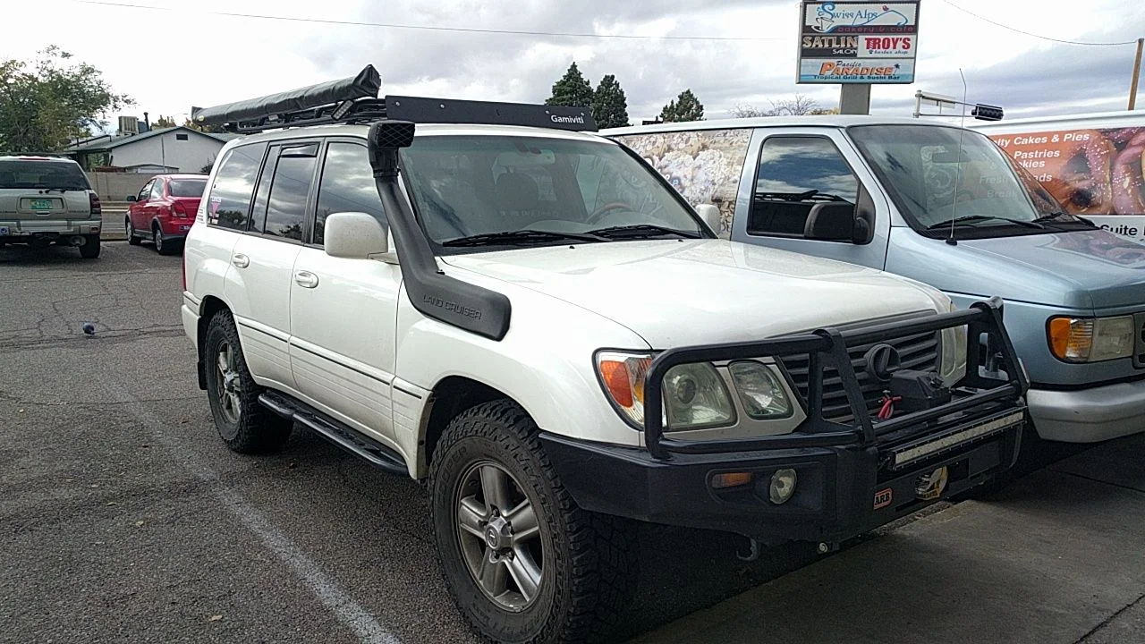

Installed the eBay snorkel. Really happy with it, especially for $70. Its really strong and the hardware is nice. The only thing I changed was using nutserts on the 3 A-pillar mounts instead of the rivets. Im sure the rivets would work fine, I just like the nutserts a lot morre.

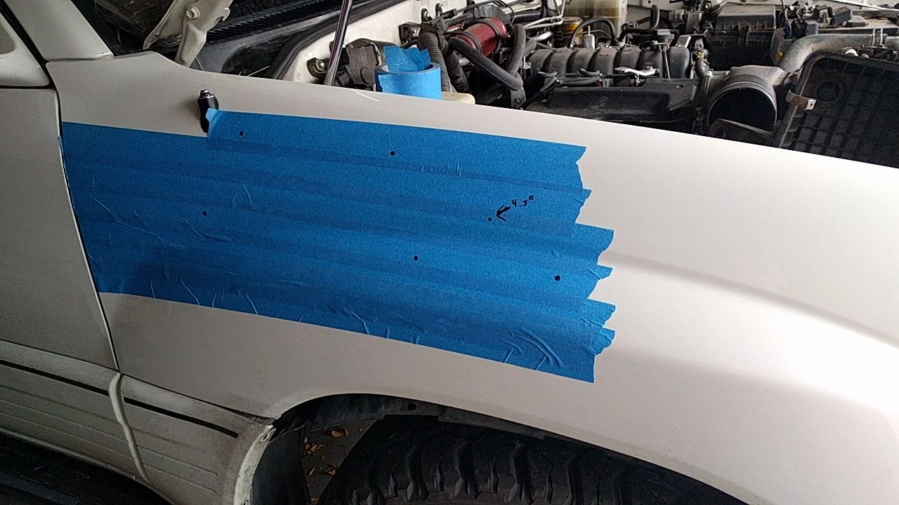

First thing to do us tape off the area so you can mark the holes using the paper template. I didn't get any photos with the template but it's pretty straight forward. Just line up the top and door edges then use a marker to mark the holes.

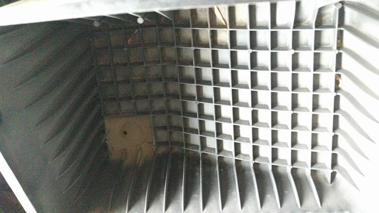

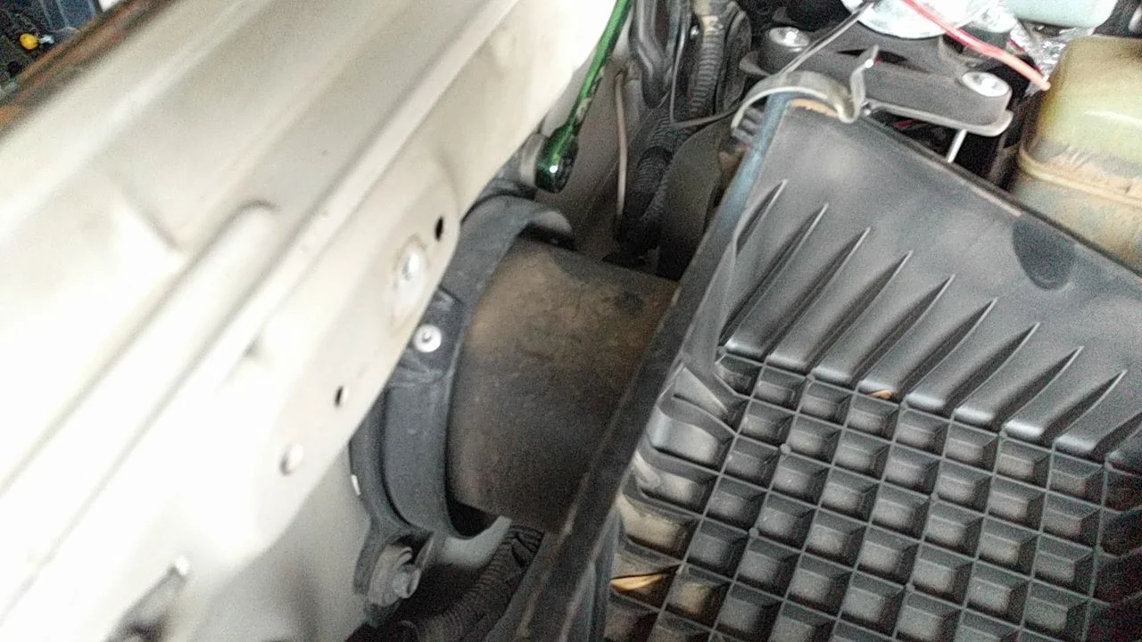

Before drilling any holes, remove the air box, the attachment that goes into the fender, and the inner wheel liner. I didn't entirely remove the liner because it's a pain to get the plastic tabs behind the side molding.
Also, in my 06 there's a hole in the air box for water to escape. I sealed it up with some RVT.

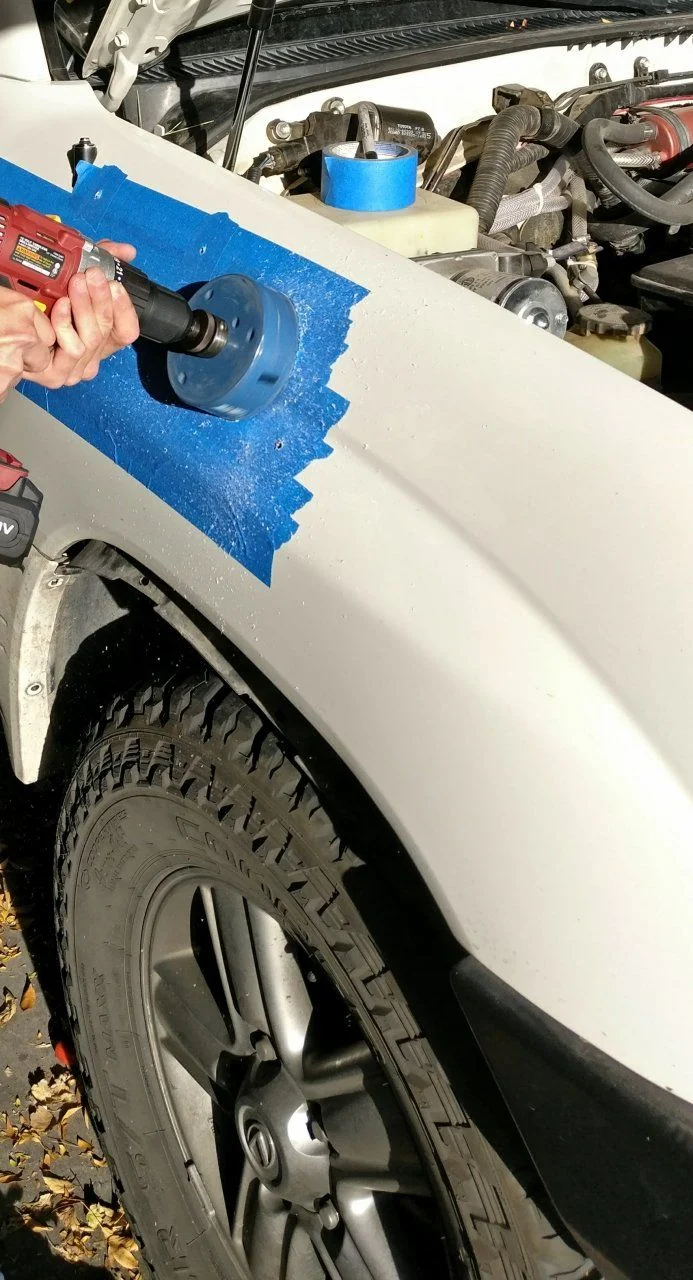

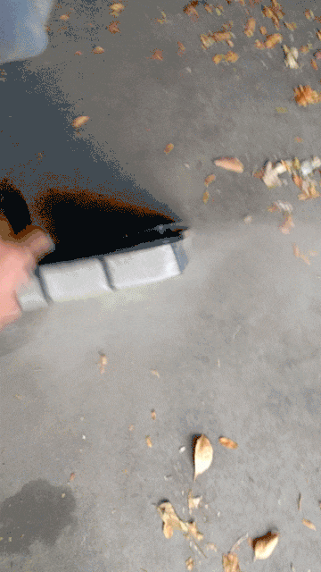

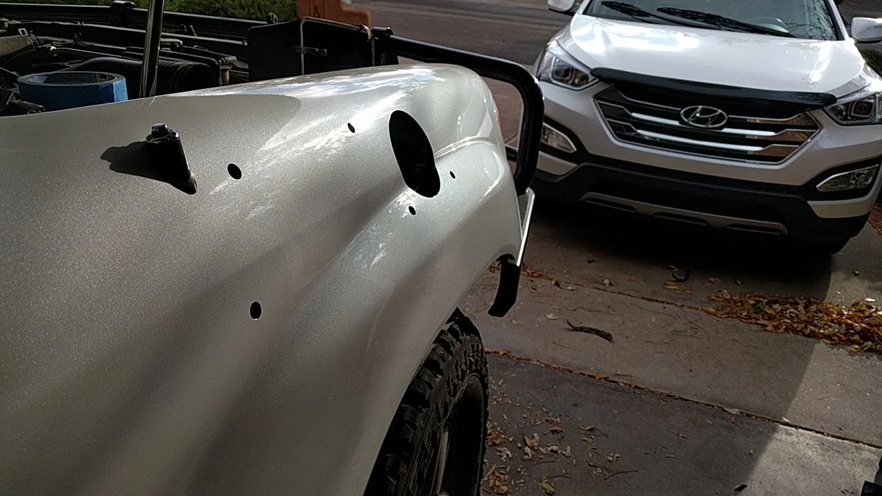

Now to make the holes. I spent about 3 hours procrastinating and doing anything else in the garage that I could find to do just to avoid picking up the drill. It was extremely nerve racking. I started with a small drill bit for the bolt holes which made making the big hole easier. Once you make one hole, there's no turning back. Easier to start off small.
Next up is the A-pillar mounts. You have to install the snorkel then mark where the A-pillar mount sits on the pillar. I had to bend my snorkel a bit to get it high enough on the pillar to not interfere with the door opening. Not a huge issue but annoying.
Once you mark it, take the snorkel off then line the braket up to the marks you made. Then mark the holes and drill.

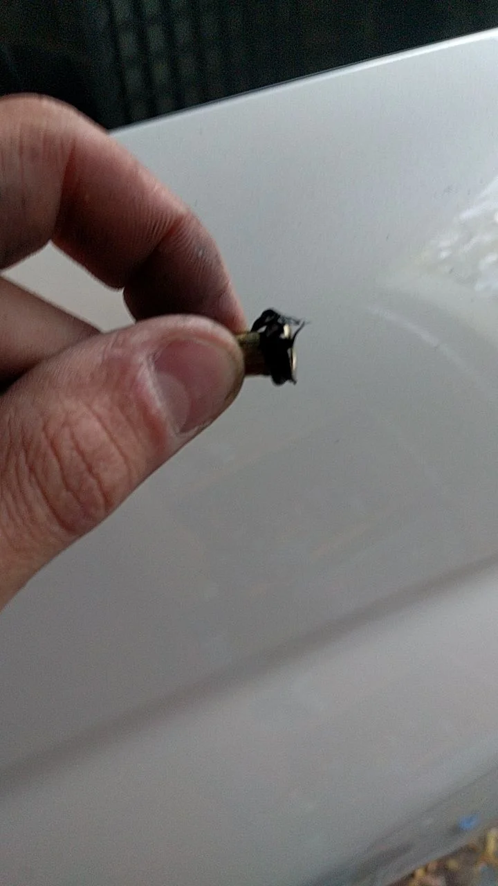

Then use either your rivets or nutserts. I covered them in RVT so they would be waterproof and keep water out of the A-pillar. Be careful as my middle bolt wouldnt go all the way in because something inside the A-pillar was blocking it. I ended up having to cut the bolt a bit shorter to get it in.
Last thing to do is paint the holes you made to prevent rusting then install the snorkel. I had issues getting the studs through the fender without scraping the paint so I put some RVT around the studs on the snorkel so when it presses against the fender, it covers any bare metal.
