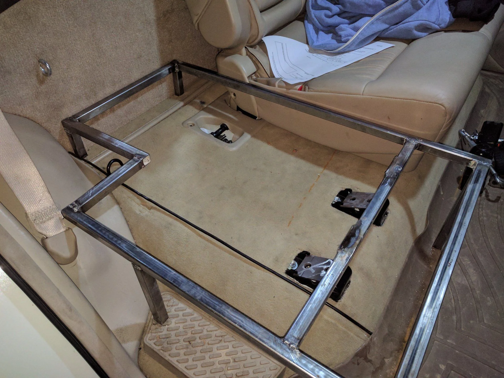

Started and finished a fridge platform this weekend.

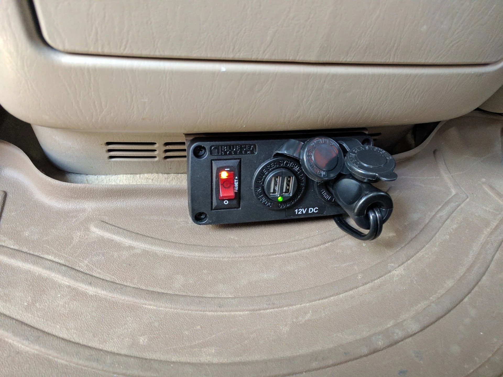

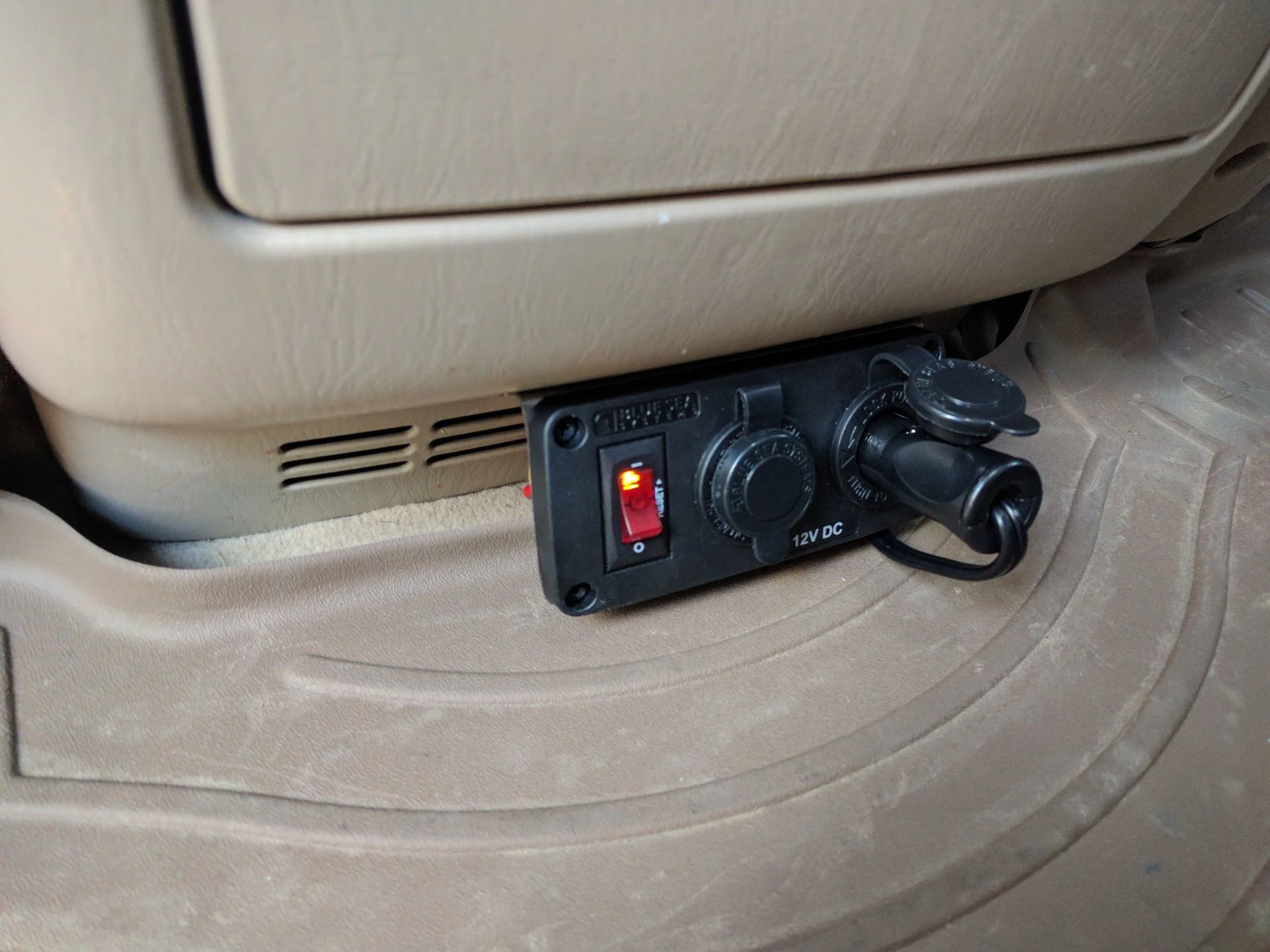

Just curious if you're worried about the rear heater vents causing your new panel to get too hot.
Thought about it then decided I wasn't worried. A couple factors came into mind. Pretty much nobody ever used the rear controls because of how awkwardly placed they are, the panel is pretty stout as far as wiring and connectors goes, and lastly, many many people put their phones or GPS units on those vent holders and never have issues and those would be way more vulnerable than 14+ gauge wiring and connectors.​
Understood. My rear heat gets used a lot with the 2 kiddos sitting back there so I have a different perspective. my '99 LC has a panel that pops out of the back of the console just above the cup holders. I'm assuming it's a cover panel that other models must have some controls in but mine was blank. That's where I installed my USB and 12V socket for rear seat occupants to use. I've used those vent holders for my SiriusXM receiver and that sucker gets hot.

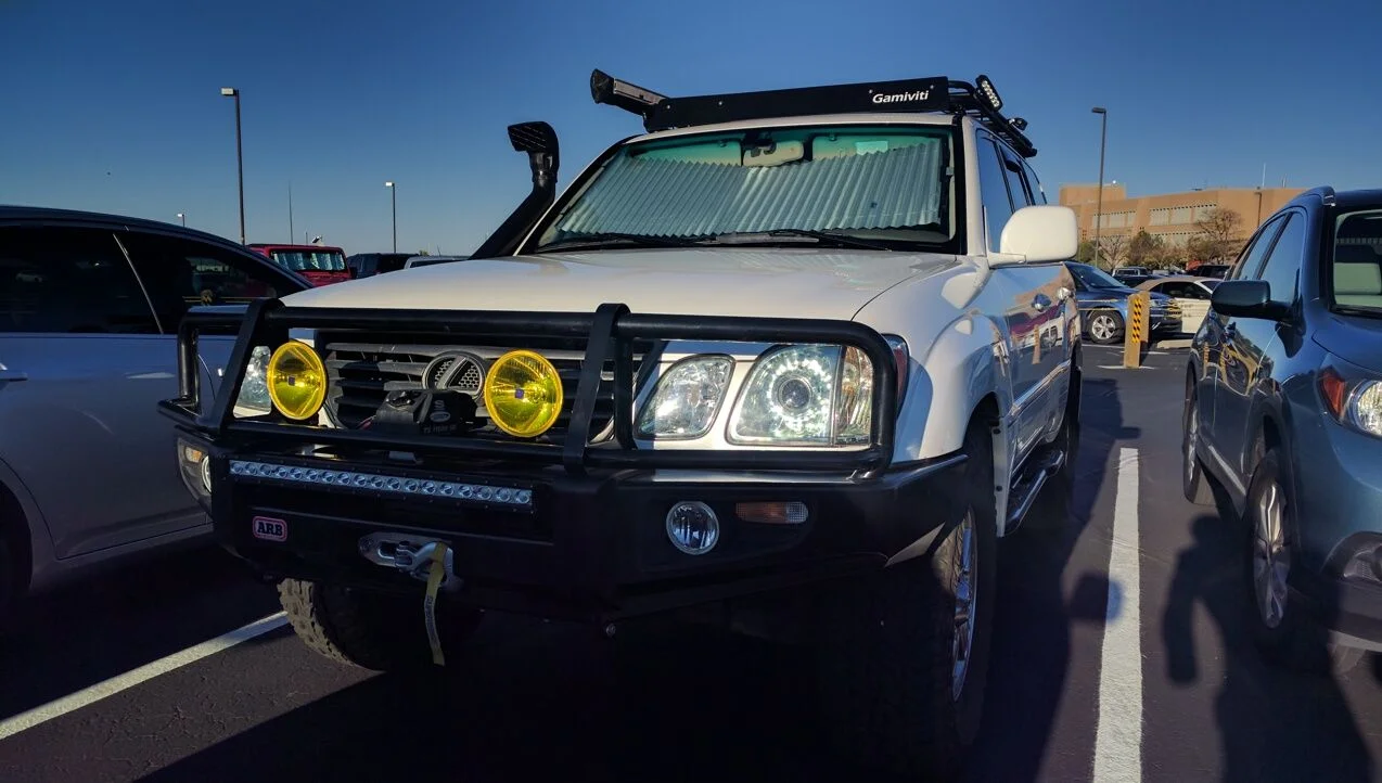

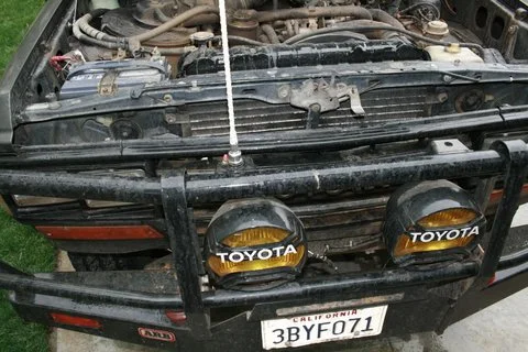

This isnt an LX but you can see the two tabs on this bumper (one with an antenna mounted). You'll have to cut those both off entirely with an angle grinder to be able to open the hood on the LX.
Hope this helps.
I am about to purchase a Deluxe ARB for my '07 LX. After you cut off the antenna mounts, what did you use to paint the ARB to match the color?

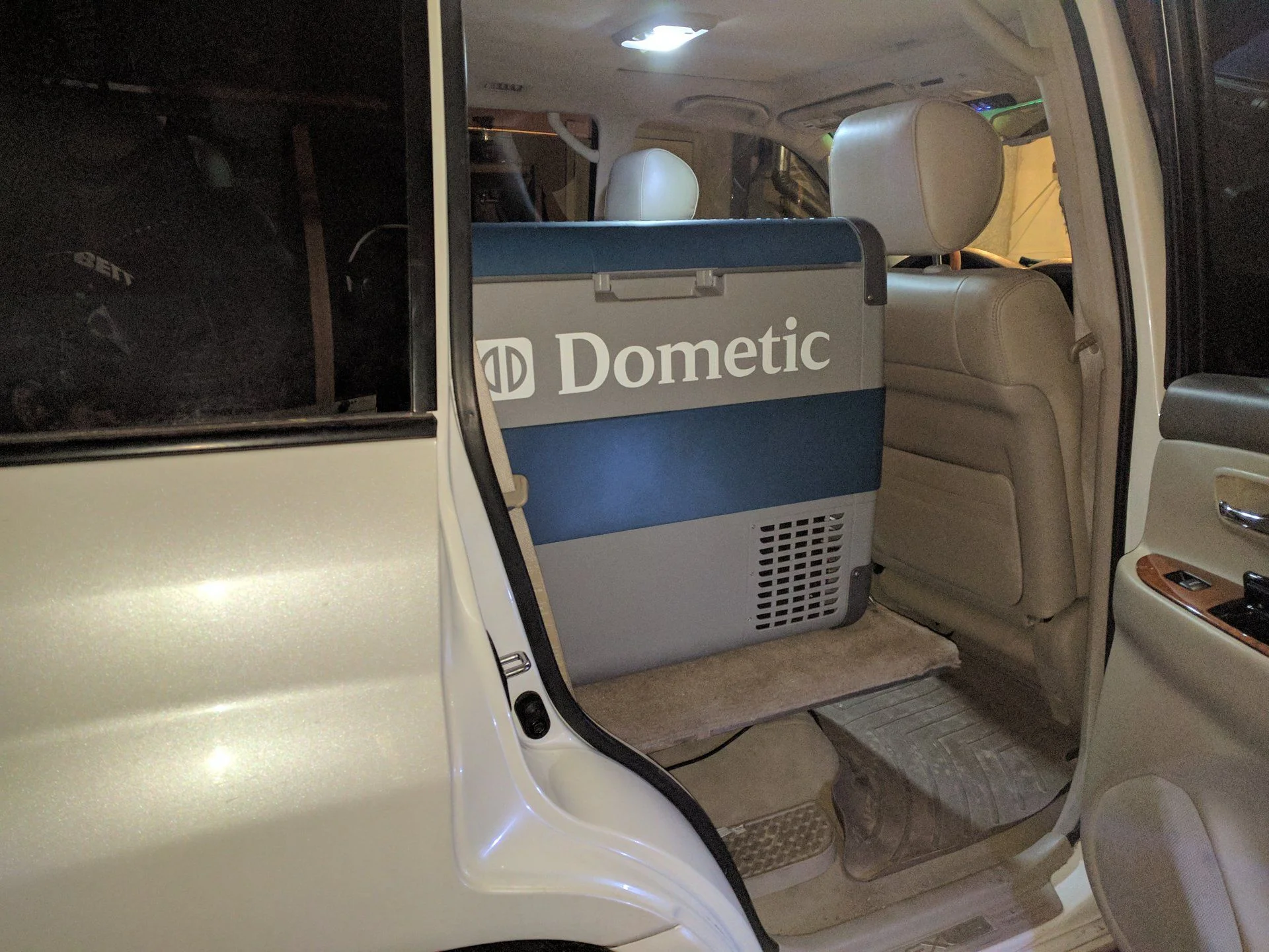

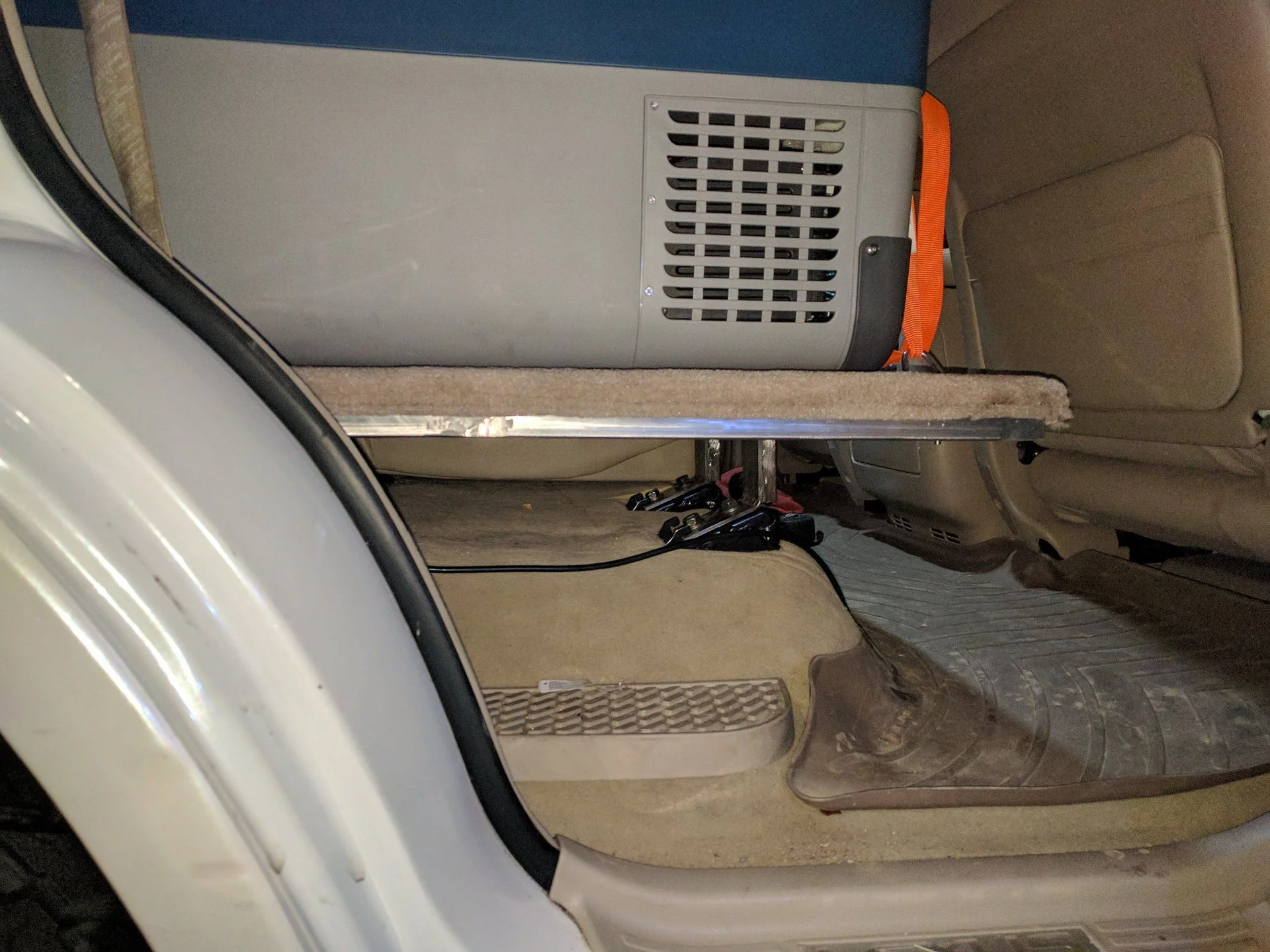

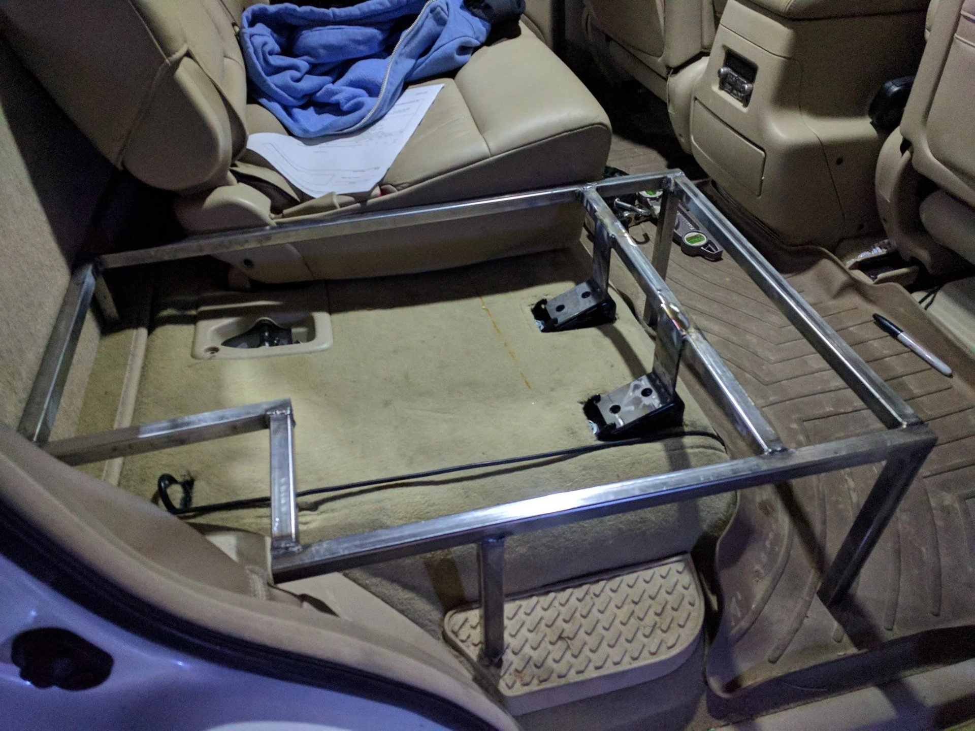

Nice work, just wondering, what is your number one reason for the fridge in the second row?
Dogs. We have 2 huskies that go everywhere with us. The have the back since it's netted off and keeps them from tearing up the seats. Also, we typically are only caring us two and the dogs when we need the fridge. If I need to carry more than 5 people, I can switch out the platform for the seat (about 10 min job).
Second reason would be the height of it being on the drawers. I always see people trying to come up with fancy ways to be able to see in their fridges (drop slides $$$$ or a mirror on the inside lid). With this setup, you can easily see inside.

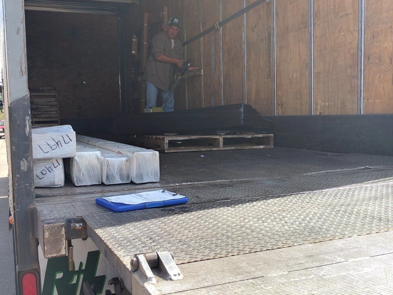

Got my outpost off road opor sliders via freight yesterday! I got them late in the afternoon, but thankfully for daylight savings, I was able to get them cleaned, painted, and mounted before bed time.
Arriving in the truck. Guy had no idea what they were.

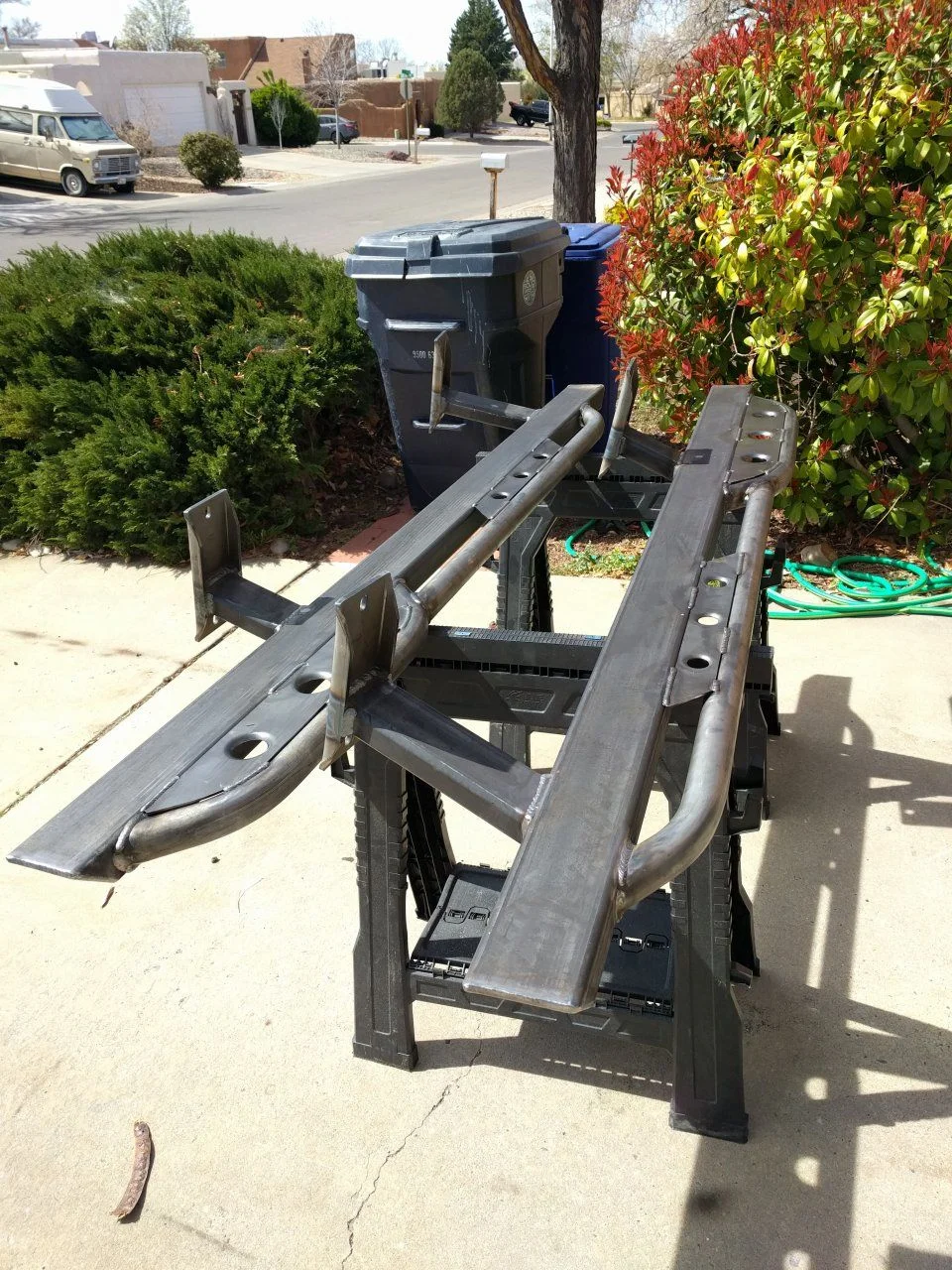

I immediately unpackaged them and threw them up on some sawhorses. Thanks to @alia176 for that idea.
All cleaned up and ready for some paint. I went with VHT Epoxy paint as I've used it before on custom built racks and when I put an 8.8 in my heep and always had awesome results.
All painted! I let them bake in what was left of the sun for a few hours then moved them into the garage and mounted them later that evening.
I have to say, overall I would give them a 7 or maybe an 8 out of 10. My biggest peeve was that I had to remove the covers for my AHC accumulators. I also had to cut small bits out of the rear most "skid" plate. I probably would have been okay with that if it was something I was told up front before. Also, not having any directions whatsoever made it more difficult to decide if it was made wrong, or they expected me to make those modifications.
I like them though, they seem very stout and I hope to get to put them to good use.
