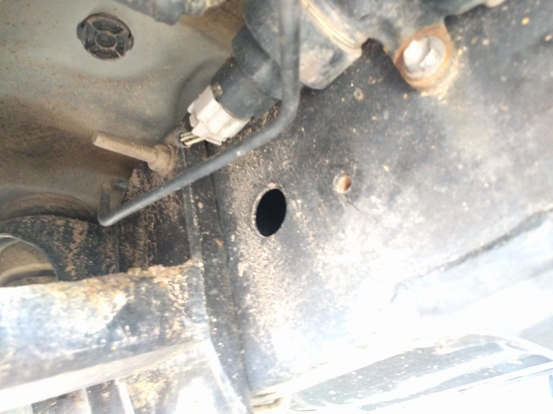

Here is what my rear driver side looks like.seems the line is already an inch away from the frame on mine. You can slightly bend the lines but be very careful as they crease easily.

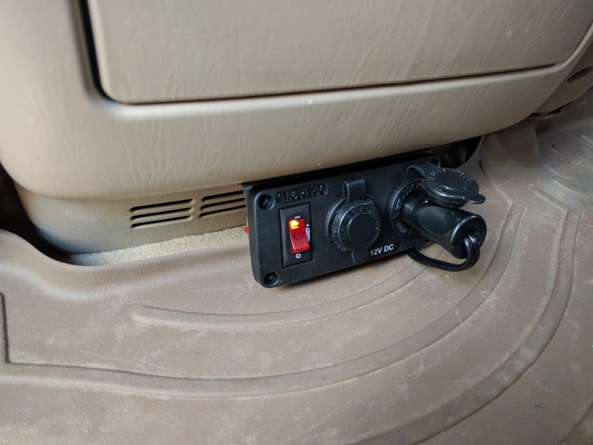

Did you fab up a small bracket to attach the blue sea panel? Also what did you attach it to?
I did. I used a small piece of stainless (20 gauge I think) and cut it to fit the panel and bent it to an L. Then bent it to be able to screw into the plastic of the console. I usually don't like doing things like that as it's irreversible, but it seemed to be the easiest location and the screw holes in the console are on the inverted part so you wouldn't really notice if you took them out.

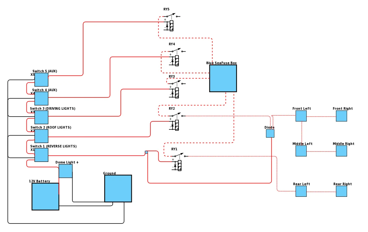

I'm getting close to finalizing my switch panel and wiring for multiple accessories. Not sure exactly what I'm going to power, but I have 5 options.
I took a stab at creating a wiring schematic (never done anything like it before). Im 100% certain it's not totally accurate but I can understand it haha.

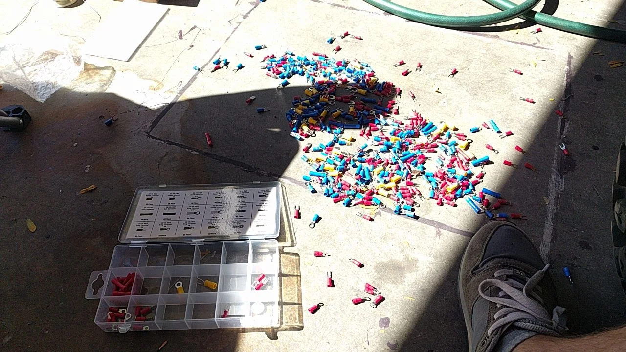

Here's a pic of why you never leave a 520 peice electrical connector set open and on the ground
I'm getting my act together to wire up my roof rack lights, and I can't figure out what the diode is for??? Do you recall?
Thx, CB
Thx, CB
The diode was to isolate just the rear lights from all the lights. So, there's 6 lights total that turn on with a switch, then just the rear two turn on with a separate switch. If the diode didn't separate those two on that switch, it would turn on all six the same as the other switch.
It's confusing, but hopefully makes sense.

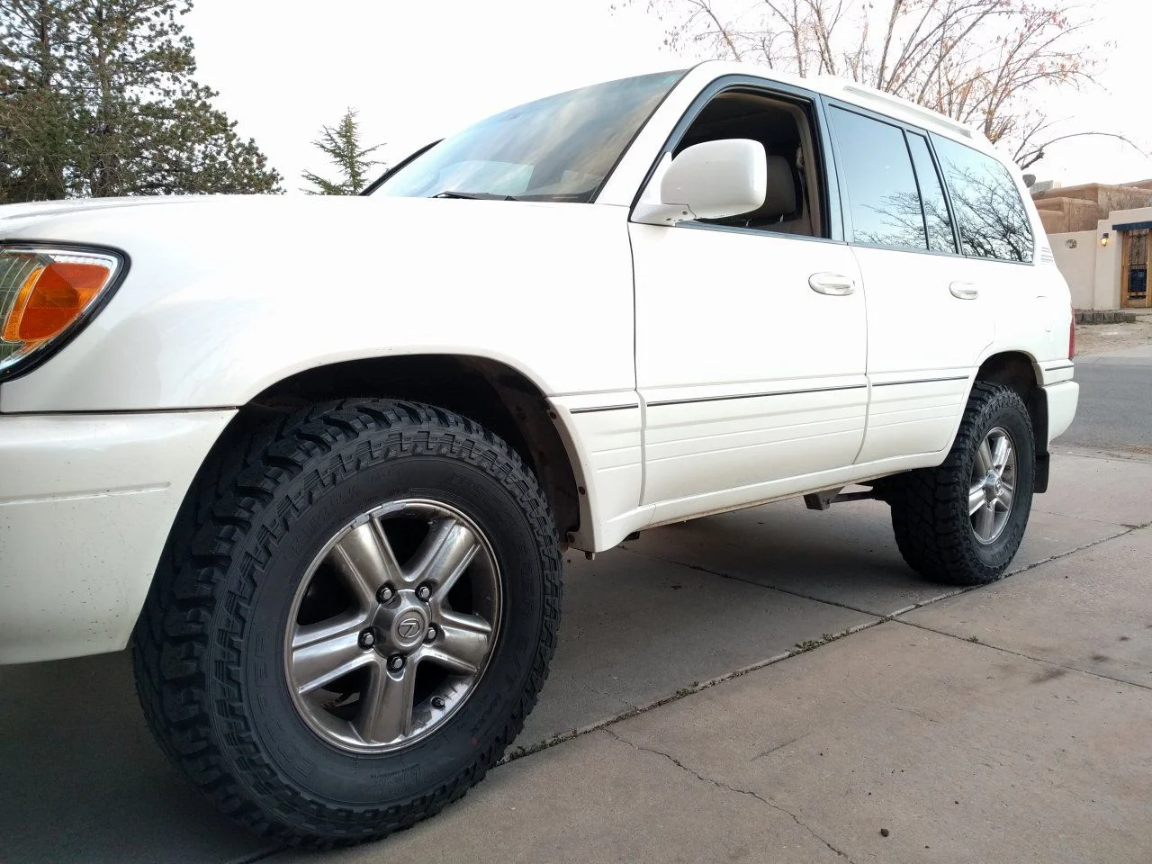

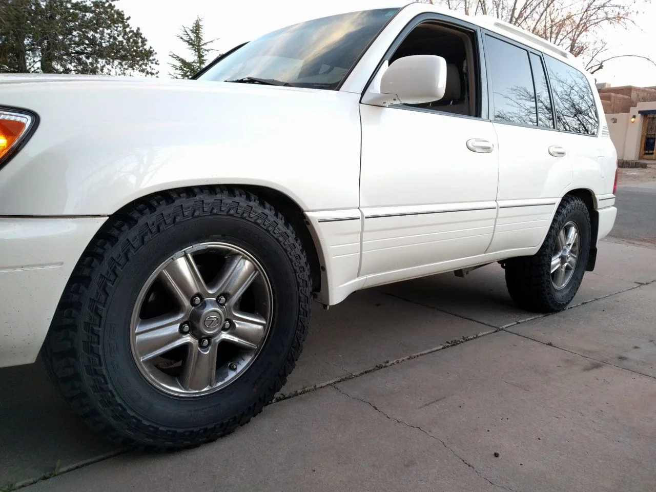

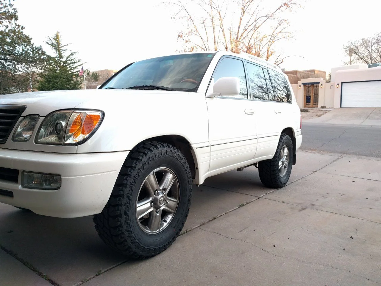

I couldn't wait until Friday, so I left work early today, ran home, loaded the tires, then took off to the shop in hopes they would squeeze me in even though I showed up an hour before closing.
I kind of expected this but after putting the LX in the bay, and unloading the tires from the back, the guy comes into the waiting area and says "theres no way man. Those tires aren't even close to being able to fit on that thing". I told him to do one of the fronts and if it didn't fit at all, he could put the stock back on and I would pay for the two mount/balances. Then one guy, who I presume to be the manager, started going off to another guy about how its a 35" tire and that I'm trying to put it on a vehicle that was never intended to have any larger size tire than stock and that it will never work.
Long story short. They fit perfectly!

started from post #1 to-date. awesome build! now really considering 295/70R18. have the same model like yours 06/07! Do you think the 295/70R18 tires will hit the OEM side step? I have no plans removing it anytime soon we have a 10yo girl and 10mo old baby and you can just image all the stuff, so yeah keeping the side steps. thanks!
started for post #1 to-date. awesome build! now really cons
I can only speak to the cooper st Maxx, but no, they wouldn't hit the steps. They only rub a bit on the sway bar at full turn.
