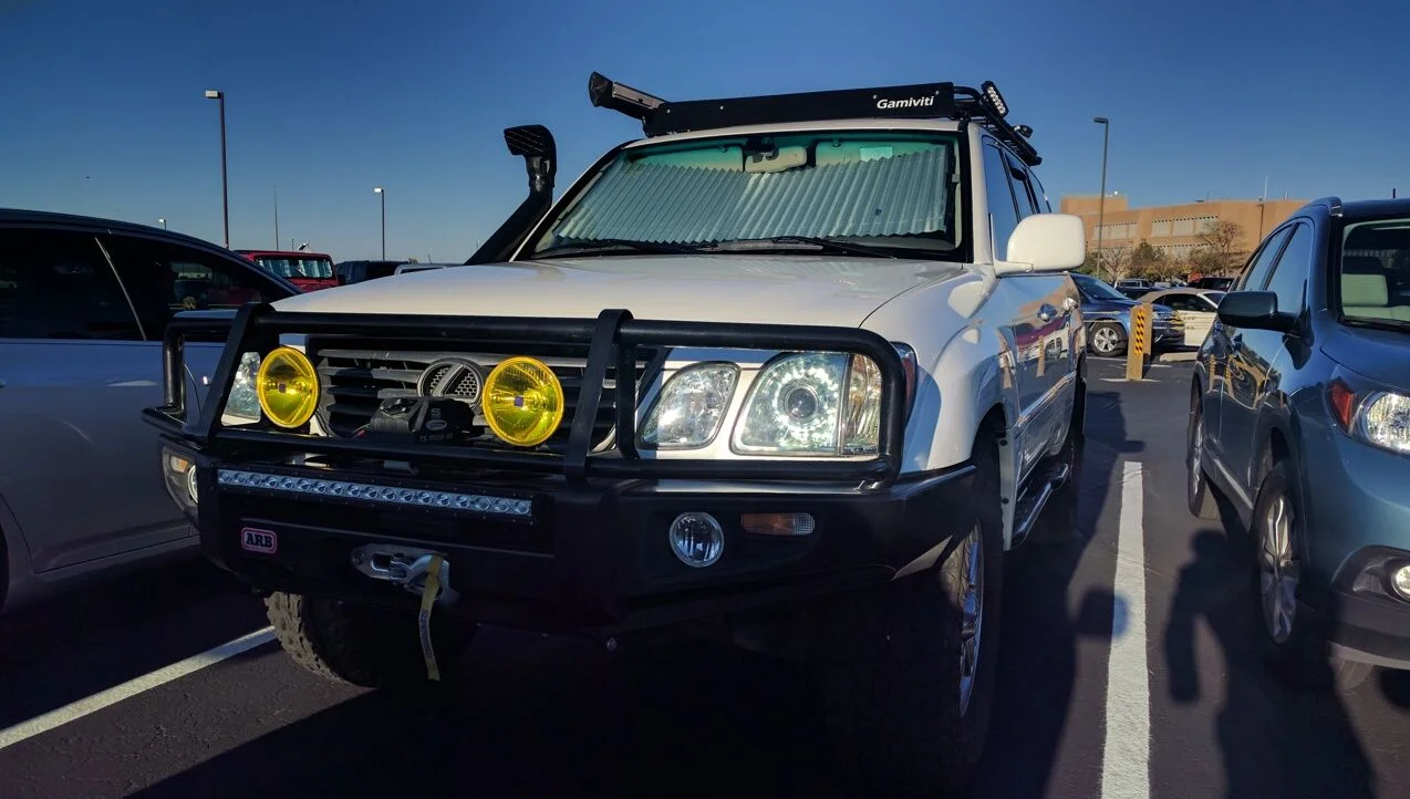

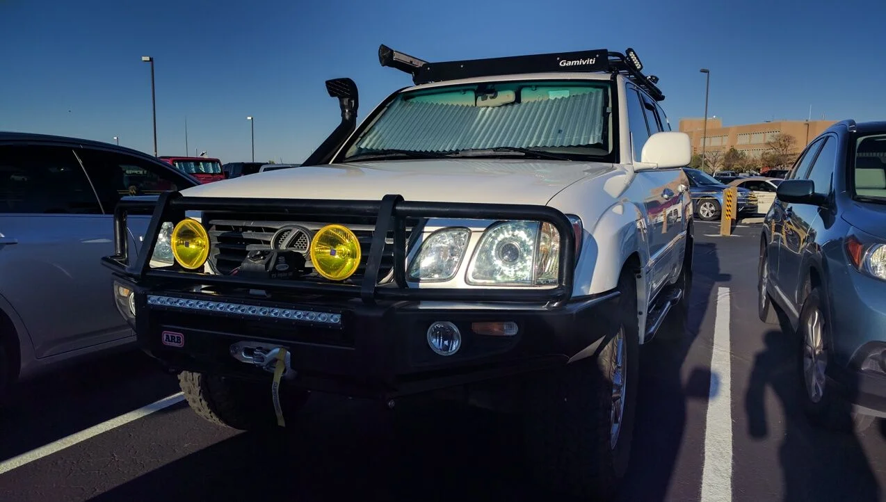

Just one suggestion, the drain hole in the air filter housing is there for a reason... when you make a deep water crossing some condensation might build in there or some very small amount of water might manage to get in through some of the various fittings, if it does not have a drain hole, every little amount that comes in with several river crossings will add up until eventually it might be a larger amount that can present a problem.... With the snorkel, specially the the Safari with the front facing inlet, a little amount of water will get in the air filter housing when you are going through hard rain is insignificant as long as it has somewhere to drain to.
The little hole is not an issue when doing deep water crossings as long as you don't stop, and even then the water should be pretty high to get to where it would enter through the hole and you'd have to keep the engine on while submerged for a longish period of time.
How about an alternative by installing a one way valve for the hole where if anything accumulates in the airbox it will still drain yet even if you do have to stop or slow down in large water crossings, no water will be able to enter into the box from the bottom?
Interesting. I was under the impression that any moisture that got in there would be small and evaporate pretty quickly. I'll keep an eye on the box after a big rain and see if any water builds up.
I don't know if such a thing exists.

I have not taken the airbox off for awhile but if there was room under neath it the idea would be to somehow attack a check valve to the bottom. Just an idea

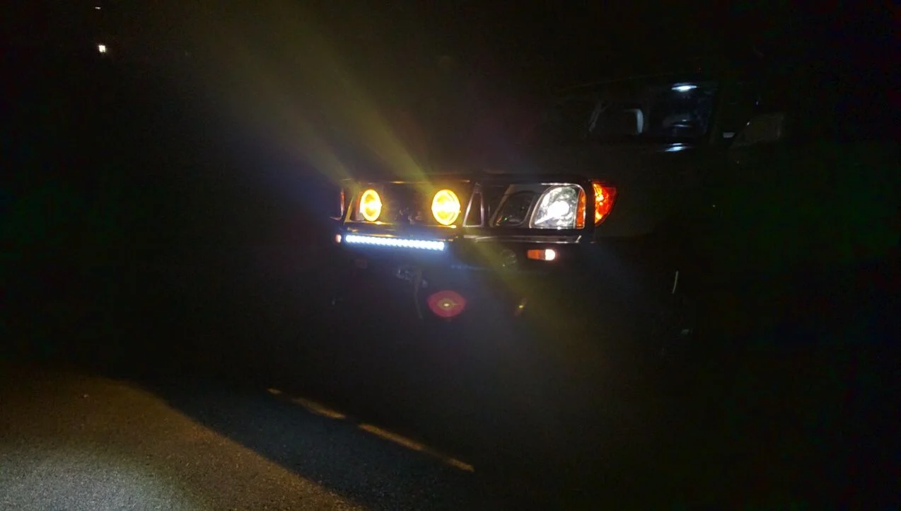

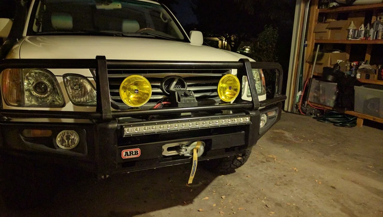

Added some amber 55w hella 500ff driving lights to the front bumper. I initially wanted some lightforces but then thought about the fact that the first thing to get stolen off the truck would likely be the lights. So far I have less than $120 invested in all the lights themselves.
They cast a pretty far beam, much further than the LED light bar. It seems even led spots or driving lights can't cast light very far.
The LX is looking great! Regarding the drain hole in the airbox, when I installed my snorkel, I just plugged the hole with a screw and some sealant. You should be checking the airbox after a deep water crossing anyway, so it's easy to just pop the screw out from inside the box and drain it if any water does collect. I've never had issues with significant amounts of rainwater making it into the airbox through the snorkel, though. The channels around the head seem to do their job.
Thanks! That's essentially my thoughts as well. Even driving in a major storm for a long time, I cant imagine much water accumulating in the box. If it does, It will likely evaporate off quickly based on the amount of airflow over the surface. I'll report back when I drive in a big rain, which here, might take a year or so.
