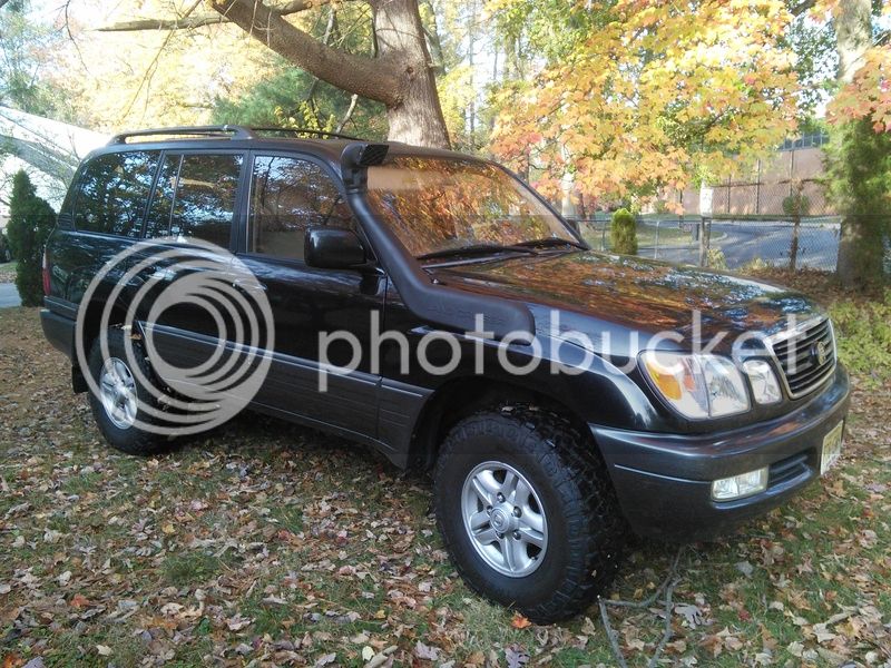

I bought and installed one of those $66 eBay snorks on my LX a couple of weeks ago. I'm also impressed with the quality. There are a few things I wasn't too happy about though:
- the a-pillar bracket to snorkel hardware is already starting to rust.
- the rubber elbow that goes in the fender had lots of "flash" (for lack of a better term) inside it that I had to tear out by hand
- I didn't like the need for rivets in the a-pillar and replaced them with nutserts and stainless button head bolts (I'm sure the rivets are fine, that was just my preference)
- I nearly peed my pants when hole-saw kissed sheetmetal, but again, not the snorkel's fault
[/URL]
