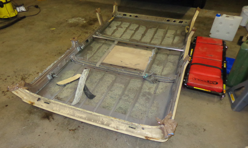

After removing a lot of paint and body filler the real face of my roof appeared. It looks terrible. I got the chance to buy a complete used roof in a good and rust free shape. The seller just cut the pillars. But know I'm not sure how to continue the restauration.
First I could also cut my pillars and weld the "new" roof on my landcruiser. Seems to be easy but how to cut the pillars that the windows and doors will fit after the welding?
2nd way: Separating both top roofs, renew the bottom roof with metal sheets and weld the "new" top roof on the car. Problem: How to separate the top roofs? After a short test I got buckles on the top and bottom roof.
3rd way: Cutting different worse parts out of the cars. The last part of the outer face of the top roof incl. the rain gutter and the top of the body sheet. To make it waterproof I would push the "new" part under the top roof by using welding points and glue.

On an FJ55 I had, a local shop said that you cut the posts in the middle and sleeve them, and weld it all back together. Very time consuming and expensive to have done professionally. I'm not sure the posts were cut very favorably on your salvage roof, but it might still work. You would have to test fit all the doors and windows as you went along, to be sure they continued to fit as designed.
You would never have the strength of the original roof, but then again, your 'original roof' isn't as strong as it once was!

Sooooo I'd recommend cutting the donor pillars a bit closer to the roof to maintain pillar strength even to to extreme to grinding adjacent to the existing roof to pillar joint and then attach the new roof. Be sure you are extremely confident with the welder and be prepared for extensive body shaping work to get it looking and acting good. Otherwise give it to your local body shop and they shouldn't have any problems stitching it on.

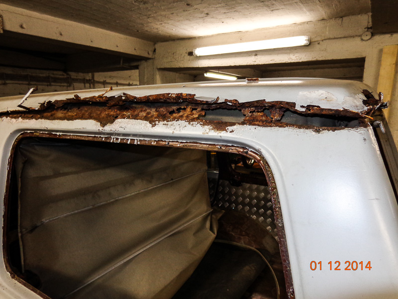

Today I cut off the rusty parts of the roof. At the moment I've no exspectations to find the perfect way of the repair. I change my mind hourly ... version no. 4: just close the holes with steel plates and weld a trimed plate on it.
A new cruiser? No. I bought the HJ60 just for repairs. The first step was the inspection sticker which I got in december and now ... difficult question :cool:
Hi Stephan, a new roof maybe a bit difficult to weld, you can only weld around the pillars and the windows have to be replaced.
The picture above is better , first cut the rust out and then decide what to do.

I sanded my roof back today, to have a look how bad the holes would be, this is the worst of mine and fortunately for me it's nowhere near as bad as yours :grinpimp:
I'm looking forward to seeing the after pics from yours
