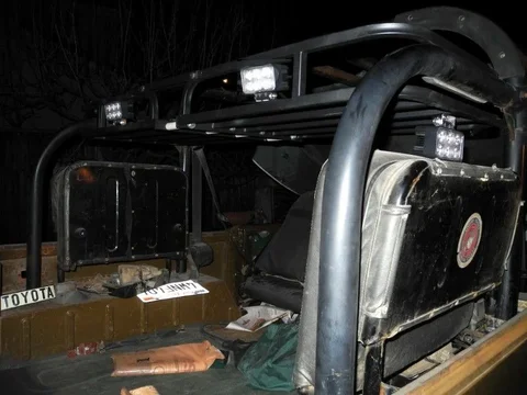

I started with this HF receiver rack kit
http://www.harborfreight.com/500-lb-capacity-steel-cargo-carrier-69623.html

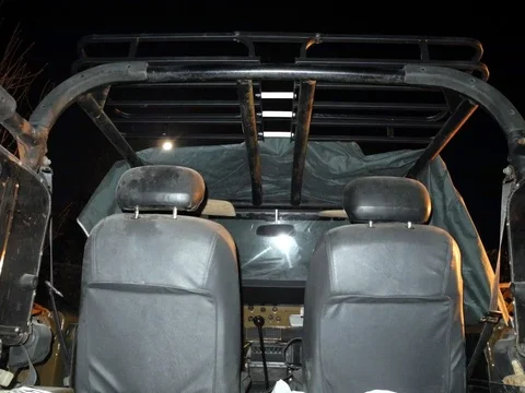

dumped the 2" tube, spaced it out a little, and it is sitting right on the pads here. I've got four quick fist clamps on order that I'm going to use to keep it there. The LEDs are a photoshop job. I've only got one so far.
It will also work up on top if someone is going to use the jump seats.
Top? No top needed, nor doors for that matter.
It will fit inside the top when mounted at the rear, just can't use the jump seats. I should get the clamps tomorrow, so I'll post up some more pics with gear in it over the weekend.
The clamps look like this:
BTW, I've got a total of about $100 into this, including the extra hardware and the clamps.

Latest, with quick fist clamps. Bolts and other HW are not installed yet. Still only have the one LED light.
The "original" clamps claim to be able to fit up to 2.25". No way I could stretch them onto 2" tubing. :confused:
Poly Performance was awesome about exchanging them. Thanks! These are the next size up, the "go betweens".
The cargo net is cut down from a larger one from harbor freight that was $10 on sale. Total investment to this stage is $125 + lights.

Are you sure those QuickFists will handle the shifting weight of rack and gear over a rough trail? I wouldn't be comfortable with rubber clamps holding a roof rack full of gear, even a half rack like that one.
Excellent question. I'm planning for a max of about 300 lbs with a working limit of about 200 lbs.
The Go-between model is good for 50 lbs with a break strength of 150 lbs. They are rated for holding tools or whatever vertically. Most of the weight here is not vertical, but simply sitting on top of the clamp. They are very high durometer rubber. The exception would be climbing a rocky incline where the rack would be trying to pull backwards. In this case the roll bar pad will keep it from sliding backwards as well as the friction of the rubber on the roll bar. I'm guessing 300 lbs in that direction would not be a problem as it's still mostly pushing against the bar with maybe 50 lbs on each side trying to shear off the roll bar pad. This is well within my estimated limits.
The rack itself is rated for 500 lbs in the original configuration, attached to a receiver. My PVC spacers may be the weak link, but even with 300 lbs in the rack, each PVC end is limited to about 30 lbs of torque (guess), so I have no current plans to use steel tubing there.
With 300 lbs in the rack, and the rig on it's side, the rubber mounts will have to hold 75 lbs each. Over limit, but well within break strength.
The rack is very solid. I'm not going to stress test it, but I'm sure I could stand on it, and I really have no plans to load it up to 300 lbs. I will put all my soft stuff up there (chairs, tent, maybe the stove) and keep my ice chest and water can down in the bed. Worst case will be a Dusy Ershim trip where I'll have to put two gas cans up top. That's 60 lbs and only if I bring the dog. If it's just me and a passenger the gas cans go in the back too.
I still have plans for a tire rack and there may be room for a can rack there too. Not sure about that yet.
Over the weekend I finished up the hardware. Each clamp is bolted to a flat plate with two screws where one of the screws passes through the rack, so the weight is distributed across the two screws. I also added a switch panel in the corner behind the driver and a dome-light panel in the center with an OEM dome light. No pics though...
The Go-between model is good for 50 lbs with a break strength of 150 lbs. They are rated for holding tools or whatever vertically. Most of the weight here is not vertical.
My understanding of the breaking strength of the quick fists is the mount bolt pulling through the rubber of the quick fist. I'd speculate that any sudden sideways loading that would cause the quick fists to fail would probably be catastrophic in nature (high speed collision, rolling the truck, etc).
I don't think sideways could do it. It would have to be landing straight upside down, in which case my little roof rack would be the very last of my worries.
Right now I have 'normal' 1/4" washers, but you've given me the idea to make custom washers that wrap around the rubber to make it impossible for them to pull through. Maybe little sections of channel. Hmm. I really don't think the washers could pull through in any other situation than epic badness.
I think as it is, with what I plan on putting up there, it would survive a slow roll without spilling anything out.
