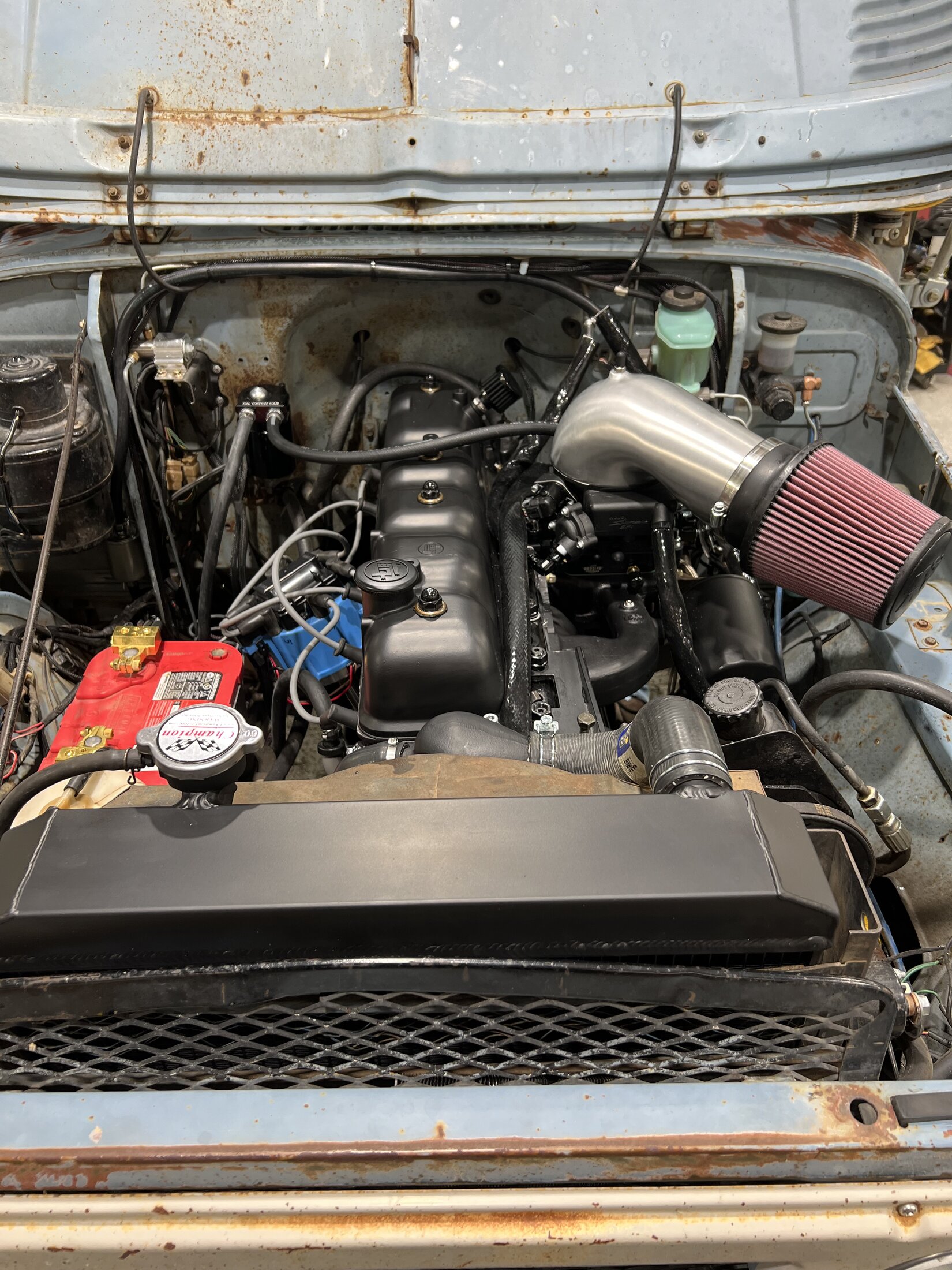

Im looking at replacing my stock exhaust. Pretty sure i have an exhaust leak somewhere and I’m looking to help prevent some of the exhaust smell. Where is the best place to have the exhaust come out to help with the smell. Ive seen some put it out the back and some put it out the passenger side behind rear tire. Ive seen some add a small catalytic converter as well to help with the smell. Goal is to drive mine to work some days but not smell like gas/exhaust when i get there. What size pipe should i use since I’ll be going to a custom exhaust shop? Sorry for all the questions, just trying to cover my bases before i go over to the shop. Appreciate any feedback
I have a stock 2F with sniper fuel injection

It’s a ‘78 with stock manifold and exhaust at the moment. I just had Sniper fuel injection installed and the smell was happening before that as well. It’s more of an exhaust smell than fuel itself. Current exhaust seems ok but haven’t dove into it much. It exits out the passenger rear now.

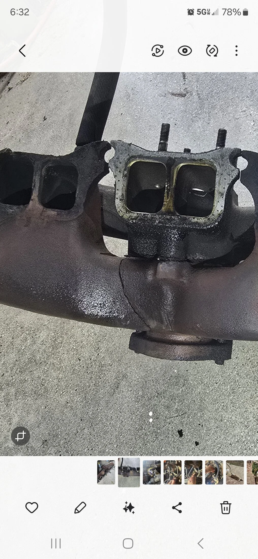

I had a similar problem... turned out to be a cracked exhaust manifold...

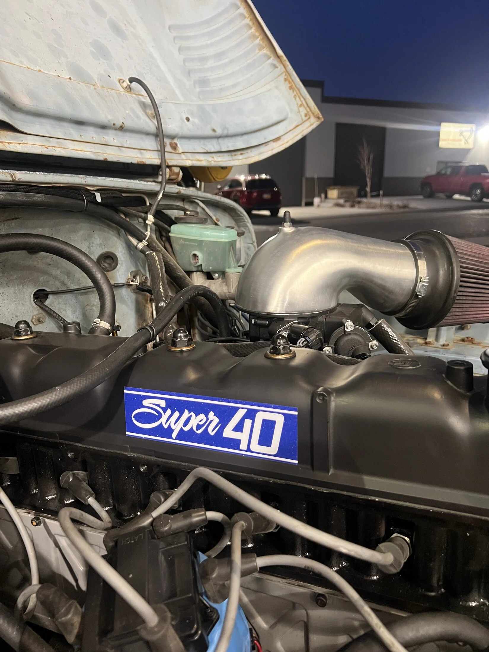

I have a man-a-fre header on my 1F, Holly sniper also installed. I used to also get bad fumes in the cab. I daily drive mine. I ended up putting an oil catch can on it from the tappet cover. Also kept getting the oily vapor smell. so did another catch can but this one with a filter on the can then to the valve cover. no vacuum ran to it, the tappet cover catch can I run to the manifold and the air circulates and pulls fresh air from the valve cover catch can solved my oily vapor exhaust like smell. I tried just running a filter directly on the valve cover like most do, but kept getting the nasty smell. then after all that like yourself I wanted the exhaust smell gone also. I run a 2 3/4 header back exhaust with a thrush chambered muffler. I used to run an axle dump system when it was open cab and it did fine tell I put the top on then it was nasty smelling. so I did a tailpipe on it similar to em out behind the driver side rear tire. It helped a ton but still kept getting a lil smell and my passengers would get headaches. so ended up putting a down draft section on the end of it and that took away almost all of the smell. I off road and crawl with it a lot so I still was able to tuck it away a bit. if I ran it lower Im sure I could eliminate the smell fully but don't want to smash it on rocks. sorry for the long message but that's what I did lol. Also if your sniper isn't fully tuned properly and its running very rich it will really really smell, when I installed mine and was in the process of tuning it, it was definitely very very rich from out of the box. running my AFR at 15 and 14 at idle and it likes it a lot. when I first installed it, it kept running at 11 and man it stunk. the fuel prime also was a big factor also mine kept priming 100% at start up so it would flood the intake then it would fire up and lope like a cigarette boat and cover the ground in black exhaust lol I turned the fuel prime all the way down to 20% and that solved a ton. the holly system is amazing but to be safe they have it running rich, rather than lean and getting angry calls from customers engines running hot and lean. rich is safe but stinky. Also make sure your PCV is good oily vapor smell and exhaust are similar. a plugged PCV can actually cause oil vapor to come up threw the distributor, has also happened to me, distributor would actually drip on driveline :)
