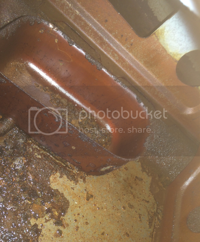

Dropped the fuel tank down today as part of my slow paced project on my 1985 FJ60.
Short story is that it was sitting for 14 years or so in a garage.
Got the carb rebuilt by Mark, drained gas, new fuel filter and now I'd like the opinions of the seasoned FJ60 guys.
Oh and the fuel tank recall was done in 95 or so, cant remember. All the hose came off relatively easy.
Here are the picts

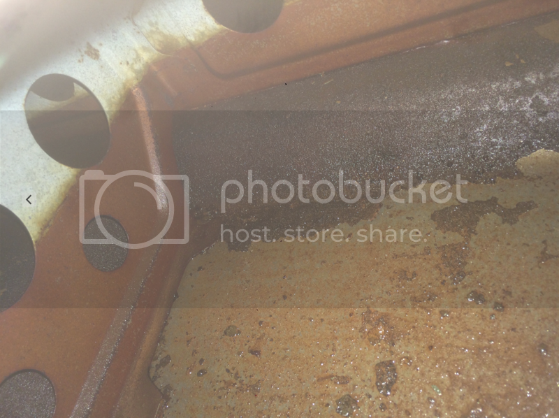

The Sending unit and pickup unit dont look so hot. What do you all think?
And the inside... do I attempt to clean it myself or just take it to a radiator shop to do the deed?

I'm kinda thinking that I might as well replace the sender and pickup while its out of the cruiser.
I would change all the rubber fuel lines, and flush only the hard lines.
I have found a good cleaner for fuel related gunk on metal parts - Bar Keeps Friend cleanser. Make a paste, apply to part, scub a little, and most parts come out like new.
On the tank, I would try a little muriatic acid. Put a small amount in a plastic bucket and dilute with water. Use a funnel to pour it in the tank. Shake the tank around to keep liquid moving and check on progress frequently. It will remove rust and scale, but you MUST FLUSH WELL WITH PLAIN WATER TO REMOVE ALL TRACES OF ACID!!!!
Muriatic acid is nasty, and you do not want to breath it, it will damage metal, etch concrete and eat holes in clothing, so be careful, but it works. When finished dilute with lots of water.
Once you are done with that I believe that POR makes a tank refurb liquid that will coat the inside (think this is what @cruiser enthuiser did with his). Lots of guys also throw some liquid in there with a large section of chain and use that to rattle around an knock more of the rust loose.

Pulled the cover off my non-functioning sender and it was obvious why it wasn't working as designed. Uneven wear on the contact surfaces will make for some squirrley readings across the range.
Don't know where in L.A. you are, but there's a place in Northridge, called "The Radiator Works" ... They do a lot of vintage stuff and they're very good. May want to call. The chemicals you need to clean the tank are restricted to business use now, in CA, and are very caustic. M. Acid works, but as stated, it's NASTY stuff and can eat through stuff quickly.
Those pick up tubes will prolly clean up. If the sender is within spec, use it. You can replace later, if needed, with tank in place through a access port in the cargo bed.

Yeah, I'm just saying I've seen a couple people ruin radiators using a DYI Muriatic Acid, which for peeps who don't know, is another name for Hydrochloric Acid.
I'd rather spend $50 to get it boiled and neutralized and washed, then POR 15 the inside and outside.
I took the tank to be cleaned out by Burbank Radiator Service. They were highly recommended by a friend who builds and restores old cars. I didn't want to mess with the acid and the mess/disposal.
Ordering the POR-15 tank sealer today. Picked up some Bar Keeps Friend cleanser to see how well the sender and pick up units clean up. Ill test the sender once I research that. Thanks for all the info guys.
Very good timing ... I pulled my tank today, after the 60 was running bad, I had fine rust in my fuel filter, after cleaning the tank I plan to use red kote sealer , pretty sure my new carb is going to need going through as well .
Just got off the phone with the radiator shop. He does a muriatic acid treatment and then a caustic acid treatment.
He then said that he doesn't think it will need to be sealed but would know more after the cleaning, tomorrow.
Does this sound right?
