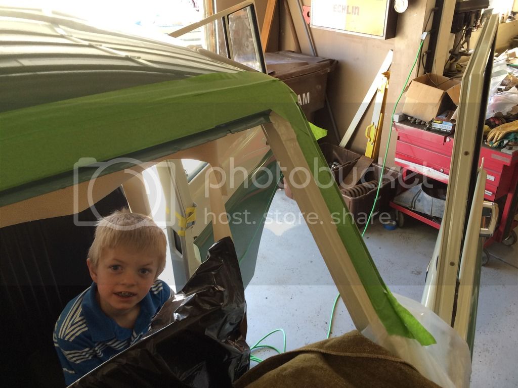

It was not as warm as I would like it, but it's not going to improve, so we went for it today. Always nice to have an extra set of hands, even if those hands are 8 and 9 Years old.
If you did not already, put all the grab handle bolts, seat belt bolts, sun visor and rear view mirror screws in now. It is a whole lot easier to find a screw head under the headliner than it is to find the holes.
Start at the front Center of the Windshield. Mark Your Centerlines, and if using a spray adhesive, mask off anything you do not want glue on. Seriously, headliner glue is some of the nastiest stuff to remove once dry. Have Acetone around to wipe any overspray off while it is still wet.

Keeping the material warm will help reduce wrinkles. My highly skilled assistants were up to the task.

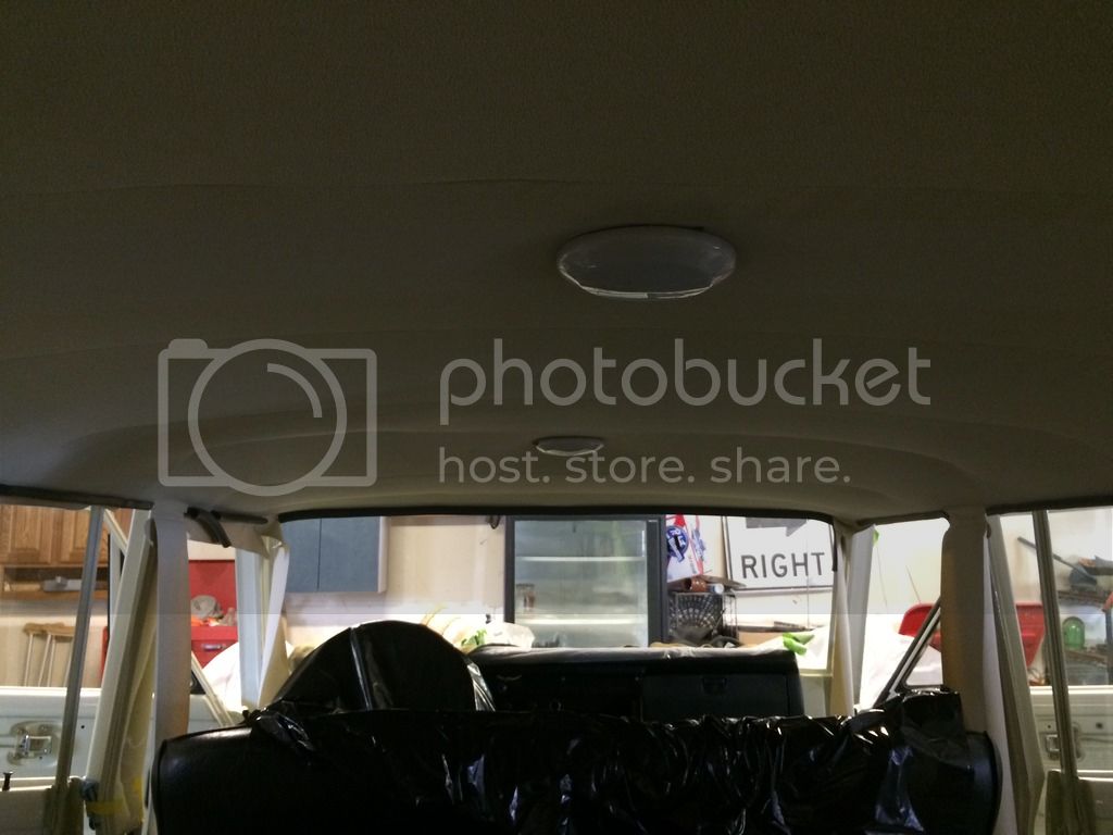

Nice and tight, minimal wrinkles that should work out with heat and the pillars getting secured. Interior cargo lights installed as well.

Sure! Here is the rest of the headliner, and progress from yesterday. When I put in the grab handles, and seat belts, some wrinkles went away, couple more showed up. This is my second FJ55 Headliner, 4th overall...the rear corners are not 100% right, but maybe it is like drywall texture, only I would ever notice...
