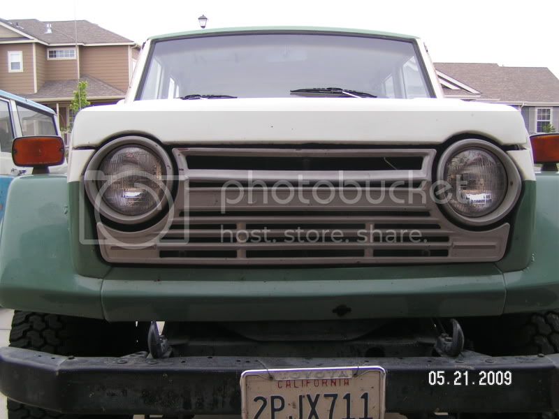

A smiling face to greet you.
The reason you are here, piggie.

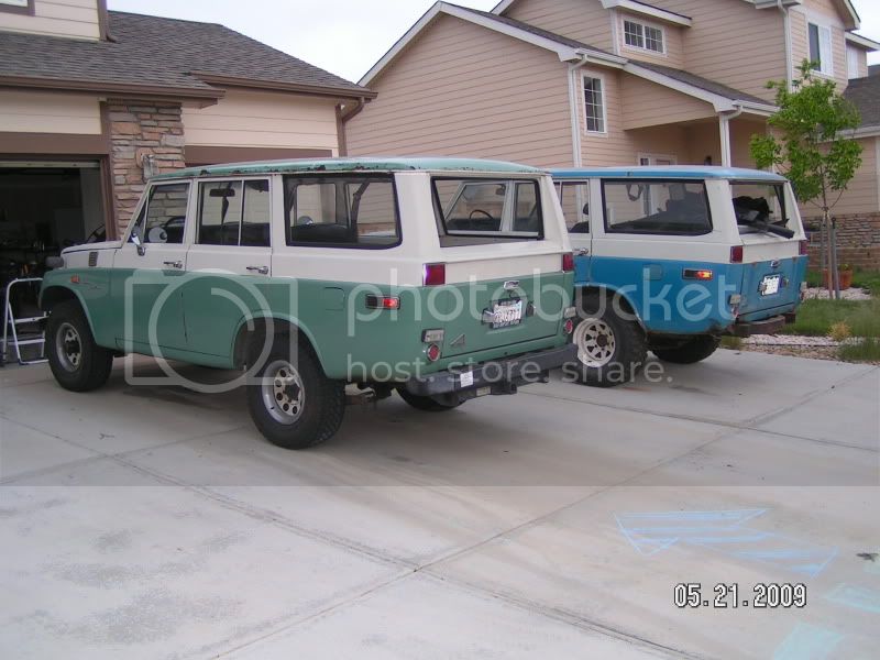

With Frankencruiser, the reluctant donor.

Got any plans for the blue :pig: once it donates it's roof? :hhmm: Are you taking the windshield surround too?

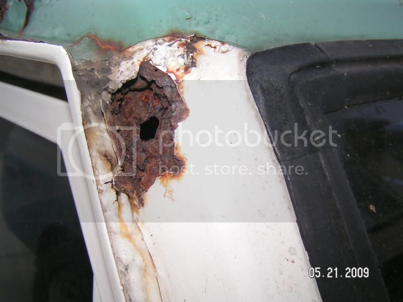

The plans for Frankencruiser are very fluid. It really depends on what the sandblasting uncovers. Possible plans are; to let it go topless, swap the two roofs straight across, piece together a pickup style cab with parts of the rusty roof, or part the whole rig.

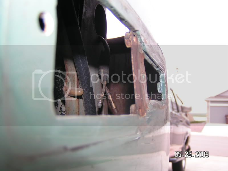

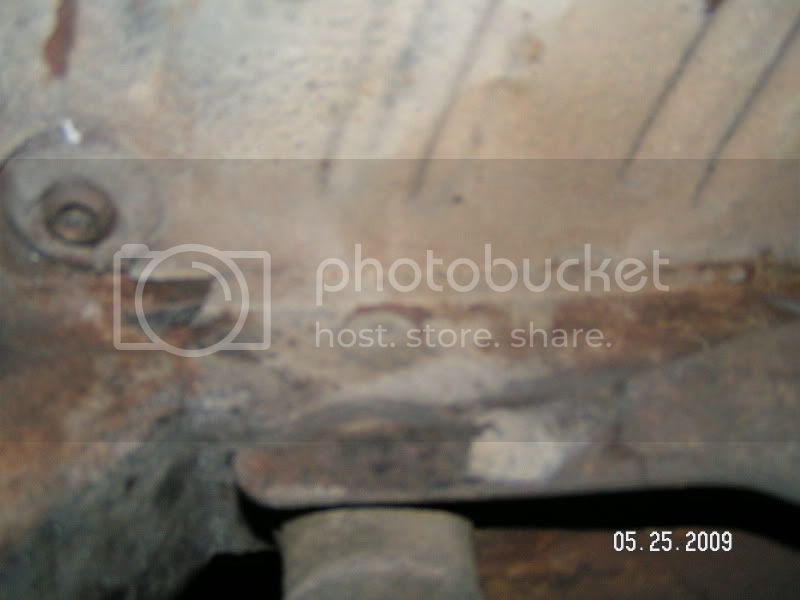

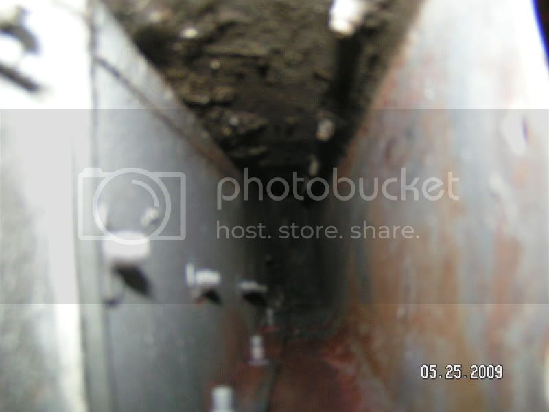

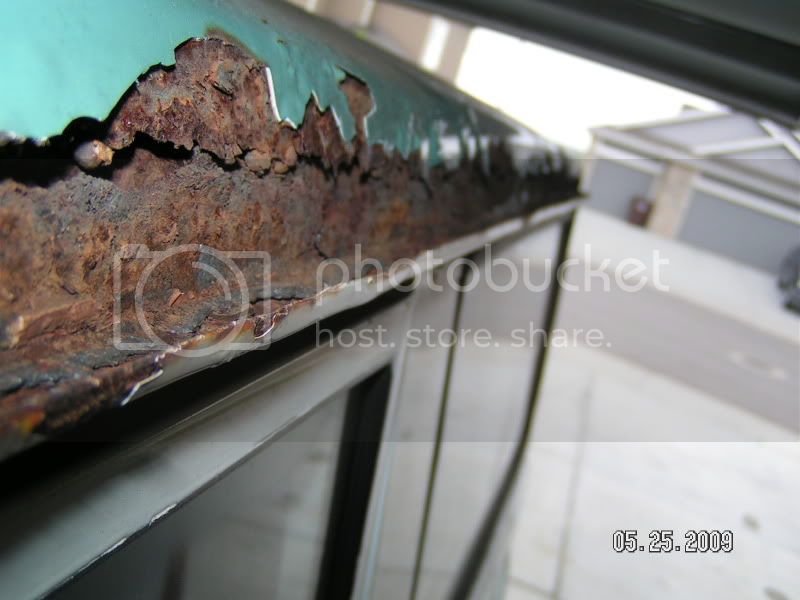

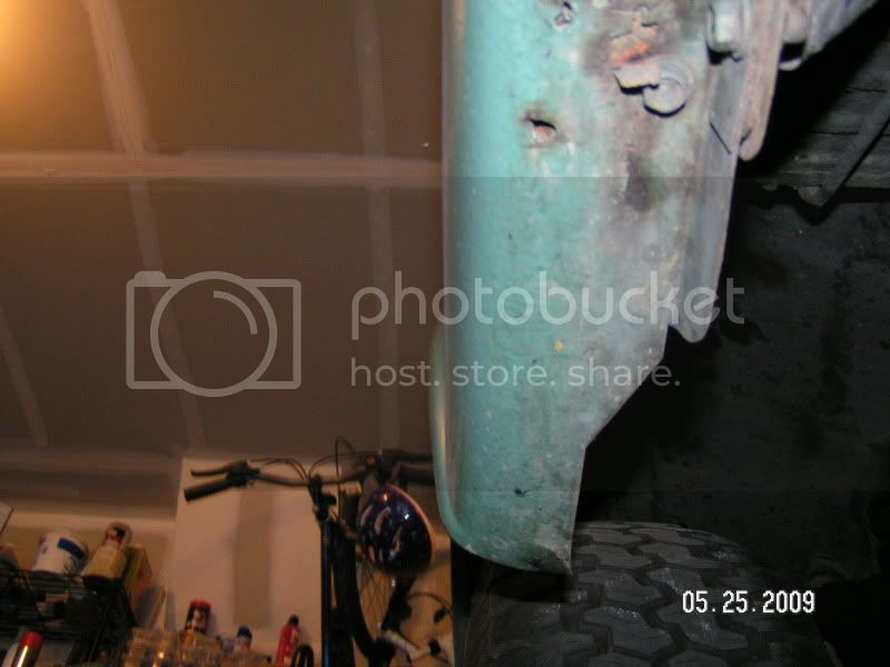

Teardown on the moviestar started today. Drivers side lights, mirror, tail lights and markers came off. Drivers side door and cargo panels came off. As expected, low end rust looks minimal, there is far more bondo on the rear corner and front fender.

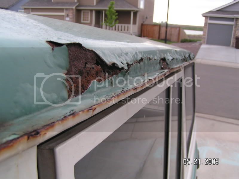

File the roof rails under "if a little bit is good, a lot must be better" fallacy. The seam sealer was layed on flush with the top of the rail. While it seems like a great idea, and is very effective keeping water out, the converse is also true. Once water gets in, it becomes very effective keeping it in. My current idea, is to put on the new roof, then use Line-X in the roof rails and up an inch or so onto the roof. I might reinforce the mount points for the roof rack as well.

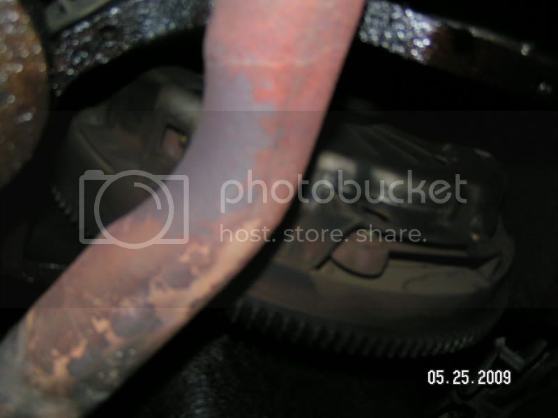

What do you call what is missing? Protective clutch cover??? Anybody know what size bolts go in this cover (provided I'm going in the right direction)????????
Mine's off right now.........how bad am I asking for trouble? I'm not driving it much but am about to.......anybody have the bolt size or some xtra bolts for sale???
*Did a search and saw Poser's comments that some have them but some don't......will continue search to find correct bolts needed to put flywheel cover on..........8mm x 1.25mm?? (sorry for hi-jack)
I've probably got some extras if you want them - price = postage if I've got 'em.
I always run with mine on. The flywheel cover is more of a guard - it won't keep water out. It will help keep everything from getting caked in mud though. ih8mud
The diesels all have a full coverage bellhousing so I have no concerns.
If I had a gasser I'd be concerned about errant rocks getting up in the flywheel area and screwing things up. If you go flying down a gravel road you always hear the rocks off the bottom of the truck or wheel wells.
