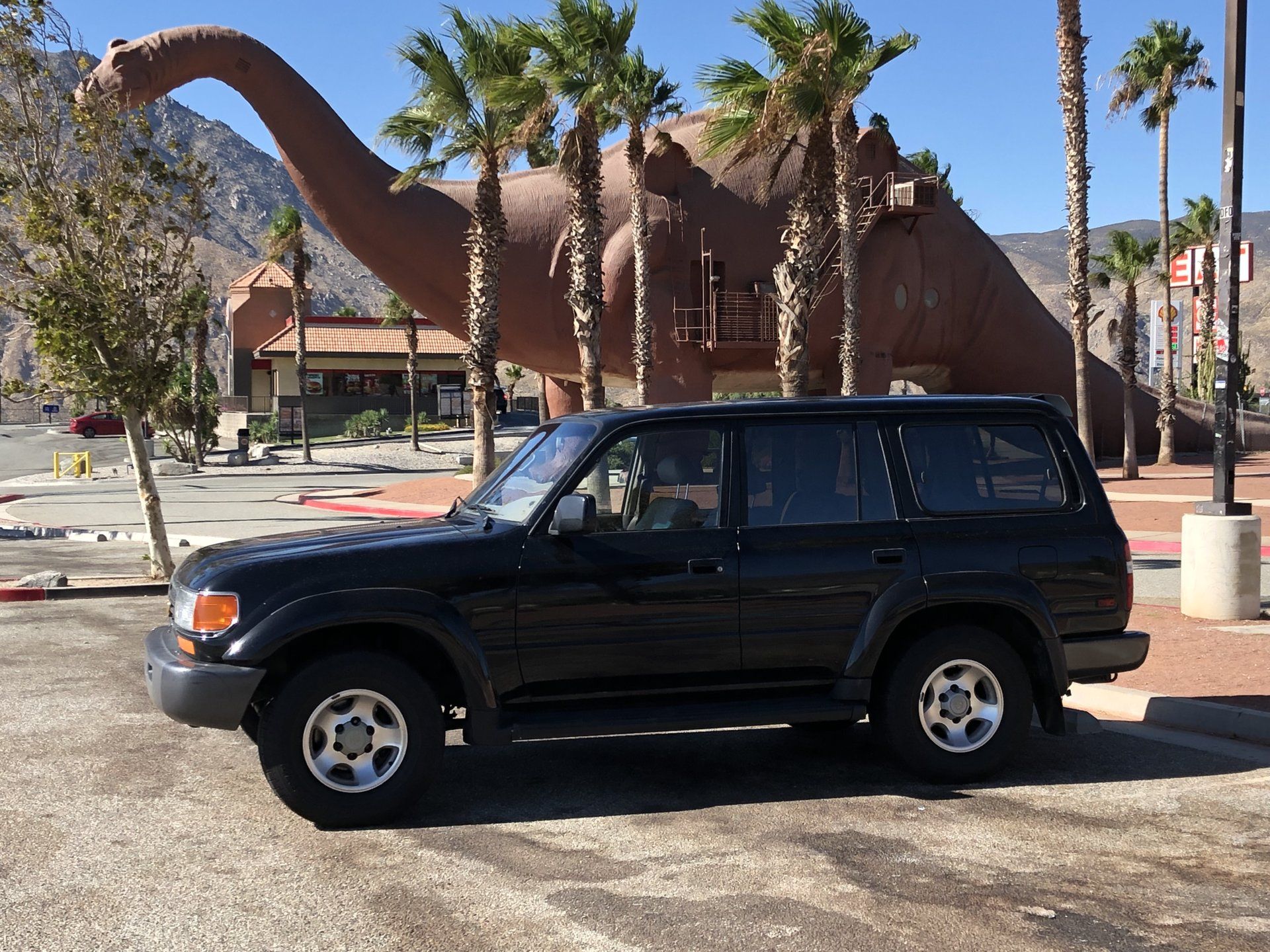

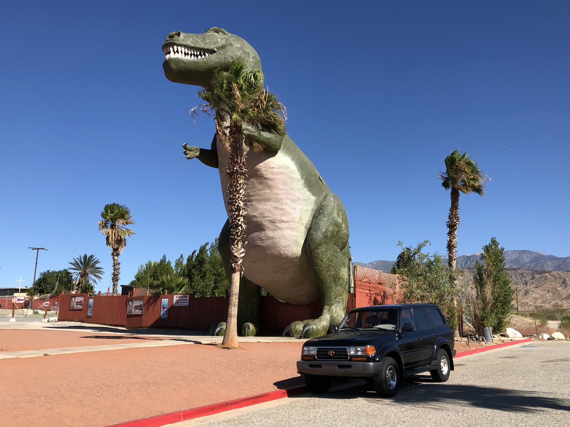

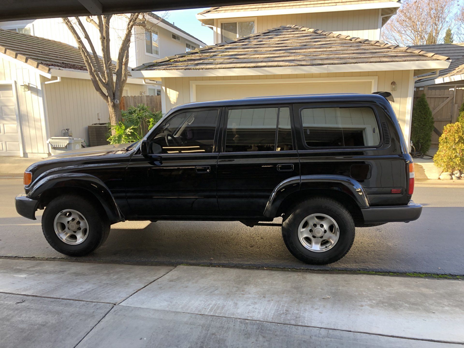

Pics from when I purchased the rig,

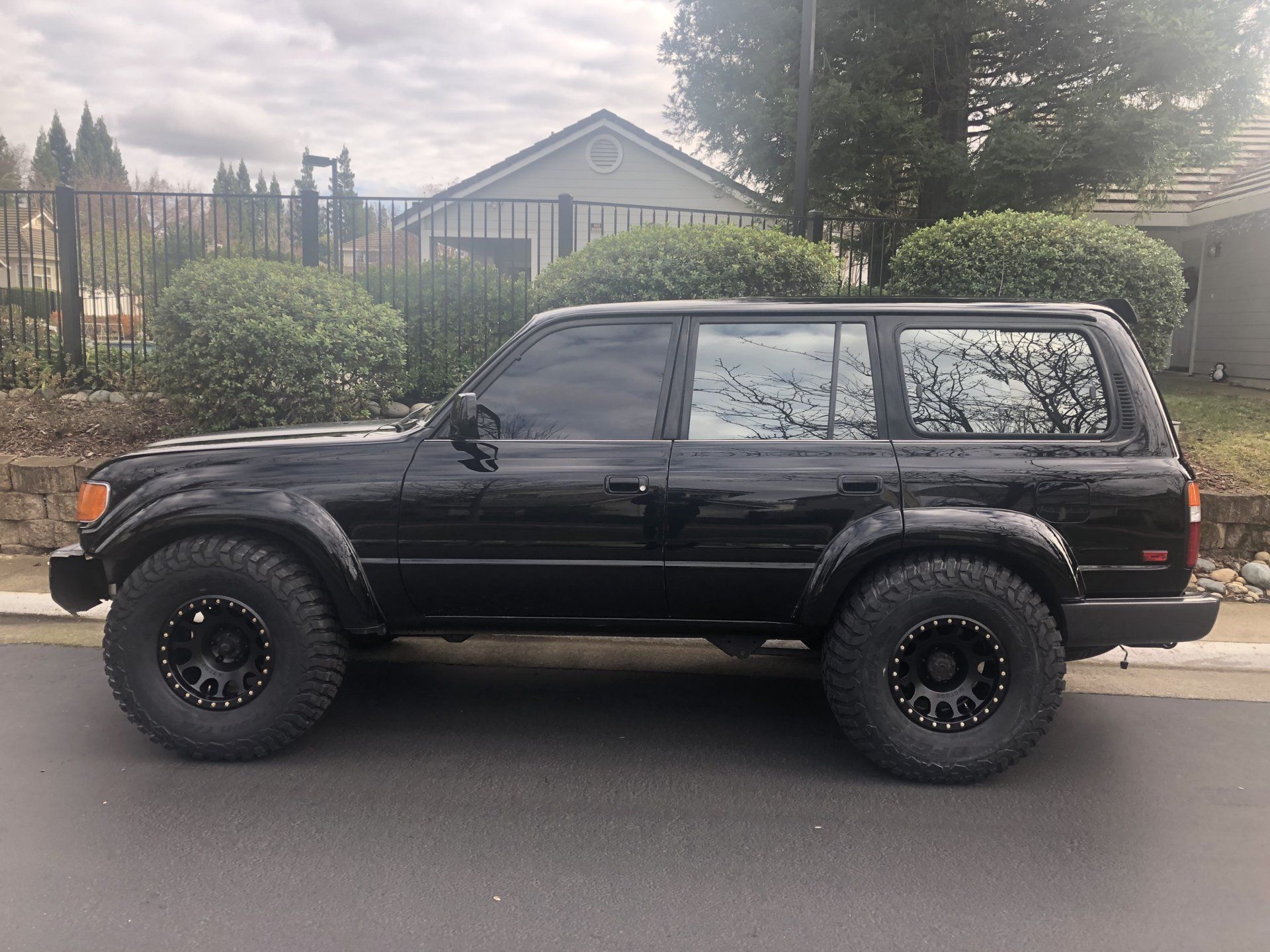

If I'm reading your thread correctly, you're running 37s on stock gears and stock suspension. What's acceleration like? Any rubbing when turning or when flexing the suspension?
Cheers
Nice stable mate - congrats on a super clean looking rig !
Great looking rig, good looking Porsche
Cheers
Cheers
The 37’s were put on to test fit. I left them on for storage purposes until my Kings come in and the rig goes to Slee for the lift.
I had to take off the bumper corners and there is still rubbing on the fender flairs. My rig had decent power in stock form. Could be a factory freak, could be the newer head job. Either way these wheels and tires are significant heavier than stock, so I will be upgrading to 4.88’s.
