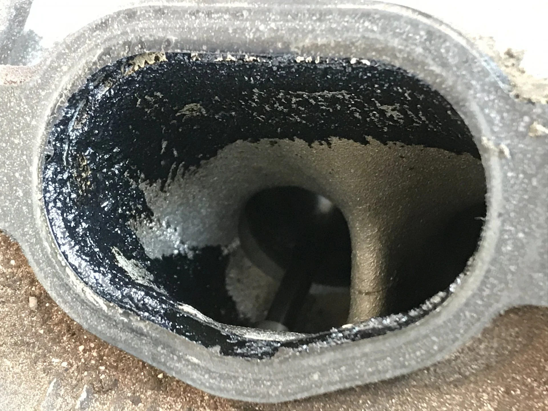

I’m in the process of doing this among other maintenance items. I have some carbon build up in the manifold. I didn’t get a pic but it looks similar to what’s in the ports of the head. Should I try to clean this? Also is it recommended to remove the the throttle body and clean it out?

I’m in the process of doing this among other maintenance items. I have some carbon build up in the manifold. I didn’t get a pic but it looks similar to what’s in the ports of the head. Should I try to clean this? Also is it recommended to remove the the throttle body and clean it out? View attachment 2441500
That is about the cleanest intake port I've seen. Looks to me to have been cleaned. If your's look like that not much to clean.
Some do clean with gasoline or some solvent like CRC or BG throttle body cleaner. I do not clean the ports of gunk or carbon. As I do not want to drop anything down the ports. I just vacuum out any dust that I may have dropped in. I use 44K, seafoam and others while engine running to clean.

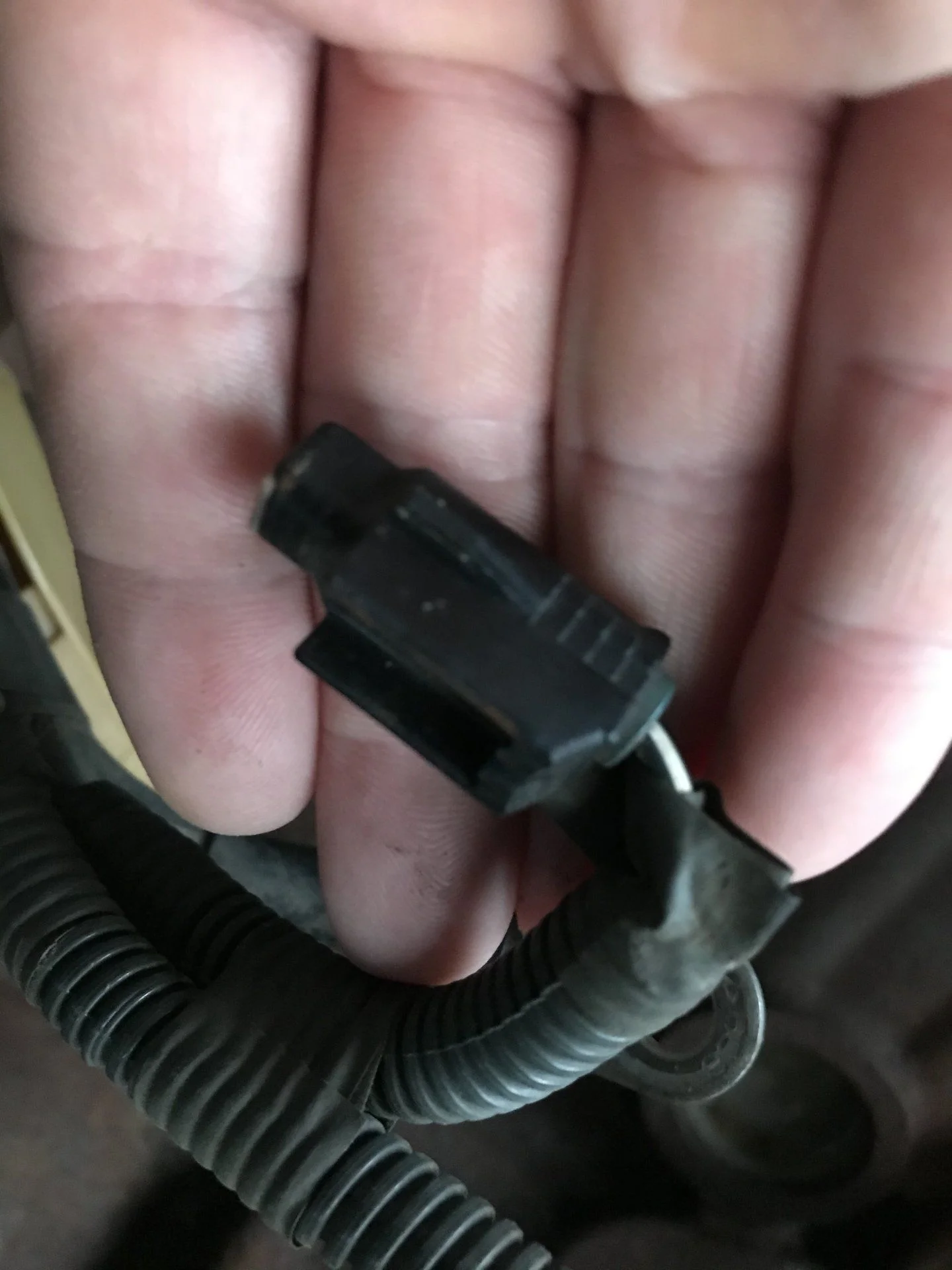

So I broke the small black connector on the side of the starter. The locking tab on the housing to be specific. I have ordered the housing. Are there any write ups on how to replace the housing. Most you tube clips of similar connectors show using pushpin, safety pin etc to unlock then change out. Is this the same? Part should be in today at the dealer.
Very common. Either strap or tape (high heat) in place or replace.
