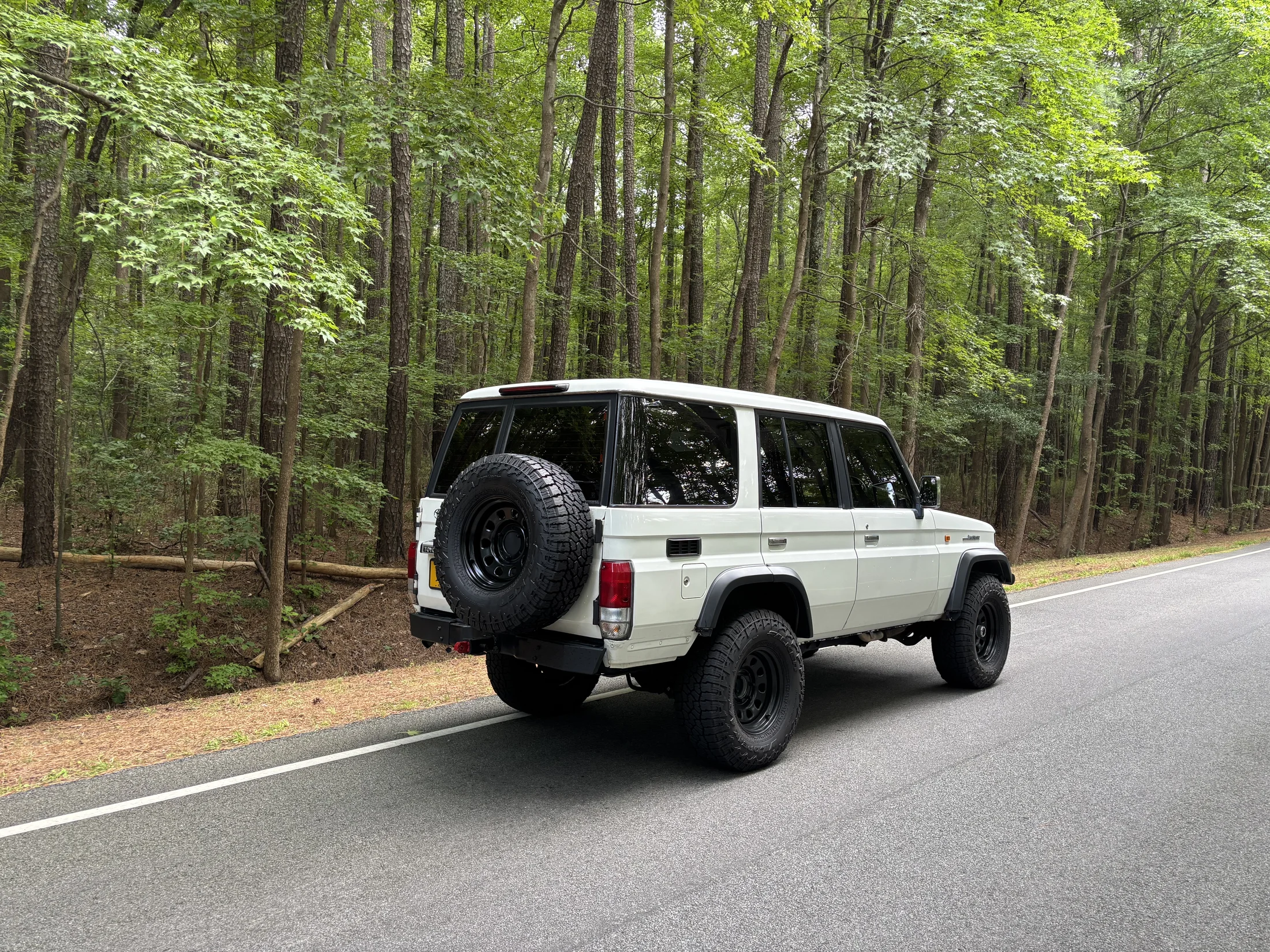

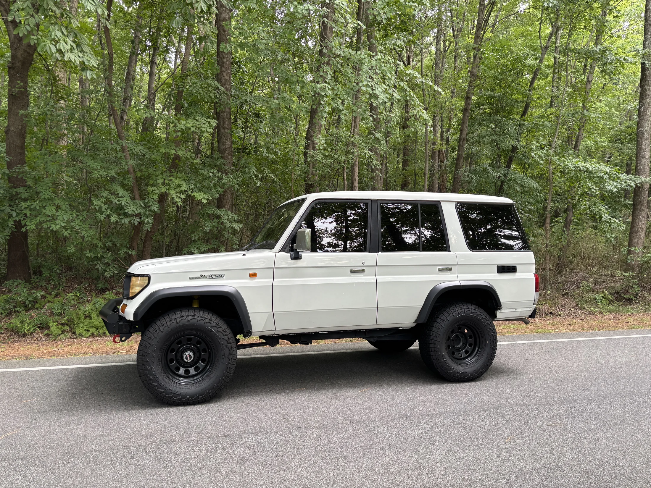

st maxx and the yokos look good and are way better tires, wrangers are ugly... and trash imo
I have Yokos on a few vehicles, and like them a lot. The Wrangler tire is my old dry rotted spare off my old 80. Has a hole in the sidewall (of course), but I patched it and mounted it up just for looking at it. If I go with the 35's the front runner picks are Yoko G003's or Nitto Ridge Grapplers. I was indifferent to Nittos until I put them on the HZJ-73. So far I really like them. The ST Maxx have been decent, not my favorite.

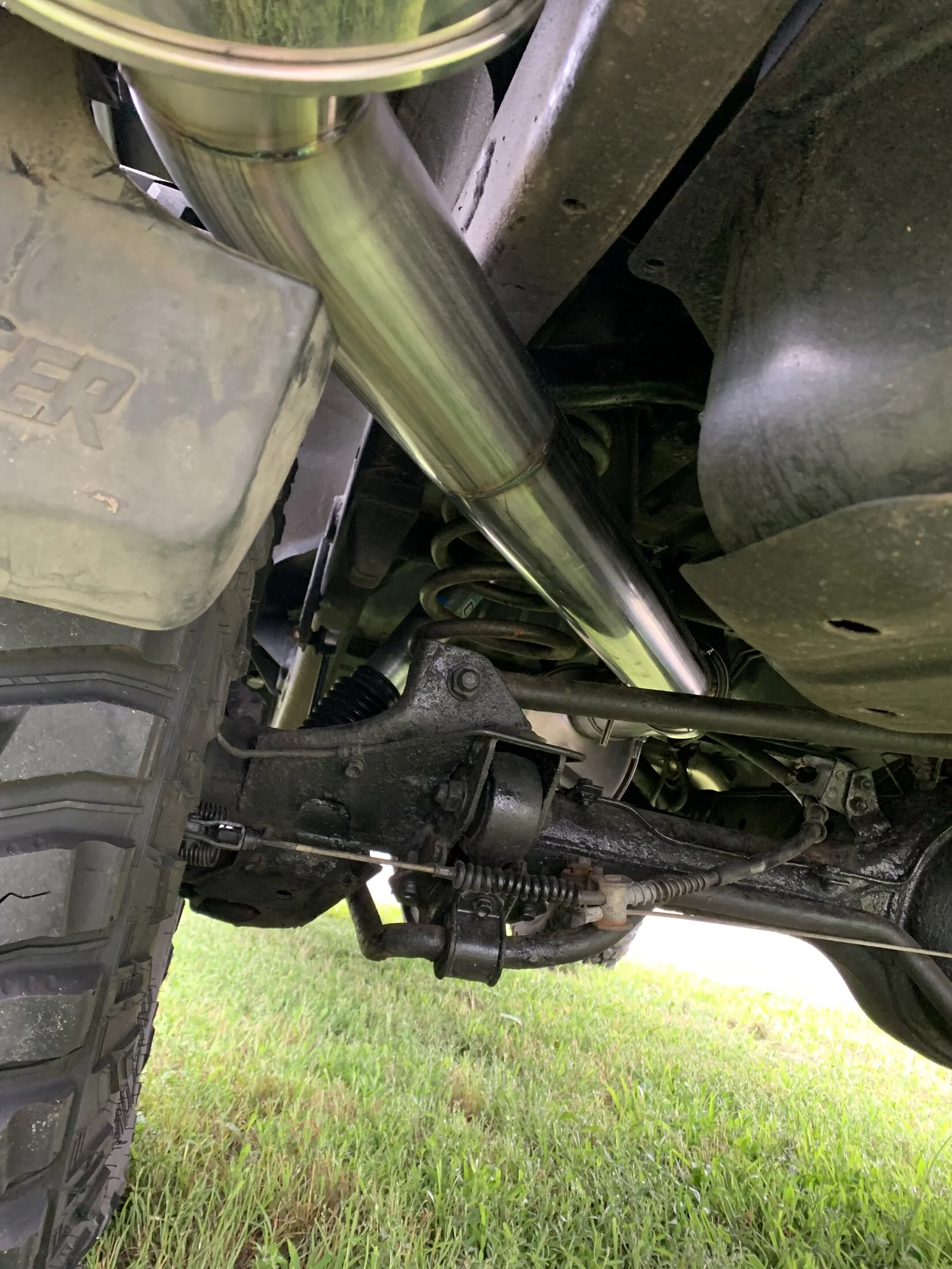

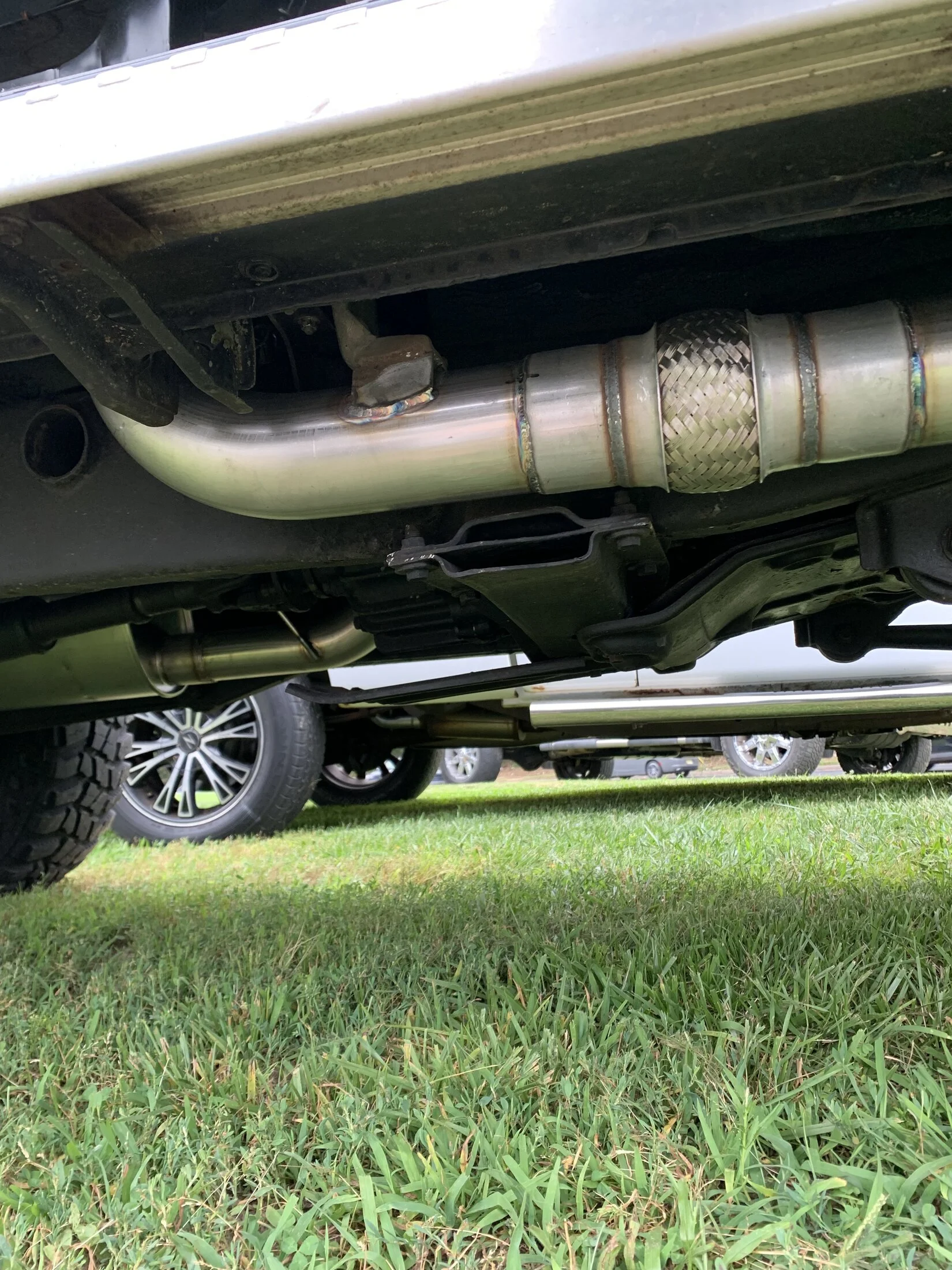

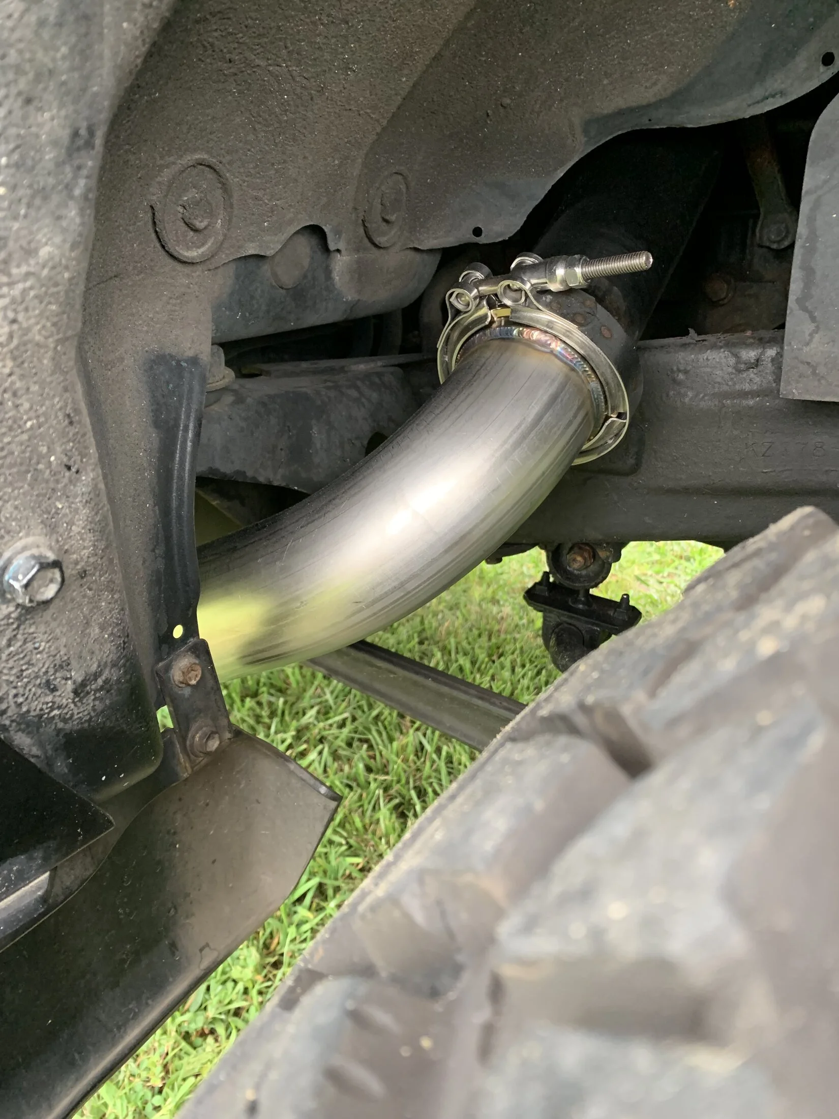

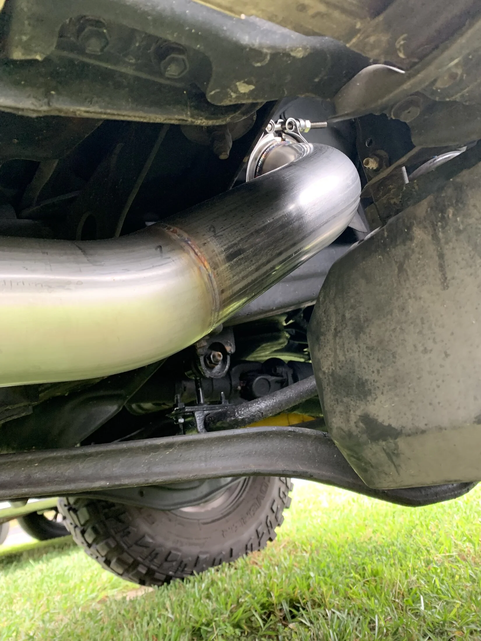

New 3” exhaust!!!

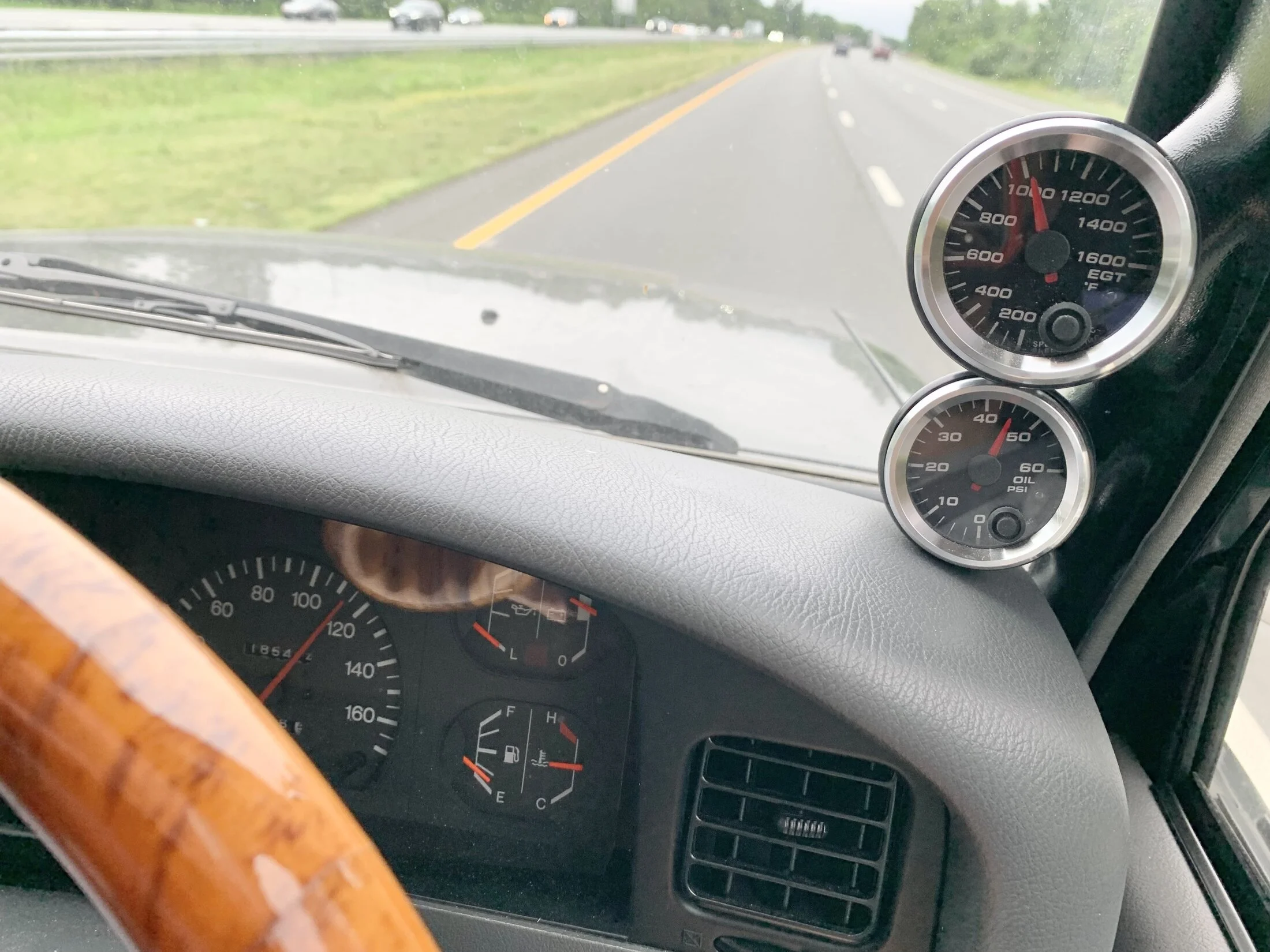

Egt’s down 200-300 degree fahrenheit at highway speed
When I had HZ1 turbo at that speed was running 700-750.
Now with HD-T , 570.
Flat road , 255/85/16 tires .
Medium load
Need to adjust IP .
@NJ KZJ78 thats a huge drop in temp with that exhaust, thats awesome. Looks like a very well made custom setup.
I took my kzj78 into my local exhaust place and they actually turned me away. They they didnt have the right equipement to build an exhaust with such tight clearances over the frame. gotta find another shop asap.
I traveled 2 hours to find a master ace tech at a performance shop (he actually builds drag race cars). The was an “easy” job for him. Just make sure you find a TIG welder. They ordered 304 stainless steel from vibrant i think, if that helps, then TIG welded it together. Most shops wont have the equipment. Find a really good welder and have then order the tubes. I went 304 stainless because it scientifically holds up better against higher diesel temps and rust.

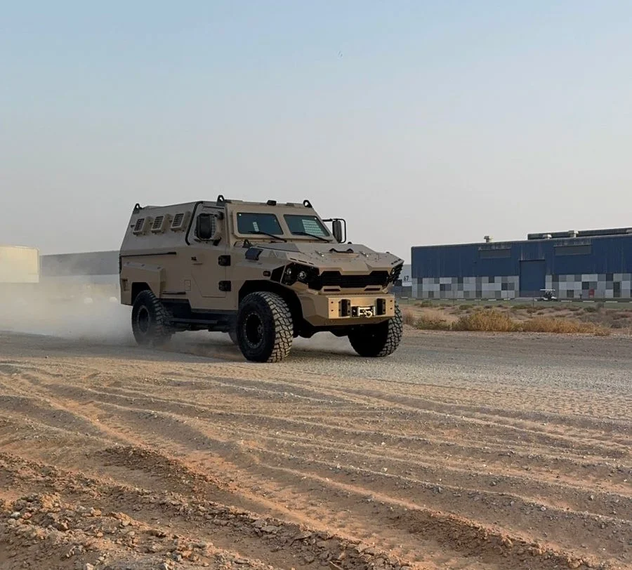

Well not so much "my personal" LC79 but one from work. The MY25 LC79 LHD SC with the 2.8L Diesel with the automatic transmission. Just finished with the body modification and now going to put it though the testing.
Looks like a 5.7 to 6 ton vehicle...
Are you using linear springs upfront or progressive?
Should probably be at least 85 N/mm for this beast...

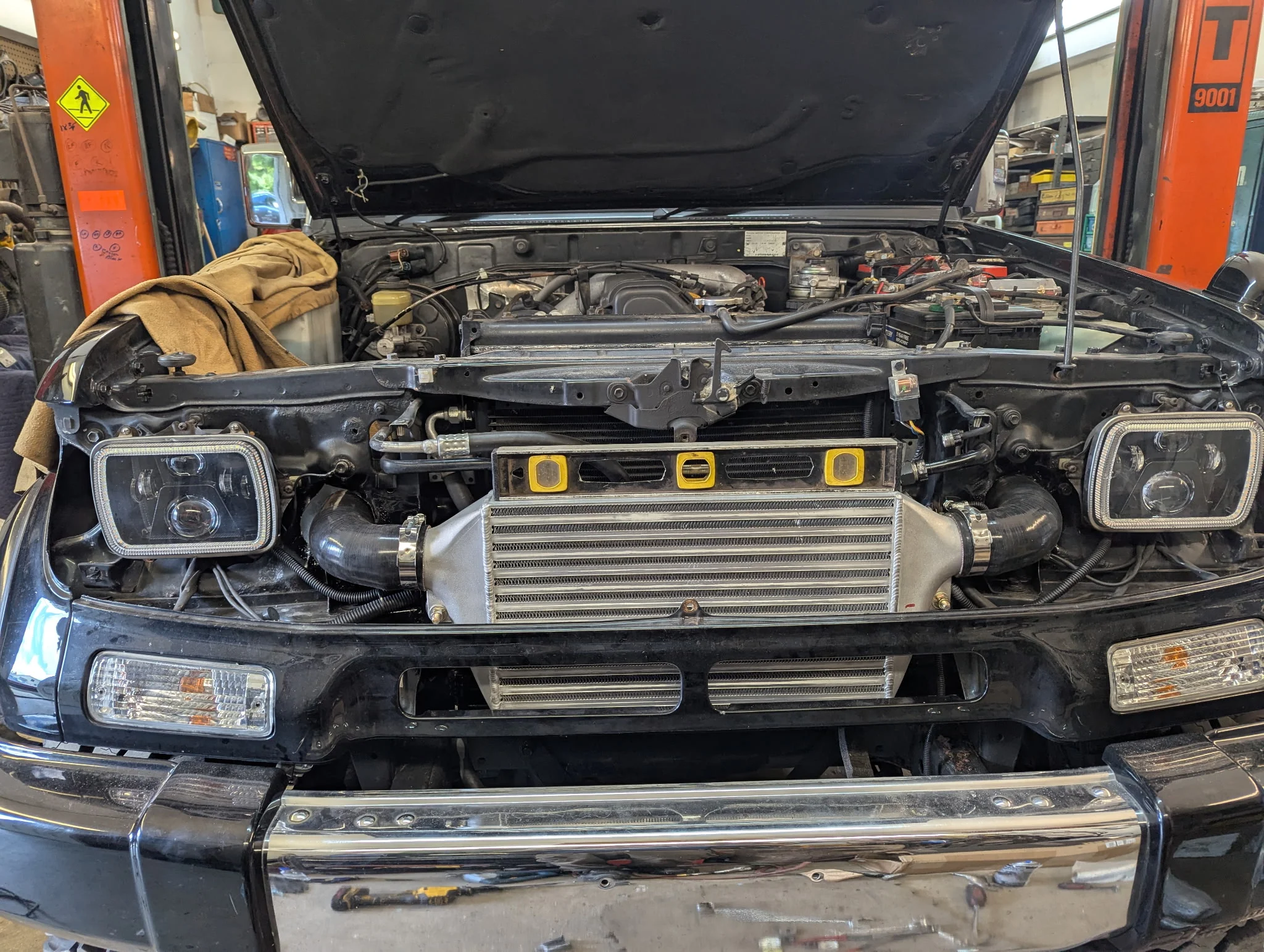

Intercooler going in! Garrett high performance…brake overhaul powered by @cruisermatt next!
That IC is much larger than the vibrant ones I've seen most people use. Please get back with new EGTs when you get a chance, that thing is a monster.
@cruisermatt Will you sell kits for this for those of us that aren't nearby? Or maybe a parts list for the DIYers?
Yes, I absolutely sell parts! please email for anything you don't see on the site.
