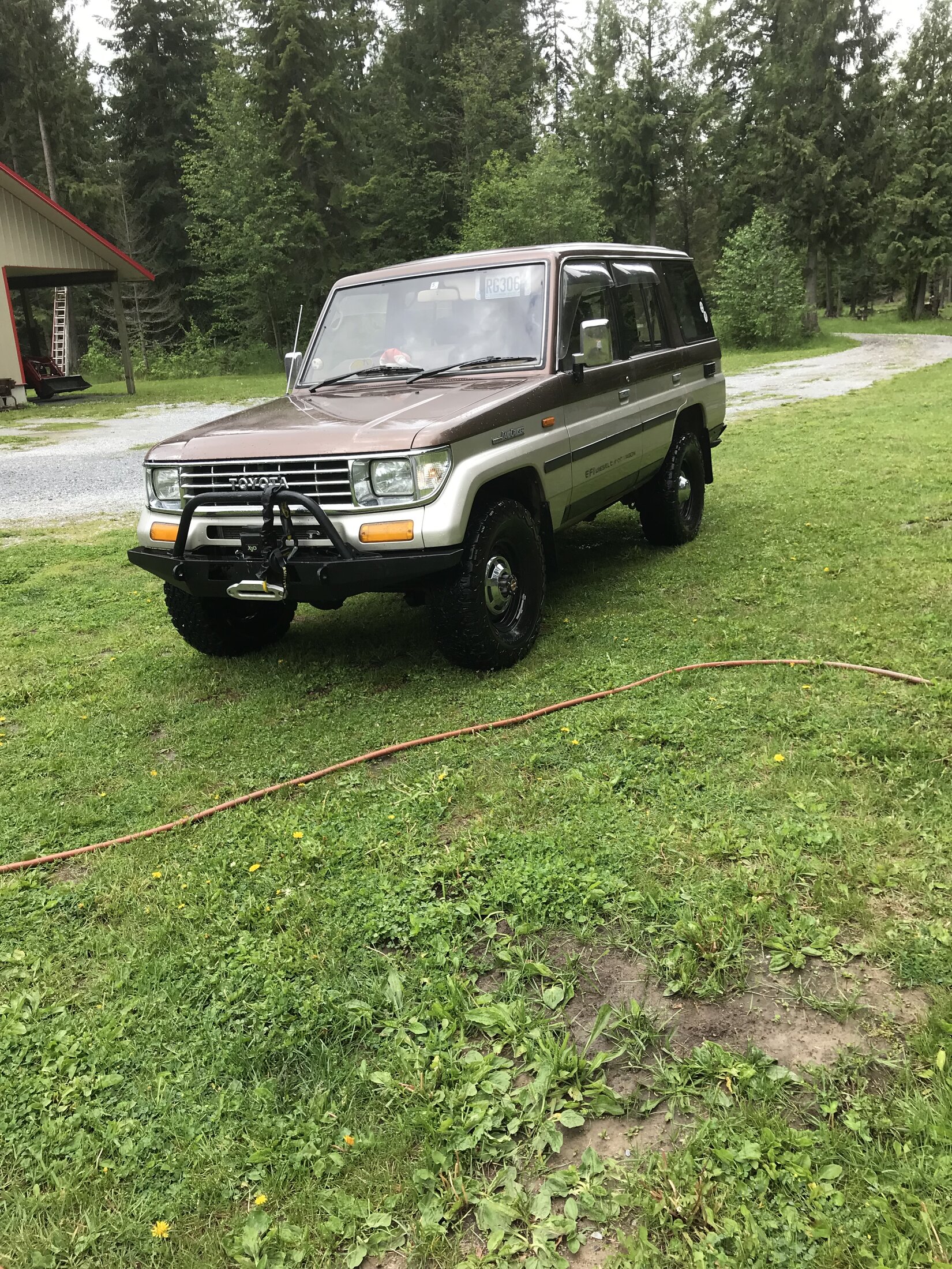

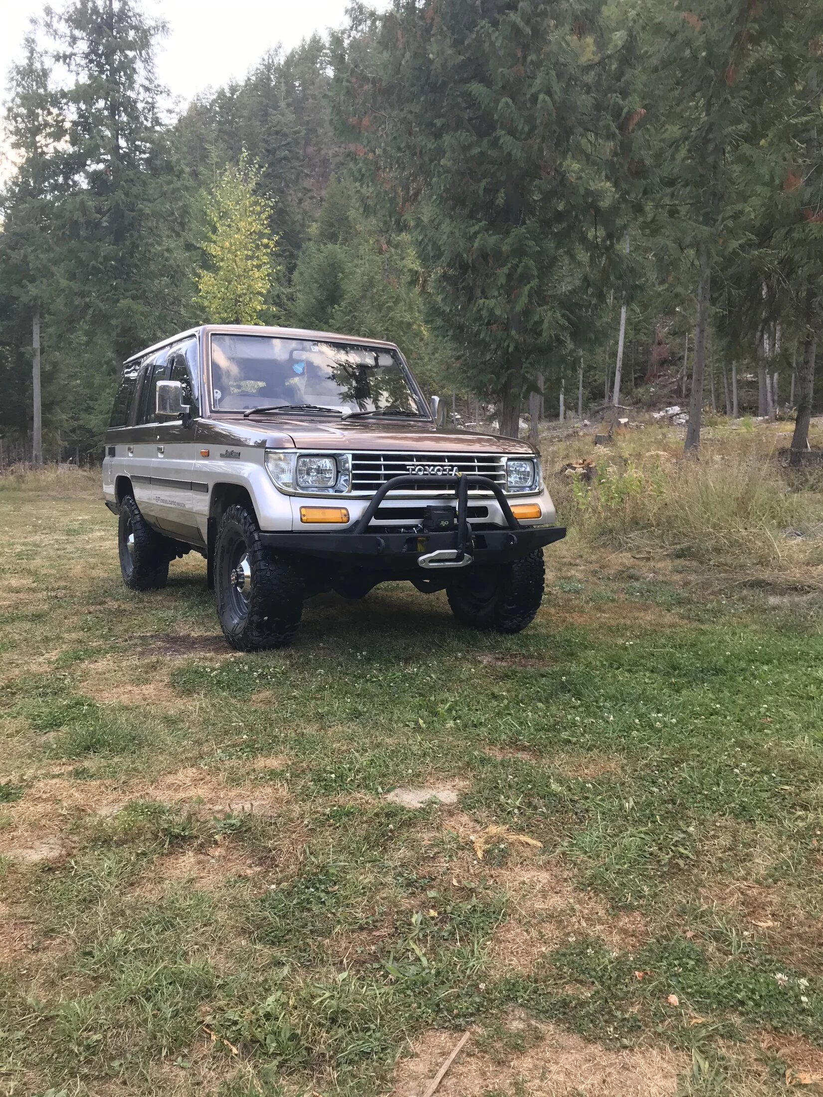

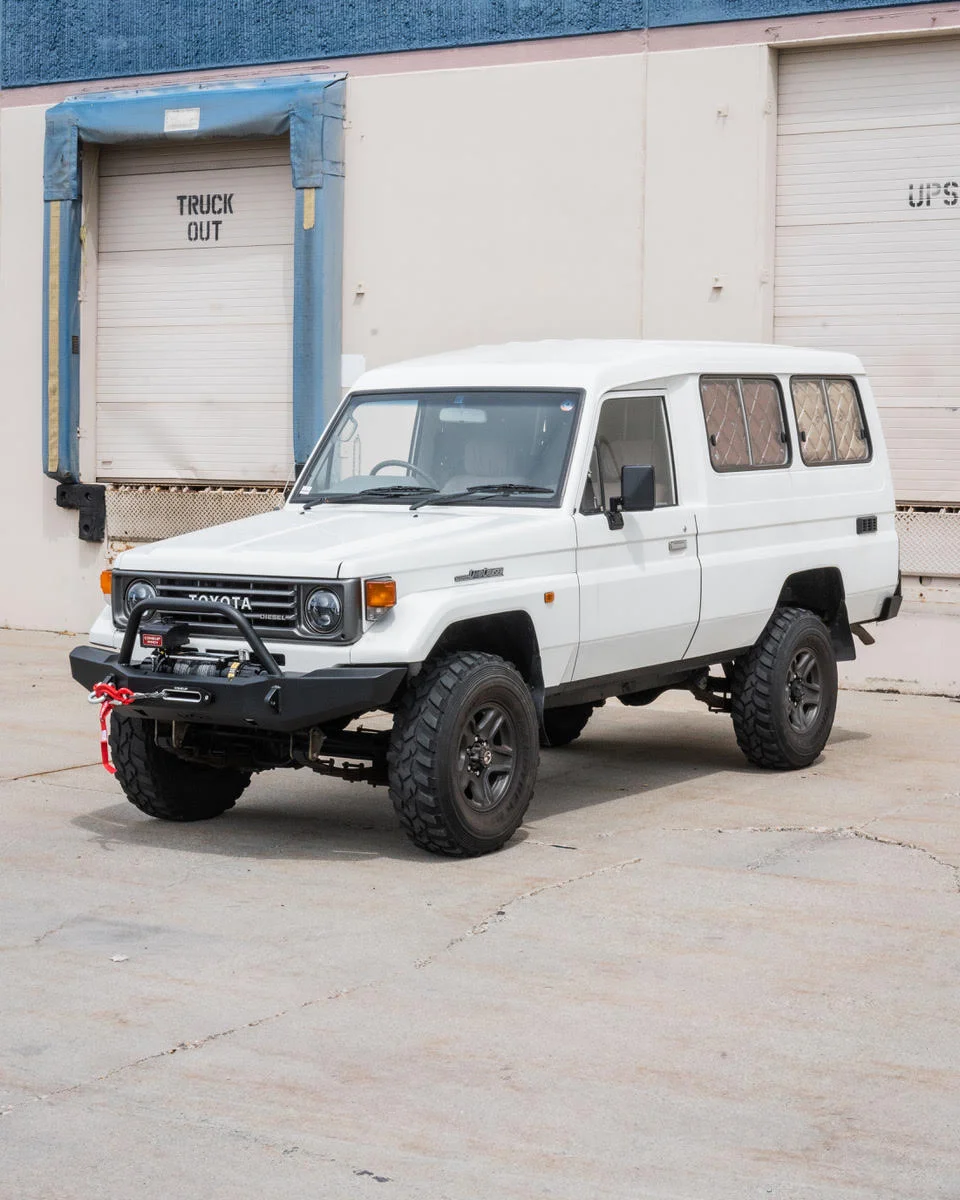

Pic of a ARB I put on one of my hzj73's , still think these are one of the best looking models available but I want better approach angles and a bumper without added bars on top

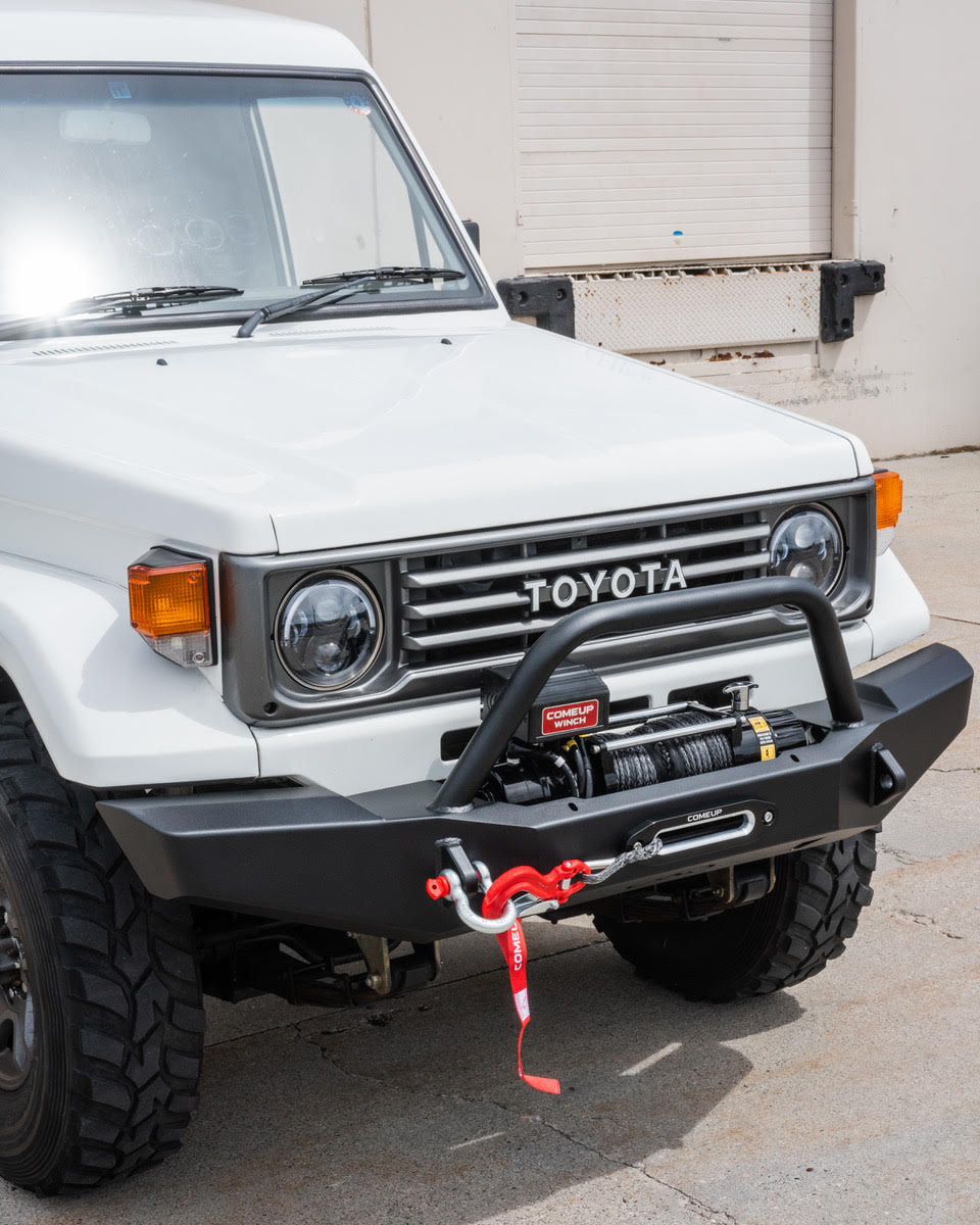

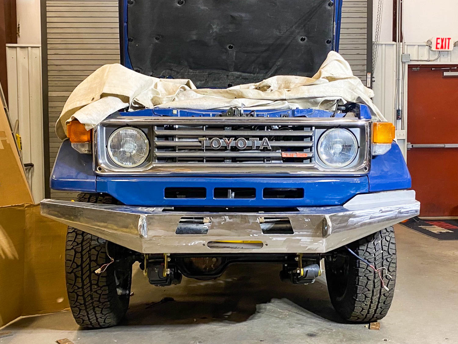

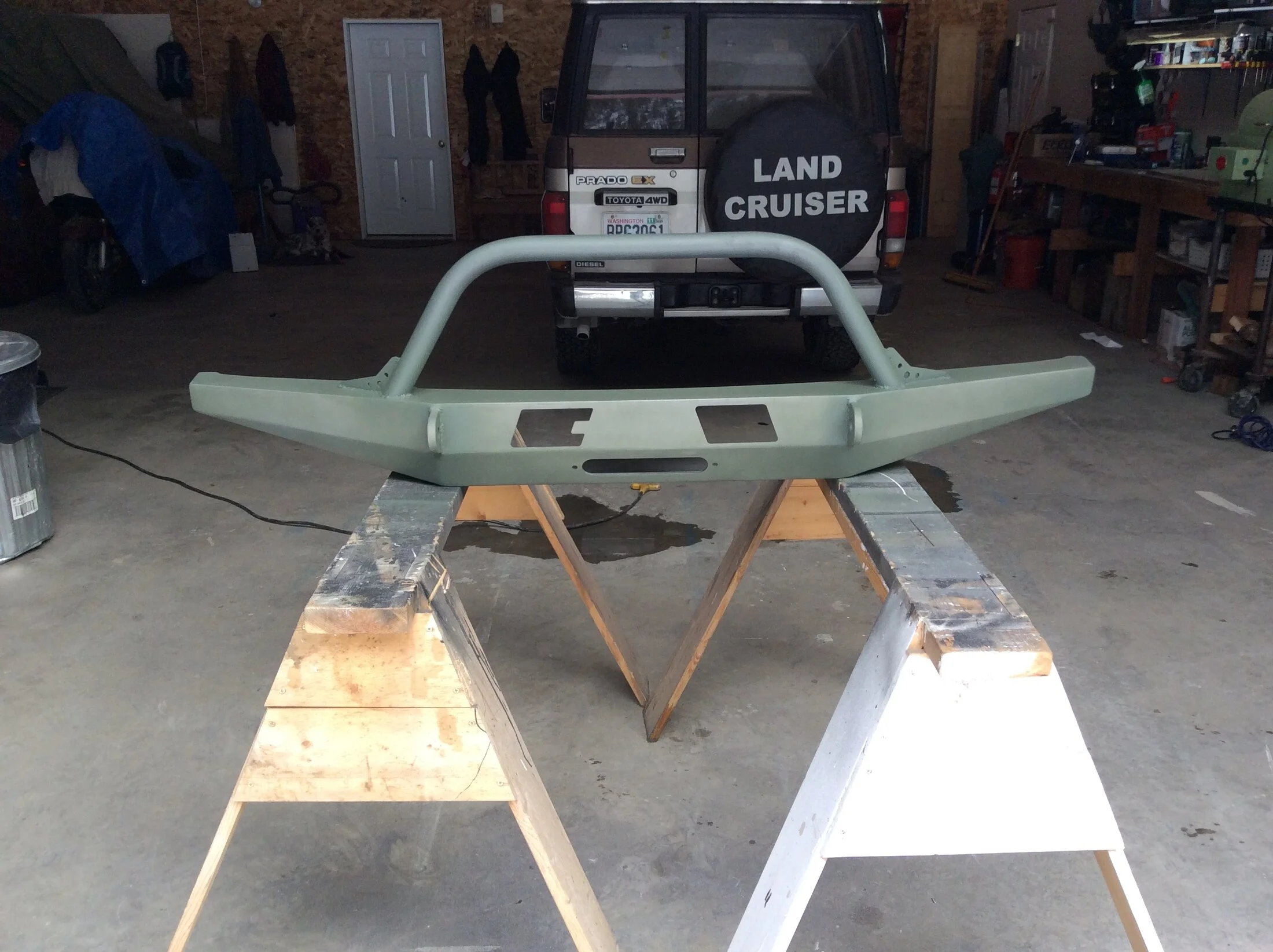

I've seen photos of a really nice front bumper that was made by Cruiser Outfitters. It was sleeker and more tucked up than the ARB, and had no hoops/bars on it. I wish I had saved the picture. Maybe they still make them?

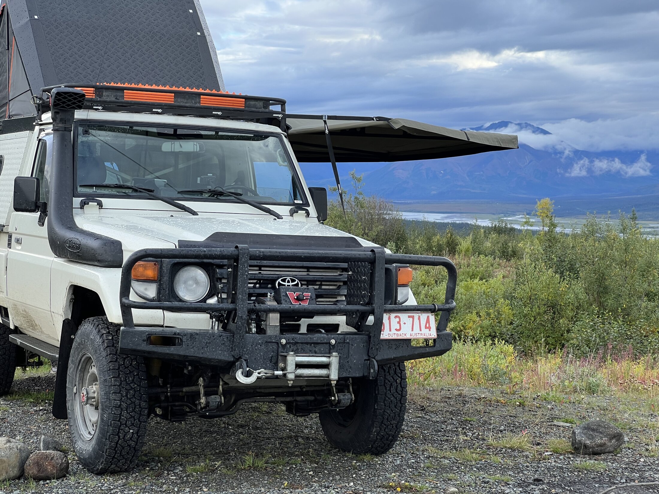

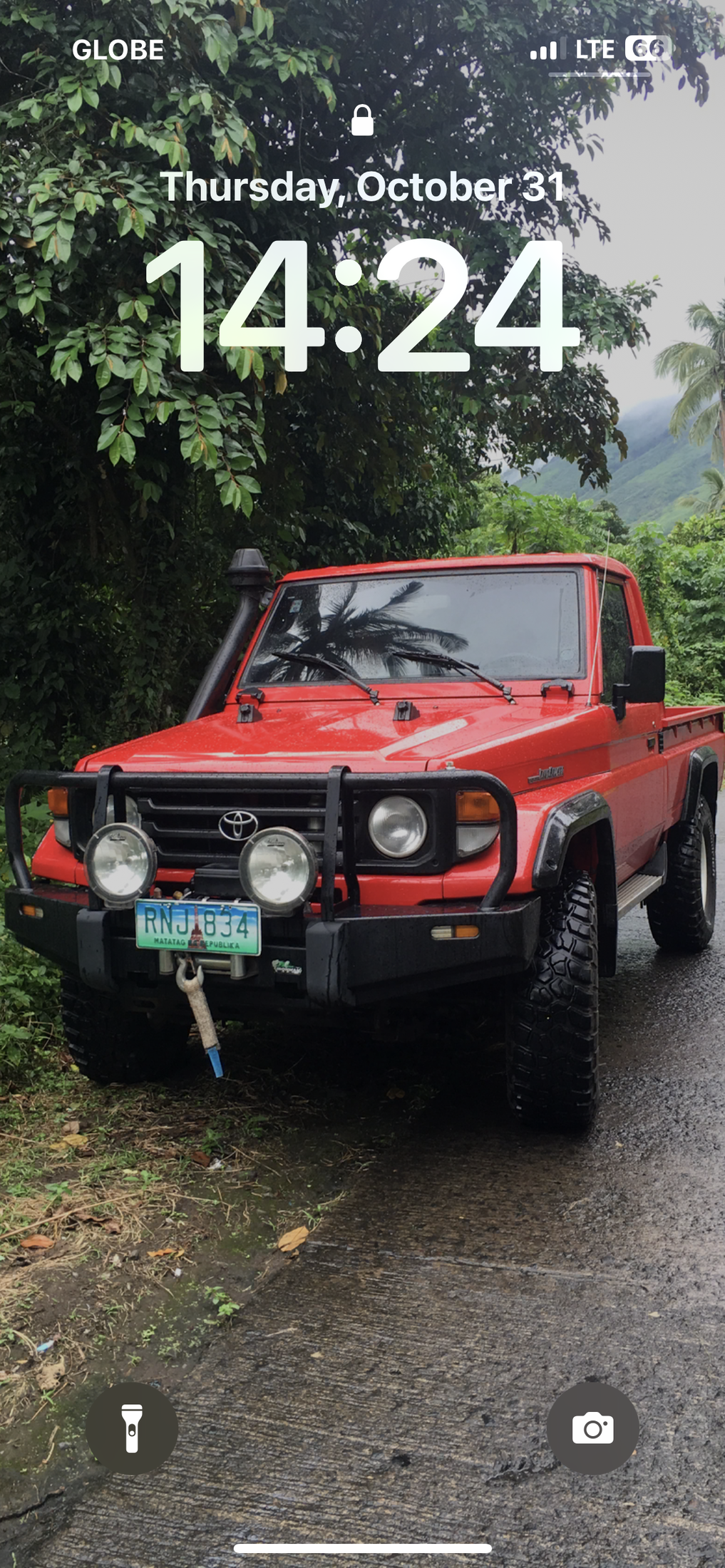

I am using an Ironman 4x4 front bumper that is quite durable and very much resembles the ARB bumper and will hold a winch.
Yes that is a option to but the same poor approach angles and the added bars I want to avoid . I had s few of them but prefer the arb over the ironman bumper for looks and finish .
Yes that is an option to but the same poor approach angles and the added bars I want to avoid . I had s few of them but prefer the arb over the ironman bumper for looks and finish .
Still offered. We shipped one today in fact. 😎 We’ve never added them to our website as they have continued to sell faster than we can get them made.

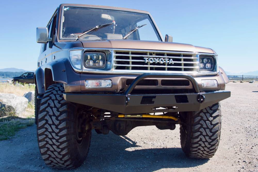

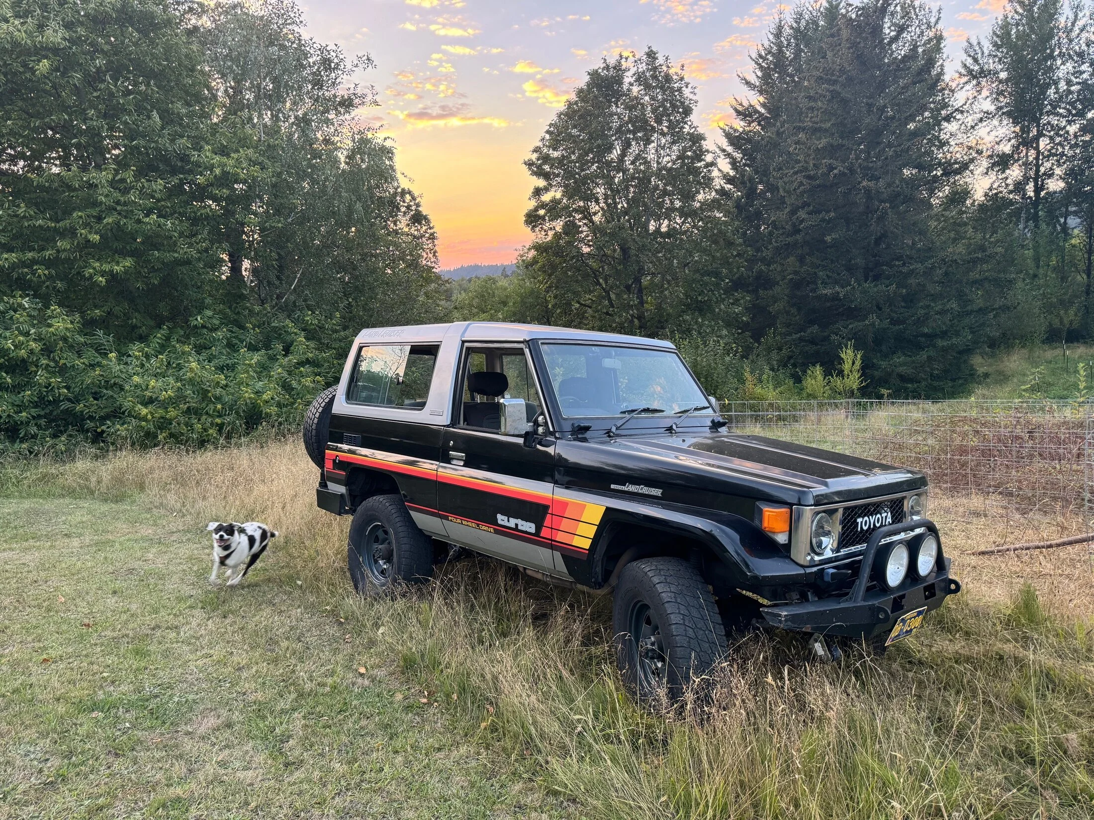

I've got a Coastal Offroad one on my 74 too and I'm happy with it. It does sit pretty close to the front valance but I think that's easy enough to deal with when you're assembling/welding (regarding winch fitment).
It looks likd the Coastal Offroad bumper has the best fit on the Prado models and the Cruiser Outfitters looks better on the HD models following the body lines . This is exactly what I was trying to see . Keep them coming guys

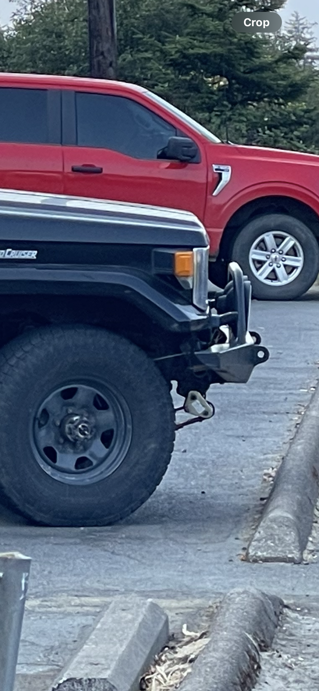

Here’s one of the coastal off-road bumper from the side. From appearances, I wouldn’t think cruiser outfitters sits lower in any meaningful way, just down to styling preferences. If I did mine again I’d probably have it pushed out a little more to the front, it’s easy enough when it’s welded up.
I also didn’t know cruiser outfitter did one when I bought mine, not sure which I would’ve picked had I known.
