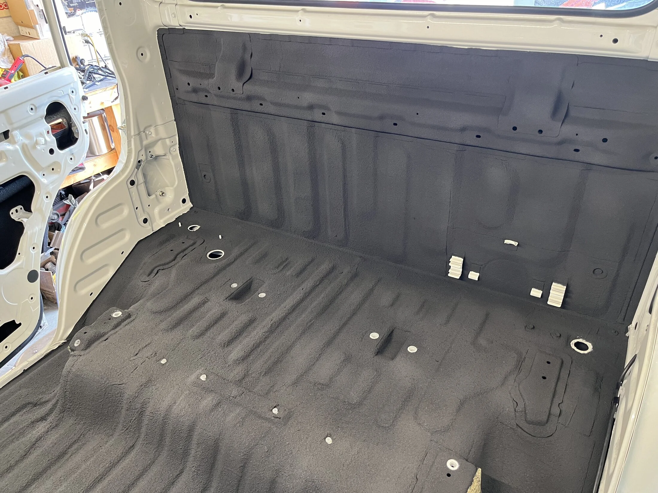

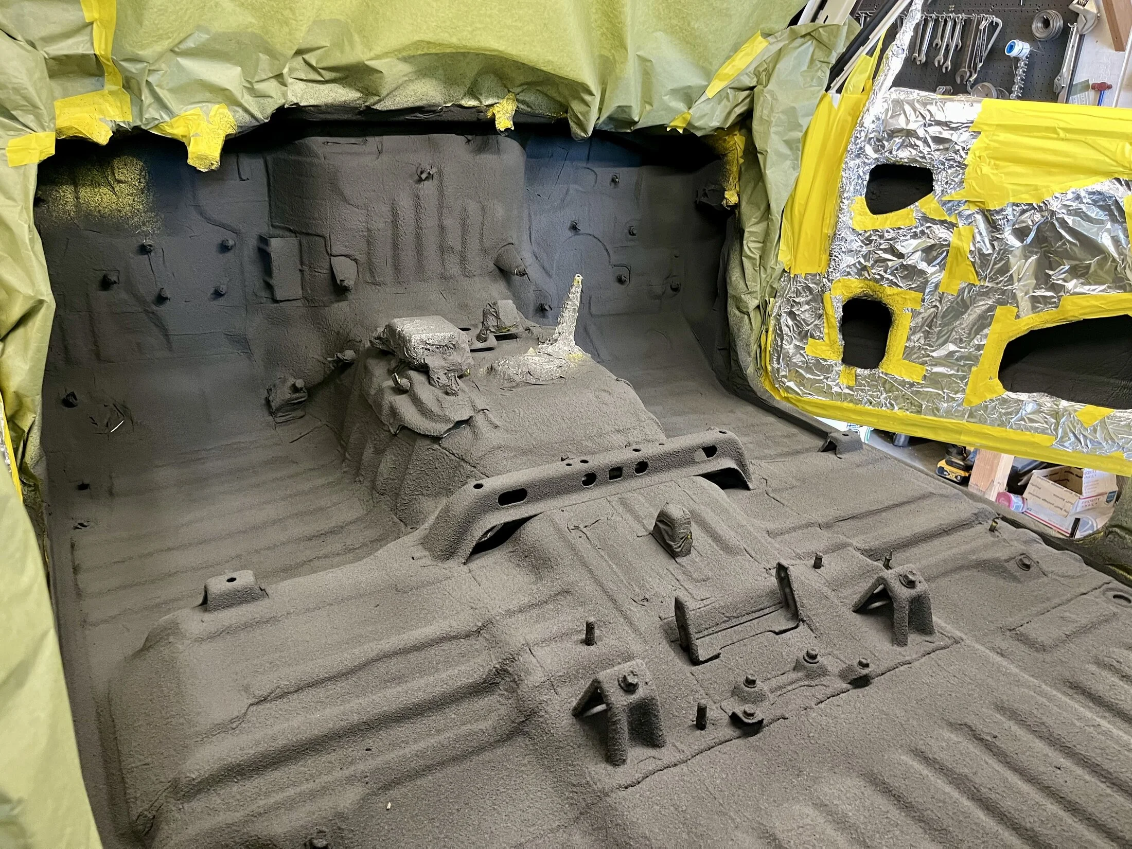

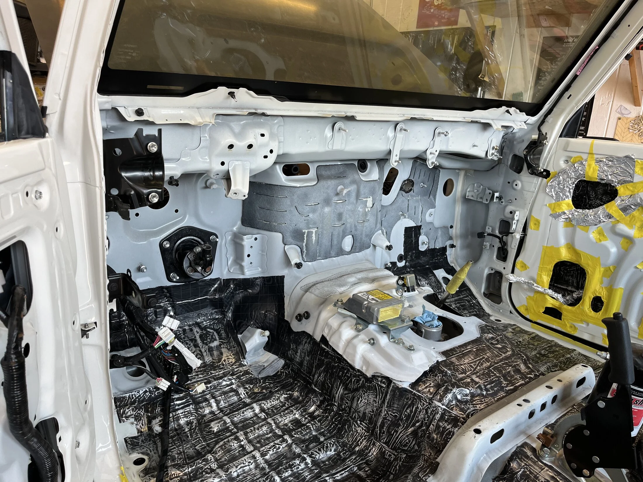

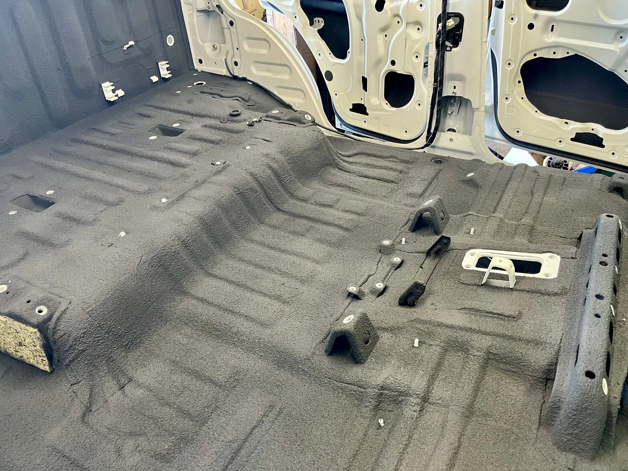

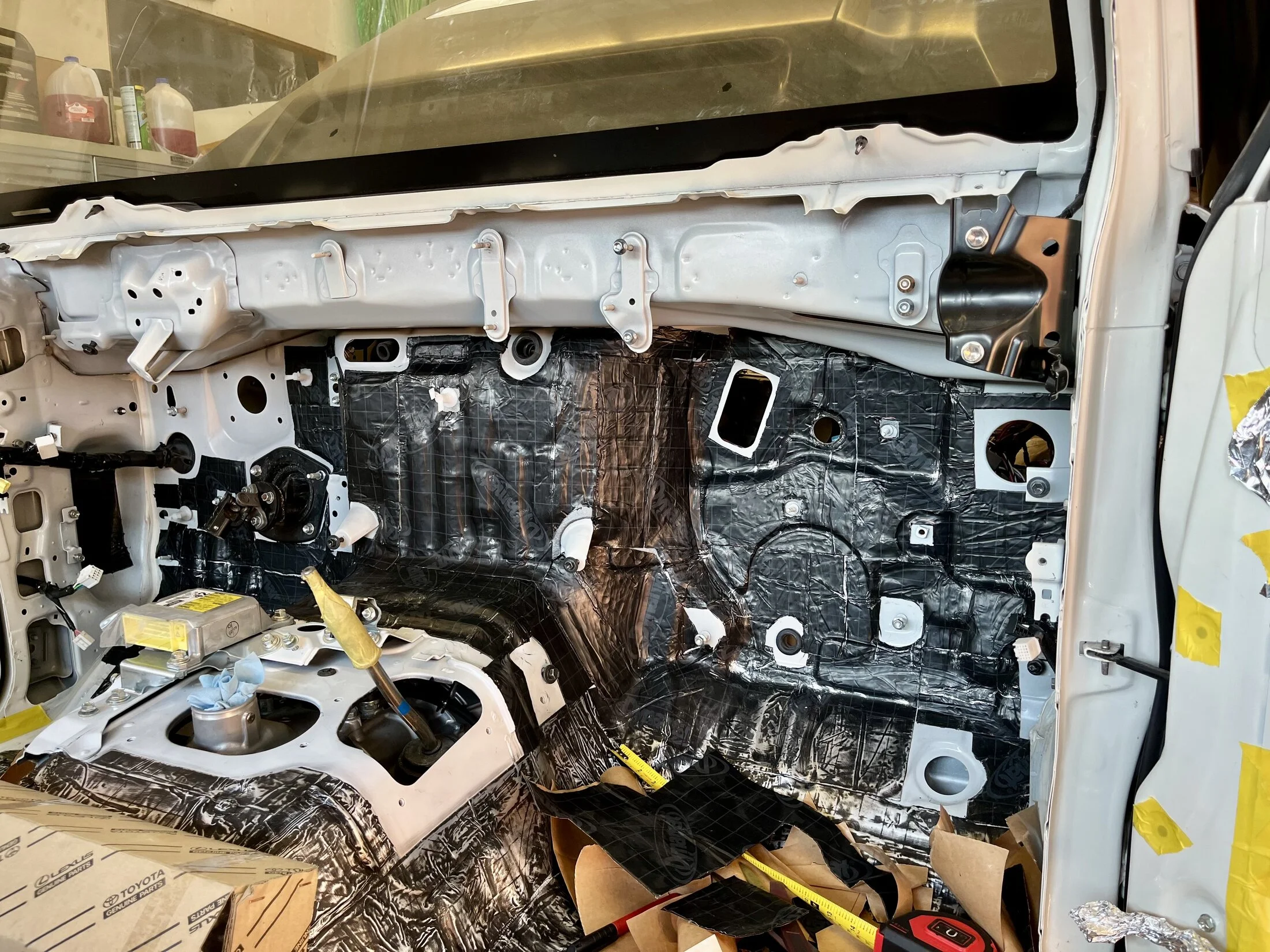

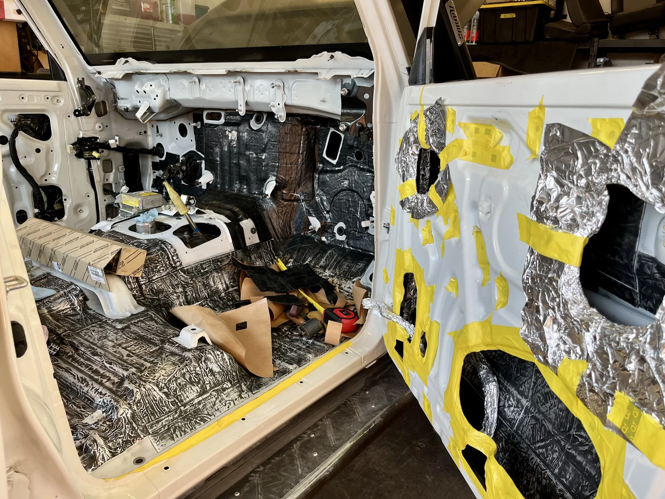

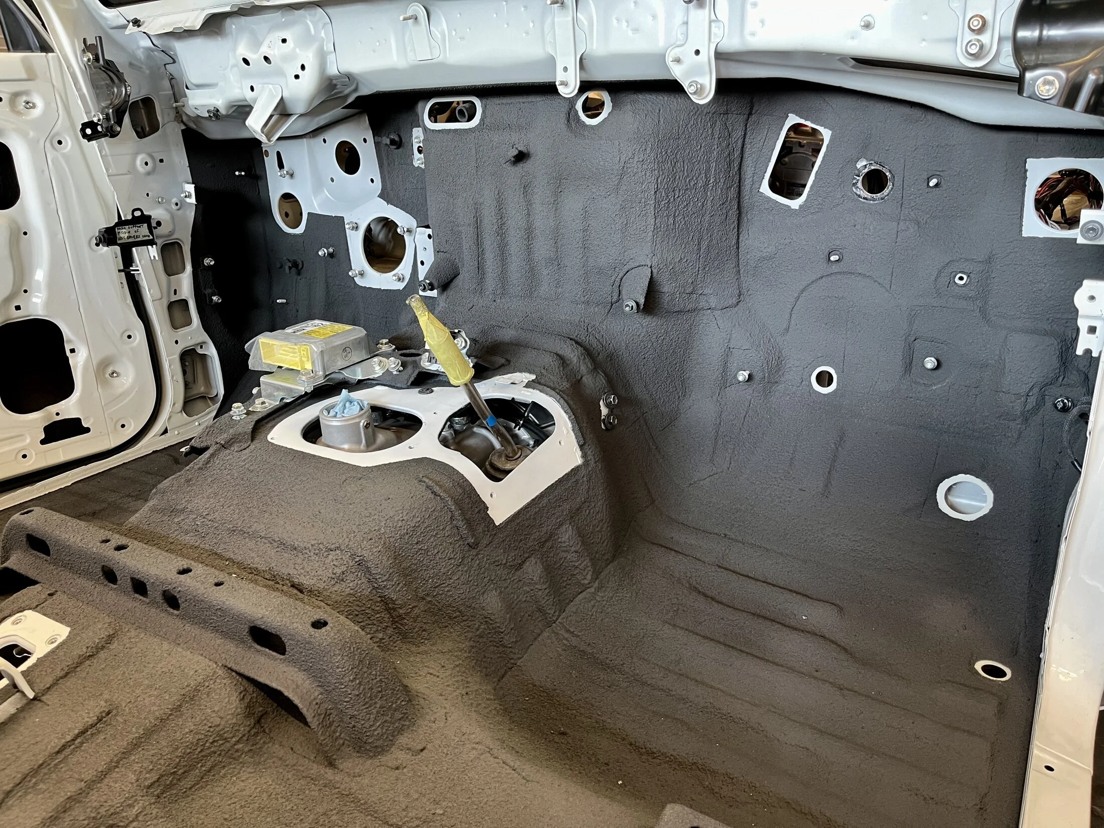

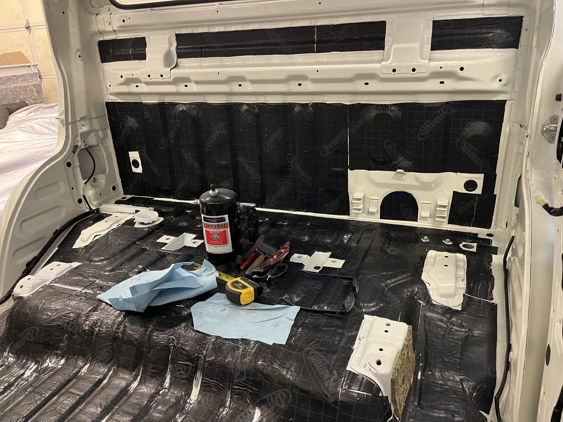

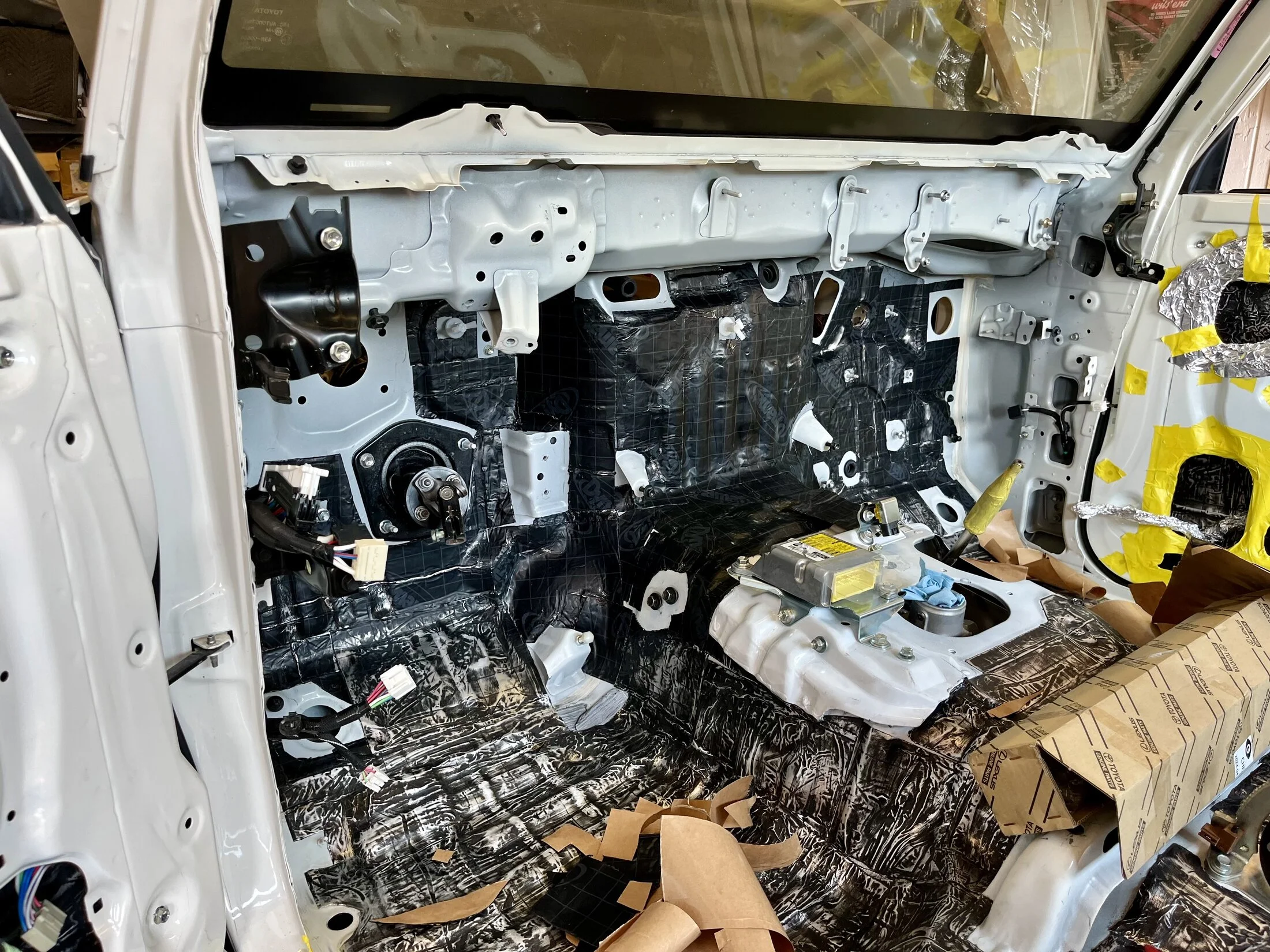

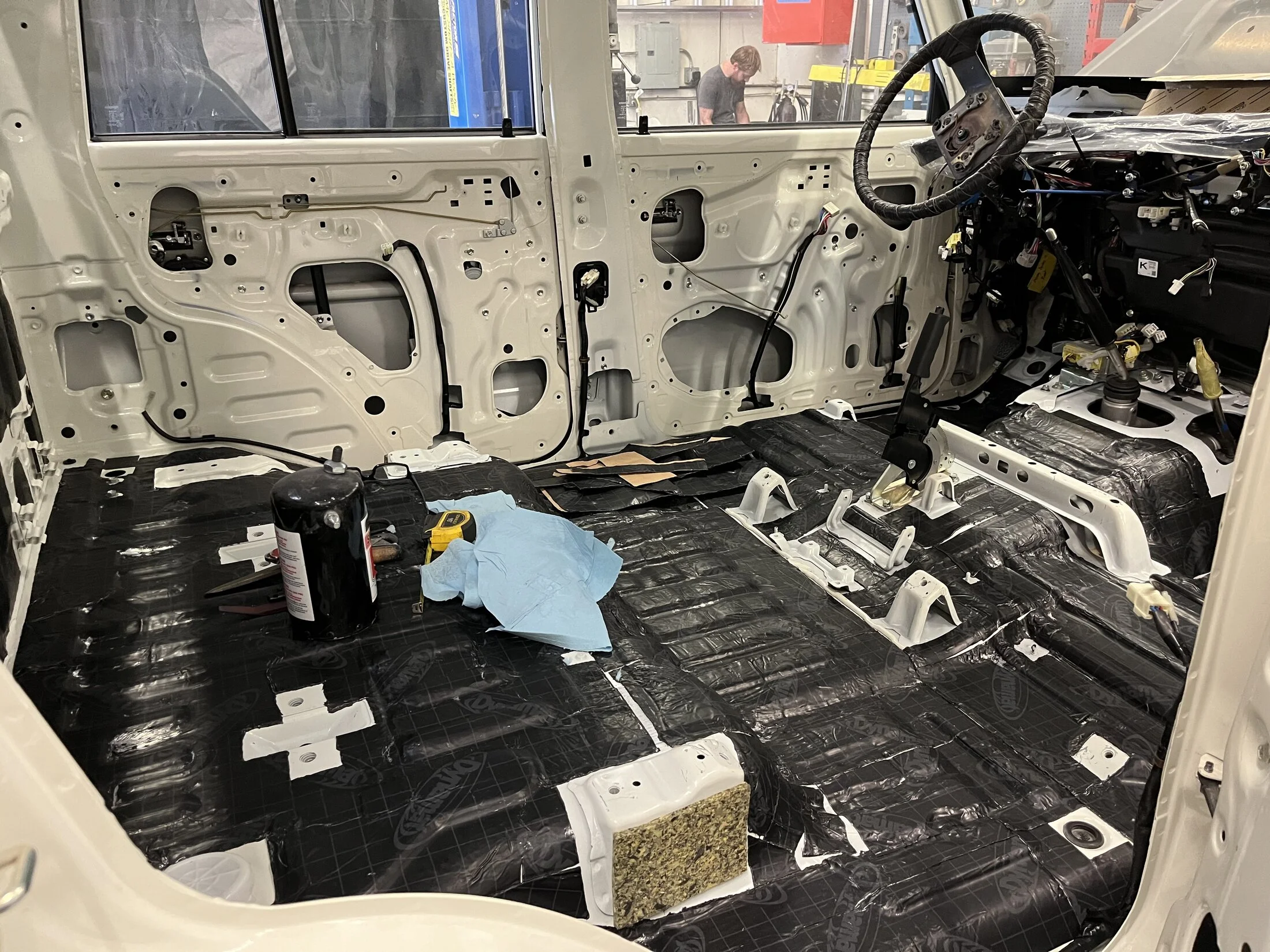

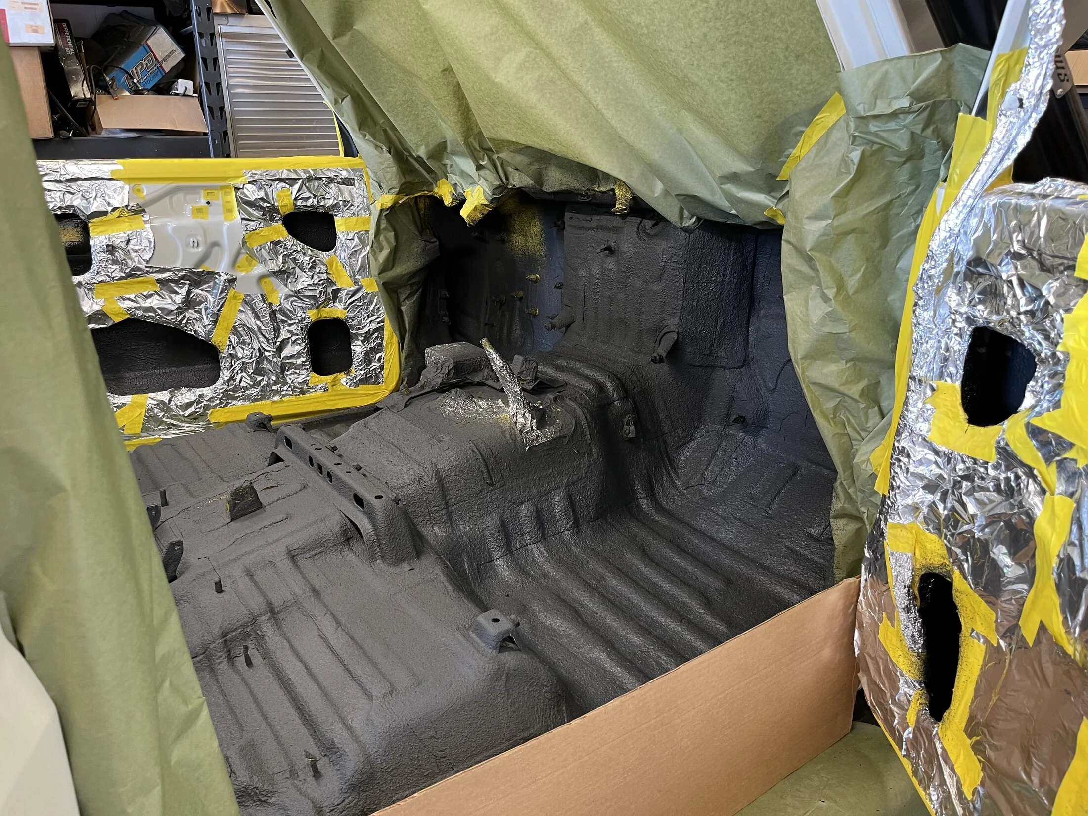

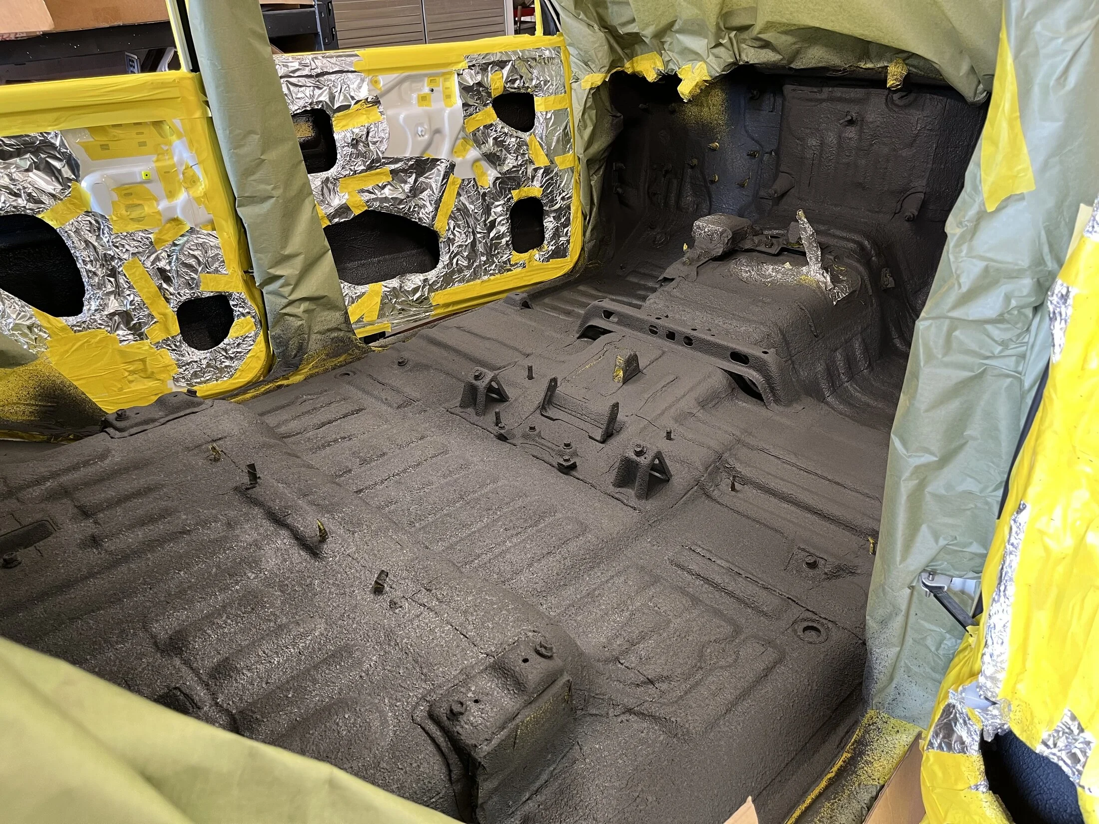

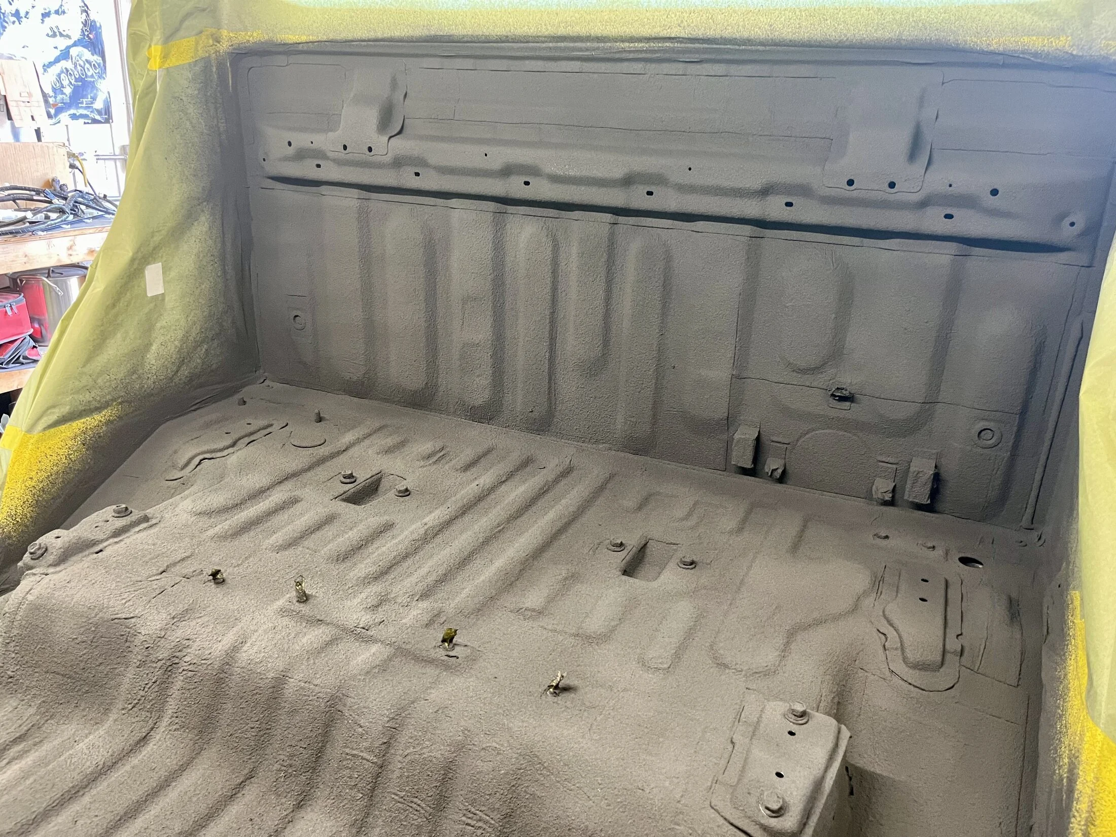

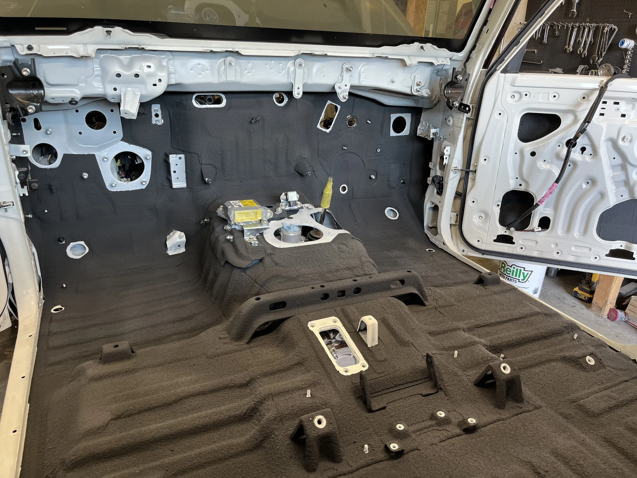

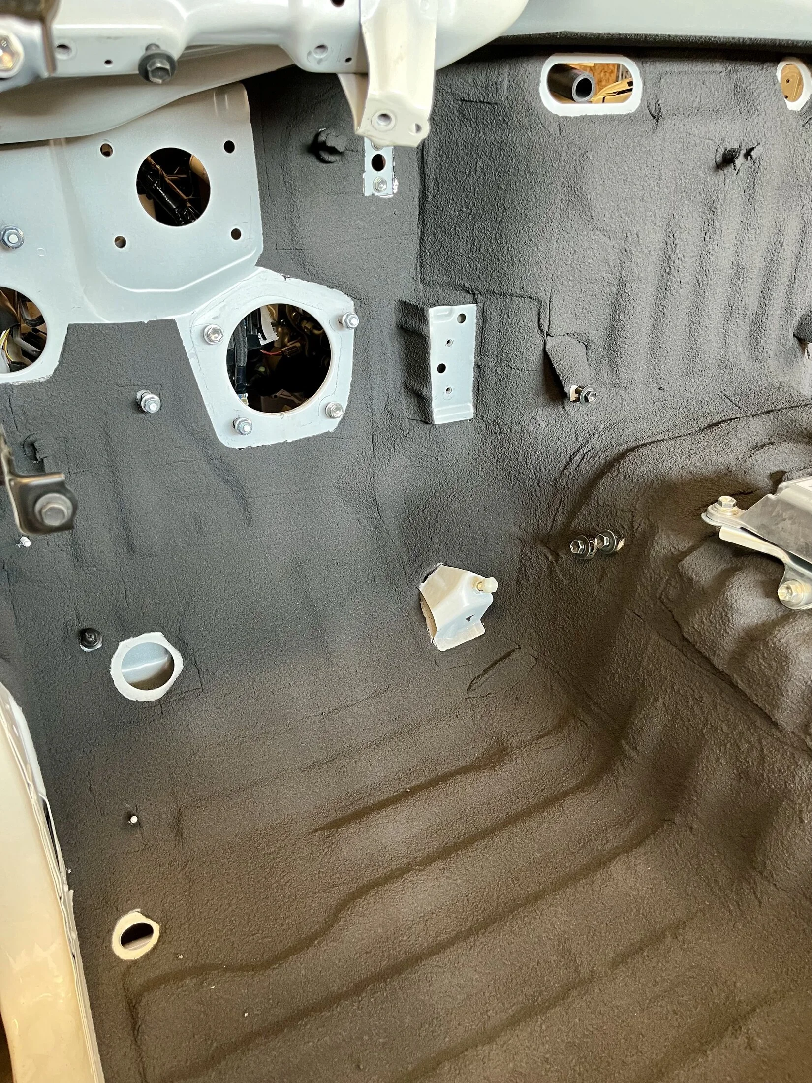

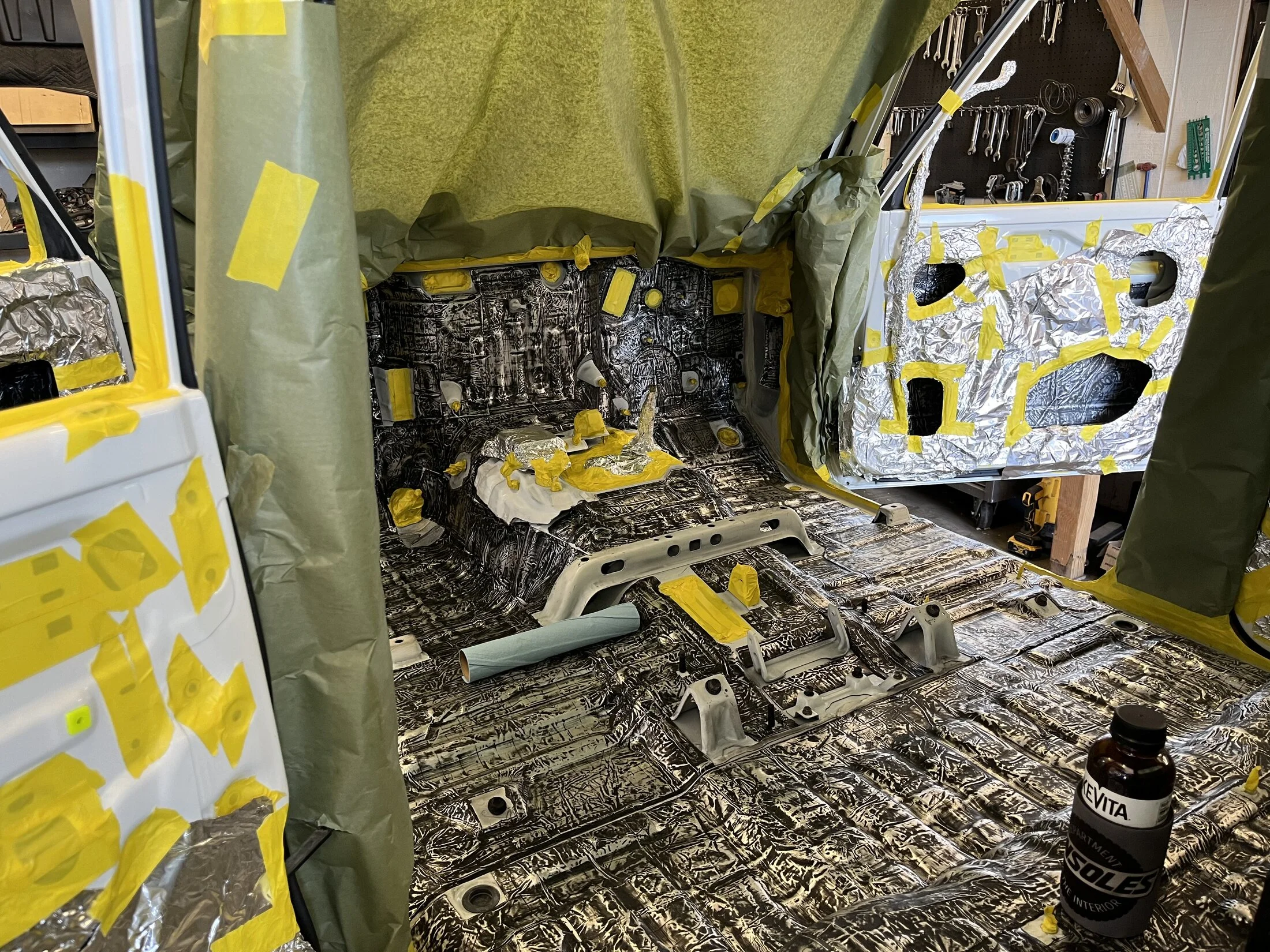

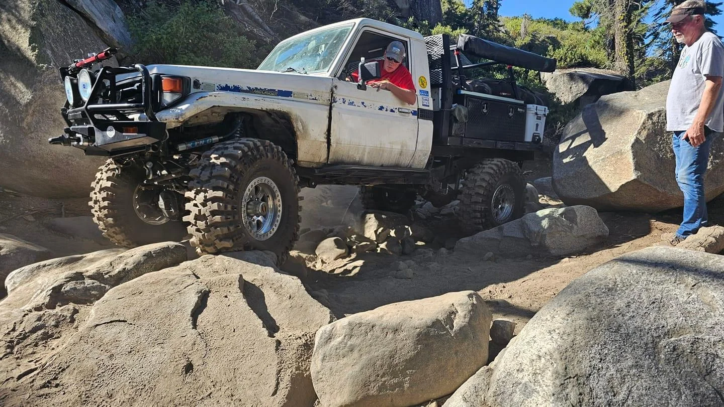

Phase one just about done of a big “three phase” sound deadening job on this 79.
Cheers

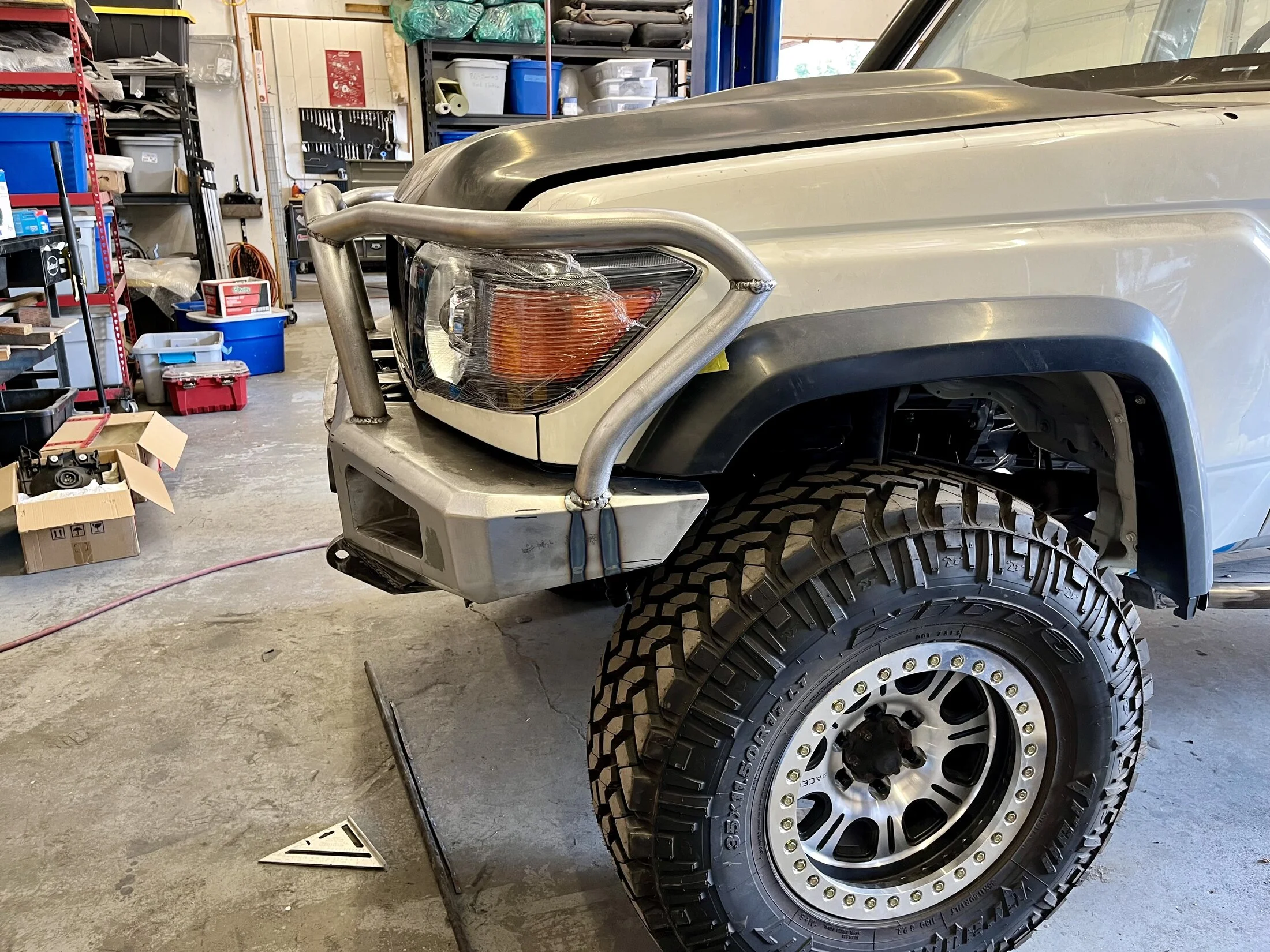

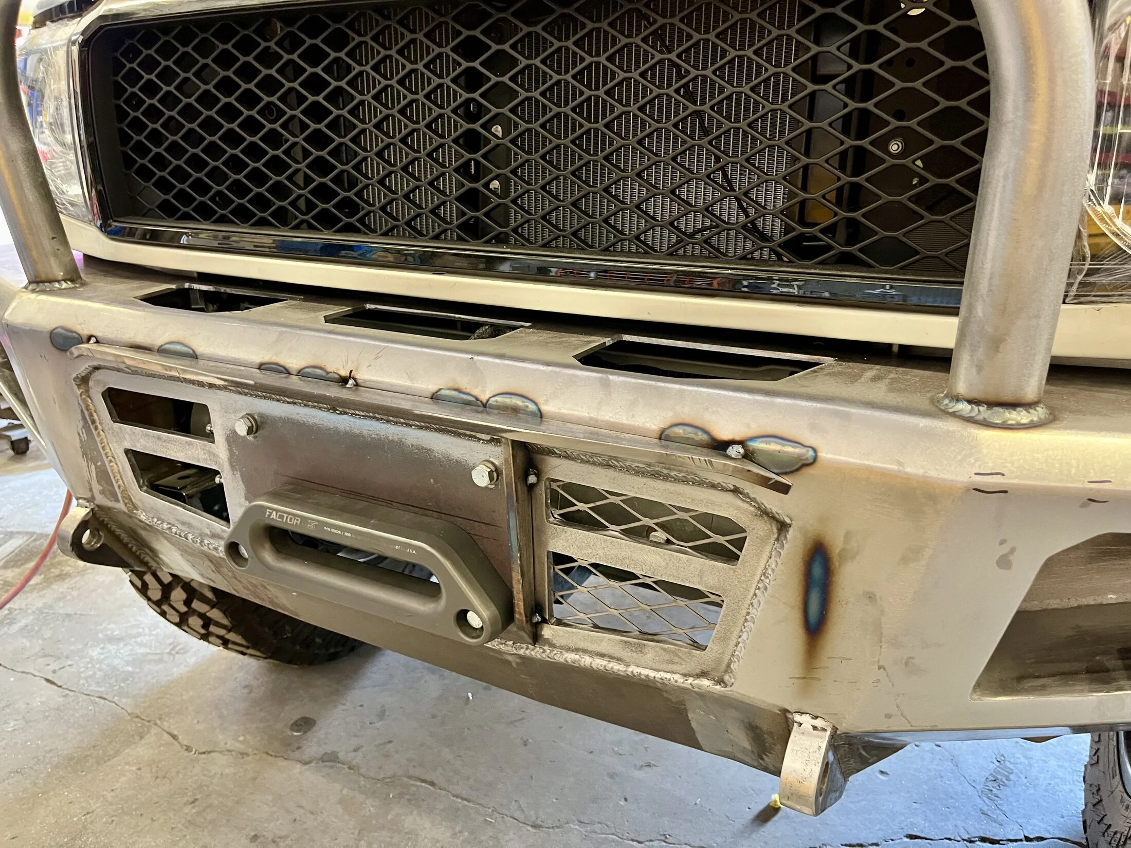

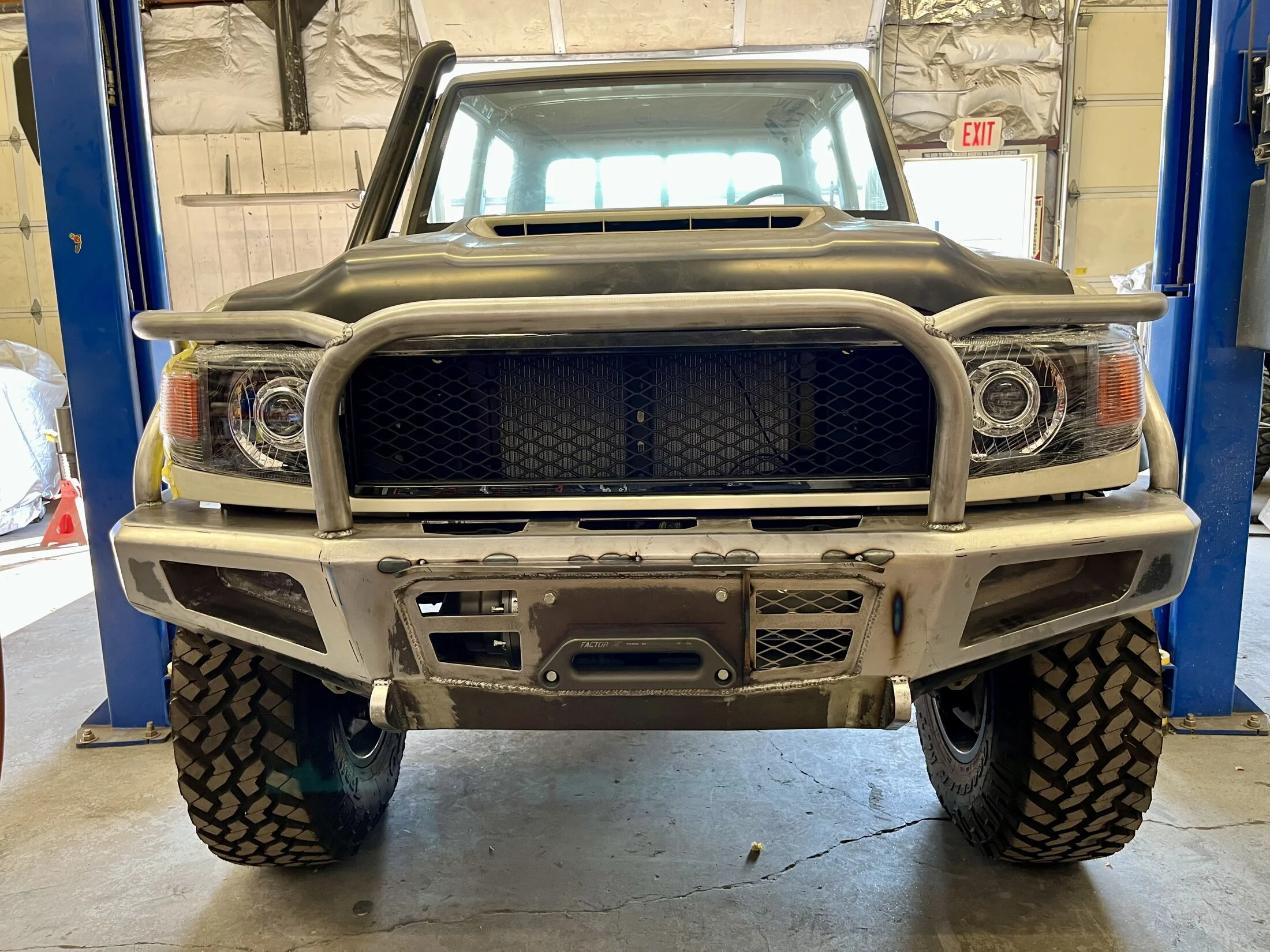

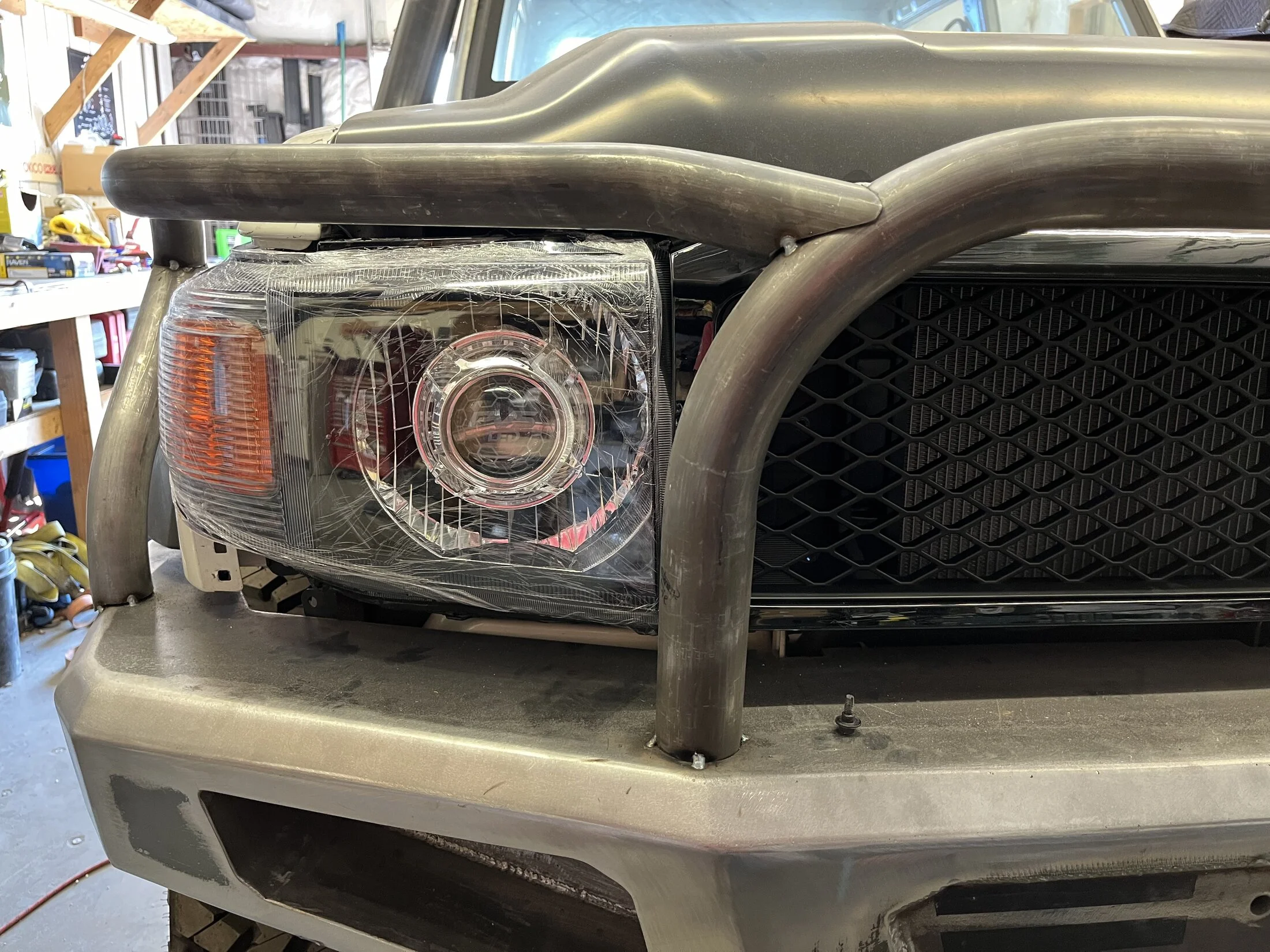

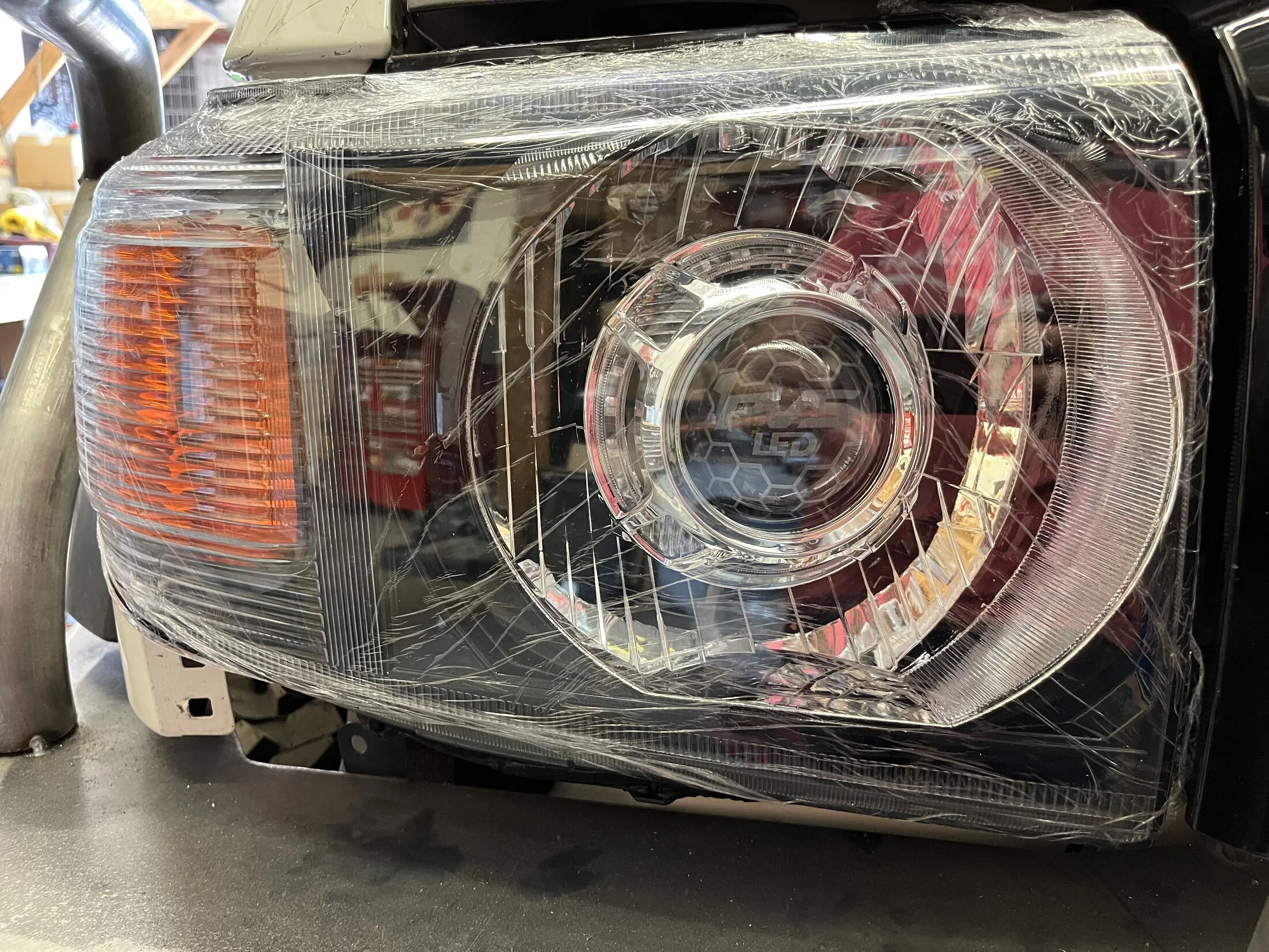

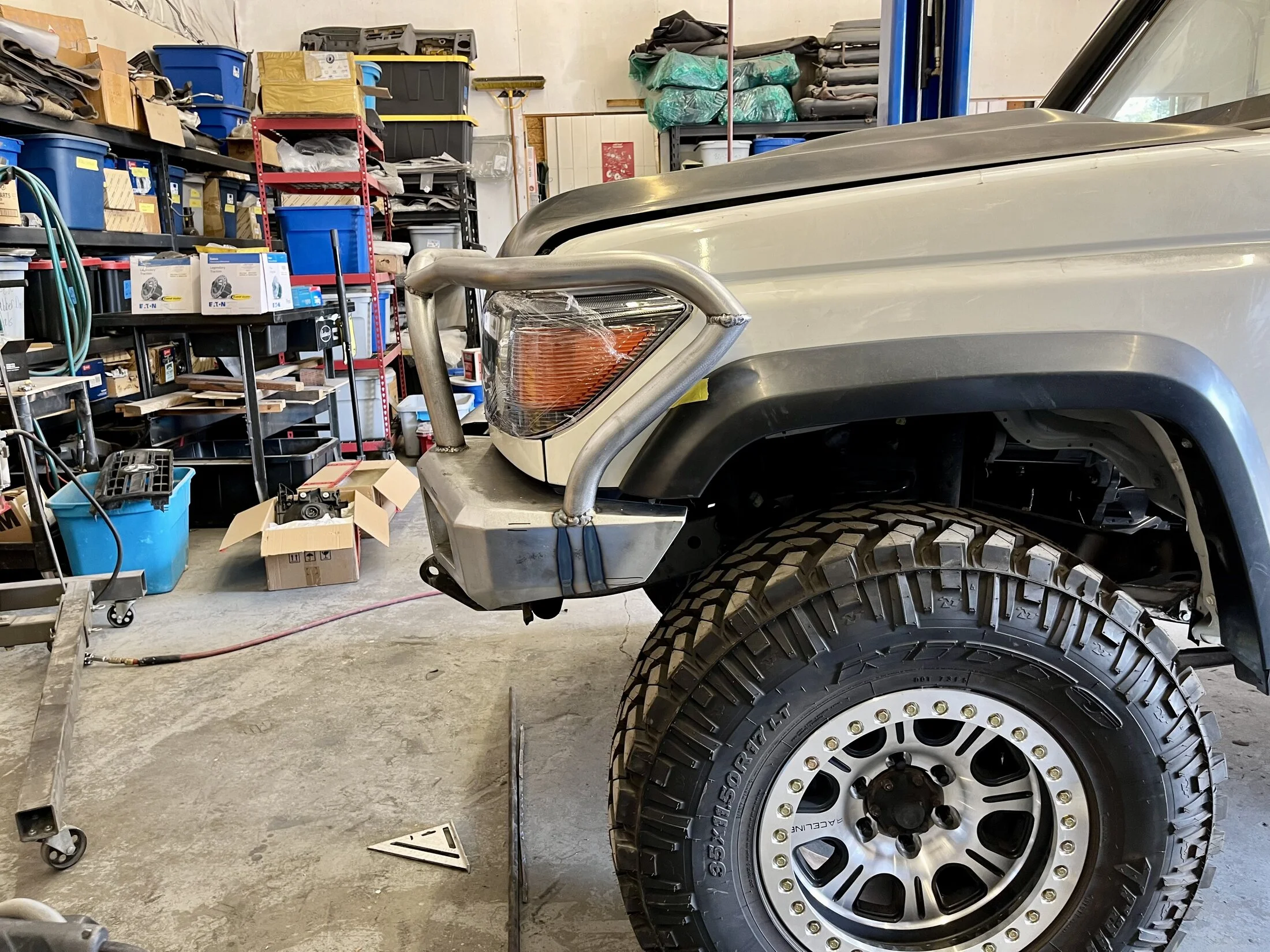

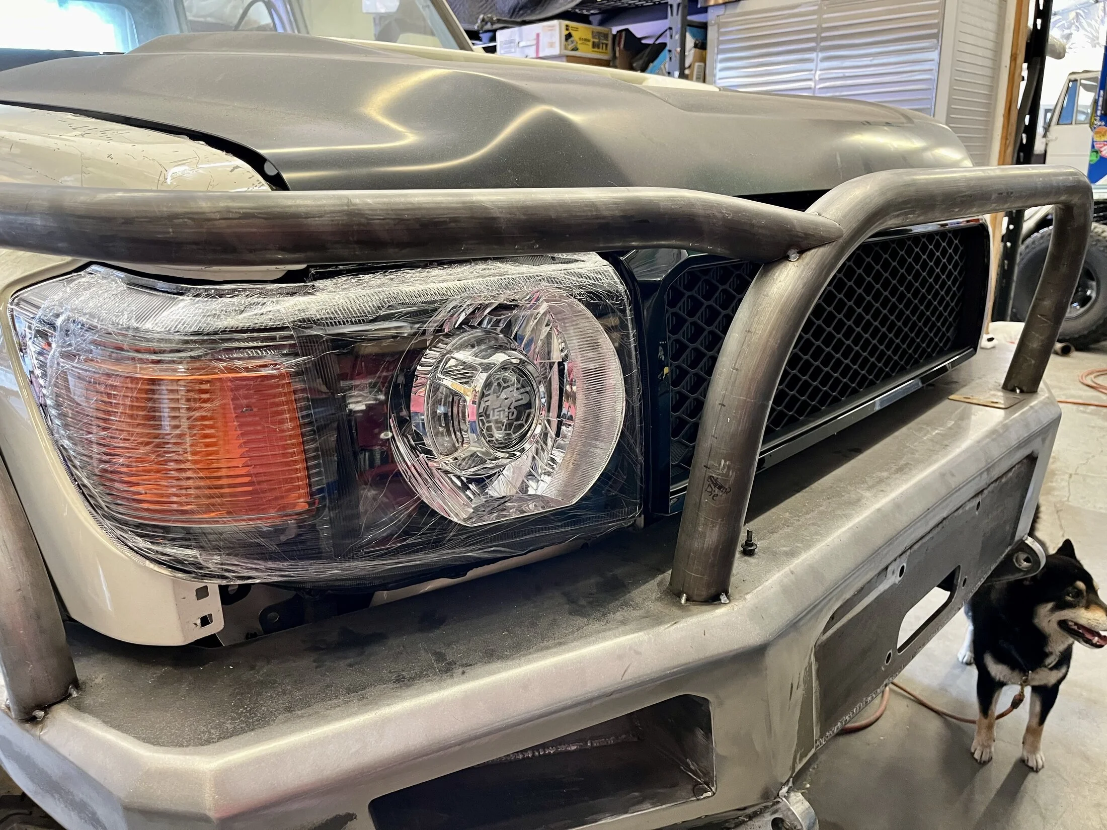

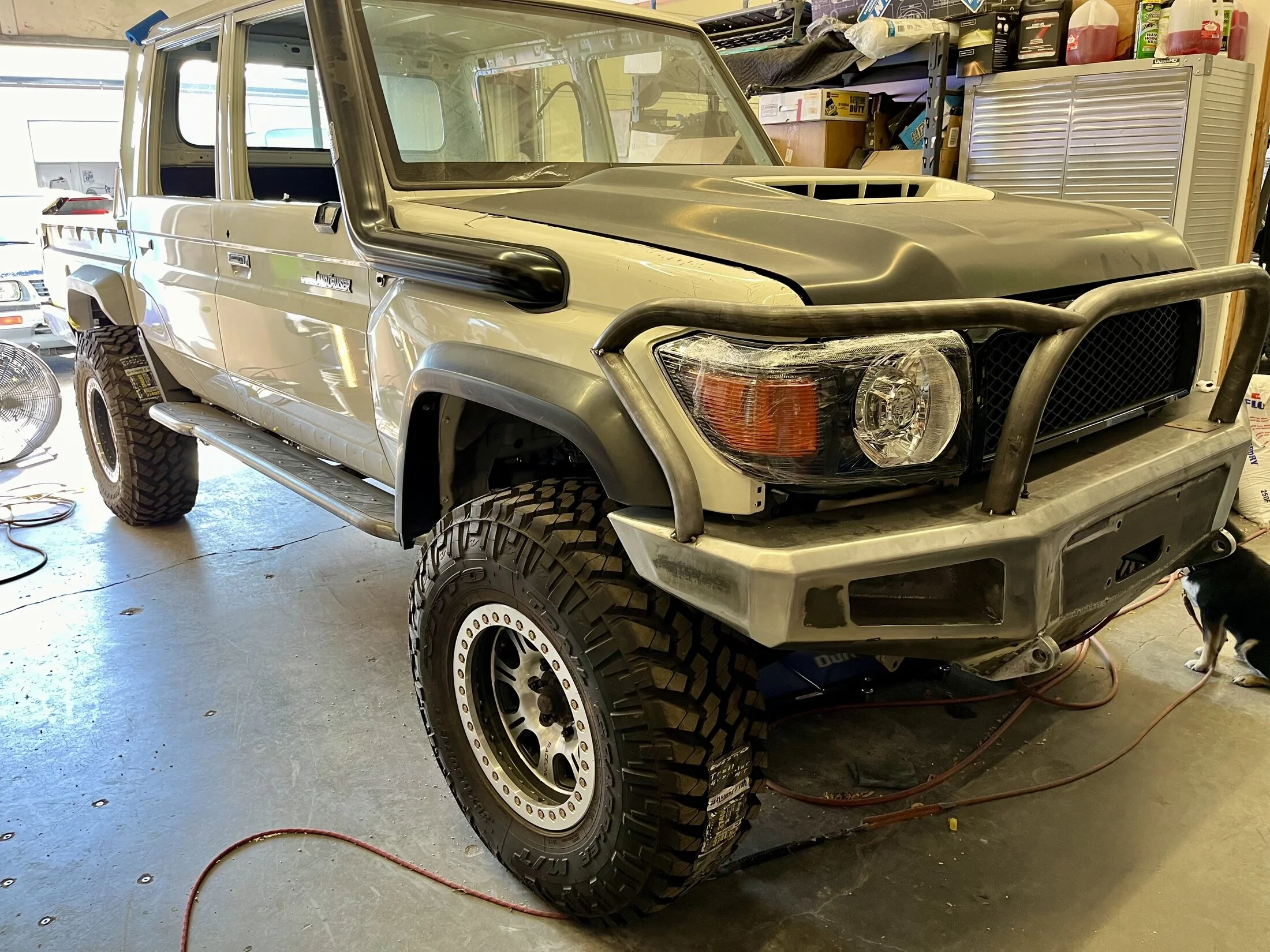

Just about there now on our custom bumper for this 79/80-series mash up build.

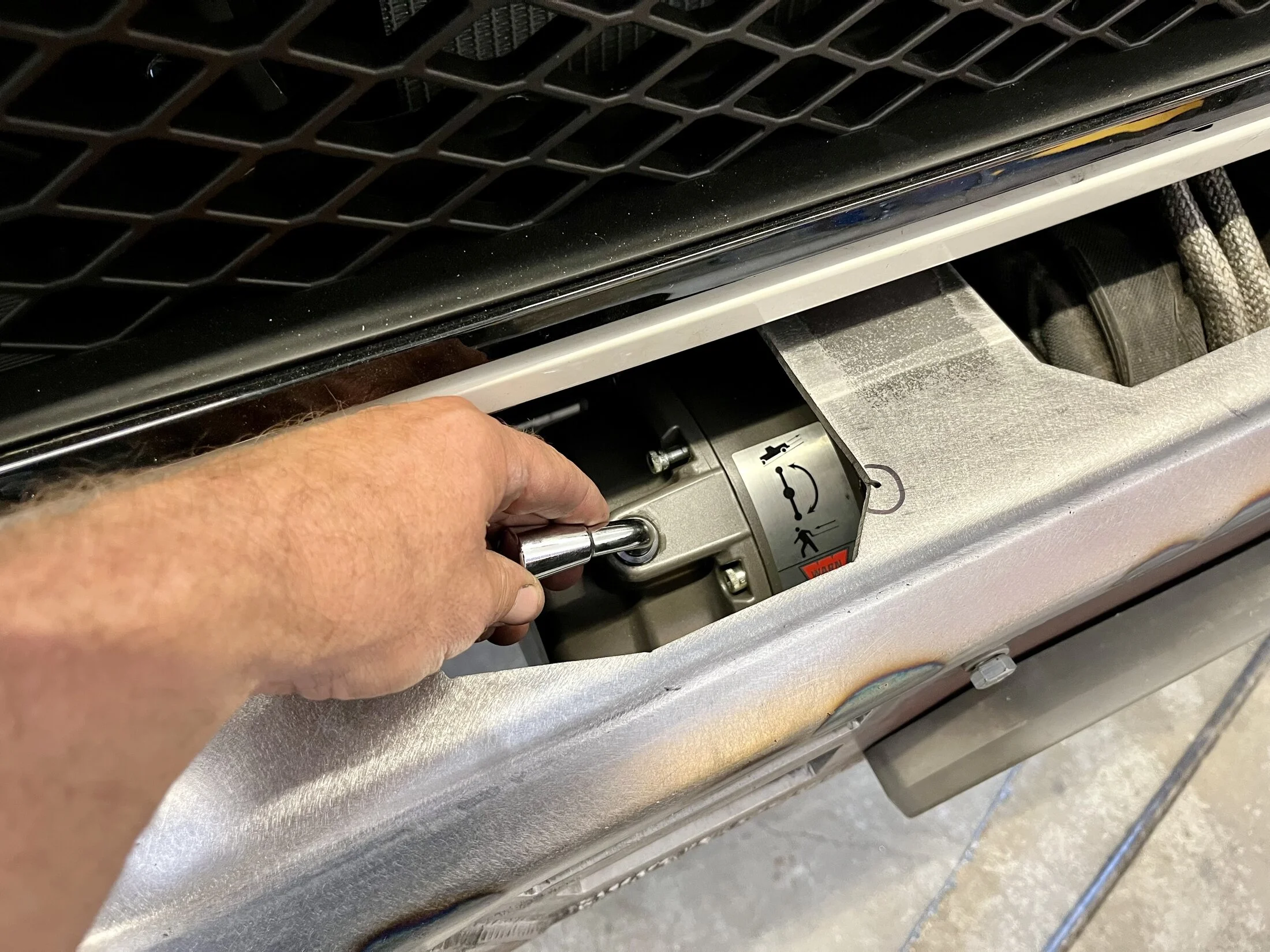

Warn 12k winch tucked in there. 😆
Cheers

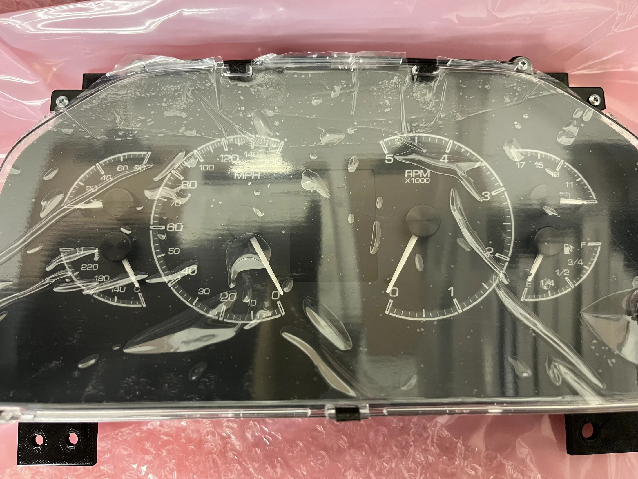

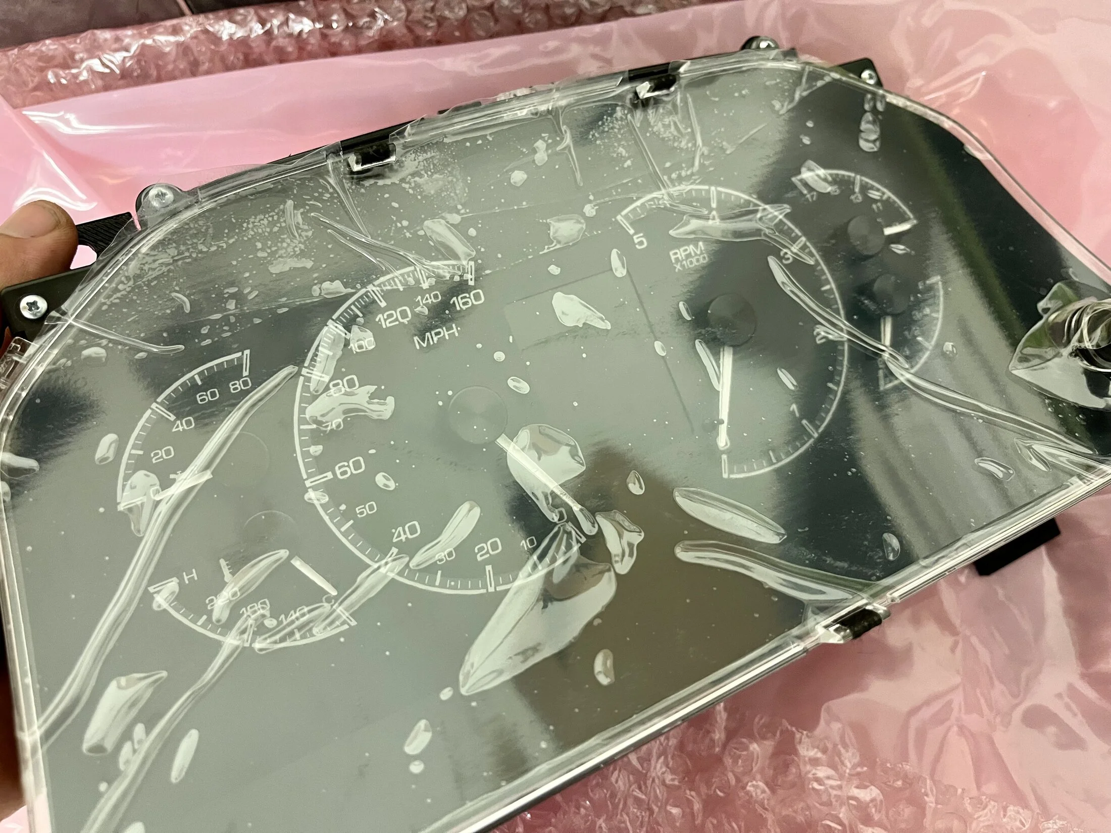

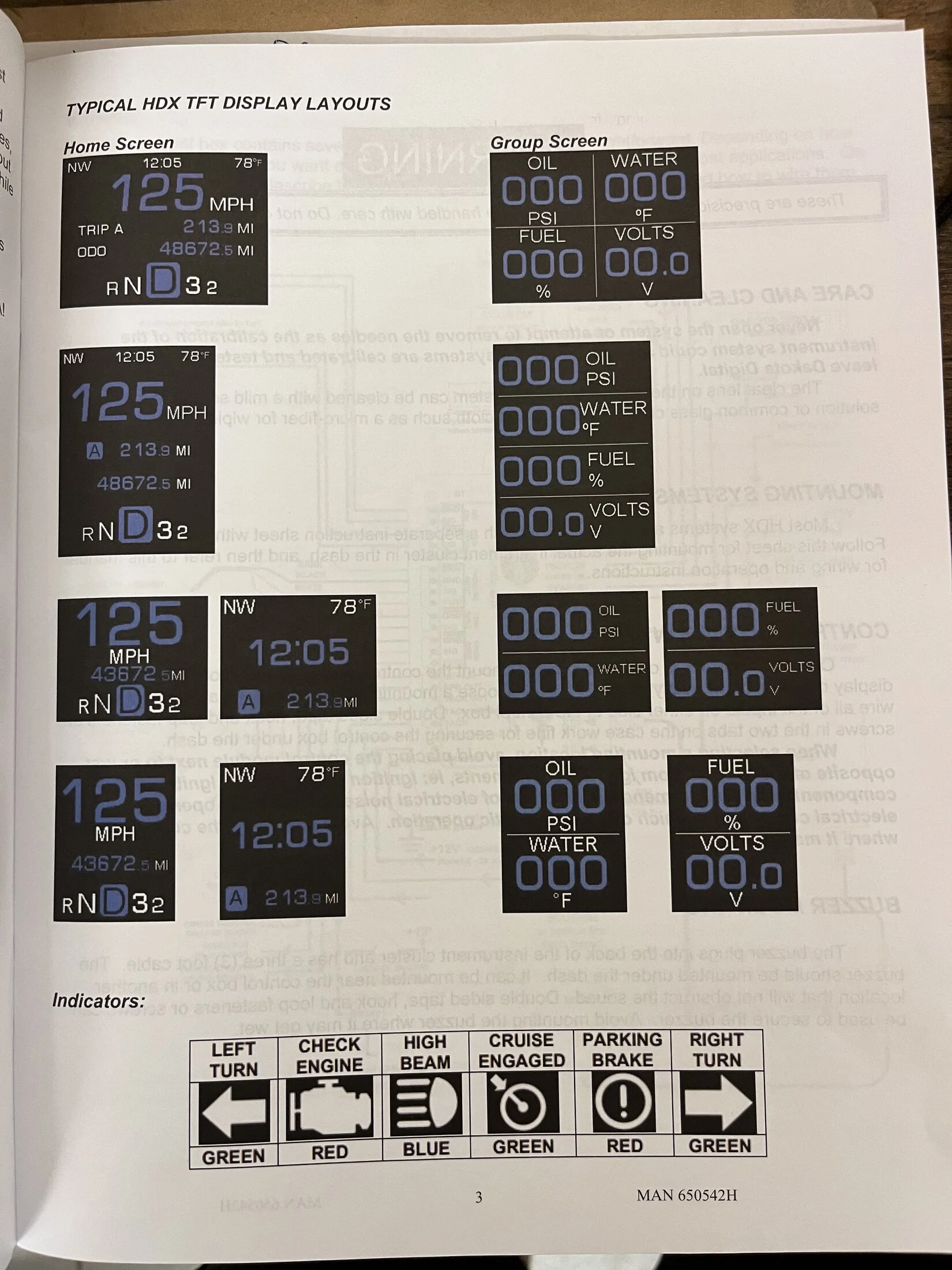

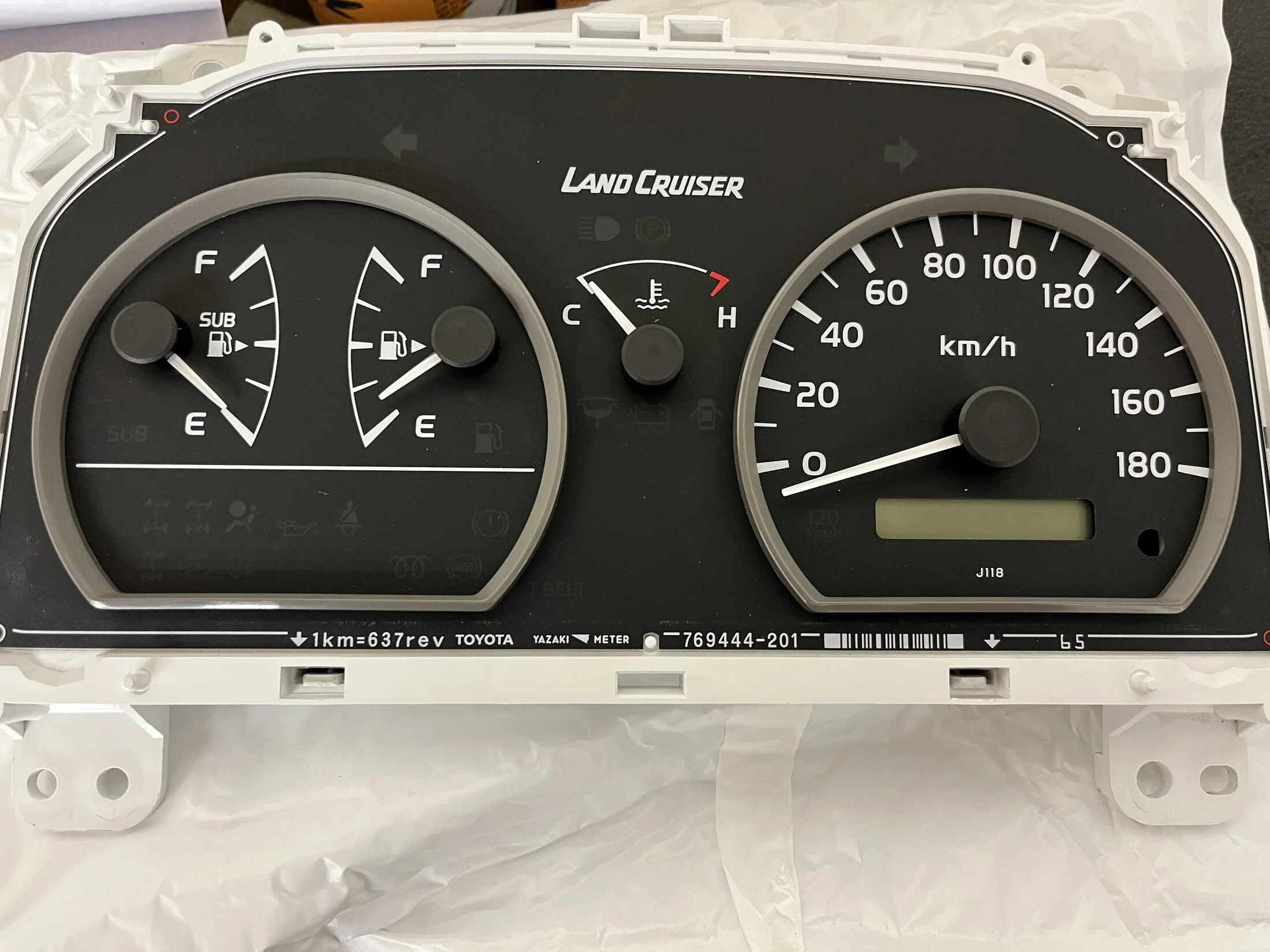

After searching the globe for a year this was the only new HZJ 79-series gauge cluster I could get my hands on. VDJ & GR clusters won’t work 100% with an FTE.
Well, that’s just not good enough for our build, we only have one tank and we want a tach. So we had Dakota Digital build us this!
Some of the many options available to us now.
No need to run separate gauges for EGT, boost or whatever, display screen covers that. 😄
Cheers
…oh we suplicate Dakota-gods-on-high, offer us 70-series clusters conformable to our heart’s desires, we beseech you…
