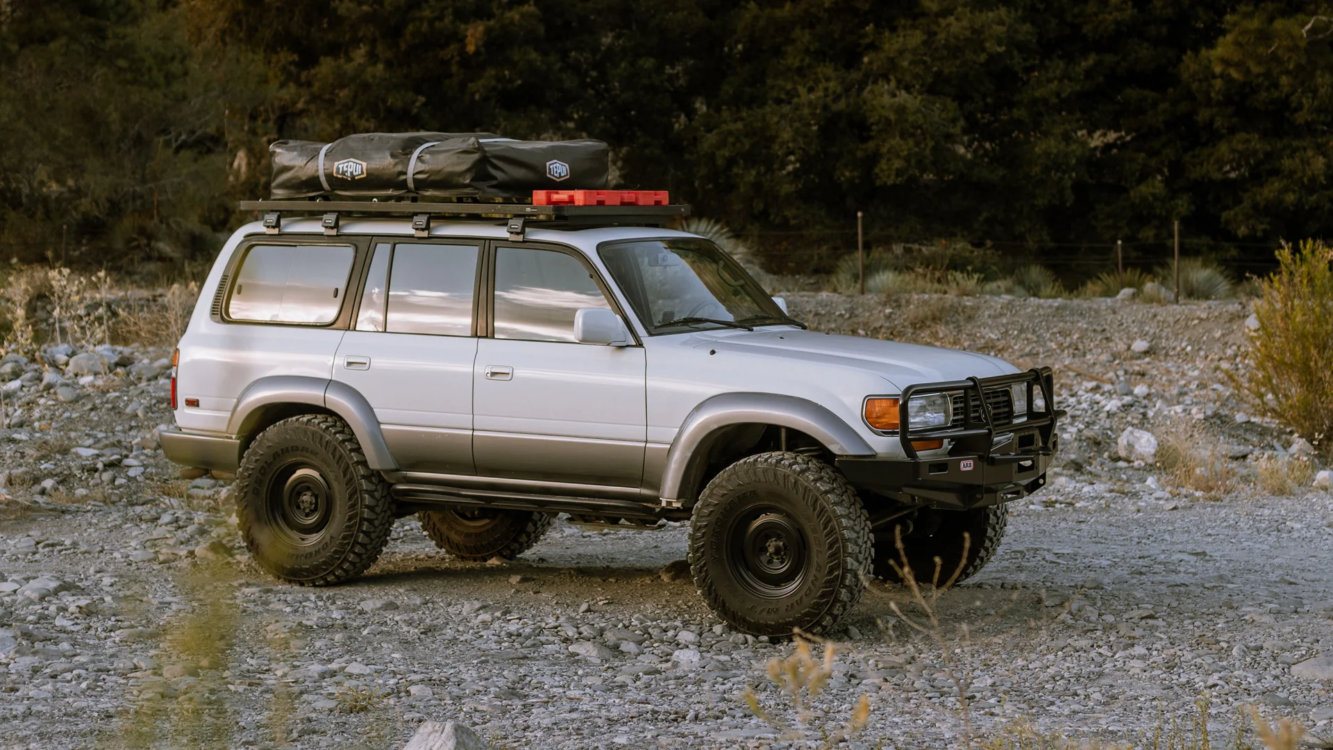

I"m about to buy this rims from a guy and I want to make sure they will fit my 1993 LC?
what is wrong with your factory rims ?
Here are the stock wheel specs…
Bolt pattern 6 x 5.5”, 6 x 139.7mm
Stock backspacing is 4.5”
Stock Offset is 0”
Center bore is 106mm
PCD is 139.7 (stud)
Stock is 16”x 8” with Offset of 0mm.
The wheels you are considering are narrow at 7.5”. You should check with the tire shop that will mount your tires. I’ve heard of some shops not mounting larger tires on 7.5” wheels. YMMV
That’s a very nice rim. Never heard of them before, but seems they make some really good looking rims. I’d get it if my tire fits a 7.5” wide rim.

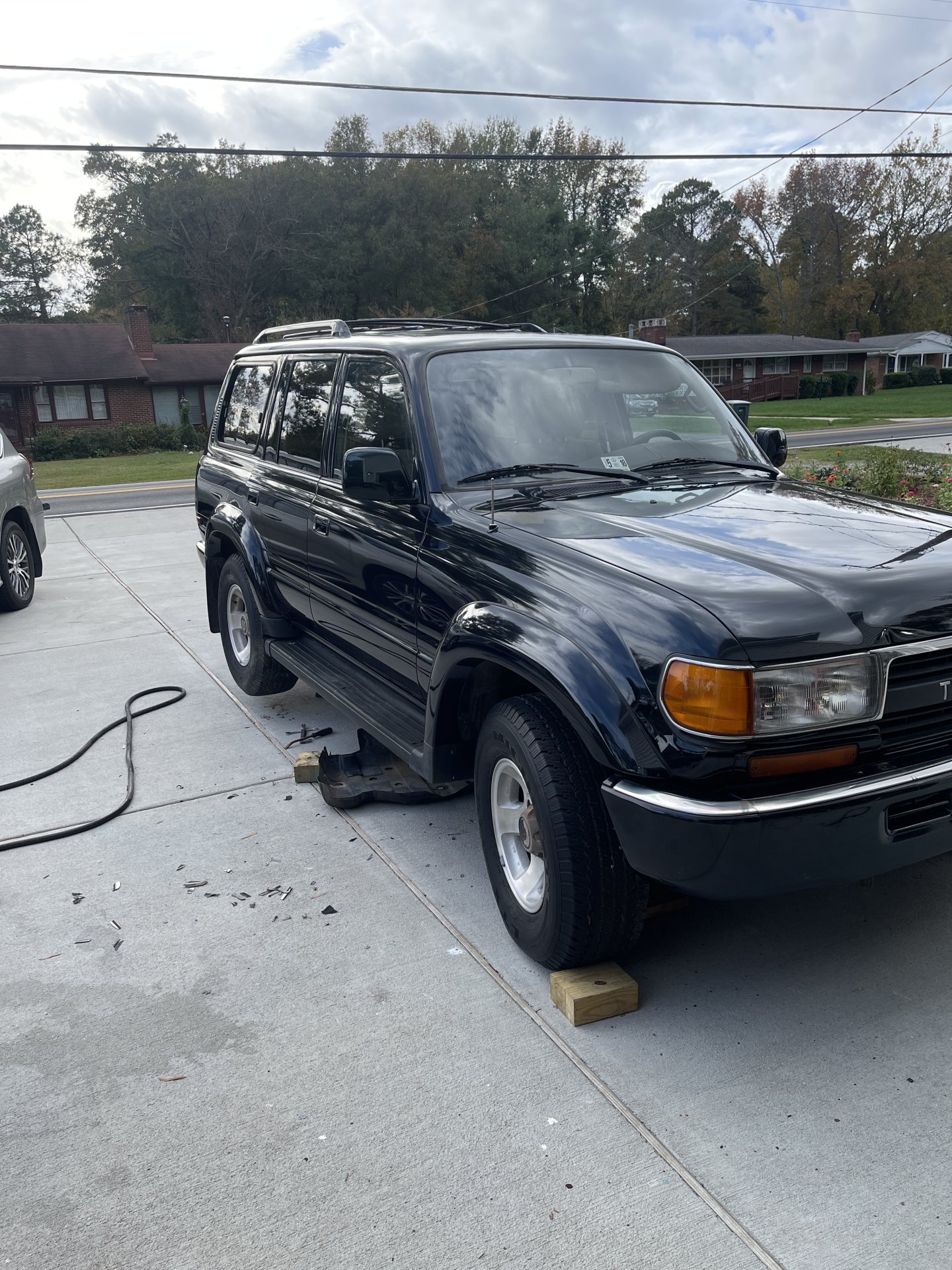

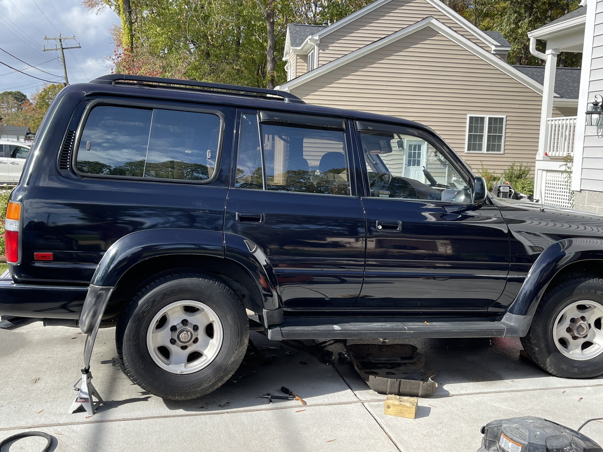

they are very bad shape, im planning on send it to get sand blaster and refinished it, the truck was sitting in the garage for 8 years it a 1993 with 73k miles original owner.
I don't see anything wrong with them, either - but then, I don't have a spiffy 200 sitting in my driveway that a '93 needs to compete with
I really like those fifteen 52 wheels. I've looked at those before. If you are getting a good price you might just take the risk. I doubt you would have any trouble selling them.
@Notthatguy those rims look pretty good. Maybe they need a polish or a refinish (i.e. clearcoat). If you get them blasted, do bead blasting. Sand blasting is too harsh.
Like everyone else stated, your factory rims are nice. A trip to the powdercoater or wheel refurb will do you well.

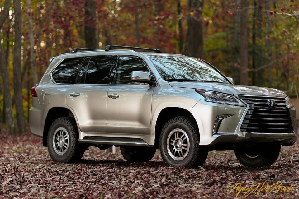

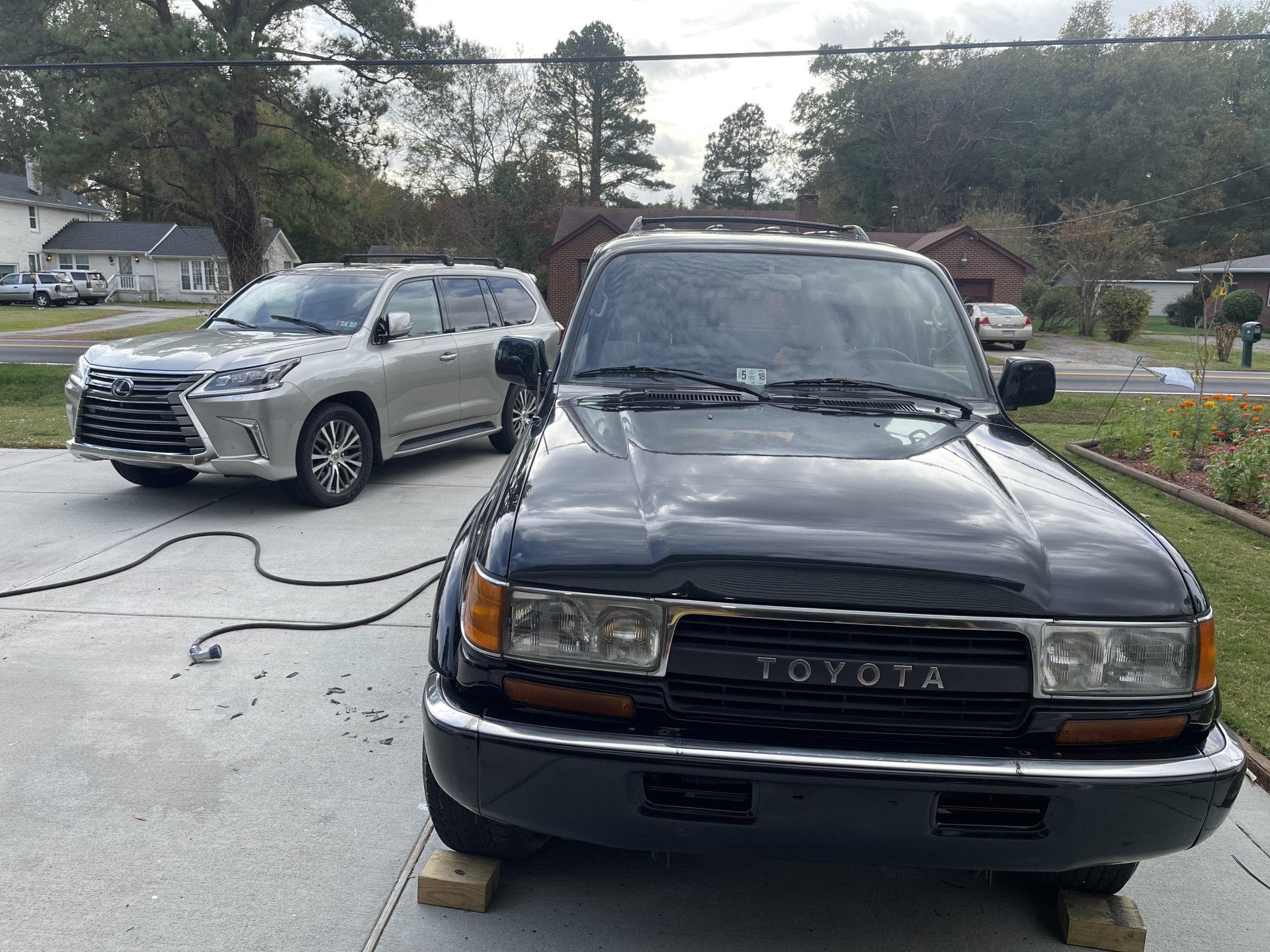

I got the tires mounted on the rims, BF Ko2 recommend a least for 315/75/16 is 7.5. I got those rims from FB marketplace 5 for $600 brand new still in the box. the stock rims I'm planing on send it to refinished in the future. My Lx is cool but I just bought this LC from my next door neighbor original owner with 126k miles for $3000. she parked in the garage in 2017 and never moved her husband passed away and it was his truck.I just got 2" ironman lift kit with the foam cell shock.
she let the gas seat for 6 years it damage the gas pump and the sending unit so I remove the tank clean it and the truck start up normal a month before he passed away he did a full service on the truck.the lx is cool but she just going back to long distance trip. I probably will sell my road warrior wheels I don't think I will need it anymore
