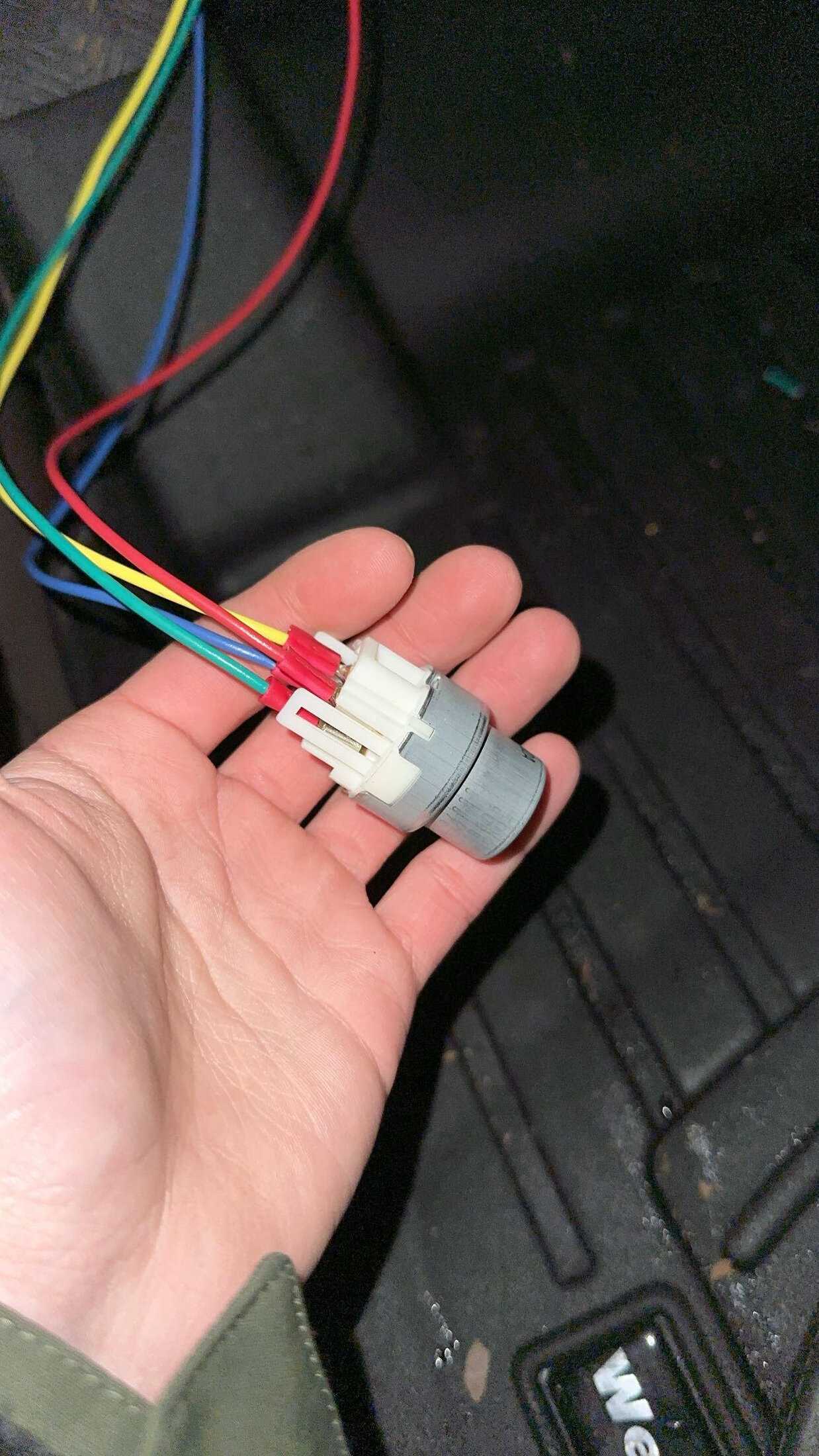

Couple of days ago I was on the freeway and the truck just died on me, I checked everything out, pulled the relay out and put it back in. Came to find out it was the relay again, but this time it did not seem to be an issue with it overheating. Upon inspection, I saw that the socket for the relay is broken, I think I yanked the old one in and out a little too many times and maybe a little too aggressively.
It kept dying on me, I kept throwing the relay in and out, but I was able to limp it off the freeway like that and got it towed home. It never started again after that, no check engine light when you turn the key, so I thought the connection of the relay in the socket is no good. So, after reading about the nightmares people experience with these relays, I decided it's time to relocate mine to the interior of the truck and was convinced it would get it to start again. Today, I got to it and wired everything up, put the key in, and I have the check engine light on. I was excited, I thought it was going to start, but it cranked with no start just like before. The check engine light comes on, but as soon as I turn the key to try to start it, the CEL goes away. Once I stop cranking, it comes back on.
Does anyone have any idea what I am missing here? Where do I even begin? Not having CEL gave me a clear sense of direction, but now that it comes on, I am completely lost. TIA

So I bought 10 gauge wire to replace the wiring with much ticket one but I couldn’t figure out what to replace. The actual wires going to the relay are like 20 gauge and I was not gonna chase them down to fully replace them (it’s cold in Chicago) and connecting 10 gauge to 20 gauge felt like a crime.
I did see the wire from one of the pins going to the fuse, but I decided I’ll upgrade this wire when it’s warmer outside. What am I missing in the wire upgrade department?
