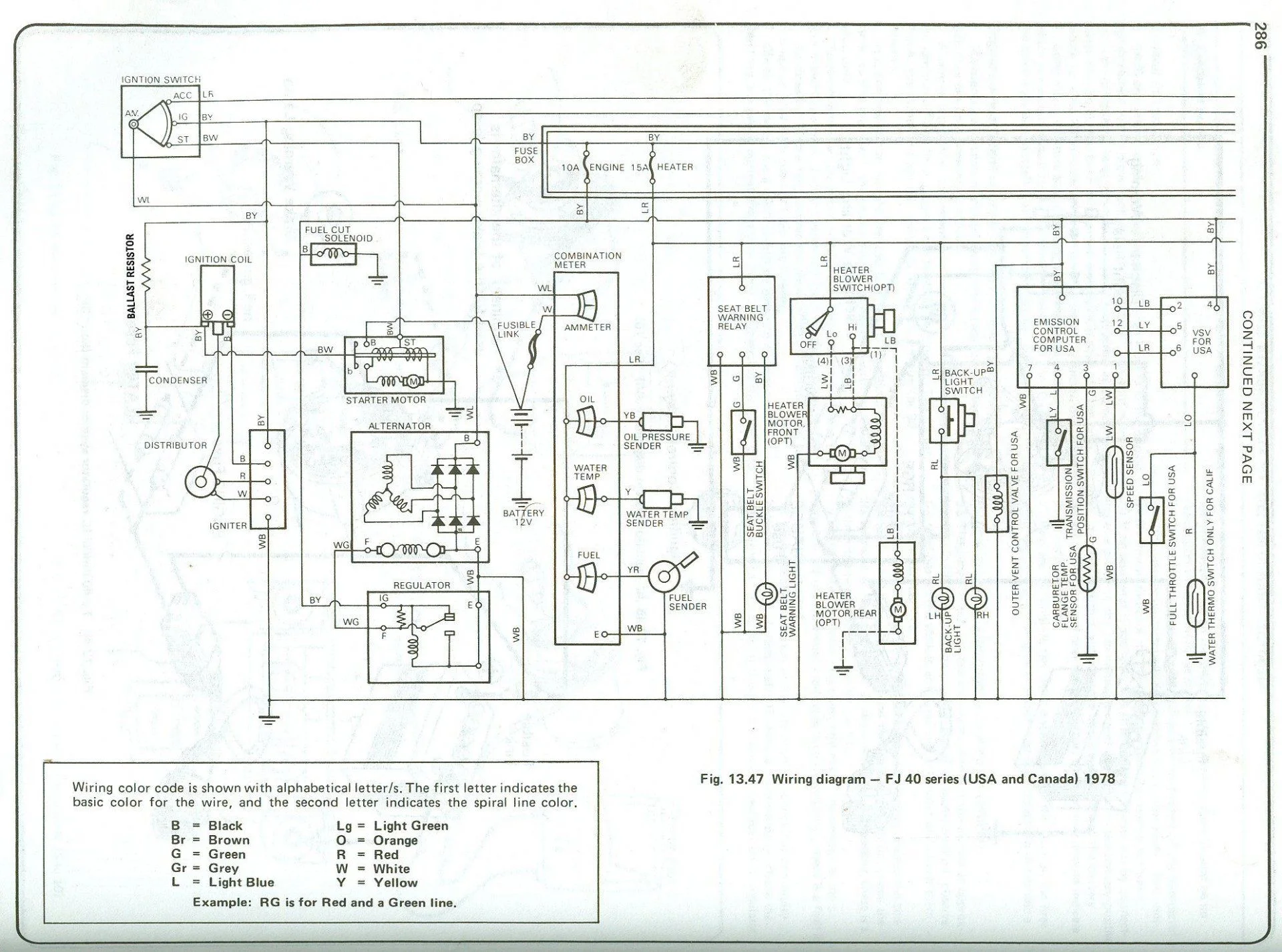

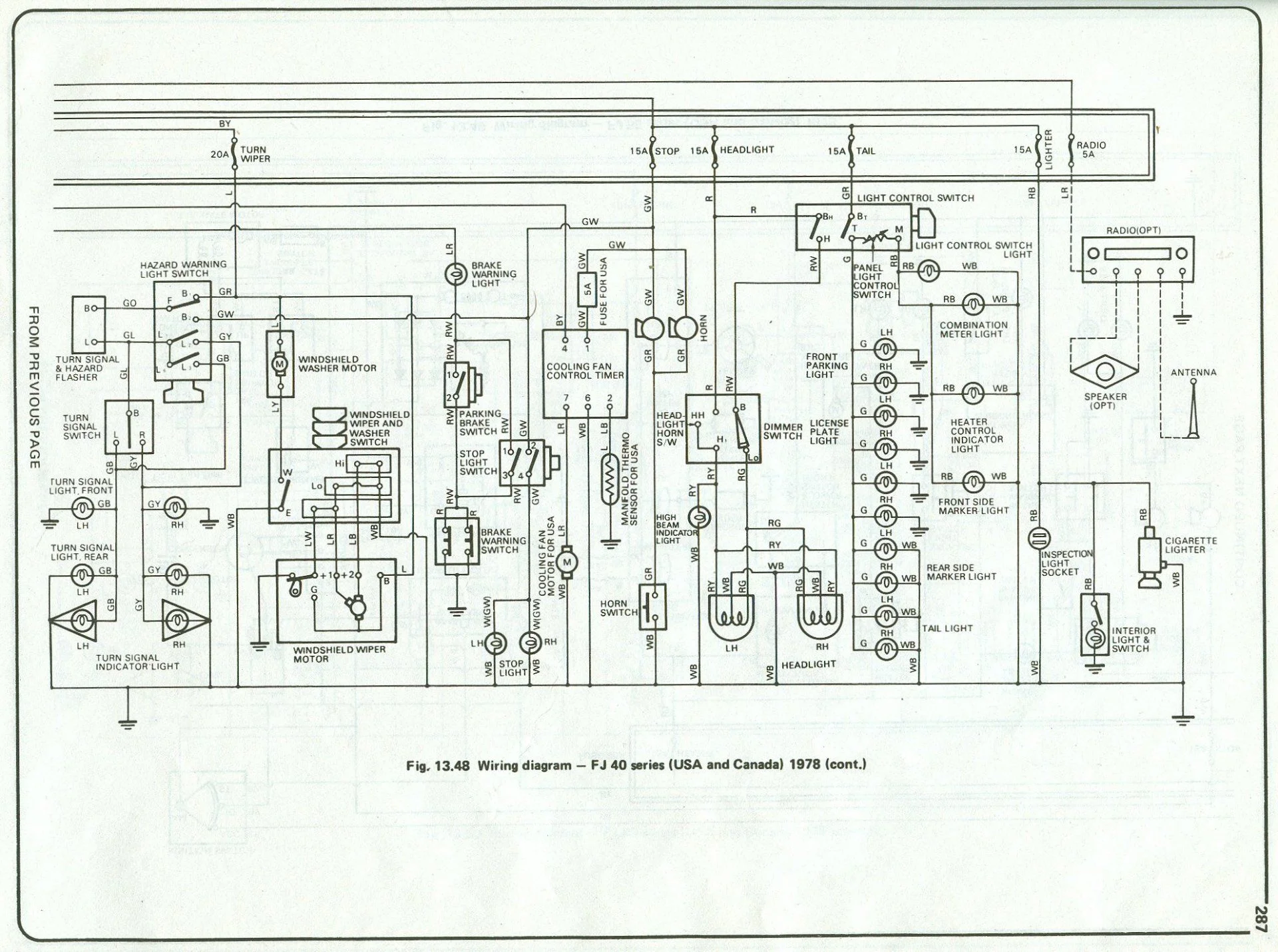

Fix the leaks, tune it up, address the wiring gremlins one item at a time (78 diagrams attached for reference, very similar) and enjoy that thing!

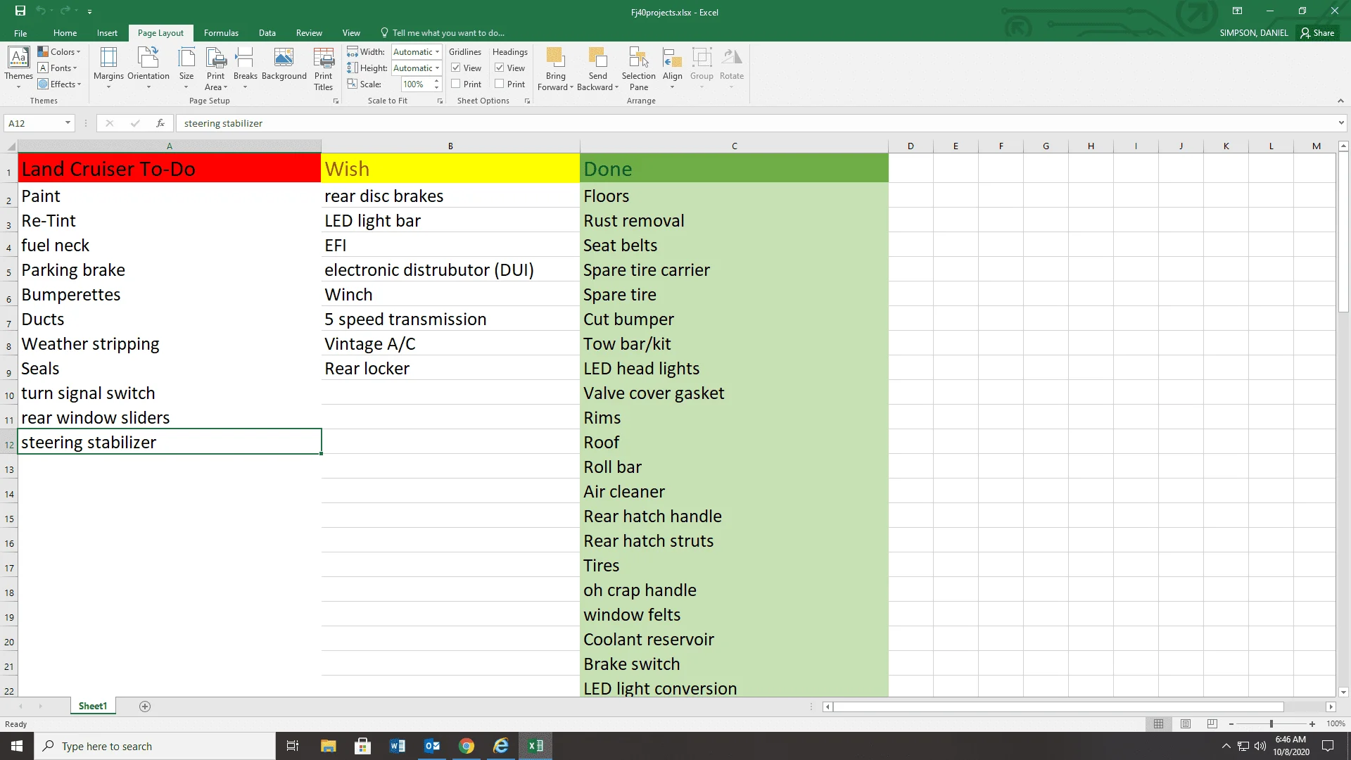

I created a spread sheet with 3 columns on it. Not because I am uptight but quite the opposite, to control my ADD and to stop me from going a million different directions and never getting anything done. Believe me I would have about 1000 projects and nothing would be getting done. One column is for the things that need to be corrected, i.e. seals, lights, brakes, tires, etc. One column is if I had unlimited funds and money was not an option such as rear locker, winch, vintage A/C iForce 5.7 v8 conversion 5 speed transmission, stuff like that. The 3rd column is everything that I have completed. Then as I get something done from the first column I put it in the 3rd column. I like what you said though at one step at a time. When I first put my vision down of what I was going to do the first column seemed daunting and insurmountable. However slowly over the last 3 years I now have far more stuff on the finished column the the to-do column.
