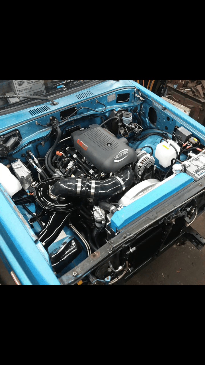

I see people have done nice LS swaps on their FJ60s. Mostly 5.3 liters. I don't see exactly which LS engines they have used which leaves me wondering. I've been studying the various 5.3 liter LS engines. It gets confusing but it seems the biggest variables are iron vs aluminum block and flex fuel system vs not. Aluminum seems like a nice option to keep ~80 lbs. off the vehicle. I don't think that I care about flex fuel. I don't even know if E85 is available around here.
The gen III LM7 seems to be the most common engine and has an iron block. When people say they did an LS swap in their FJ60, is it (almost) always an LM7? How is the weight of an LM7 compared to a 2F or 3F?
The gen III aluminum versions (LM4 and L33) seem to be too rare to even consider, correct?
The gen IV LY5 has an iron block with active fuel management and more horsepower and torque than the LM7. Is an LY5 a common engine worth considering? Is it a common FJ20 swap? How much more complex is a gen IV swap than a gen III swap?
The gen IV LH6 is the aluminum version of the LY5 but seems to be rated for less horsepower and torque. A common engine? A good swap option?
Are the 4.8 liter LS engines worth considering?
