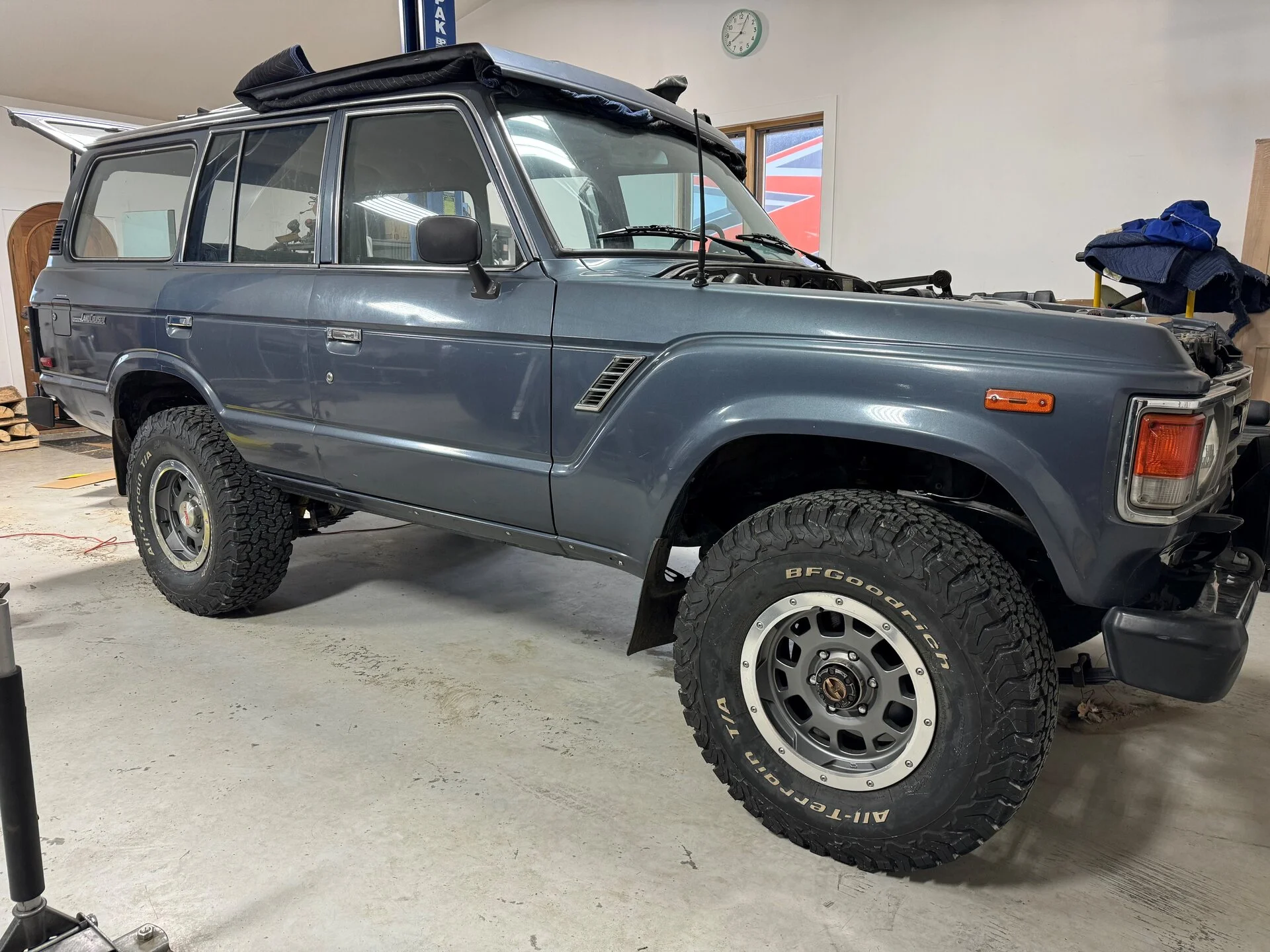

LS1 Aluminum 5.7 with forged rods and pistons, all new with a 4l80e trans. T-case rebuilt by Overland Cruisers (local to me). Extended range 36 gal. tank, new driveshafts from Tom Woods. Should be a hoot! Now it's carpet time, couple small spots to deal with on drivers floor, otherwise this is a super clean rig with only 134k original miles, seats are still mint. It's been a haul, I work for a while and lose steam and it sits. Now I can hear it rumble and it's game on!

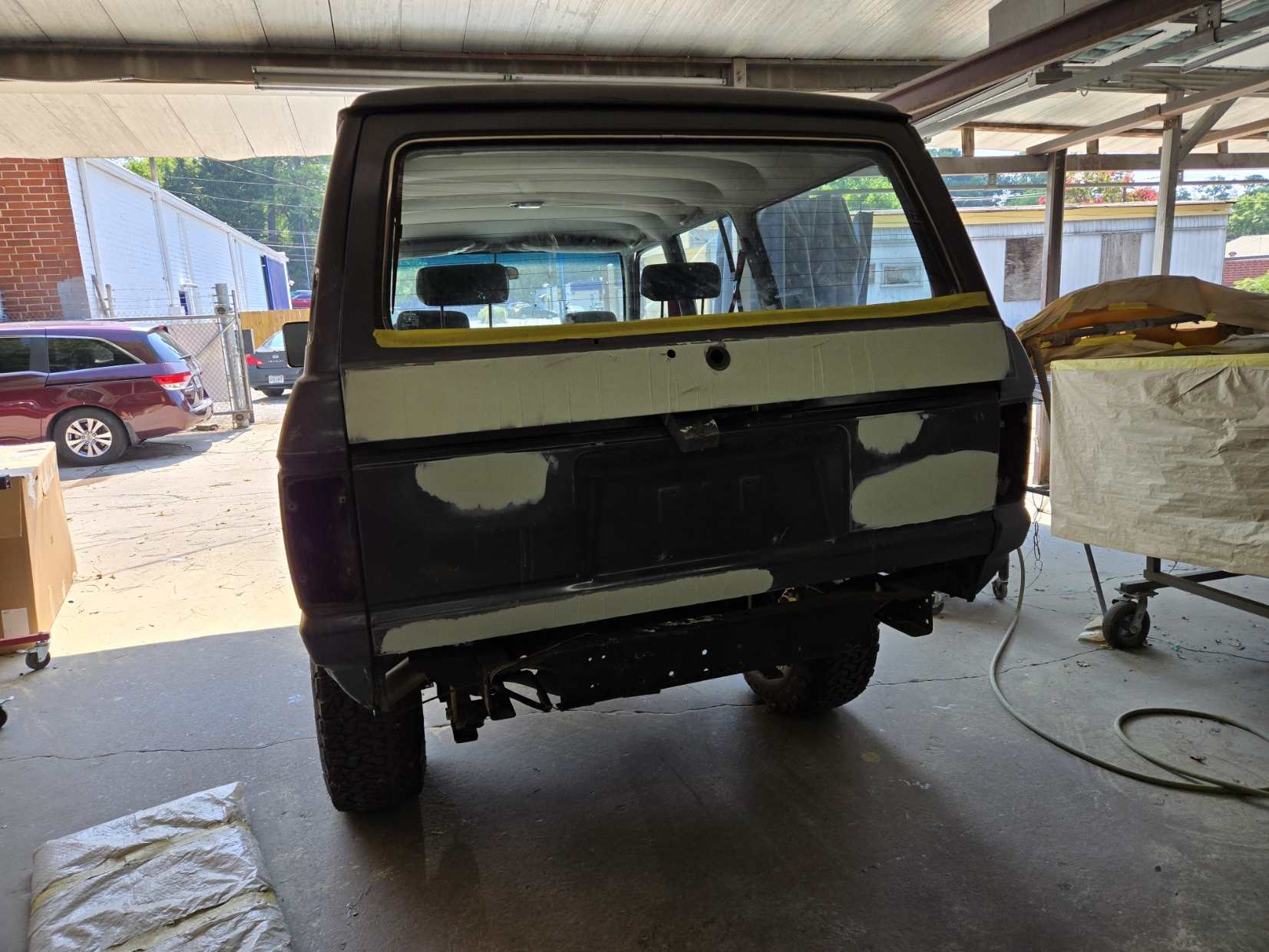

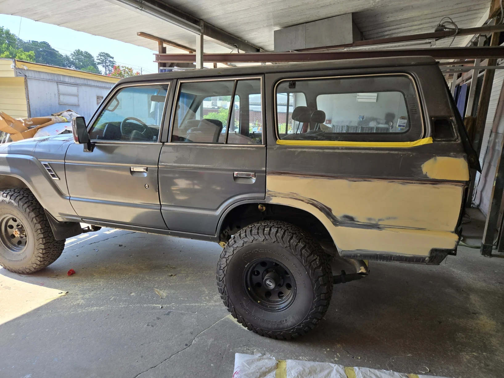

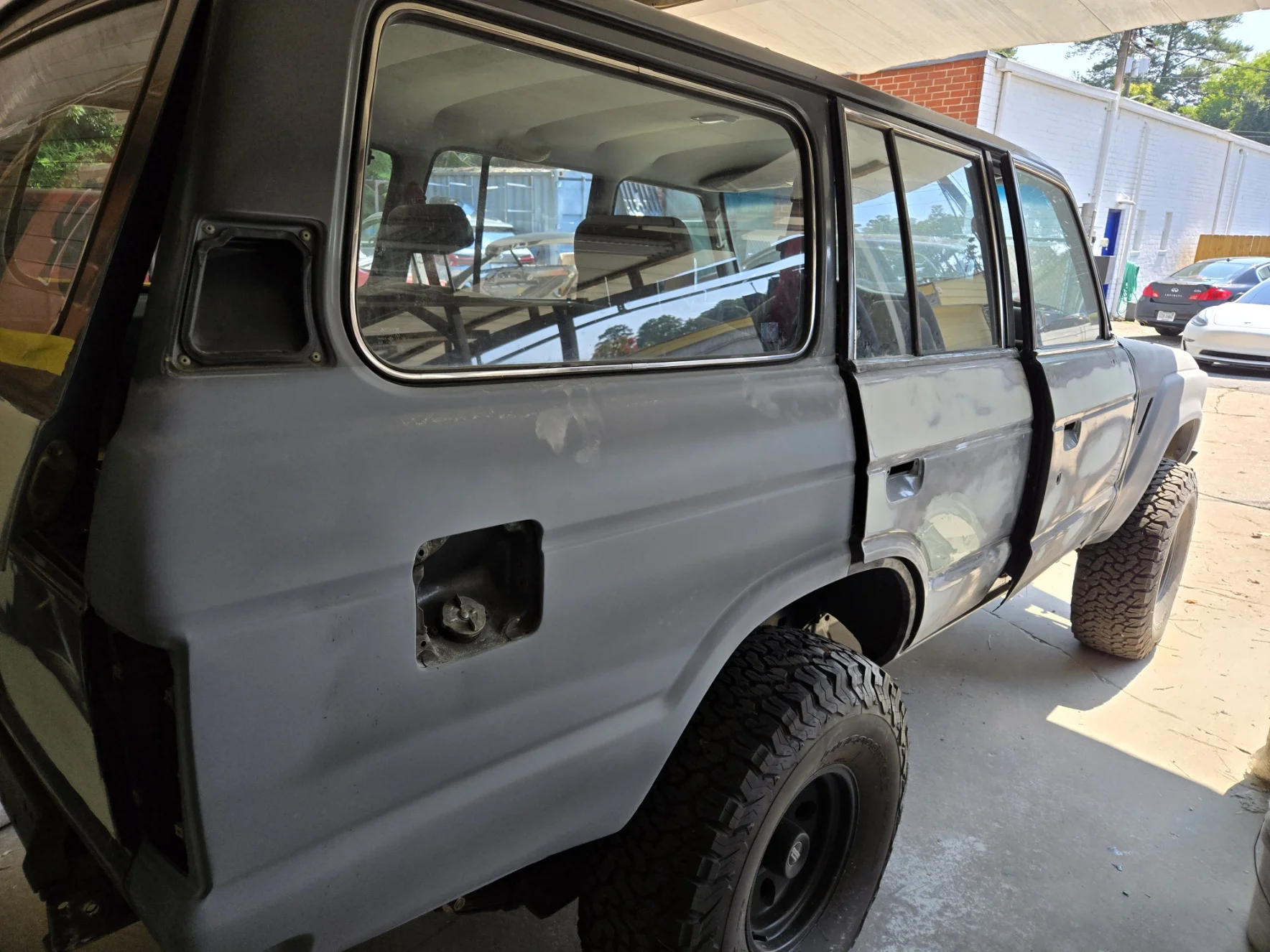

Yeah, that came back to bite me at one point (I couldn't get it out of 4L), and so I dug in and could definitely see why. V.2 will have a transfercase from Valley Hybrids with a different s***ing configuration (twin sticks), along with a custom built HD transmission, so I'll hope for the best. I'll post some pics when I get her back together and on the road. She looks the same as when I bought it (your profile pic!), though I did some body work on the roof and front inner fenders. I gutted the interior, put in some new carpert, sound deadener, new front seats and Tuffy console. She certainly smells a little better, though she hasn't been moving for about a year and a half, give or take. There was a different, humorous thread on the general topic, but upon gutting all of the interior, I found what every single FJ6X owner finds upon inheriting a 60 from someone else: Shell casings, kids' pens and/or crayons; discarded fuses and maybe a beer tab or two! It's like we're all cut from the same cloth.
