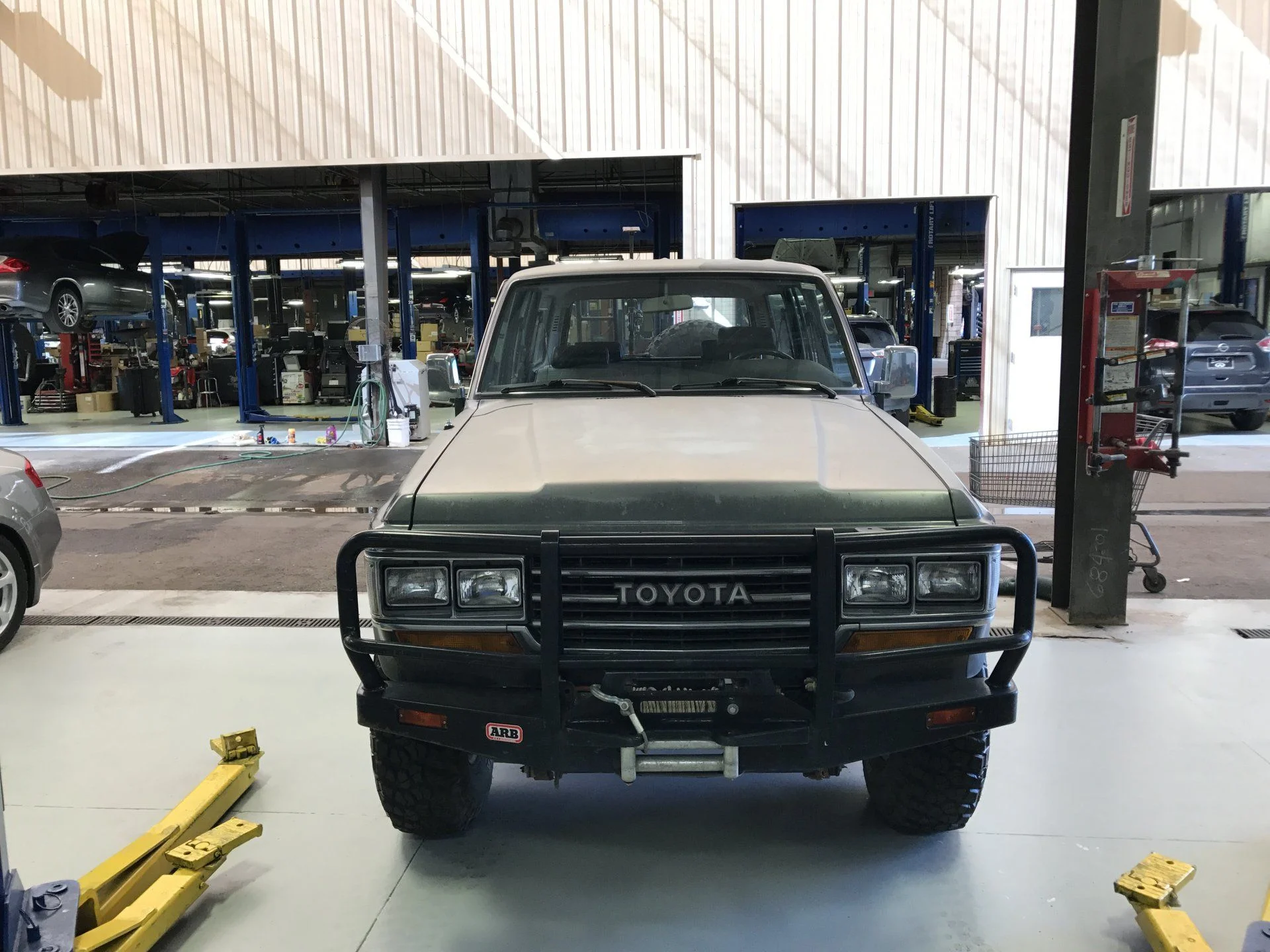

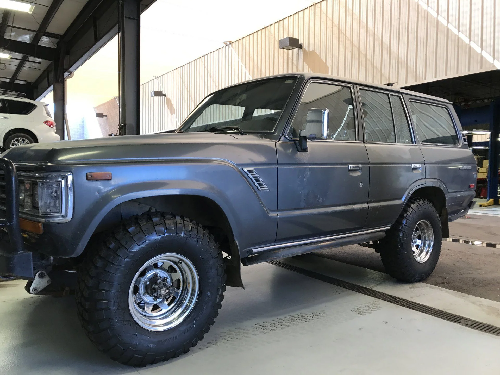

Got myself an 89 FJ62 this weekend. I believe I'm the 3rd owner (carfax is a bit sketchy before 96). A little research shows the truck was bought new in Washington state, came down to Nevada in 96'ish, went to Arizona in 05, and I picked it up in Tucson on Sunday with 149,812mi.

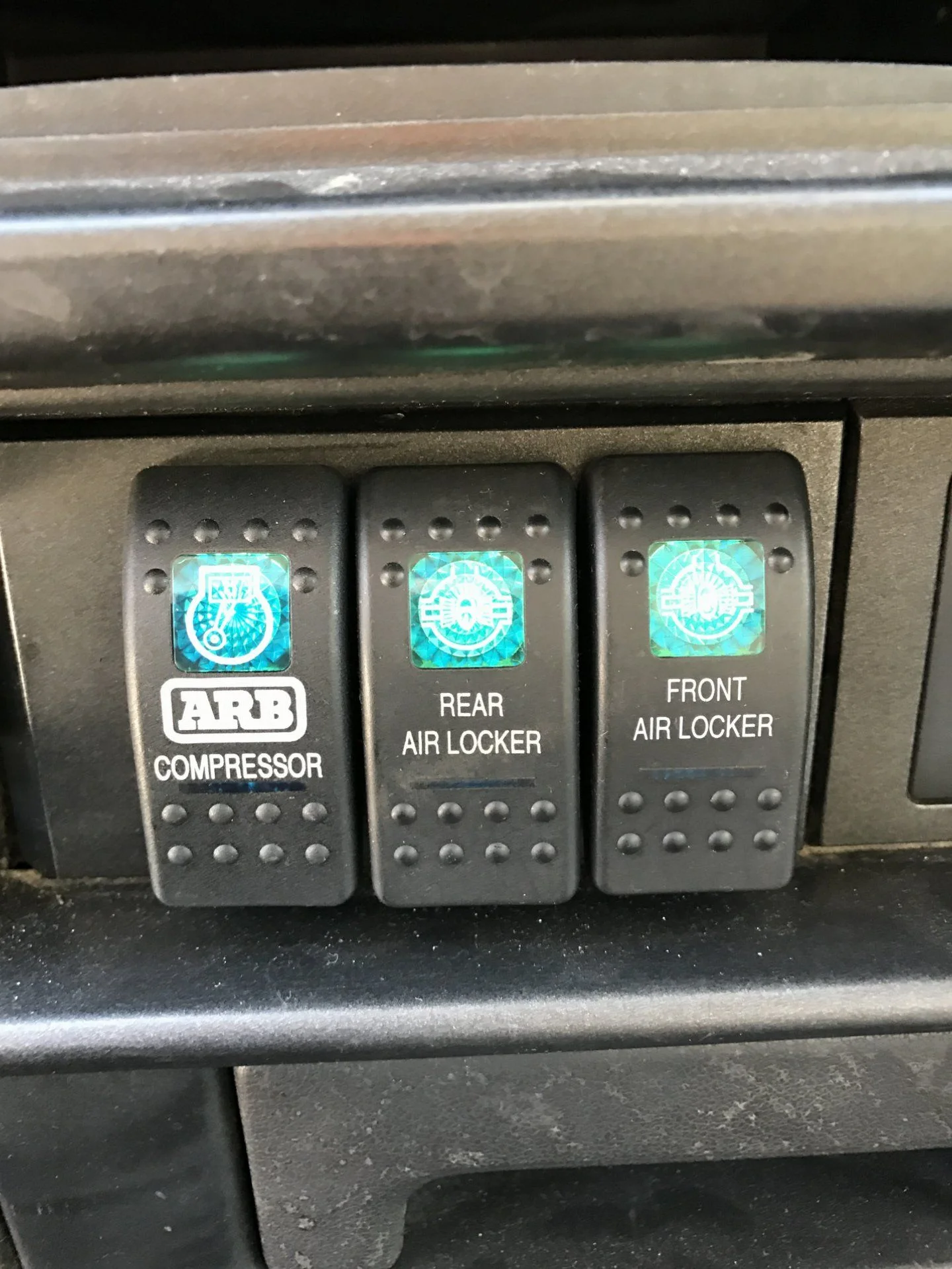

The truck has some really nice mods, it has an OME lift, ARB front bumper, Ramsey winch, 4.88's, 33" BFG's, and ARB air lockers front and rear with a brand new ARB compressor. Rear swing out bumper was apparently fab'd by a shop years ago.
