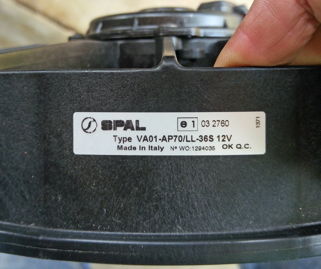

If after a new radiator (and sealing around it with foam), fan clutch (mod?), OEM Tstat, etc then if you still need more engine cooling a few people have installed an electric auxiliary cooling fan. IIRC one route was to adapt a Toyota auxiliary fan and others installed a SPAL or Derale fan
