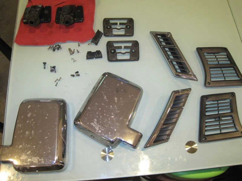

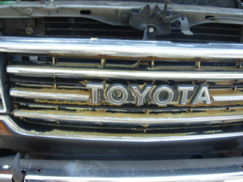

If you want to paint your plastic chromed parts that are peeling/etc have the chrome stripped off. I looked up plastic chrome plating companies and had them strip the chrome off. It cost $20.00 for grill and light trims and leaves a perfect bare plastic finsih to paint.

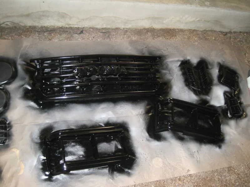

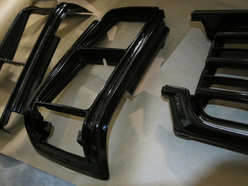

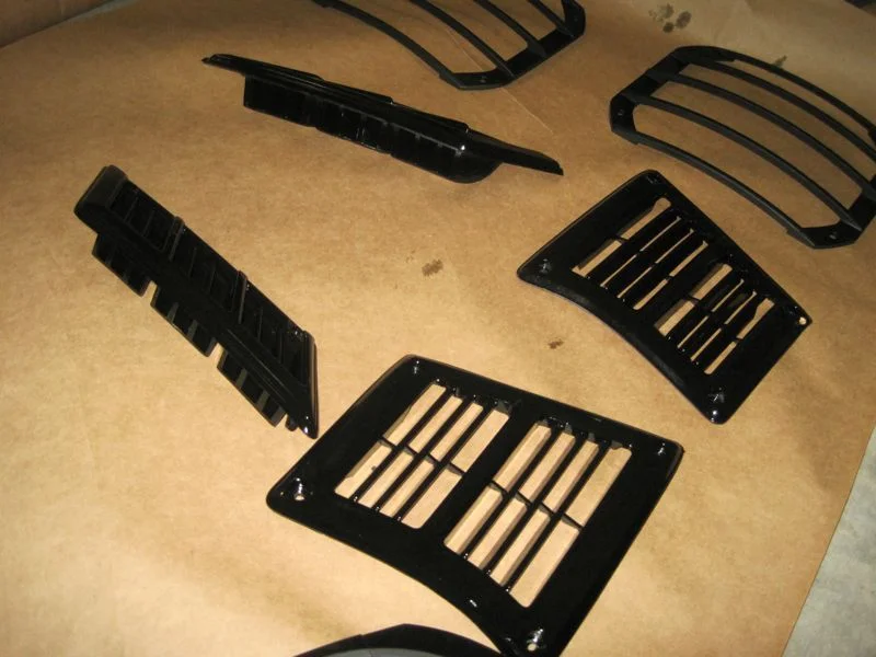

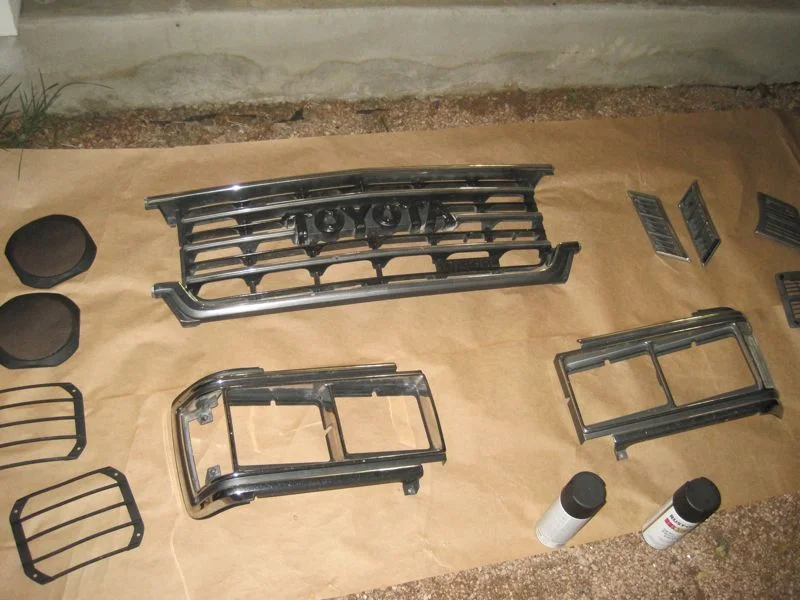

I gave the plastic a light sanding, which took all of the old paint off. I avoided the chromed areas and masked them off before painting. These parts were painted with black appliance epoxy from a spray can. I know from experience with my FJ40 roll cage that the paint is tough and UV resistant.
This is after I painted but before I removed the masking tape;
Rear vent;
Front vent

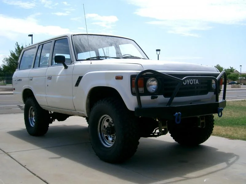

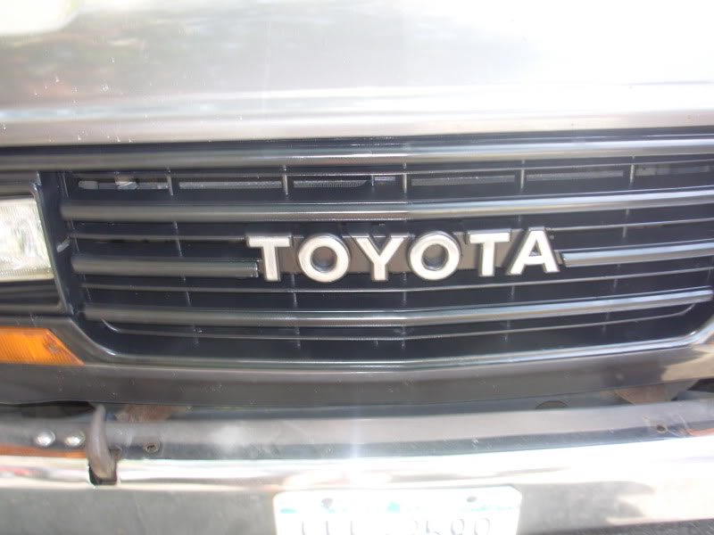

before.....(20 years of sun)

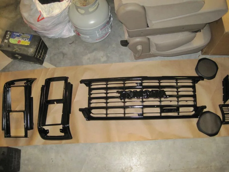

After....(1 can of primer and 1 can satin black)
Since e've all been yapping about blacking out the truck this week so I figured "why not tonight - can't be that big of a deal"
Well, I can confirm that no, it is not a big deal. It is a piece of cake. I didn't do the door trim & the handles because I didn't want to take my doors apart yet (getting some sound deadener soon - will do it then) nor did I do the mirrors (because I got lazy).
But I did do the grill, headlight enclosures and vents. My rear bumper was done by the P/O.

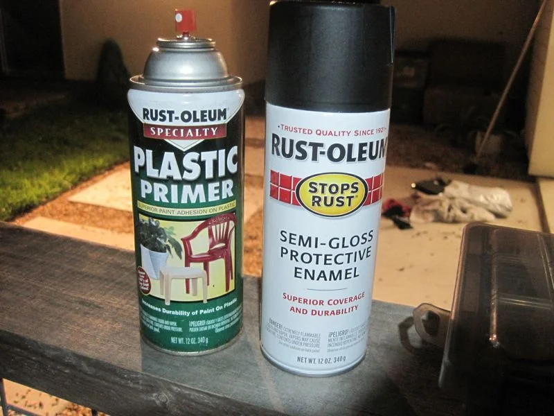

I used Rustoleum Semi Gloss on top of Rustoleum Plastic Primer. One can of primer and two cans of paint got me one coat of primer (with primer left over) and three coats of paint.
It isn't perfect, but it looks a lot better than the faded chrome. I'm hoping to get the truck repainted in the next year or so and when that happens I'll have pro's knock it out again the right way (you know - with real painting equipment and training in its use vs. me and beer+spraypaint).
That said, I think it looks pretty good. I am going to let it sit in the garage overnight and slip it on in the morning when it is dry and ready.
