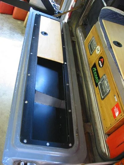

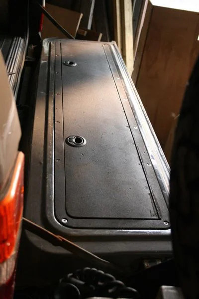

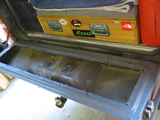

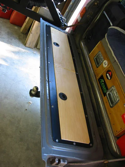

All that wasted space inside my rusty ol’ tailgate was bothering me so I wasted my Sunday and made this.
Thought I would post it ‘cause I’ve never seen one before.
Now I know that the reason I’ve never seen one is because it's kind of a waste of time, and you don’t gain that much space.

Thanks
Yes I climb, nothing to do with the stickers though, I just like them.

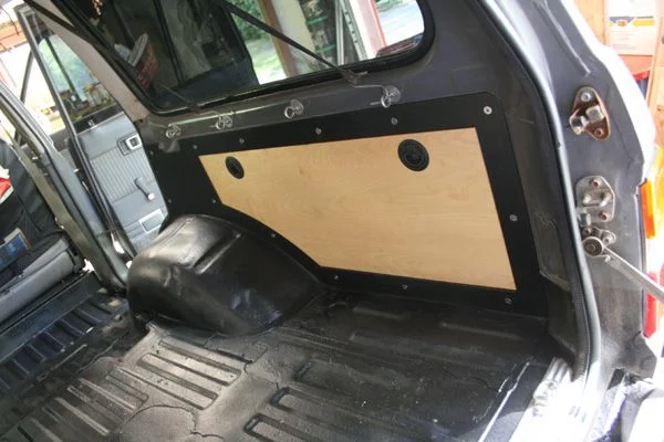

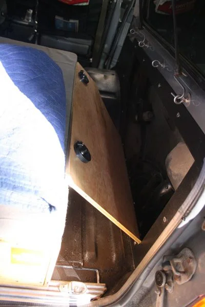

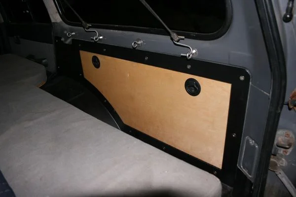

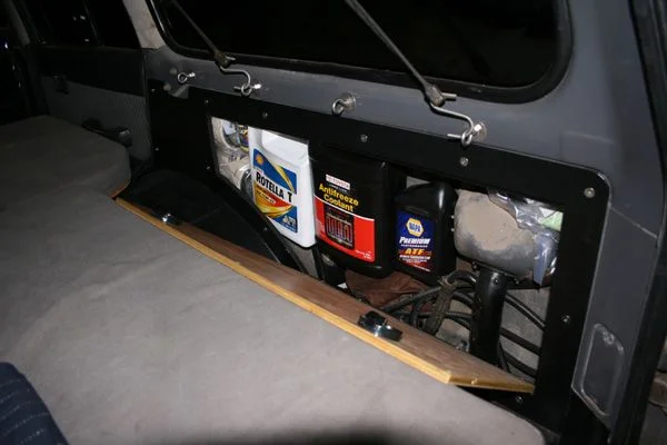

I already putt some hinged panels on the quarters, those are great, and VERY usefull.
I was thinking that the tail gate box would be good for emergency stuff, axe, jumpers, tow strap, jack (too bad the jack wont fit in there)
Now I am thinking that I will make it an overflow kitchen box since I lost so much kitchen drawer space due to the NEW FRIDGE!!!!
Since the main structure is made from angle iron it is still very strong, actually its stronger than OEM. I had the classic caved in tailgate and I used this to straighten it out.
The main thing is to keep access to the internal door mechanism so whatever I put in there needed to be relatively easy to remove, that limited the size a bit. The box is 48” in length but only 3.25” at its deepest, and that is right up to the outside metal.

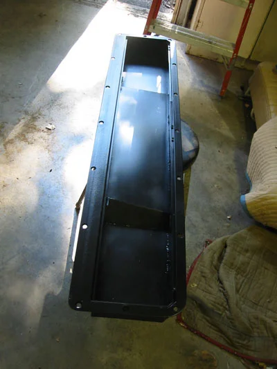

Here's a pic of just the box outside of the gate. Basically the rim is made out of angle iron, the top bit has a 2" leg to clear the latch mechanism and the rest is just a few pieces of 16ga. I cut the tailgate out with a jig saw and welded on some 1/4-20 nuts to bolt the whole thing on. Oh, and some 1/4x1/4 rod makes the lip for the lid to rest on.

Yeah, so I looked at the pics I posted......and they suck, sorry 'bout that.
Here is a zoom in of the original photo, perhaps it will explain the constuction a bit.
I can take a few better ones tomorrow.

The quarters are just the original vinyl panels glued to a sheet of aluminum, hinged on the bottom with a little 1/4 turn compression latch at the top. I am seriously considering doing something just like this so that there is actual boxes in the quarters.
I would not suggest cutting a hole in the tailgate without planning to reenforce it a lot.
Once the center bit is cut out there is pretty much no strength to the tailgate anymore.

I have always thought about doing this, as I am sure most others have too, but I always thought the opening mechanisms for the tailgate would get in the way. Glad to see it works!
Any pics on the quarterpanel storage. I am a visual learner. Gracias.

rear cargo area panels
Talked about the 1/4 panel stuff here.
