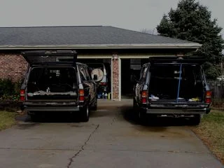

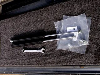

Sure appreciate all the info on replacement tailgate struts!
I used Reid Supply Co., mfg. is ArvinMeritor, label tag is Guden; Suspa has an on-line order system & also sells the ball studs. Don't miss those little spring clips in the attachment parts bag. No instructions, but I found them to hold the strut on when placed appropriately.
I fortunately started out with 1 extra OEM strut, as I rounded off the 12mm base of one stud completely (must have been on there for 18 years now, 8<), rounded a corner on a couple others. Not to worry, as you can use a box end wrench (love those gearwrenches!) when you reinstall them.
I used a rotary tool to cut the studs free , from the pic you can see that those cutoff discs I'd worn down to the size of a dime or less cutting my fan shroud work perfectly, as the mandrel can ride the socket & space the cut away from the stud. By the time I'd cut 9 of them I was getting pretty good, and only nicked one of those I did use.
See studssalute pic for a comparison. FJ62 on L has new struts; FJ62 on R is propped up on a mop handle, so its just slightly higher than where weakened struts held it up.
Stand back when you open the hatch so you don't catch it on the chin. I warned the wife to release the tailgate before feet leave ground. No more noggin knots!

Chalk another repair up thanks to Reid Supply Co. $52 shipped to my door, w/ 2 struts and 4 new end balls.

Another happy customer - about $45 from Reid supply.
One note, however. The new struts are slightly longer than OEM. The result is the hatch lifts up higher (which is good) but it lifts until the hatch hits the rear gutter. The rubber window gasket is what actually touches the gutter and it doesn't seem to be harming anything, but if you were able to get struts that were slightly shorter - maybe .5 inches, it would probably be ideal.
But not hitting your head is pretty ideal too!

I got the shipstore lift struts awhile ago, and just put them in today. I discovered (I have an '88 FJ62) that you can get the ball out without cutting the socket, you just need to get the little wire clip out of it. I fished it out of each of the sockets in like 10 seconds each, max. Not sure if people are still interested, but the shipstore struts are super easy to install, and if you can get the little retaining wire out, the whole job should take less than an hour. I would've taken pics, but once I discovered I didn't have to saw them all apart, I got excited and just finished it up.

Yukon,Thanks for the fishing out the clip idea.It took me a while to fish out the first one,then it was all downhill from there.Just curious,what did you use? I went through 2 bobbie pins, a couple paper clips, and finally settled on one of my wife's dental tools.Thanks also for the write up,used the reid supply springs.

check out McMaster-Carr, i just bout some w/ the ball ends for $40 for both. 20 minute install. boutgh the 17 inchers rated at 90lbs

First off, shipstore.com sucks!!!! I ordered several months ago and never got anything. They never responded to any of my phone calls or emails until I threatened to dispute the charges and contact the BBB. Finally they emailed back and said they were cancellingmy order.
I ordered from Advance Auto Parts and got Monroe replacements within 3 days to my door. Roughly $50 for the pair shipped. They came with new ball ends. I didn't notice the new ball ends in the package until after I took the old ones out of the old arms.
The best tool I could find to pry out the clips was a small spring. It was the only thing that I had that was small enough and stout enough to pry them out. I uncurled one end of it and got it started under the clip. It was more of a roll action with the wrist to get them to peel out as opposed to a straight pry.
