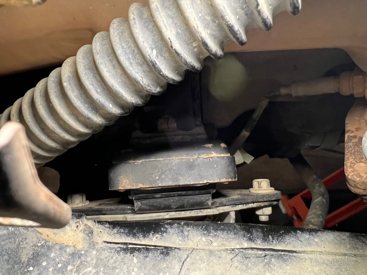

I don’t recall if you did engine mounts, but I just replaced mine and it solved vibration when stopped in drive.
Those are brand new as well - both the left & right along with the transmission mount.

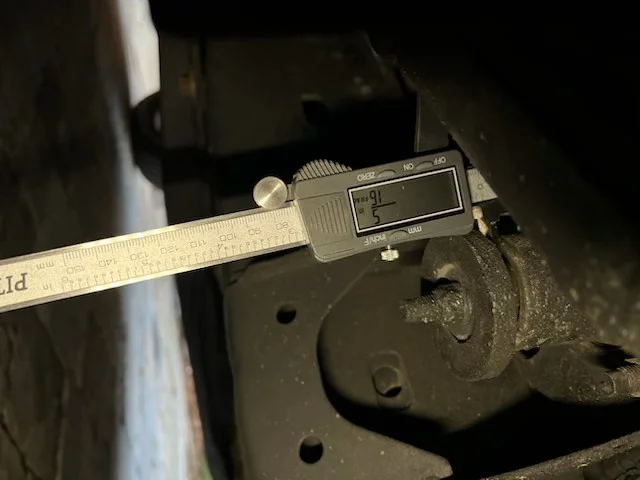

It's been a while since we talked about your body mounts. I mentioned that the mounts on my pampered LX appeared to show much different spacing
than yours between the big washer and the mount. Maybe take a close look at that as any contact without rubber between body and frame can make really
weird noises. Man, I wish something would magically solve this for you, you deserve the relief for all of your hard work.

Would you be able to grab a photo of yours? If not, not worries - I probably should just compare to the new OEM ones I have sitting in a box, haha. Would be interesting to see what other 'aged' vehicles look like.

New driver side.
Oops, you said body mount…
Here's a pic of the one right behind the right front wheel. I checked several others and they all were about 1/4 inch between the big washer and the tube that the bolt and rubber live in. This one was 5/16ths. Correct me if I'm wrong but I believe that space gets larger as the rubber collapses with age until metal touches metal. Hope this helps or at least takes this off your list.
Thank you for that! I'll check mine out & measure here soon.
