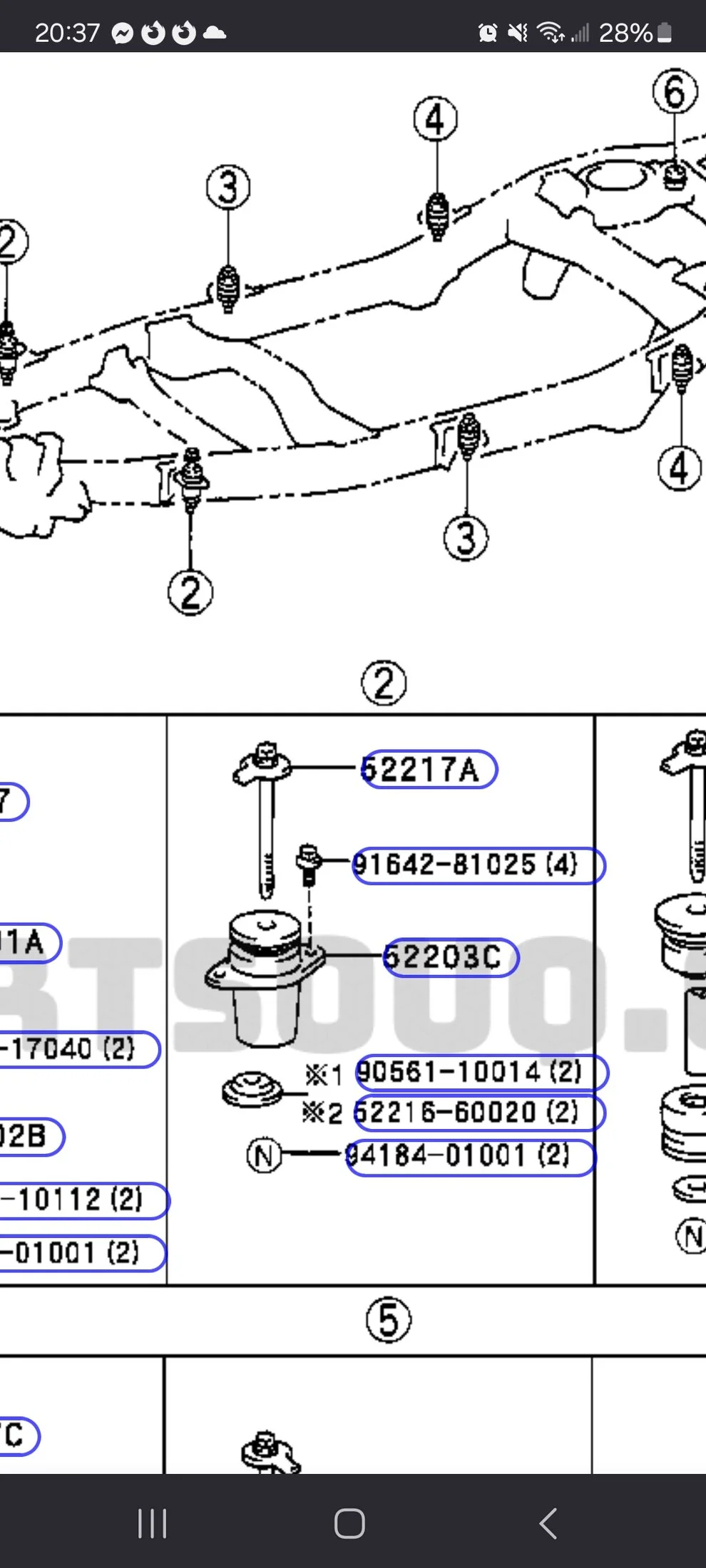

Oh - here's a question. I assume everyone's front body mounts look like this? This is the one right behind the front passenger tire:
That body mount is bad - there shouldn’t be a gap. I doubt it’s the problem, but you found another thing.
I actually think it's OK - looking at a new mount (I have them all on-hand), the actual bushing looks the same. I think the bottom "washer" just has a weird step in it - see below Partsouq diagram.
I'd love someone to confirm though!
My cherry mall cruiser has about 3/8 inch gap there. If it's a lot more than that I'd be inclined to pull that nut off both sides, put a stack of washers or a spacer in there and take it for a drive. You've tried everything else right? Only for a test, you need a gap or your rubber mounts aren't doing anything.
Easy to do and maybe it'll tell you something.
Thanks for the info! I'll measure tomorrow, but that's pretty close to where it's at I think.
