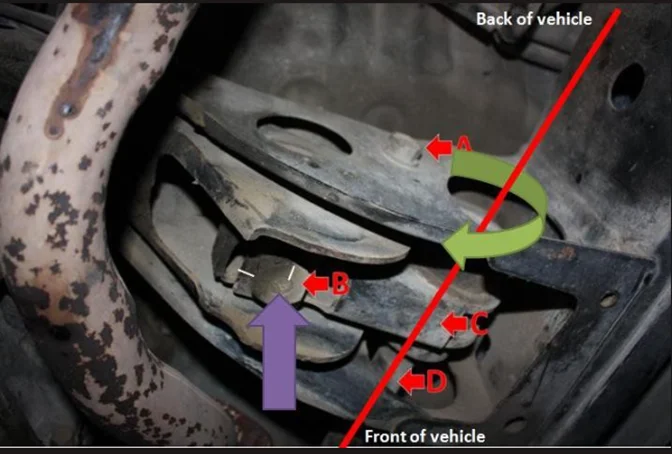

Sorry to see you're still fighting this issue. I'm sure this is not the issue/fix, but have you replaced this little bushing? I rarely see it mentioned on the forums and I'm sure you've already swapped it but wanted to throw it in the ring.

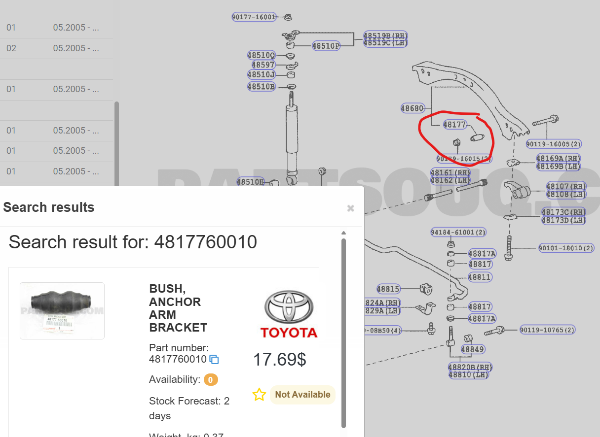

I haven't actually swapped that - I can't actually imagine in my brain where that goes. Do you have a description for it?
The bushings sit above the torsion bar adjustment bolt. In picture below, it is bolt A. (edited - my original description was wrong).
  • Like
Reactions: LJE
The bushings sit at the top center of the torsion bar crossmember. Basically follow the crossmember from the torsion bar adjustment points to the center of the crossmember.
Oh, interesting - I'll take a look at those and likely order the two to knock it off the list.
